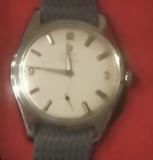

Hi,
Someone could he inform me about this Ranchero. Country of destination, year of manufacture...... value
Thank you for your help

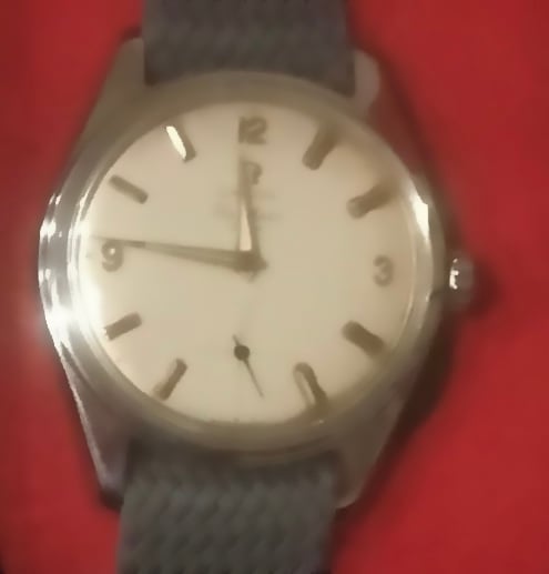

I worked on your photo a bit, let’s see if this helps. I couldn’t move the hands unfortunately.

Looks like a put together with a 2990/2996 case. Dauphine hands on a Ranchero should have a center seconds hand, not small seconds.
6,676
11,620
Lots of subseconds Rancheros have dauphine hands. Regarding OP’s watch the poor photo disallows any firm conclusions.
10,068
57,378
Yes, I stand corrected, but a 2990 would have an actual small seconds subdial and not just a crosshair which is what I think that I see on the OP's watch, would it not?.
10,068
57,378
I'm still voting for a put together. Even if it's not, that dial is in poor conditiion, I don't think that the style of dauphine hands is correct (large triangular lume cutout on the hour hand) and that doesn't look like a bowler hat style crown at least from the angle shown on the photo, or its very badly worn. .

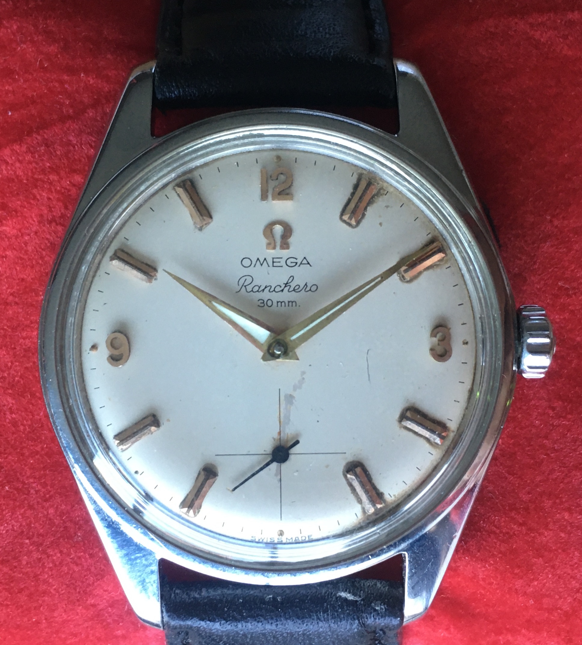

This is one of mine which is close to NOS with original strap, buckle and sticker at the back:
10,068
57,378

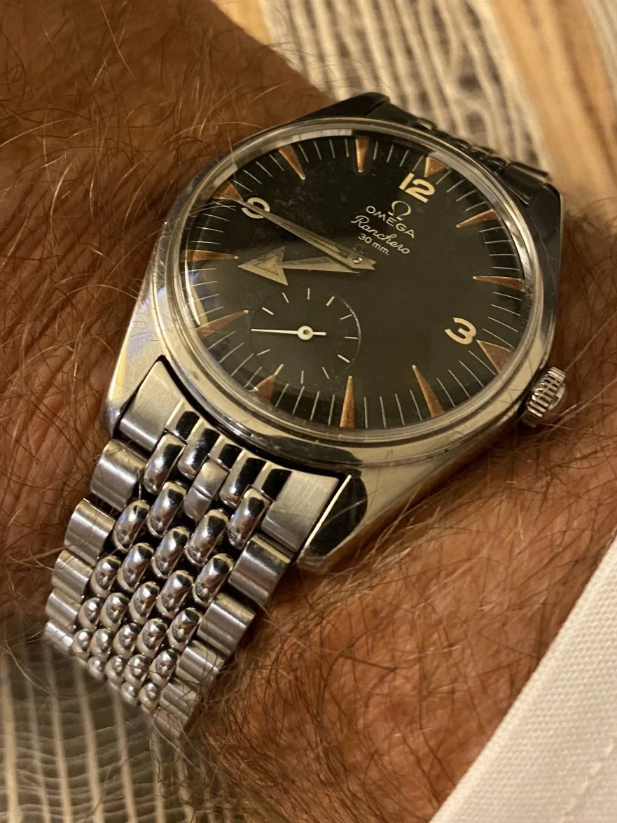

What a beauty! Well, this has been an education. I don't think that I've ever seen that style of Ranchero with the small seconds crosshair and with a stainless steel case. Very atttractive! .Right back at you with mine:
219
209
That's one sexy watch. Beautiful, thanks for sharing!

very close. You would have a picture of the crown.
Do you know the origin of this model. For which country was it intended
7
photo of the bracelet and buckle too. Thank you
