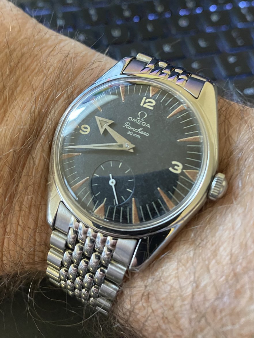

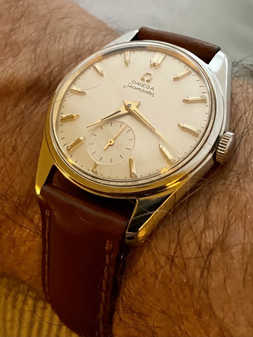

You’re not going to find an authentic Ranchero that is in good original condition for a bargain price. Be prepared to pay $4,500 to $7,500 or more for a good example. And do your research. Because the Ranchero was only manufactured for two years, and further because many unsold Rancheros were converted to “Seacheros” by putting Seamaster dials into Ranchero cases, there are relatively few authentic Rancheros that come to the market for sale. There are also many franken, redialed and relumed Rancheros that are marketed as being original when in fact they are not. Below are photos of my 1958 Ranchero and 1958 Seachero. Both are in original condition. You can see how the cases are identical.
