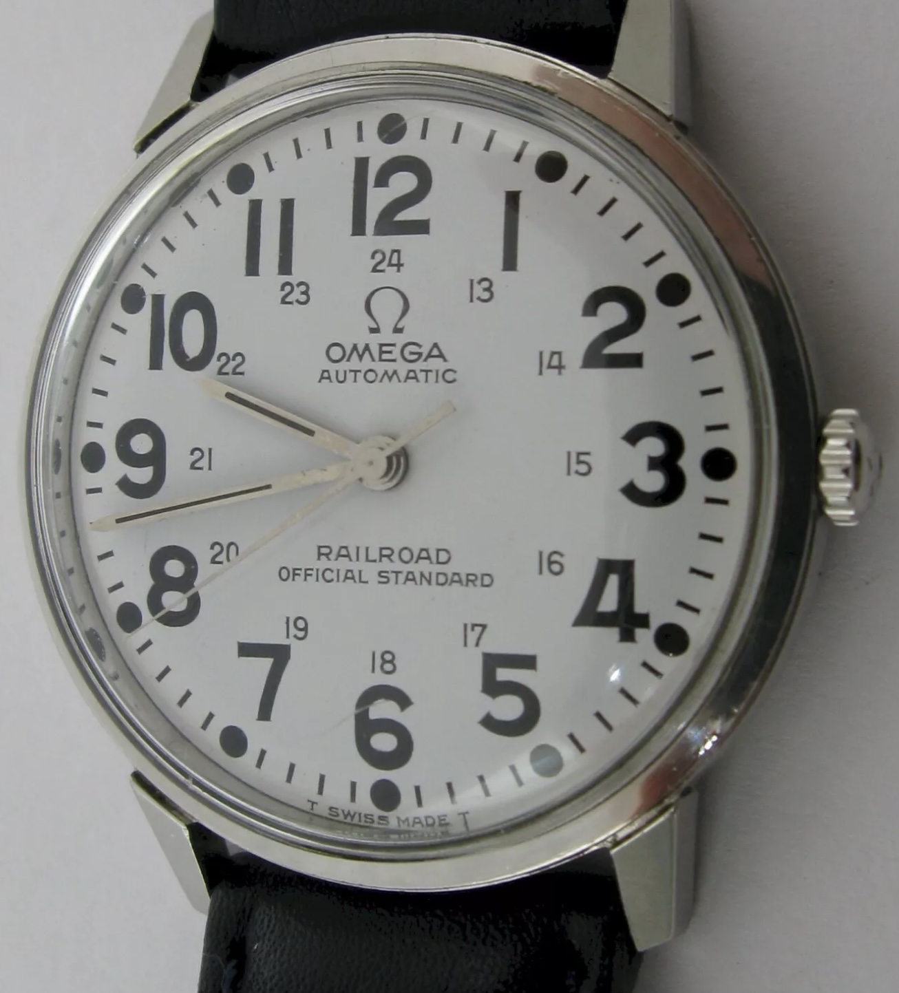

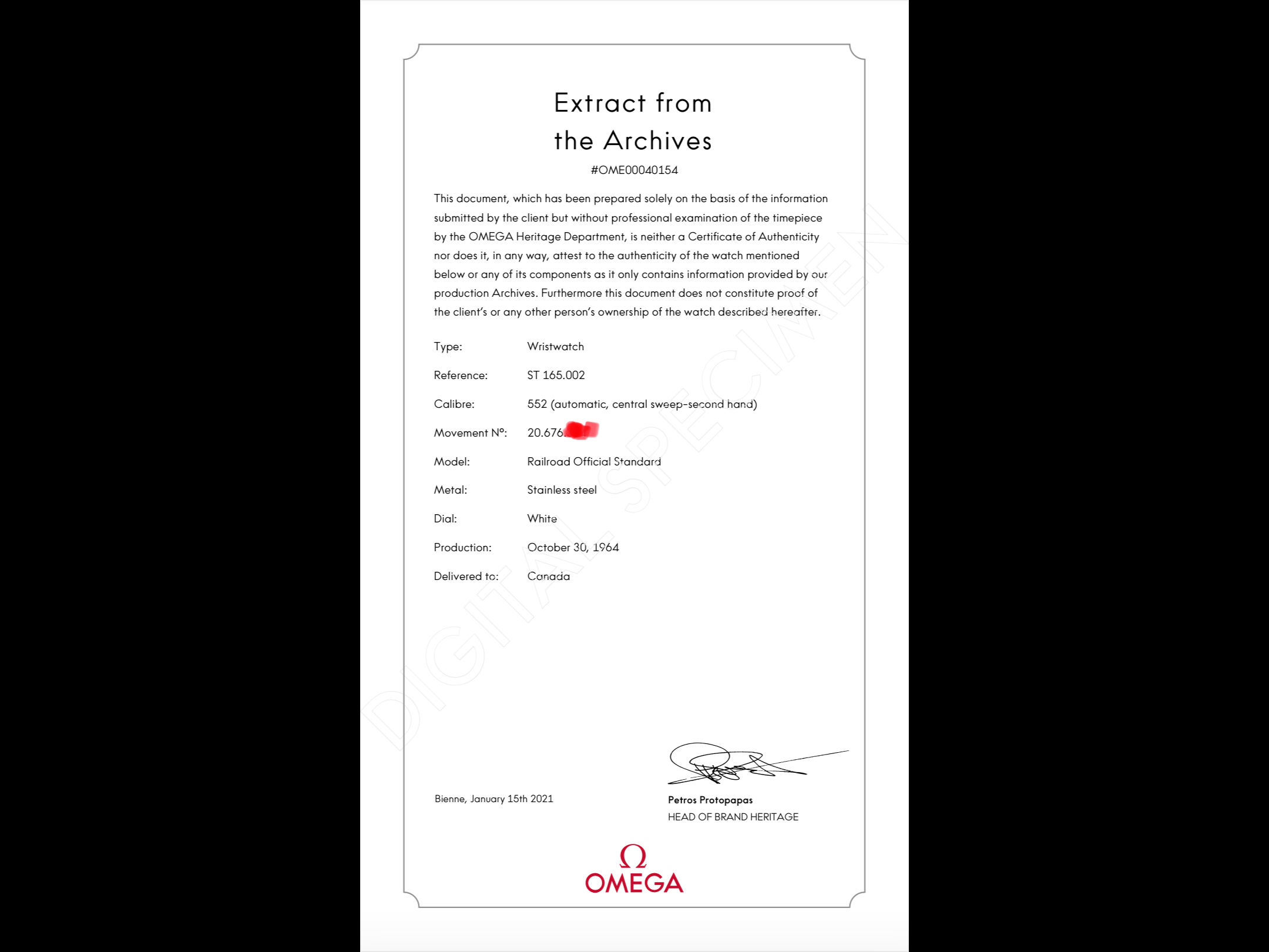

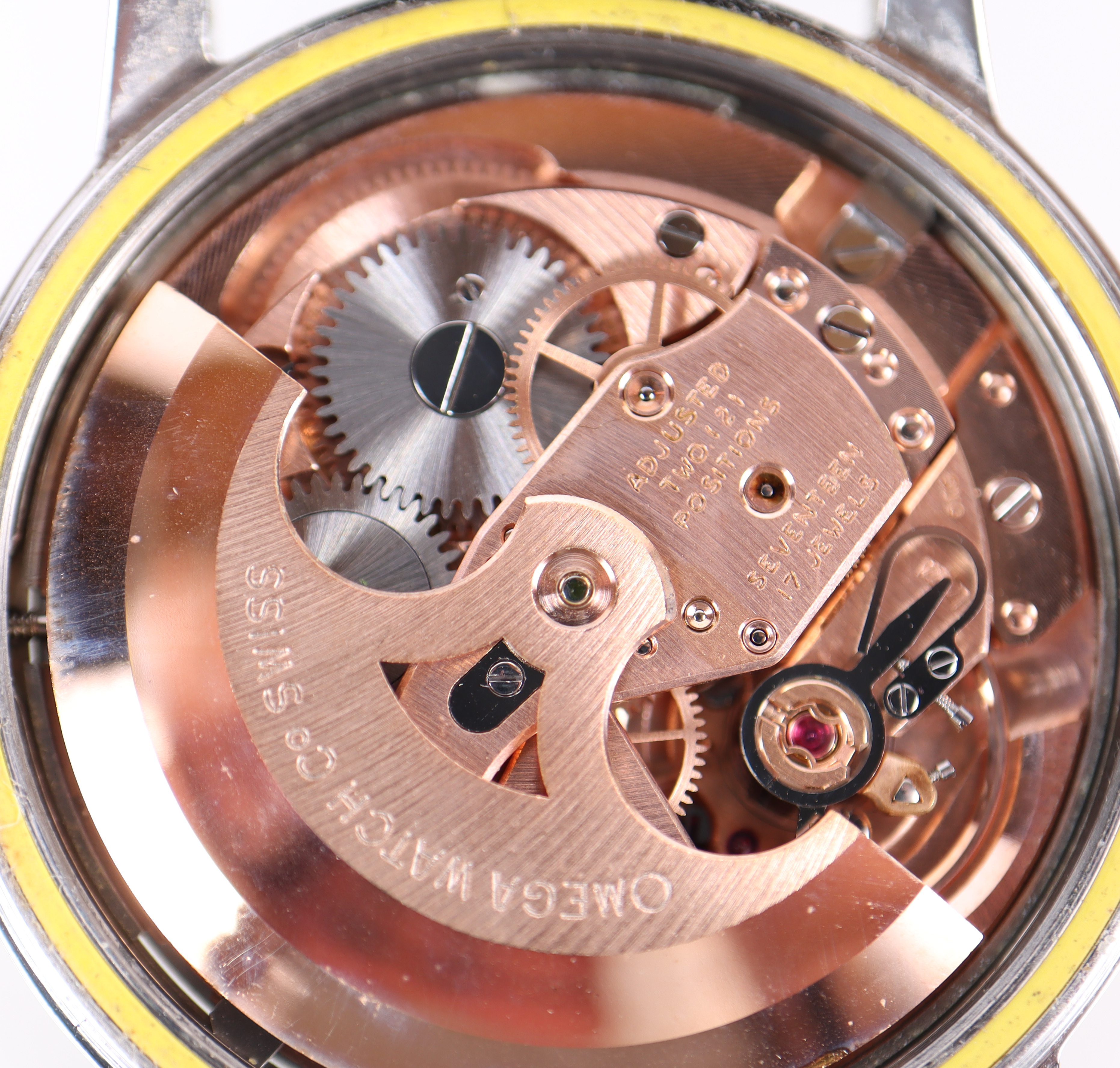

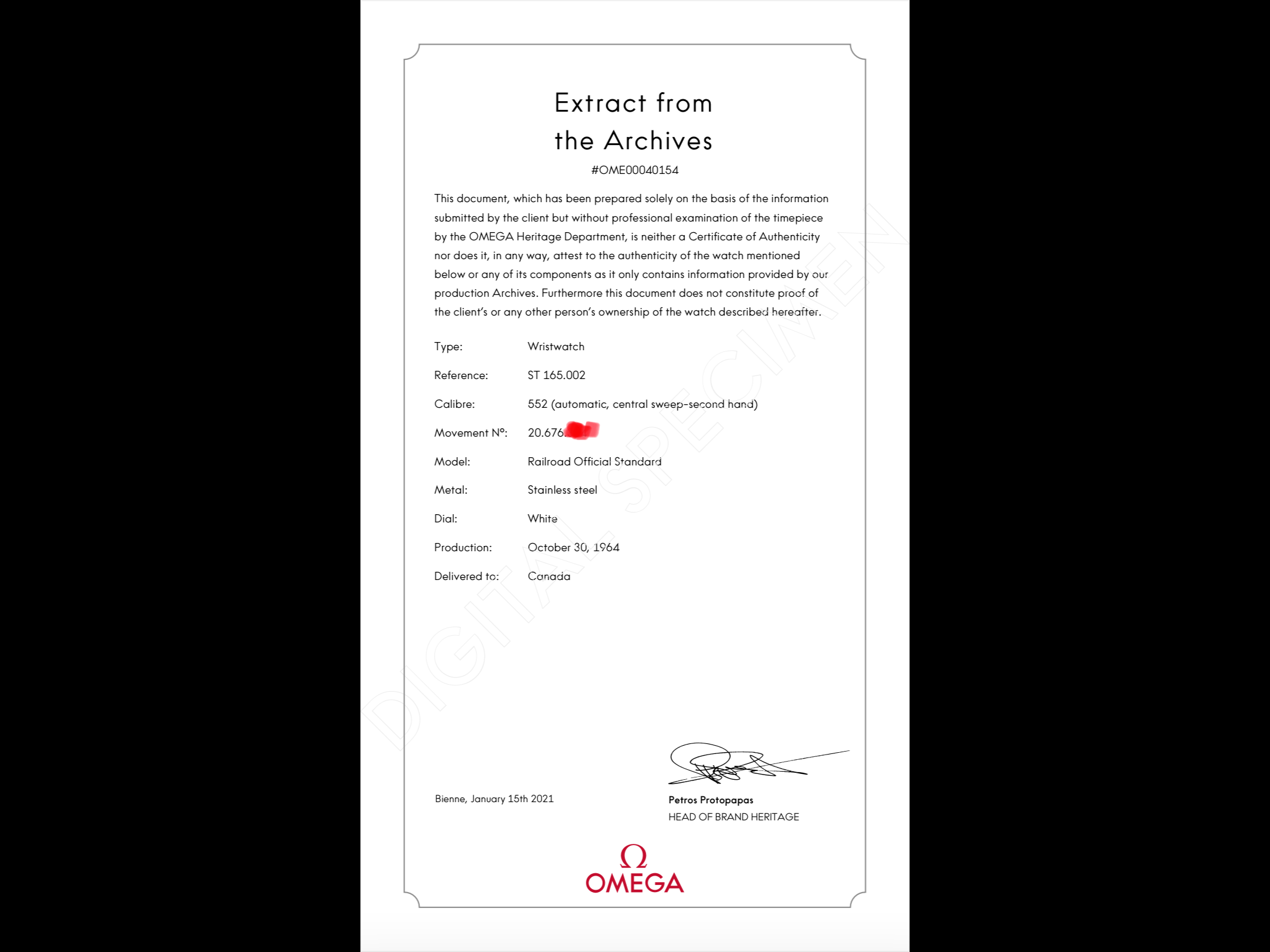

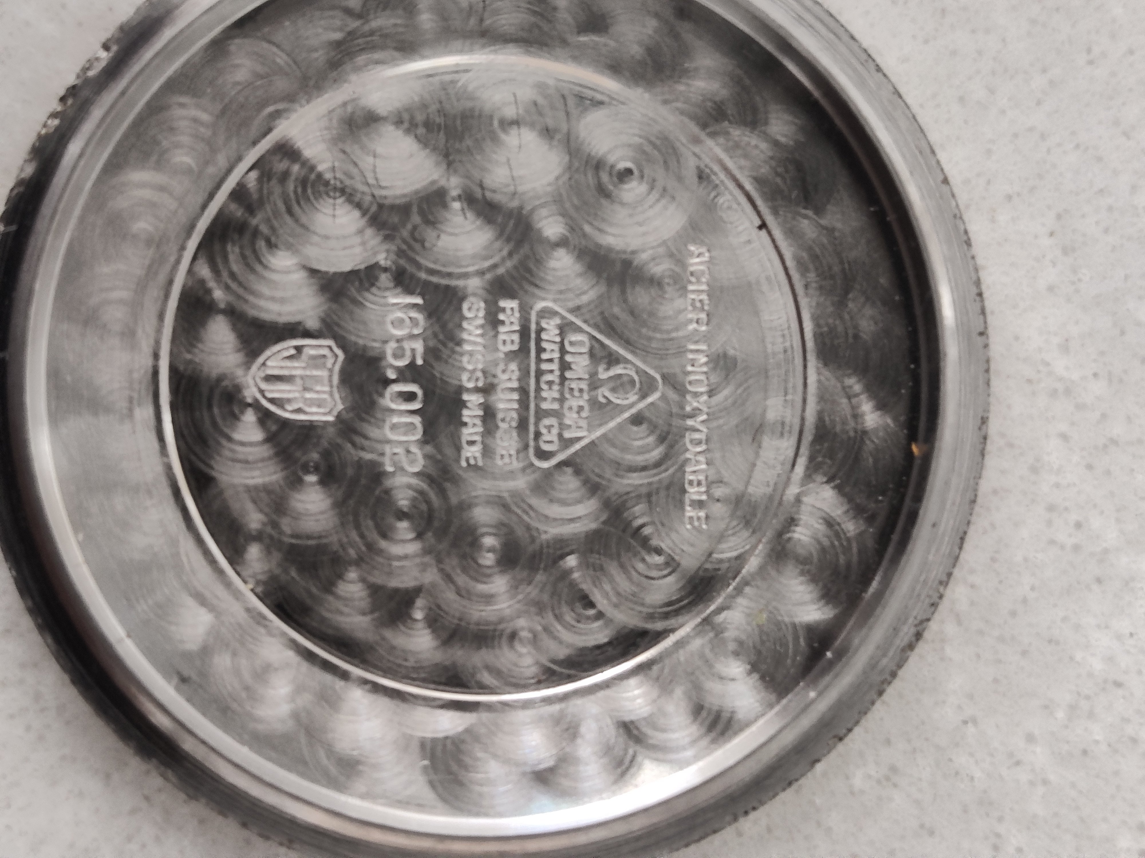

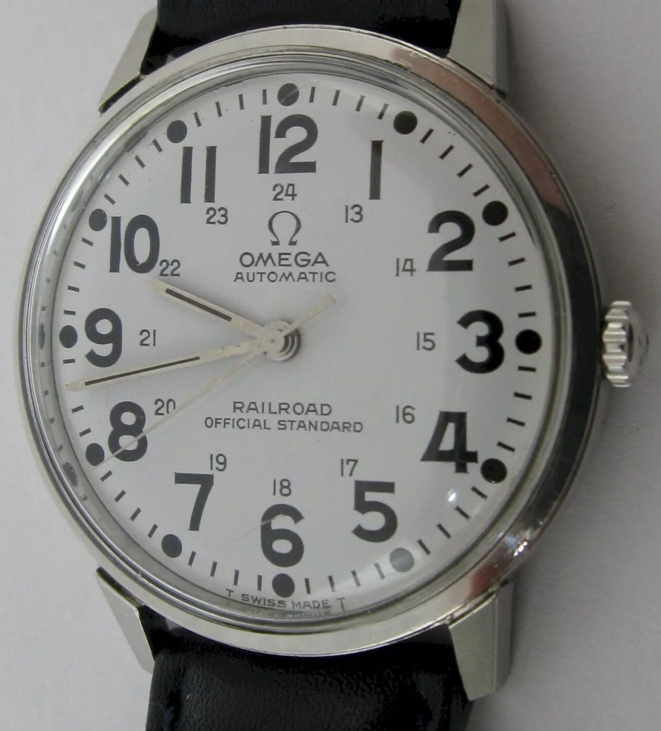

I acquired this Railroad Official Standard recently and the digital extract just arrived. 24 Hour railroad dial, Reference 165.002, caliber 552, 1964 production for Canada but no specific mention of the Canadian Pacific Railroad. What you say?

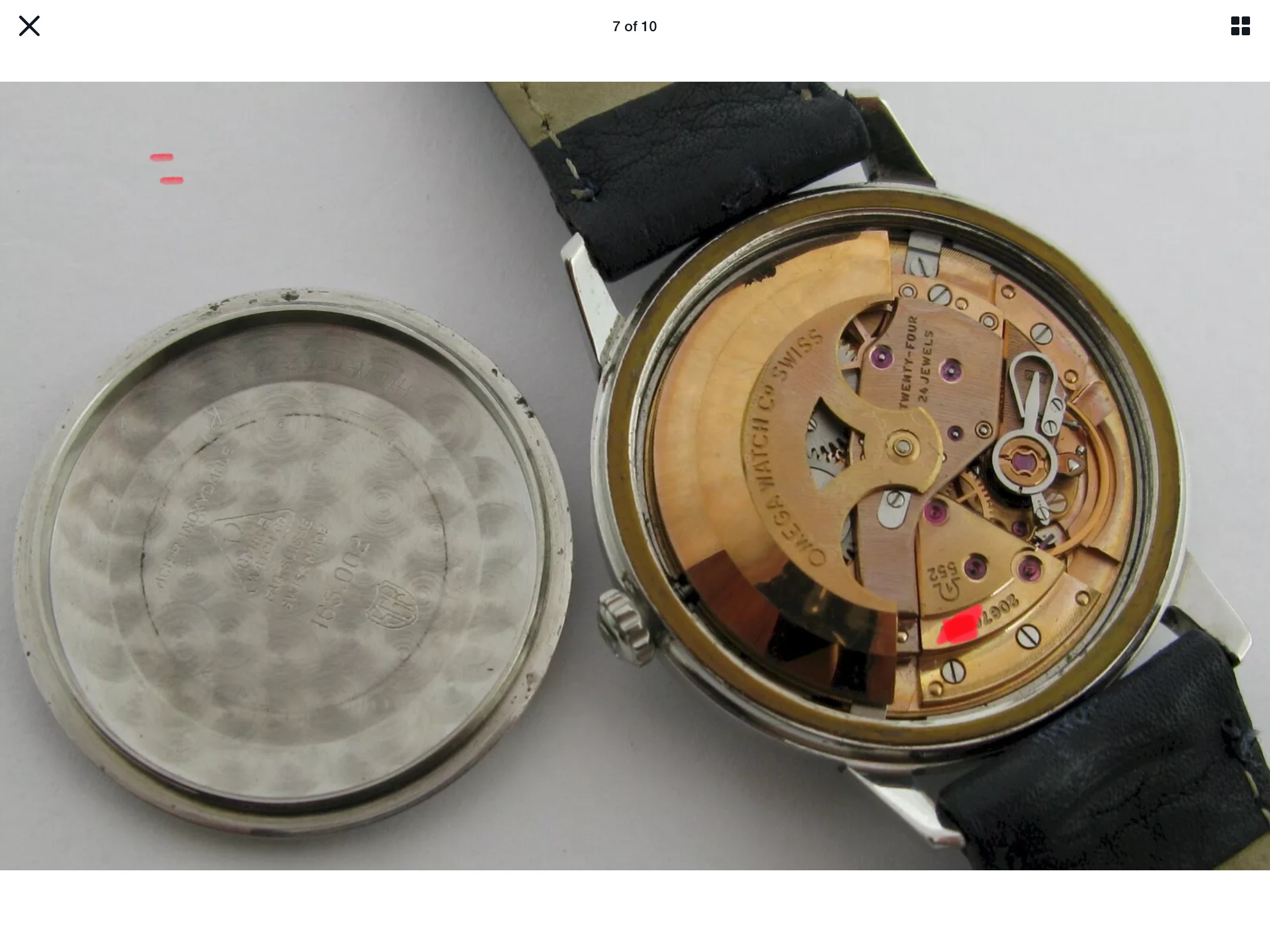

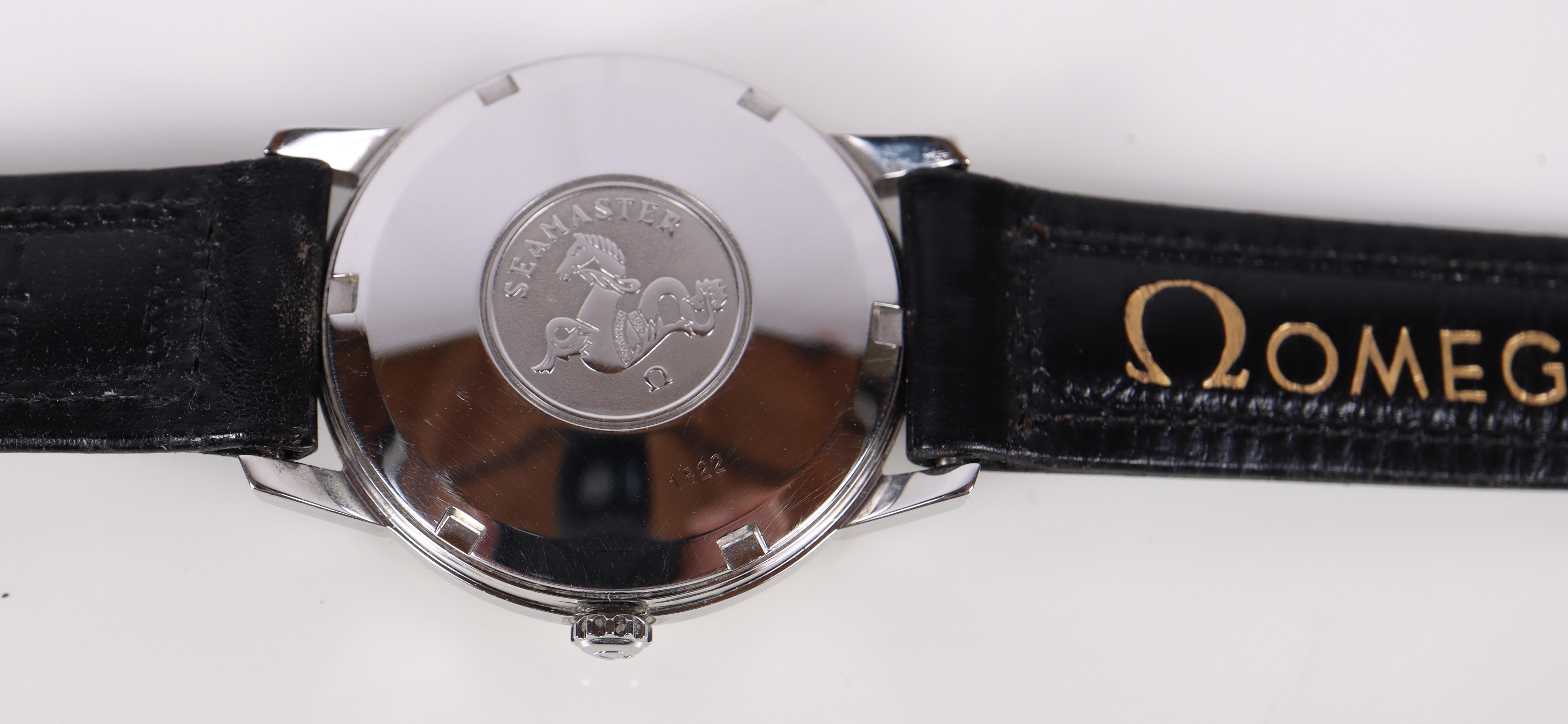

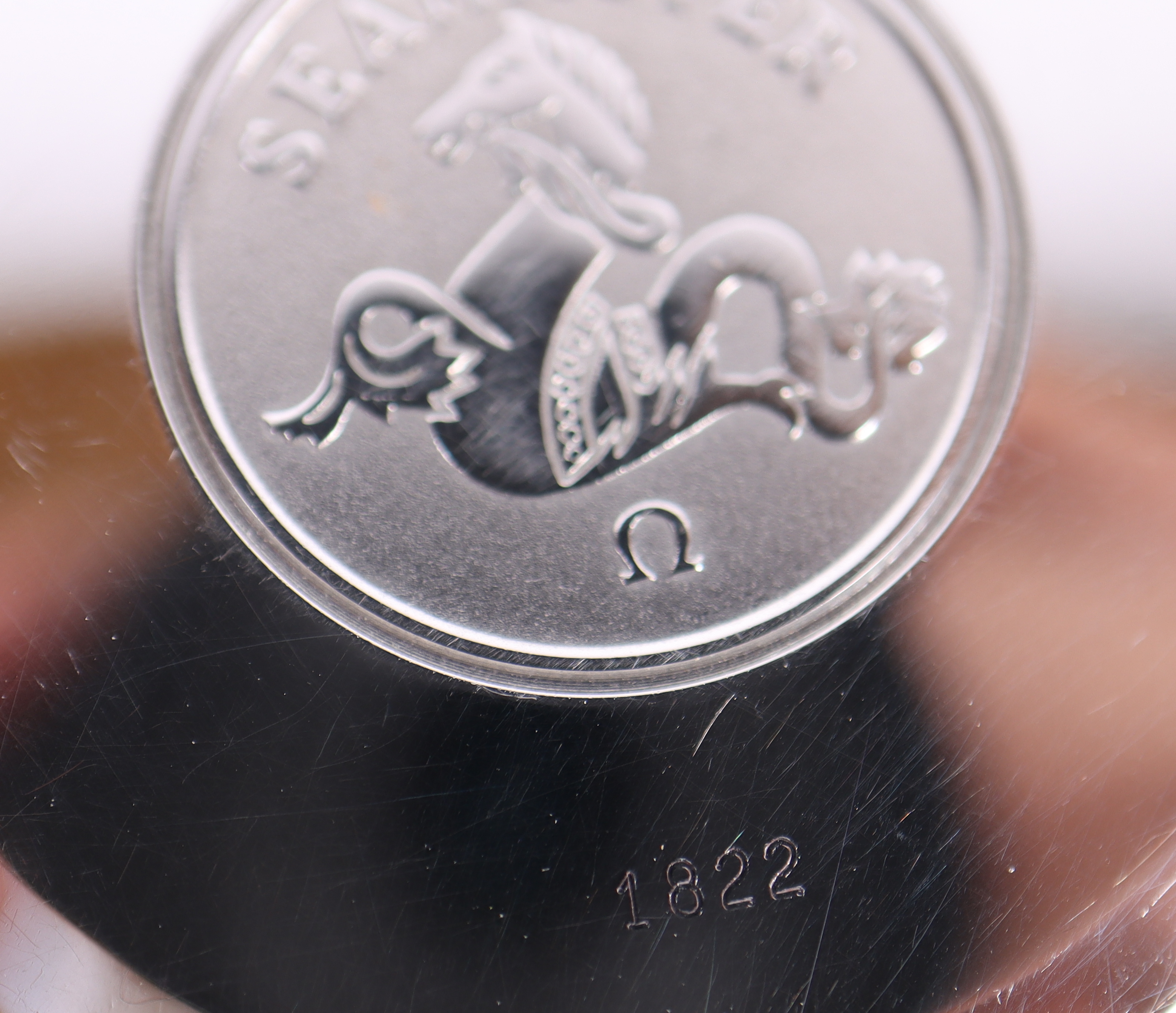

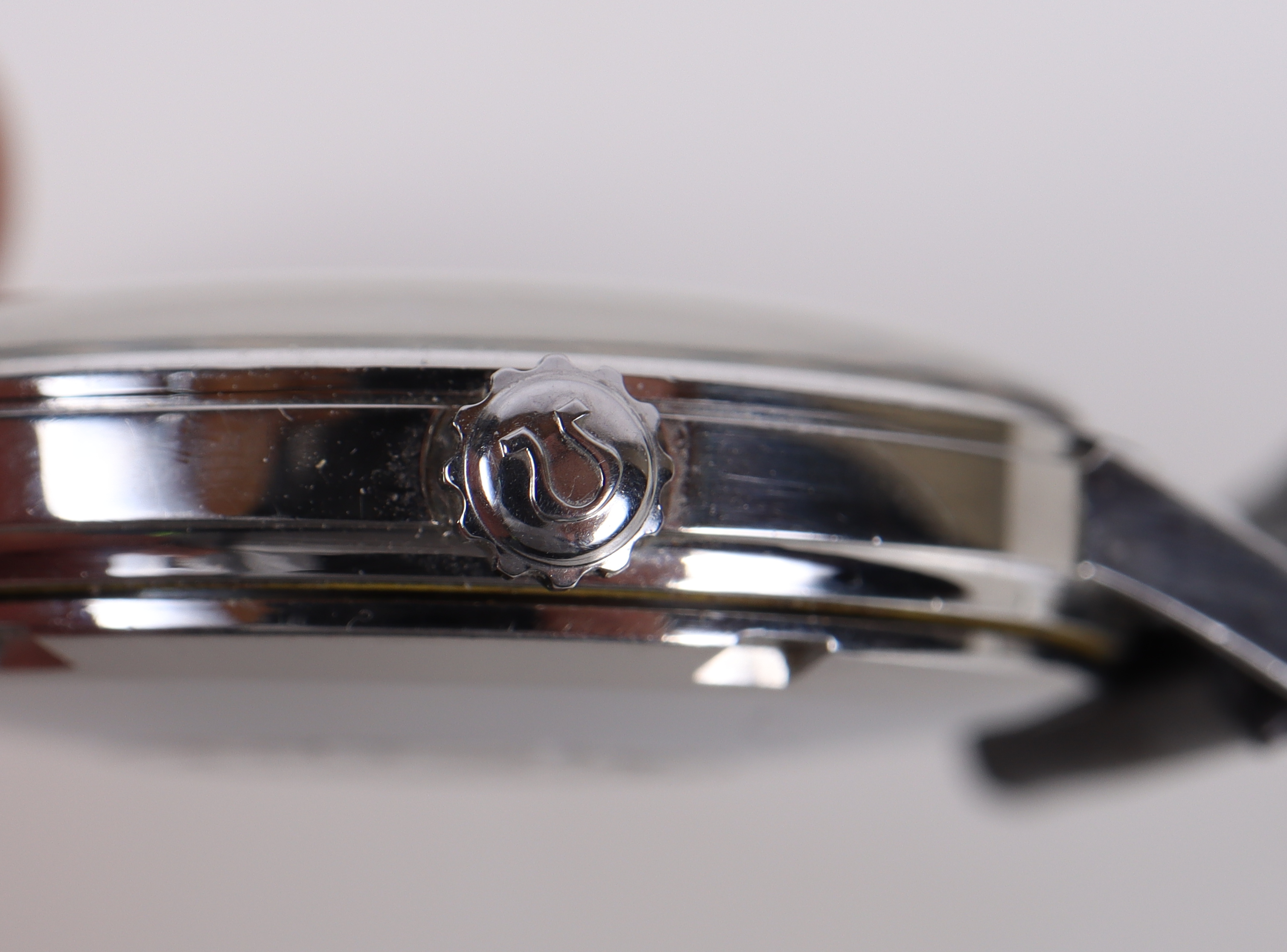

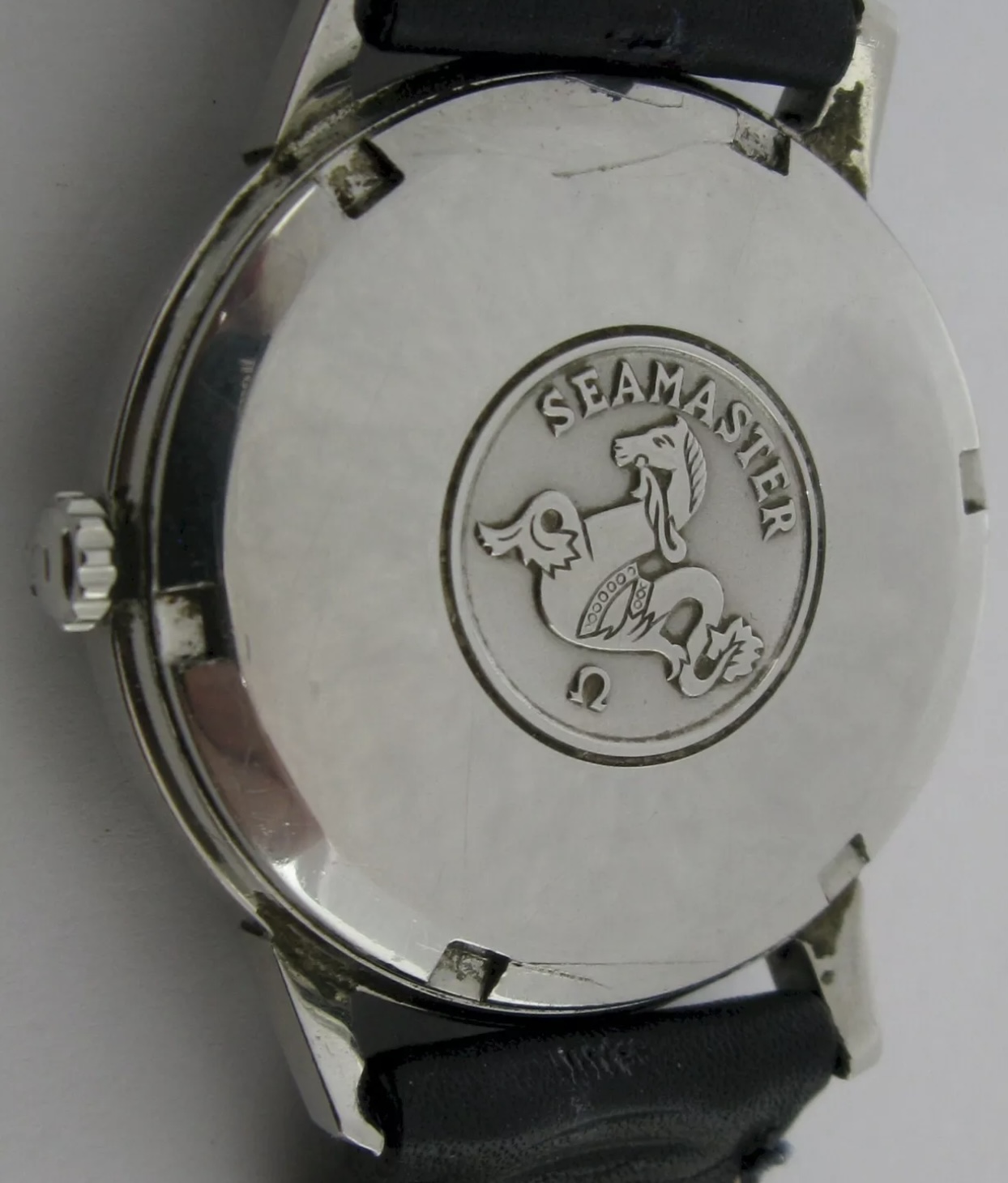

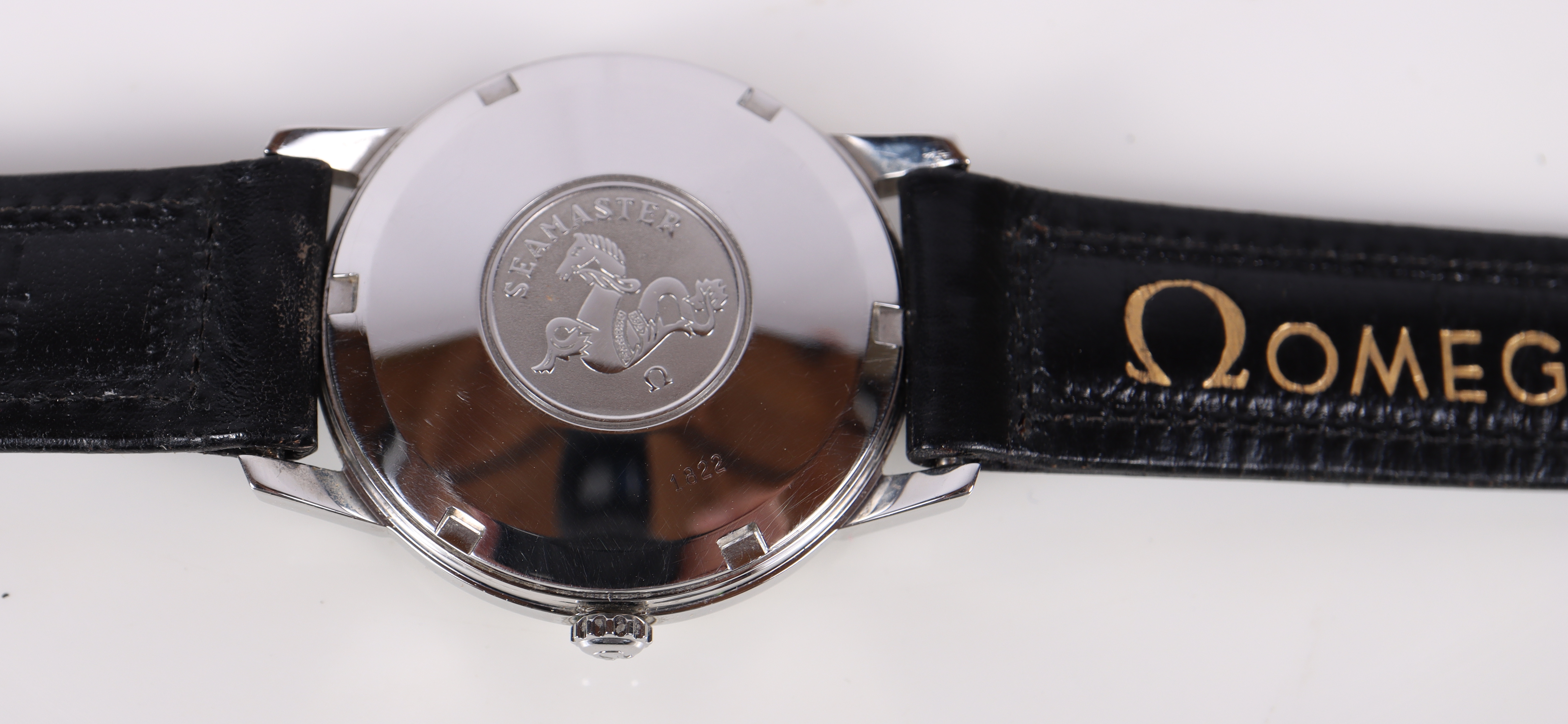

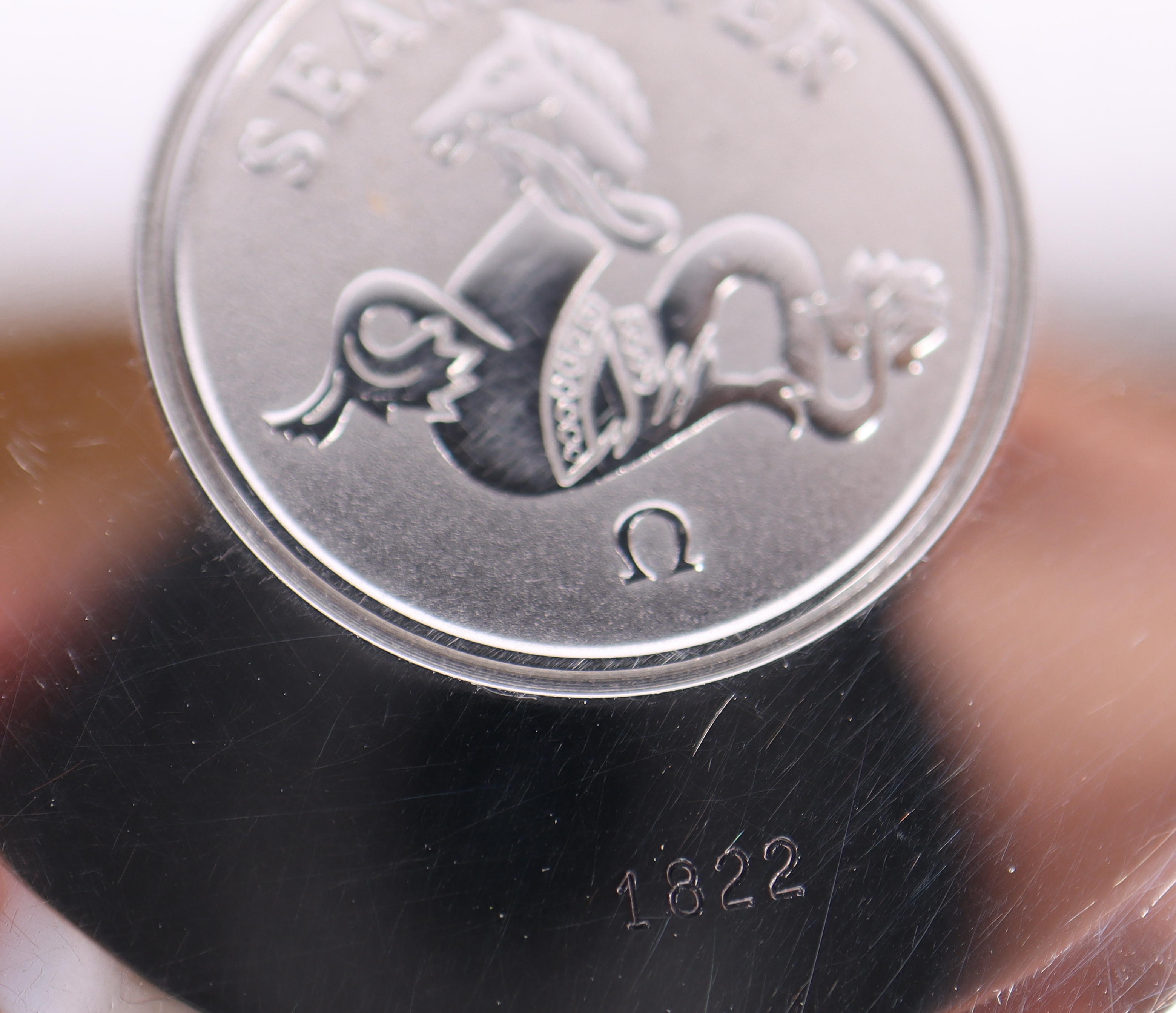

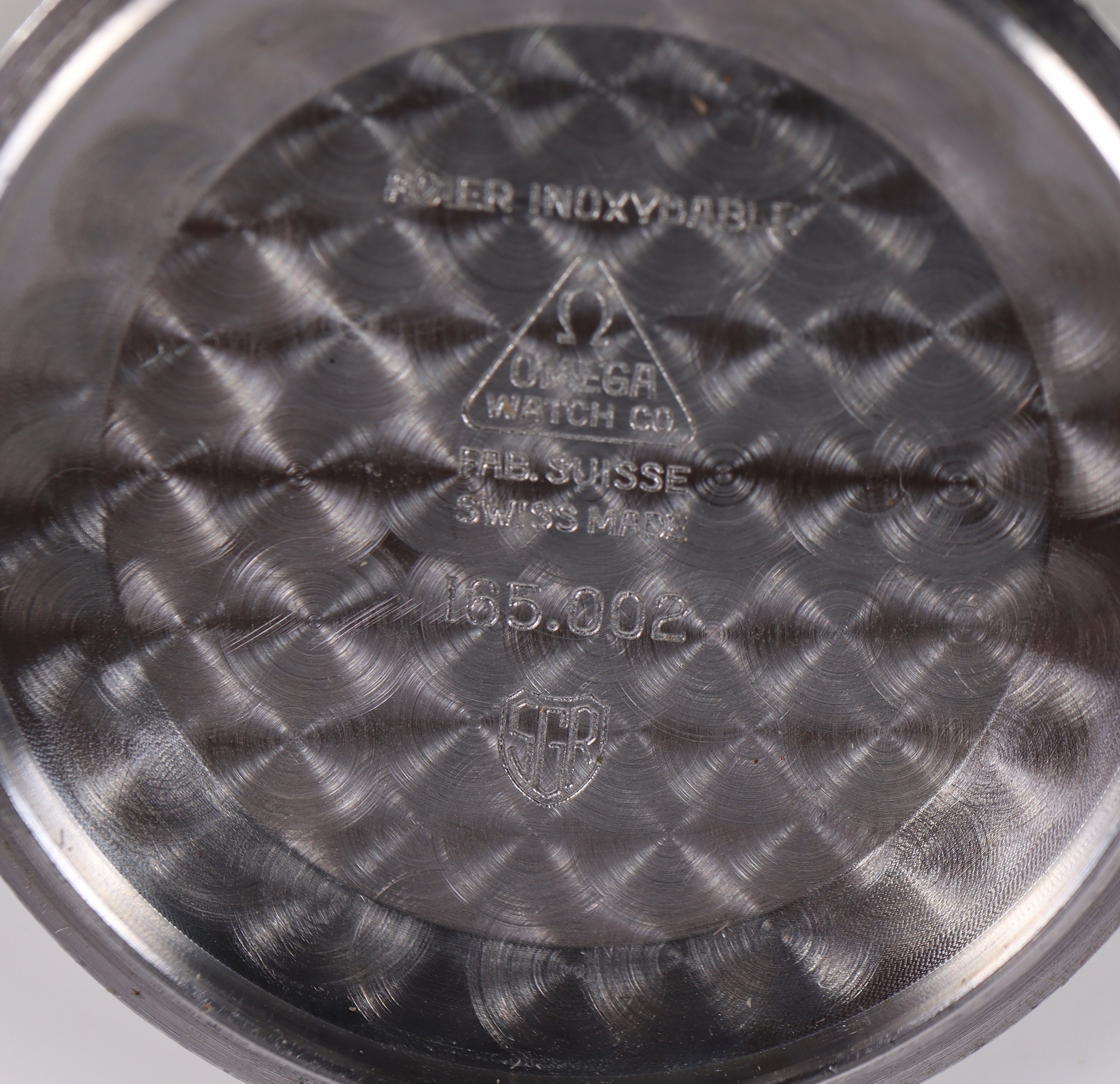

It is the case number - same stamped on the case back and the case itself. I have noticed this on three other examples of these railroad official standard manual wind versions (cal 600 ref 135.005). Each example having a different case number of course - yours being #1388. I just find it interesting and something I personally haven't observed on any other Omega models.

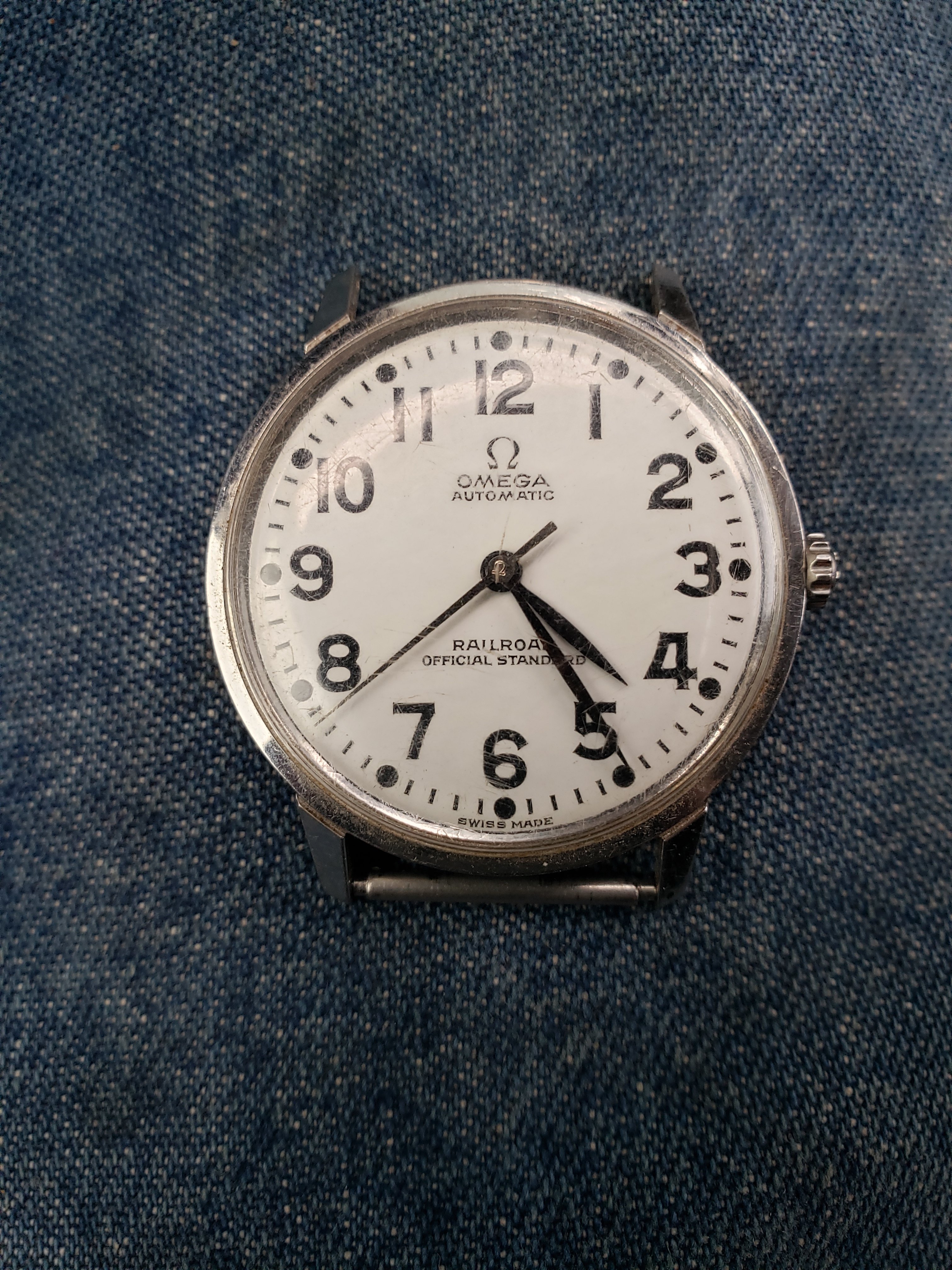

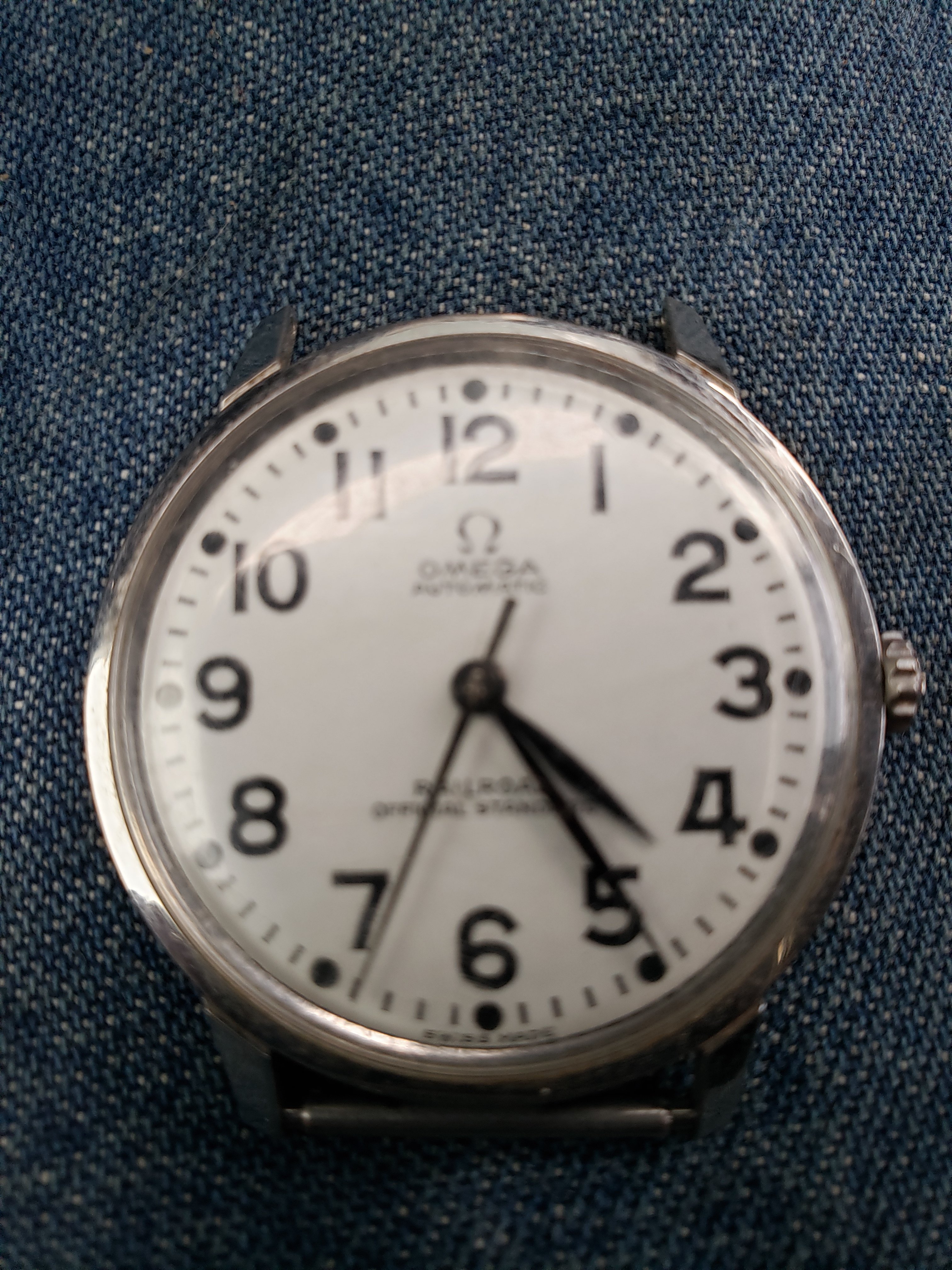

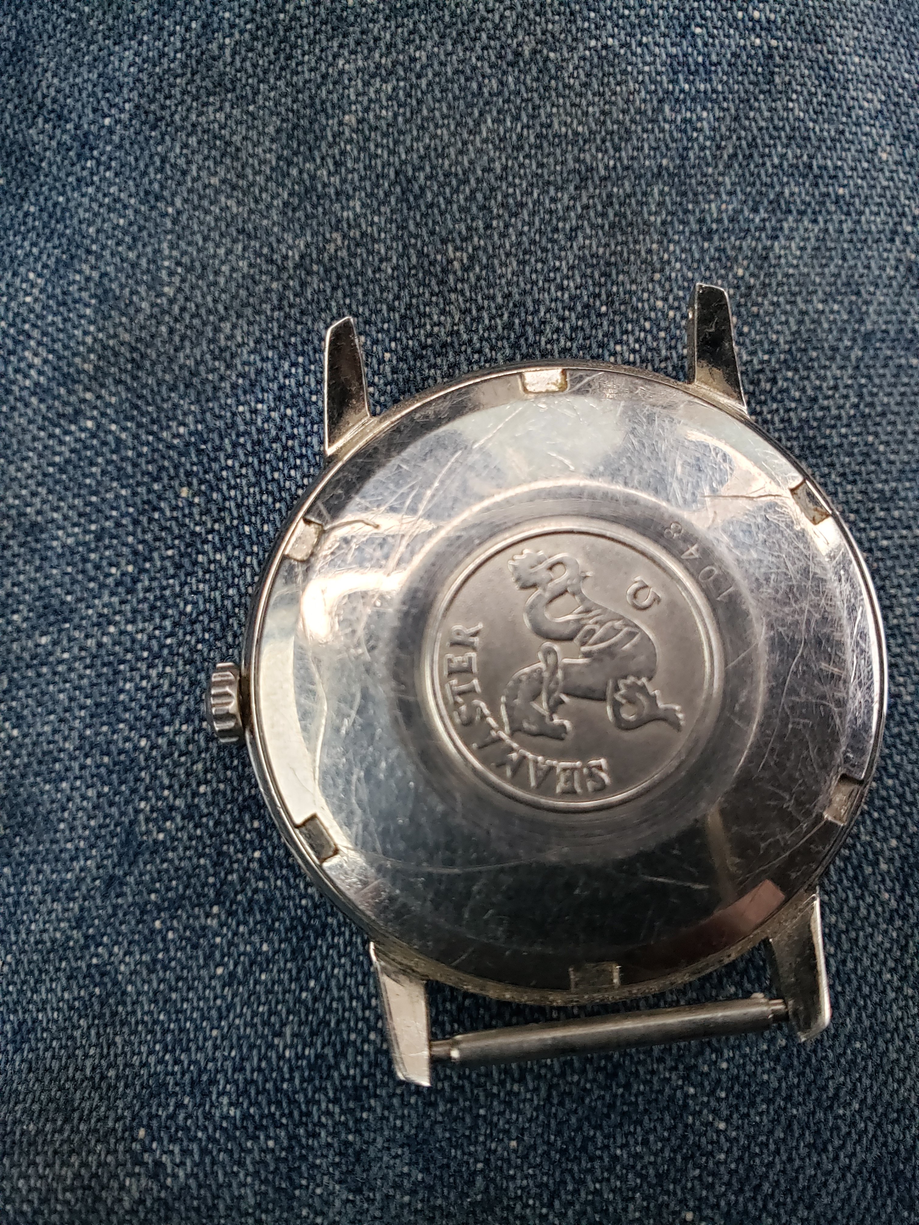

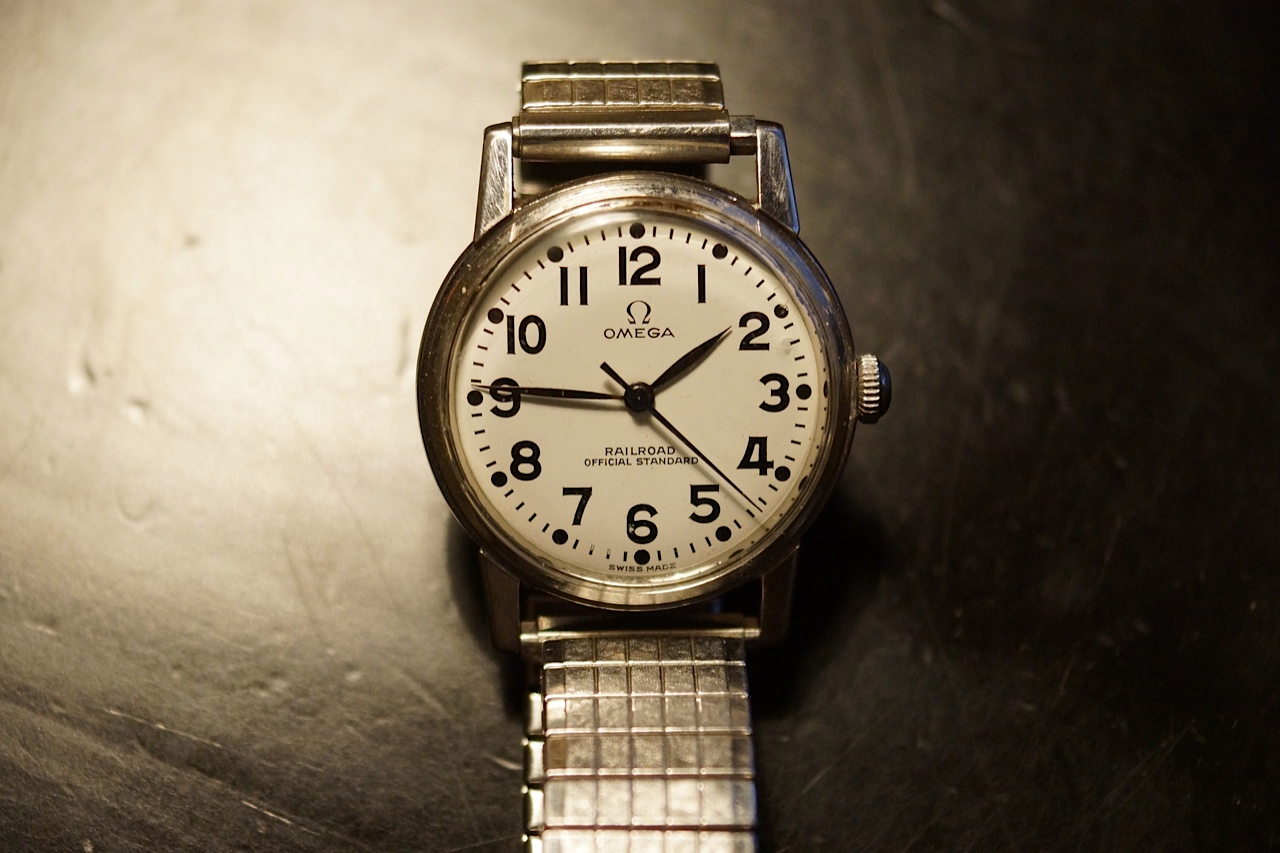

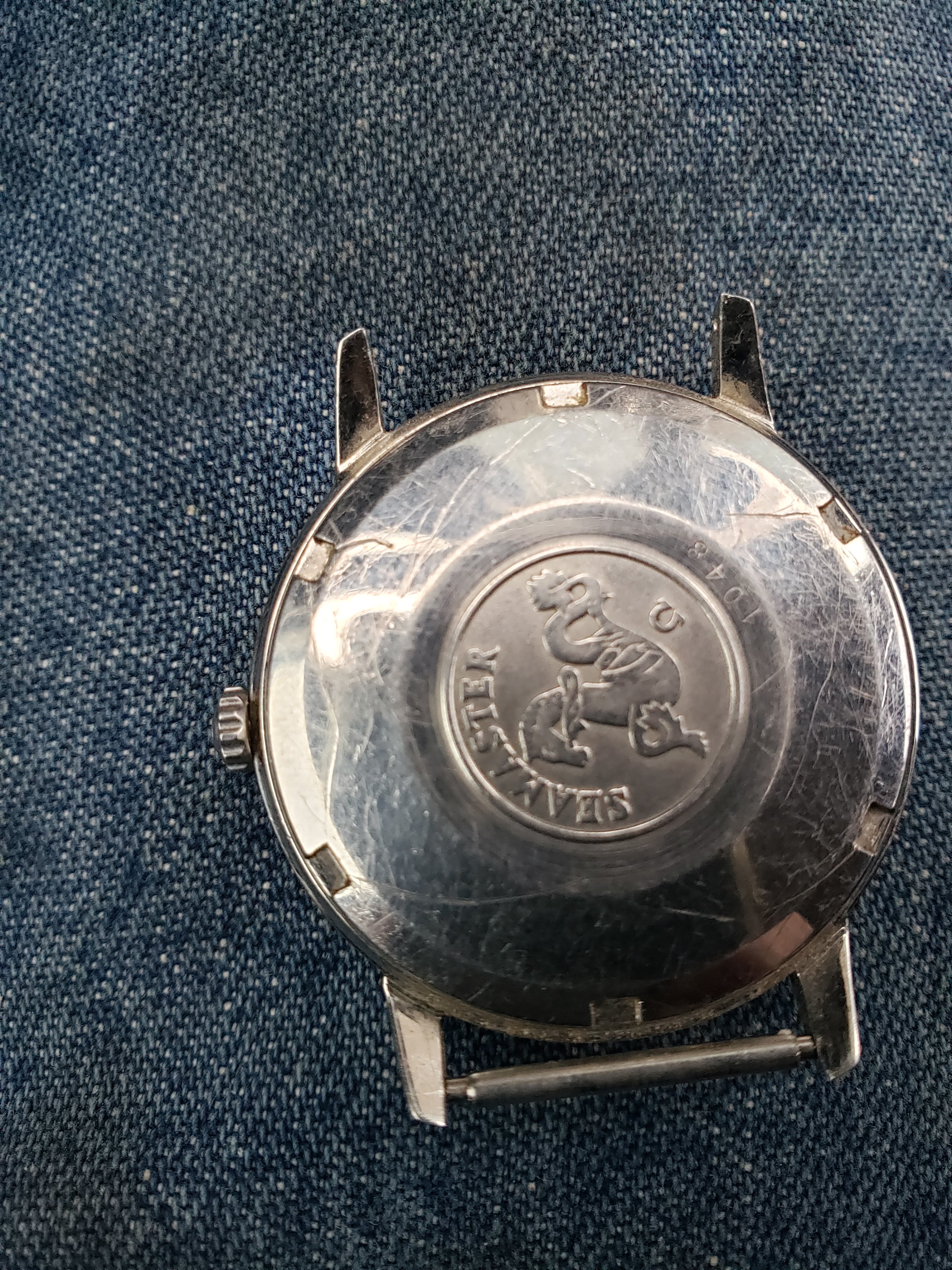

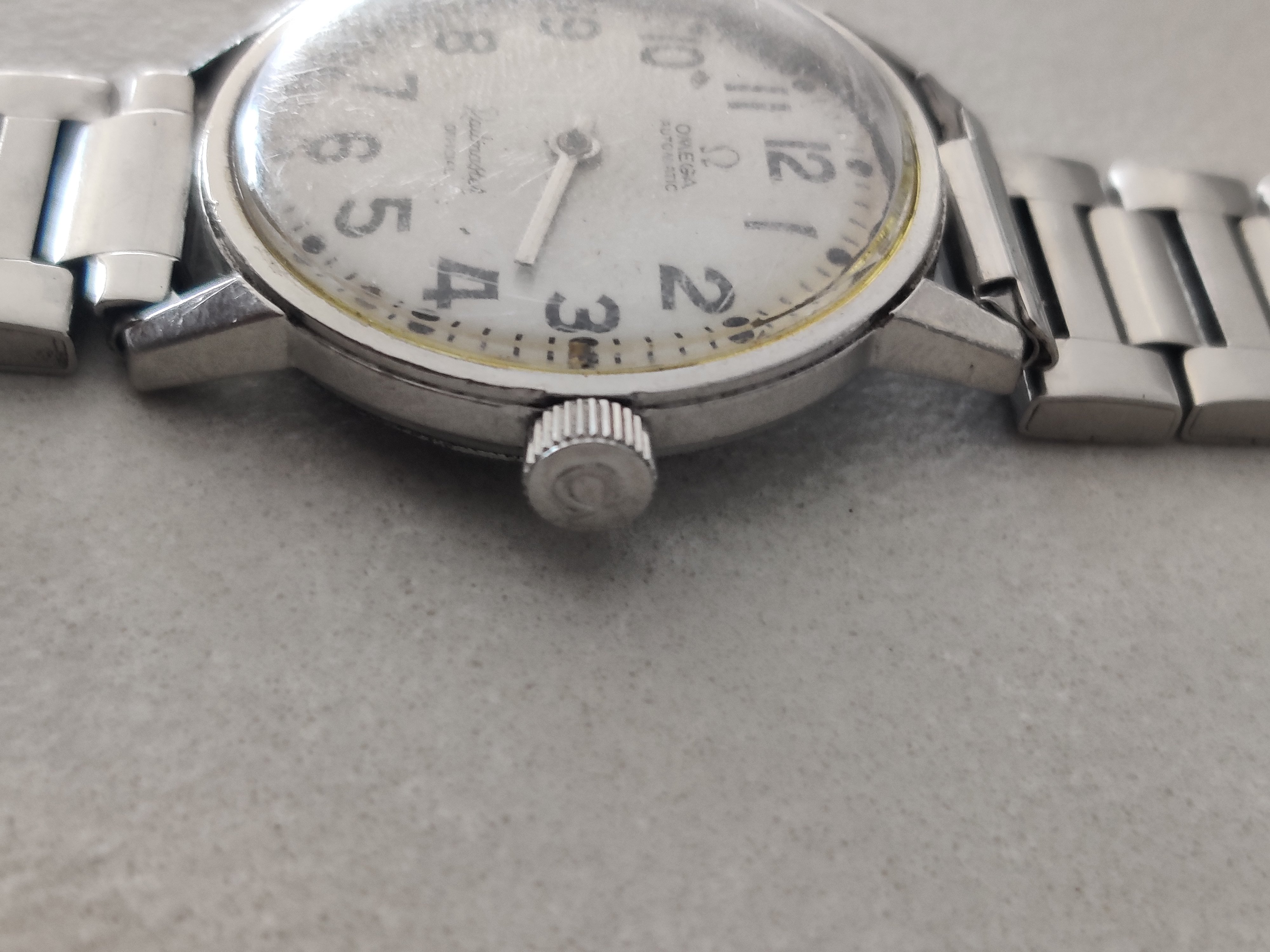

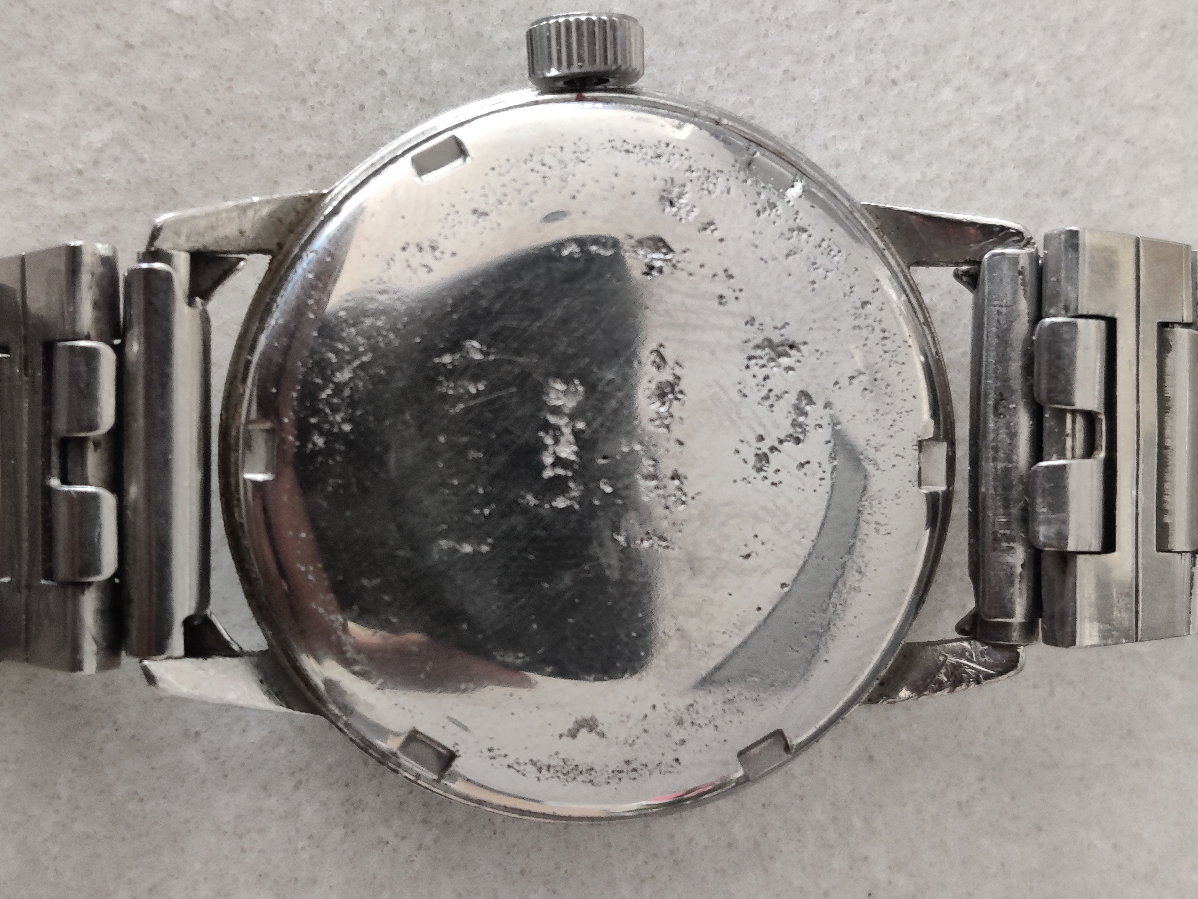

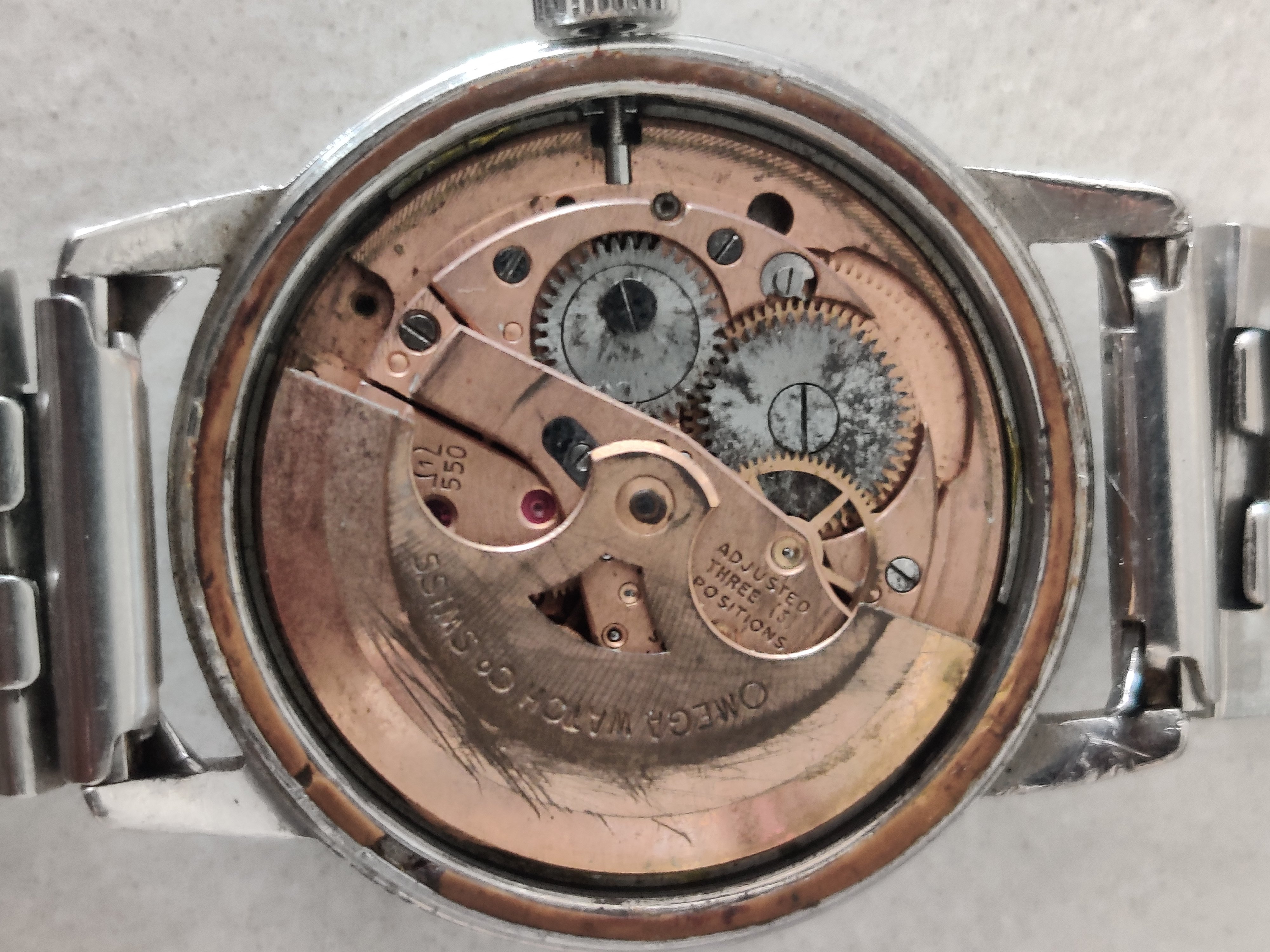

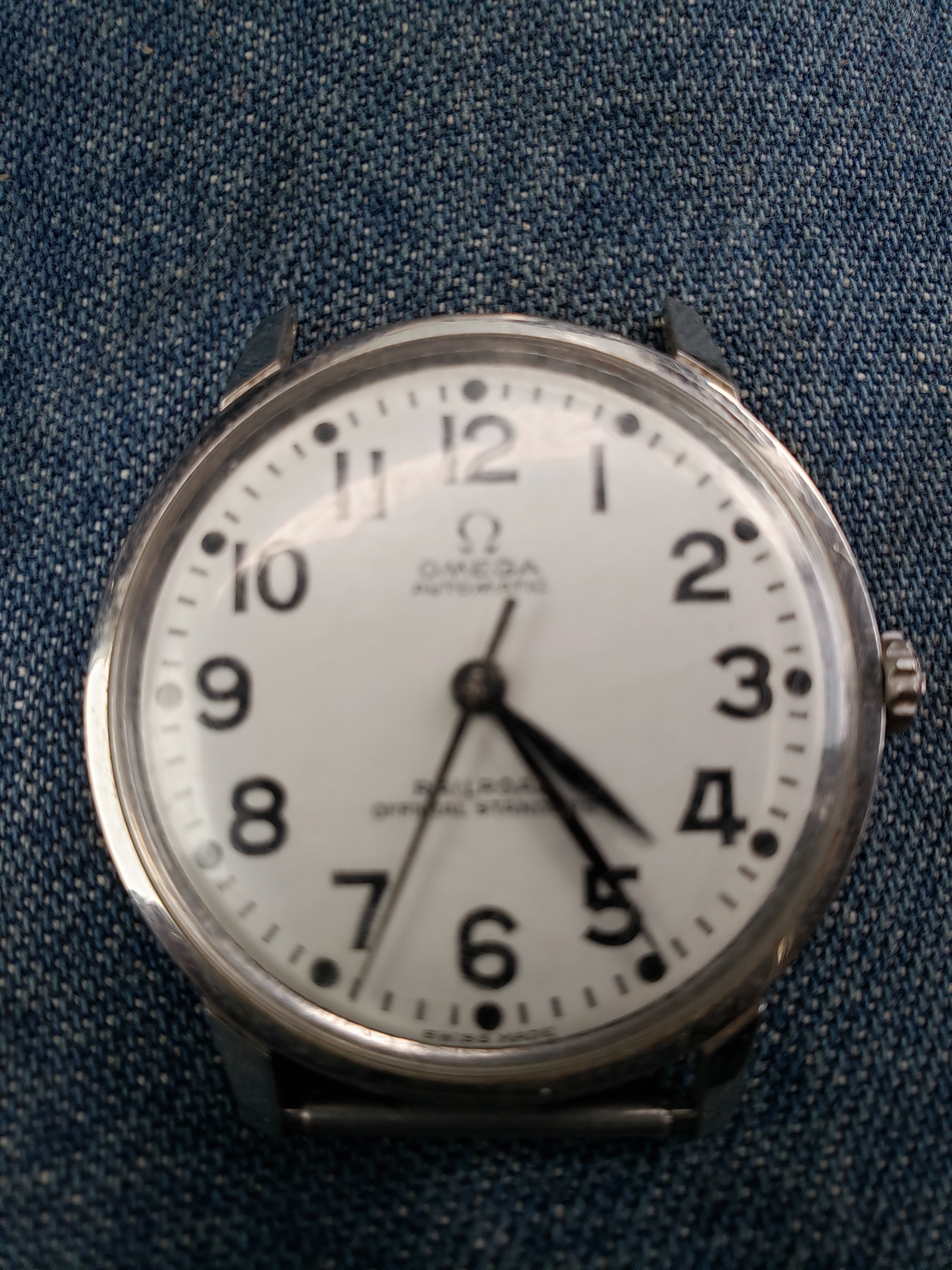

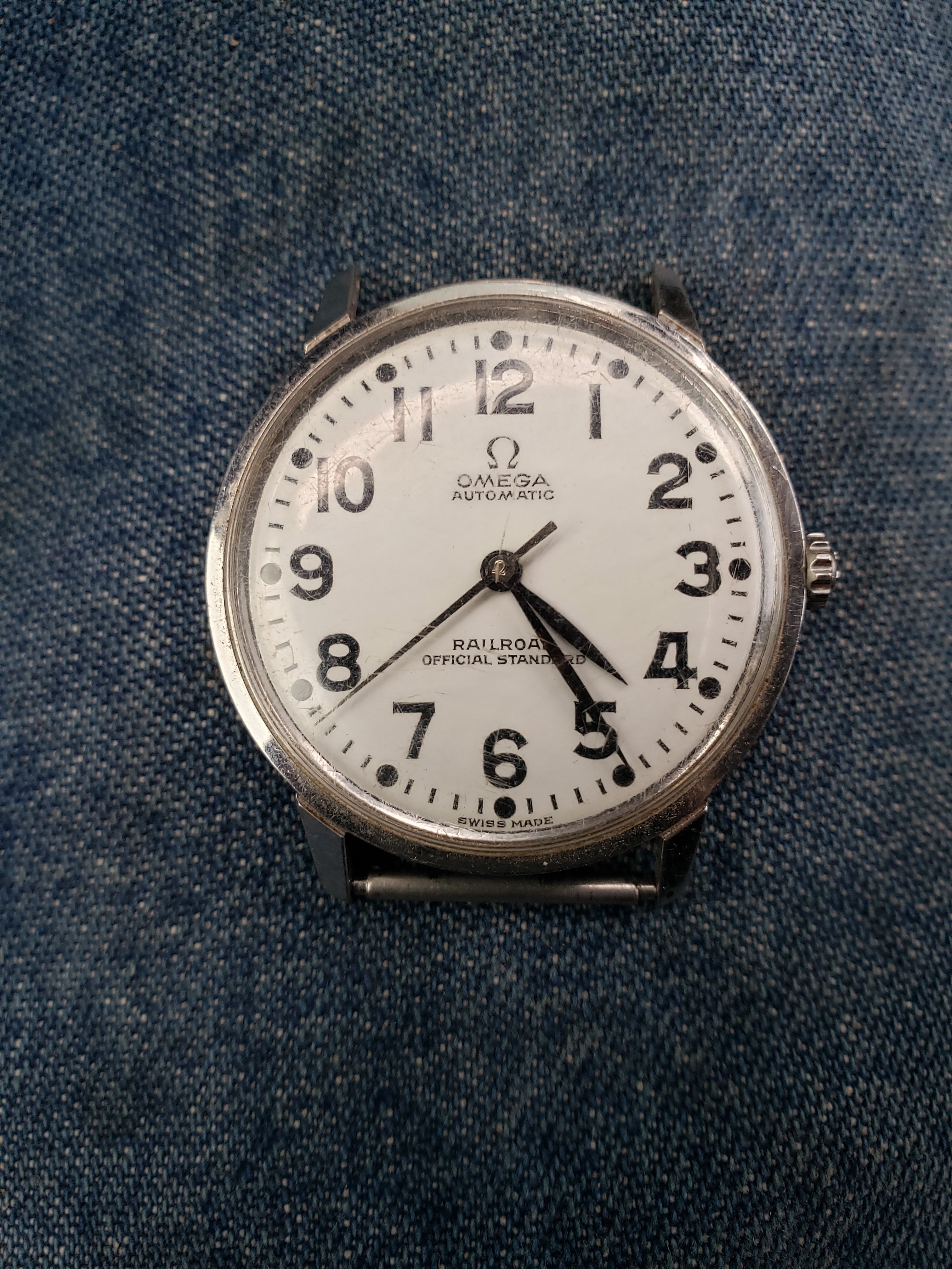

I need help to determine the value of this watch . It has a 550 movement Silver second hand with case number 165.001 its an Railroad official standard . I've worked for BNSF for years but this is first Omega that I've found like this . The back has the raised seamaster on back its not engraved like the other watches I've owned any help is appreciated.

I say, "Very cool". Nice to see an extract at least showing shipped to Canada - first I have seen. And I like the 13 - 24 inner minute circle - you don't see this variant often.

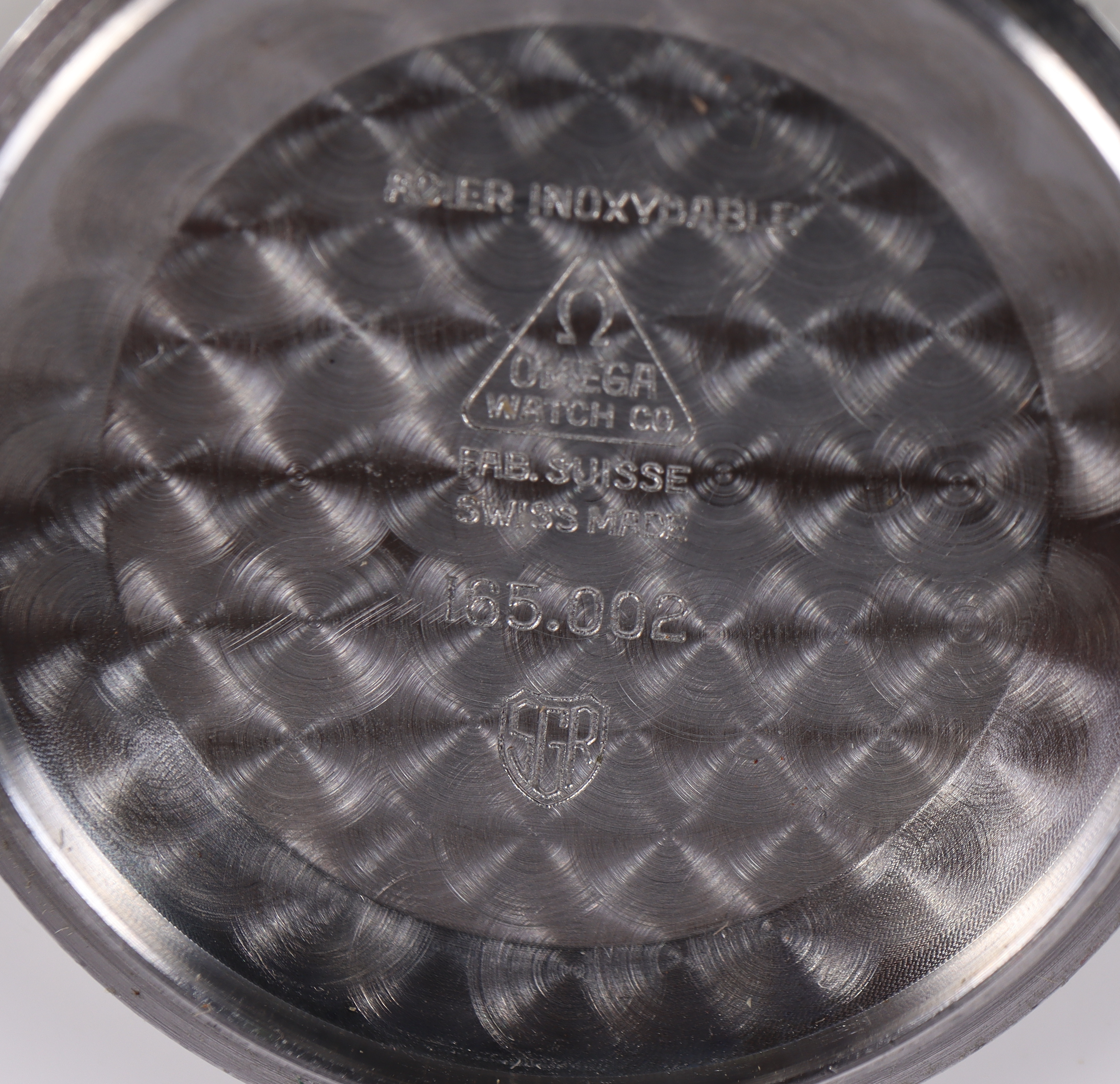

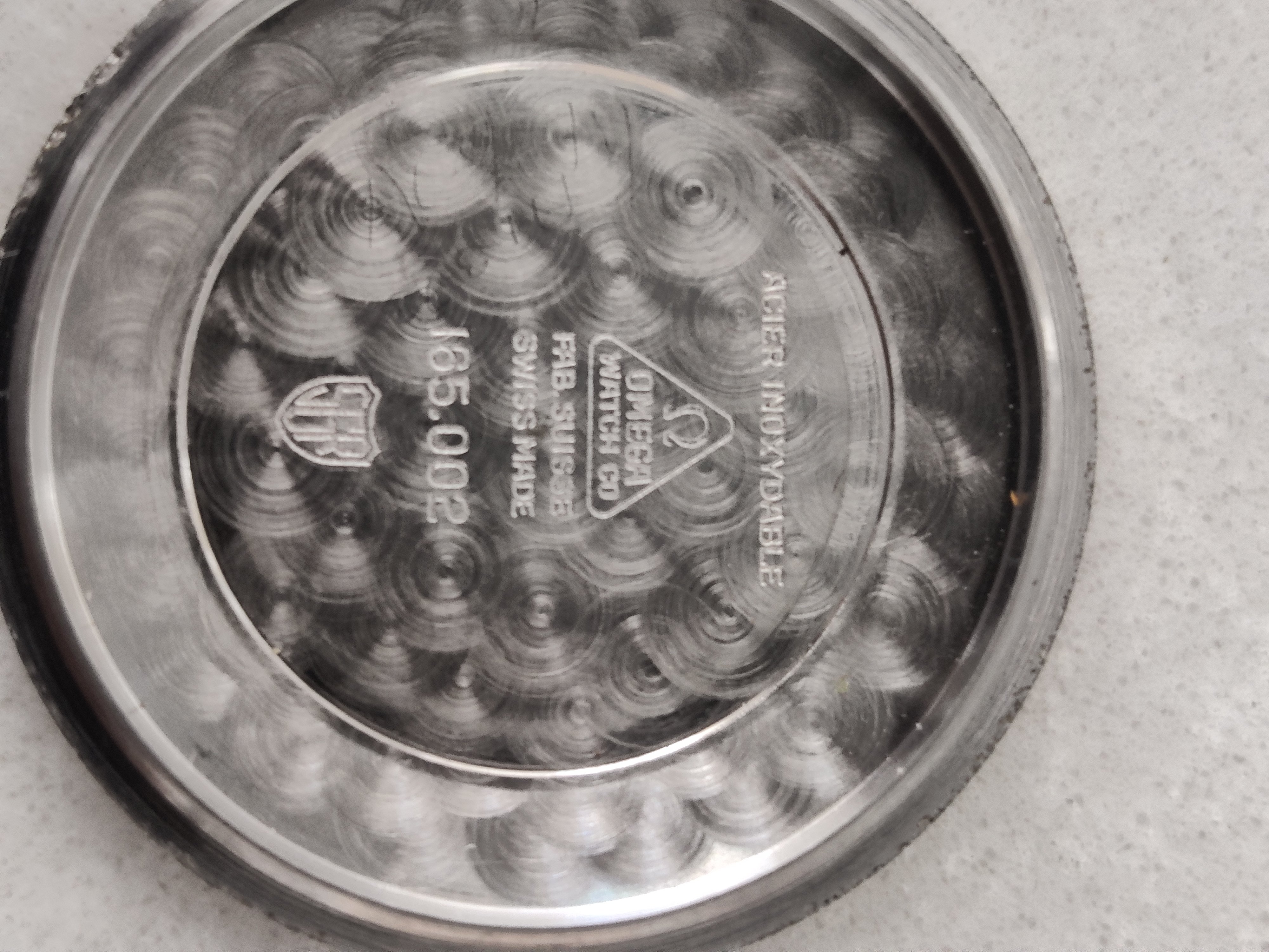

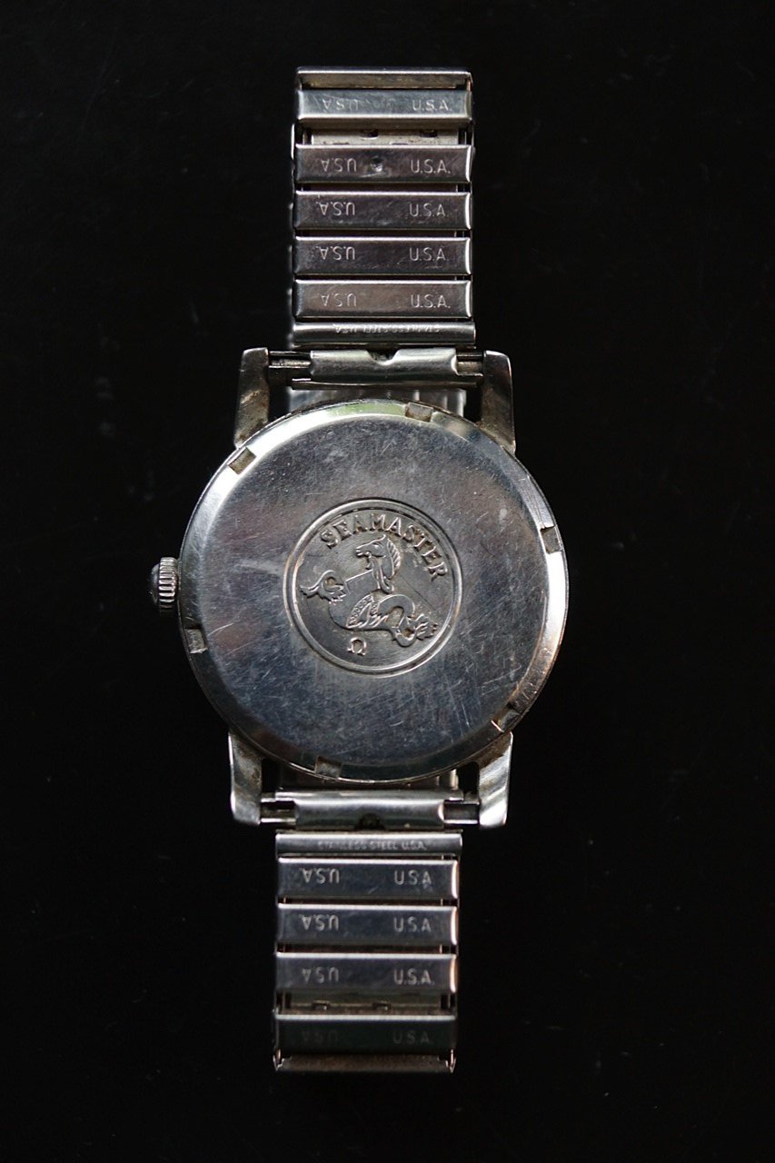

Does this one have a 4 digit case number on the back? ...and/or possibly between the lower lugs?
5,861
16,802

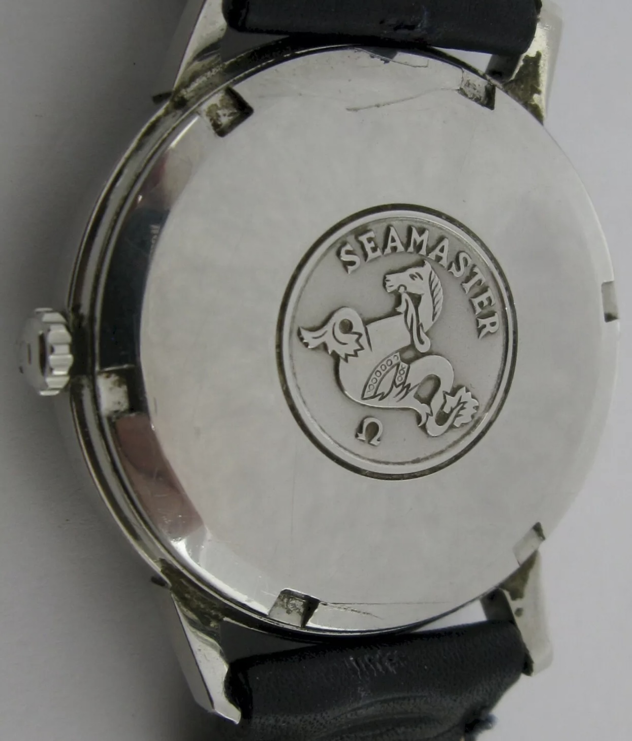

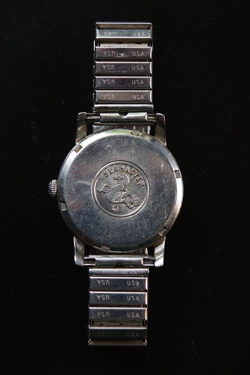

Unlike my 165.070 Railmaster (USA) and 165.001 Railroad Official Standard (USA) , which have 4 digit case back codes, this 165.002 does not have any case engravings other than “Seamaster”.

That dial is nice, which I’ve never seen before! The 13-24 inner track is actually military time...13:00hrs is 1:00pm, etc....

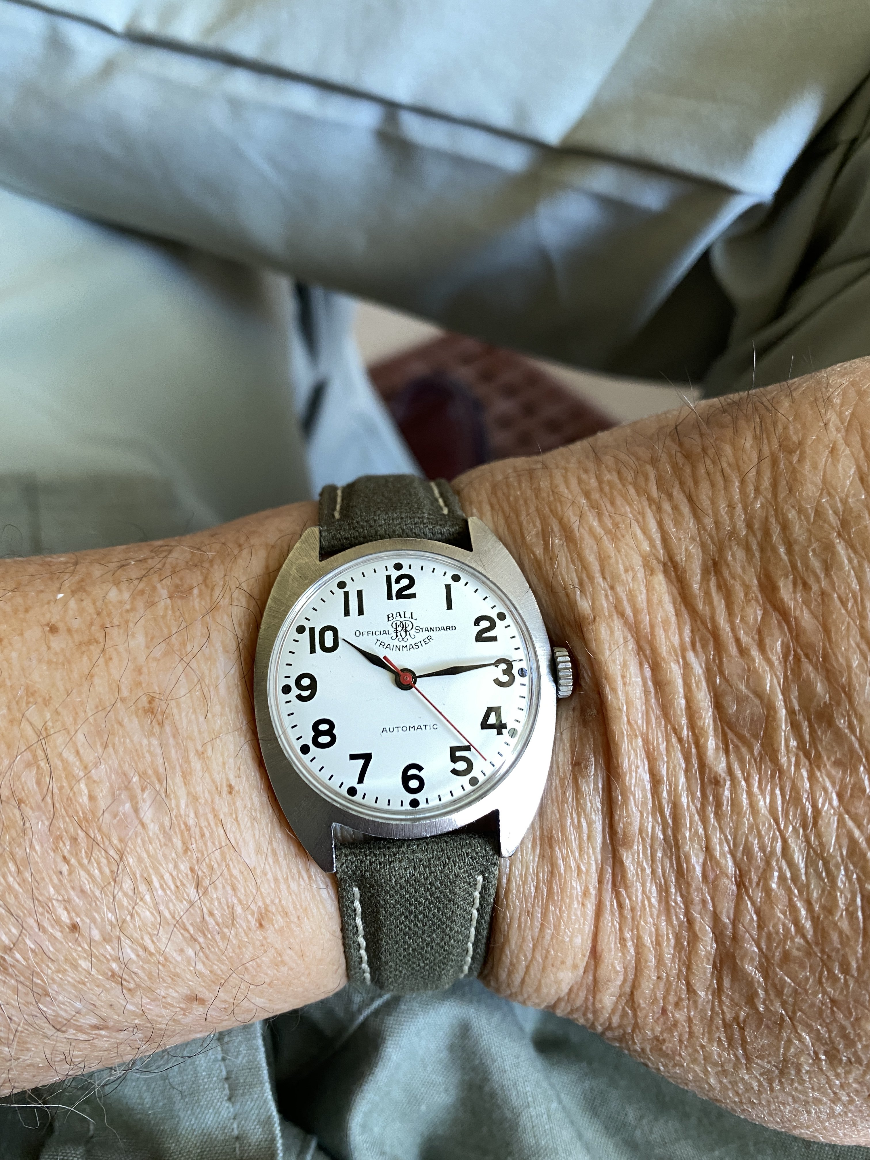

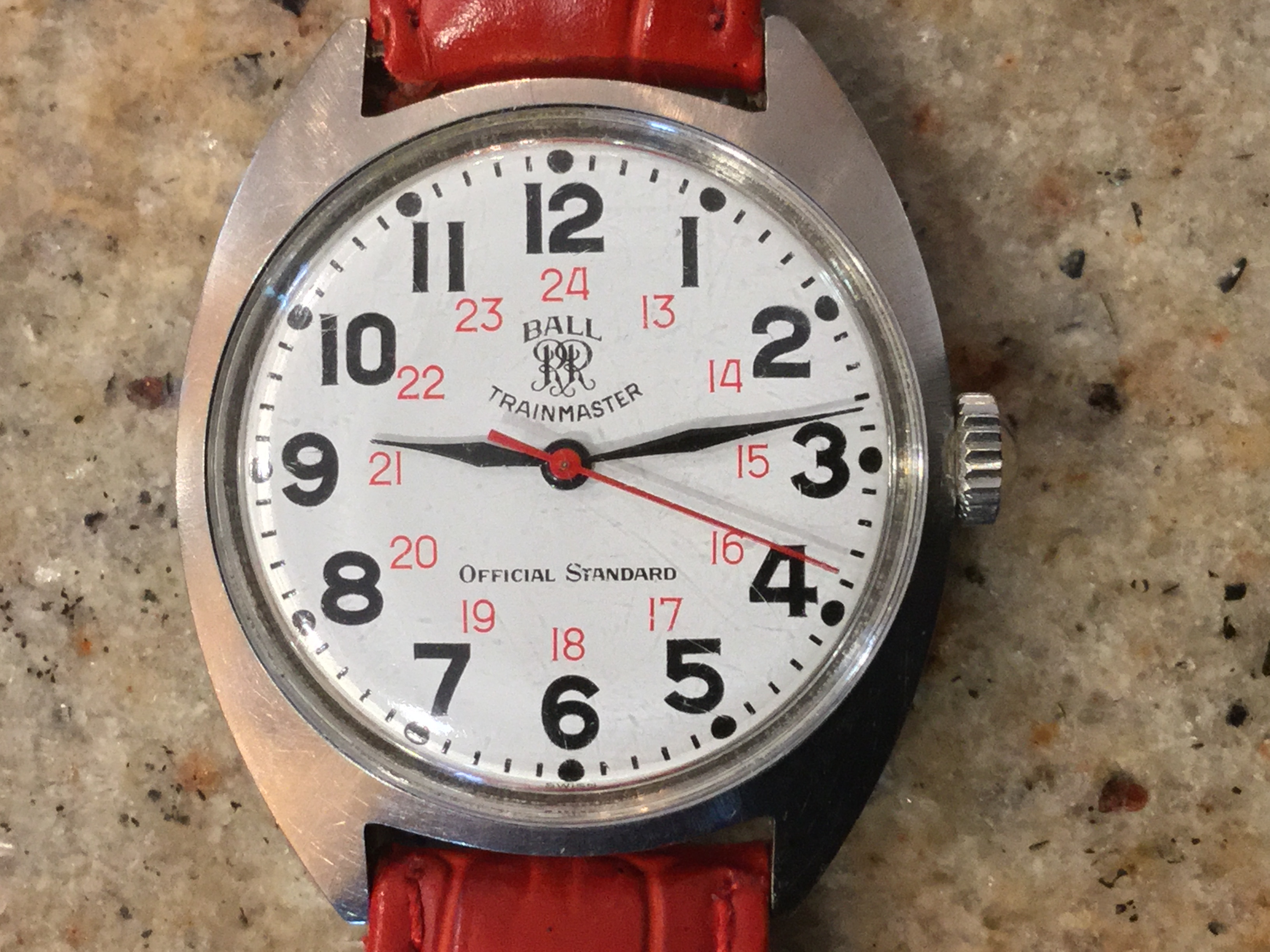

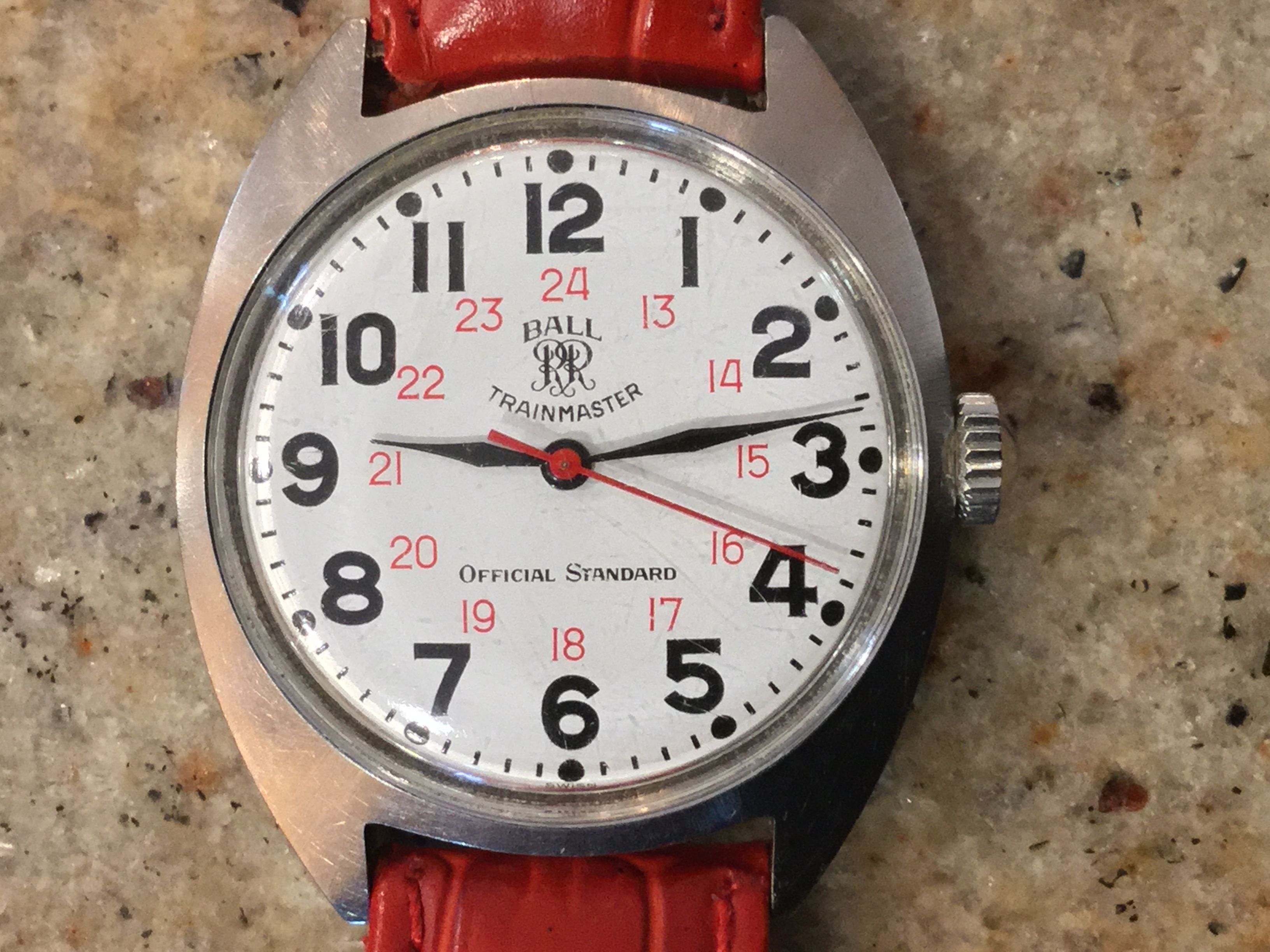

Omega may have “borrowed” this dial format from others. In the 1960’s, Ball Watch Company sued Omega and Omega was required to end Railroad Official Standard production

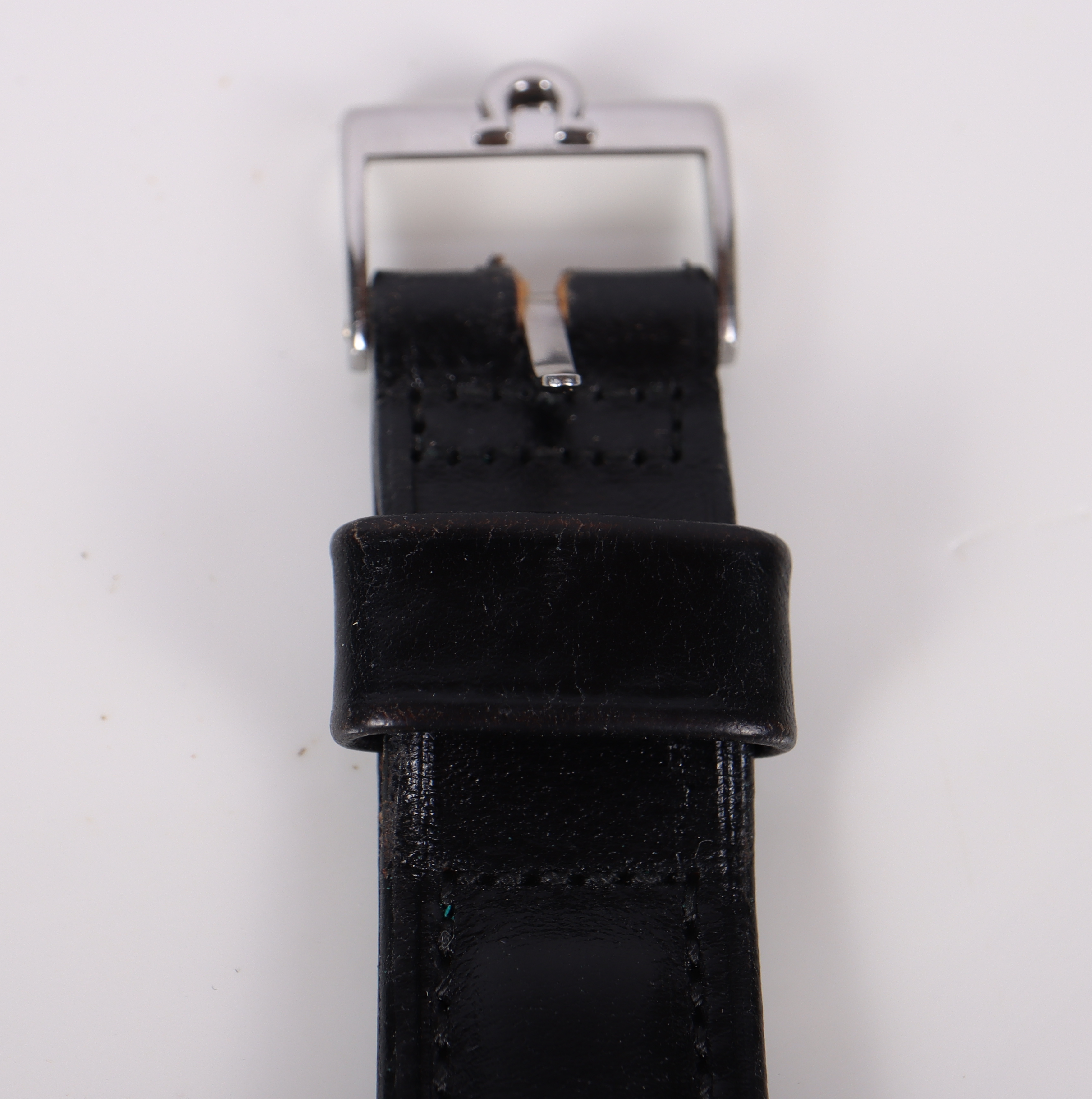

Does anyone have any recommendations on where I can take my vintage Omega 500 Railroad Official Standard in Dallas for clean & service. Also interested in replacing the bracelet with original design. Does anyone know which braclet / size came with this model? Thanks in advance!

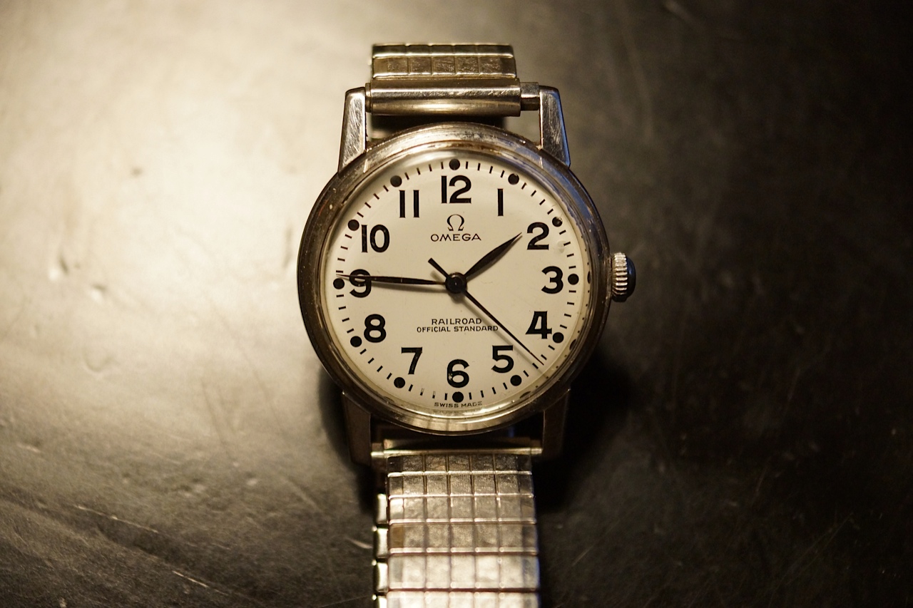

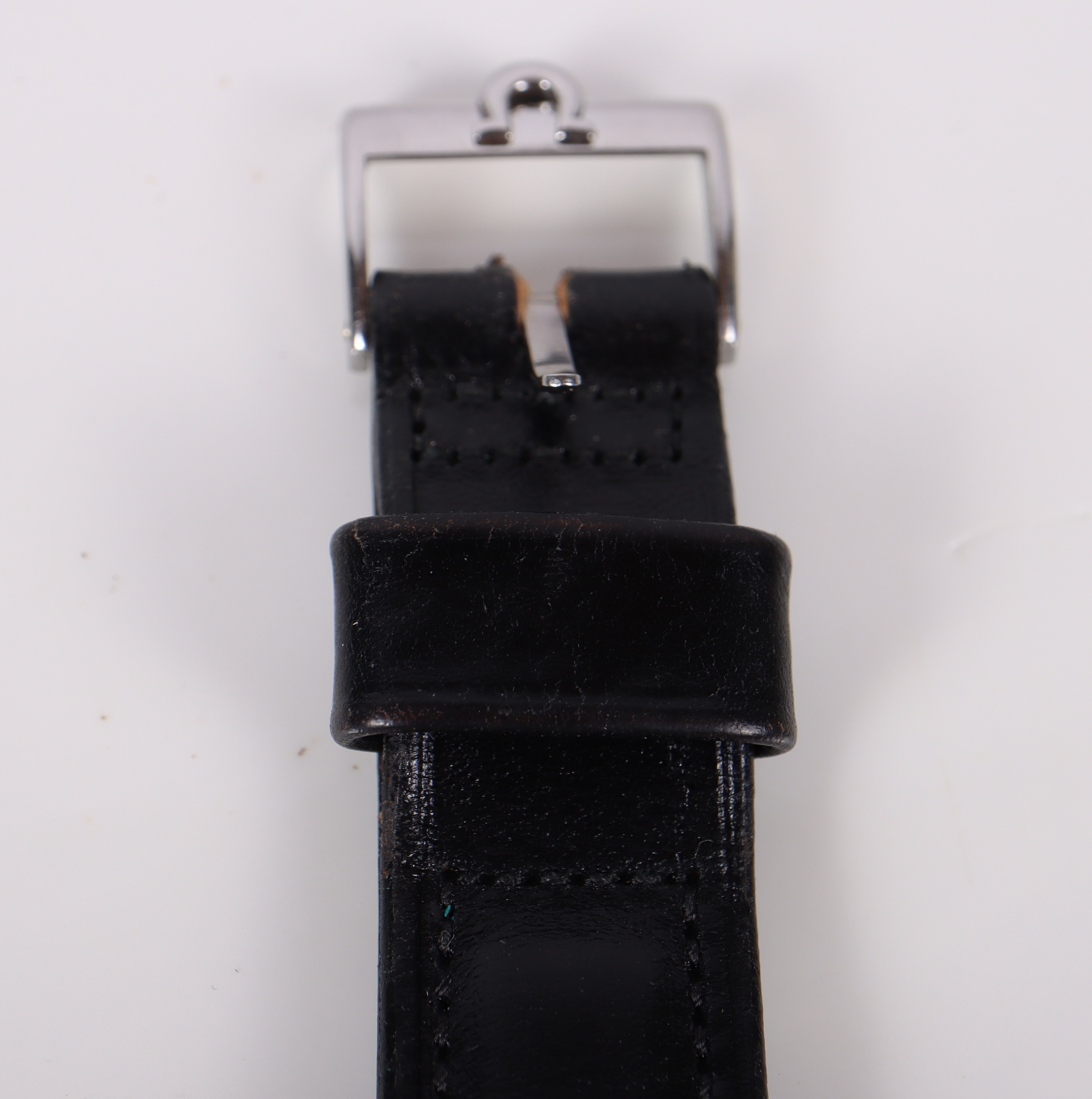

I think the RR Official Standard was originally sold with a leather strap. The lugs are rather thin and not the meaty variety you usually see with bracelet. OJTT pics show a fitted strap. My extract for both a 165.001 and 165.002 do not indicate any original bracelet.

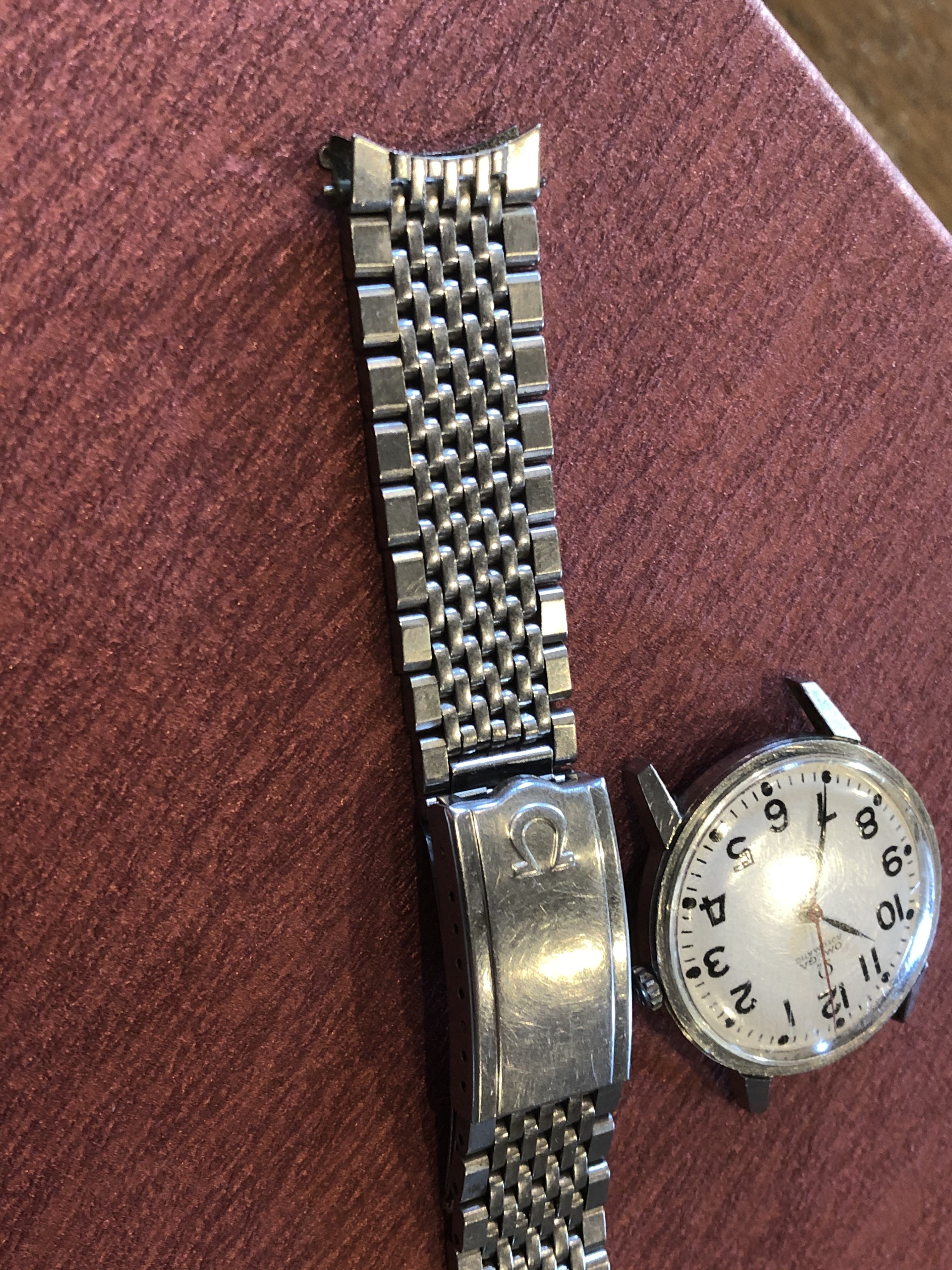

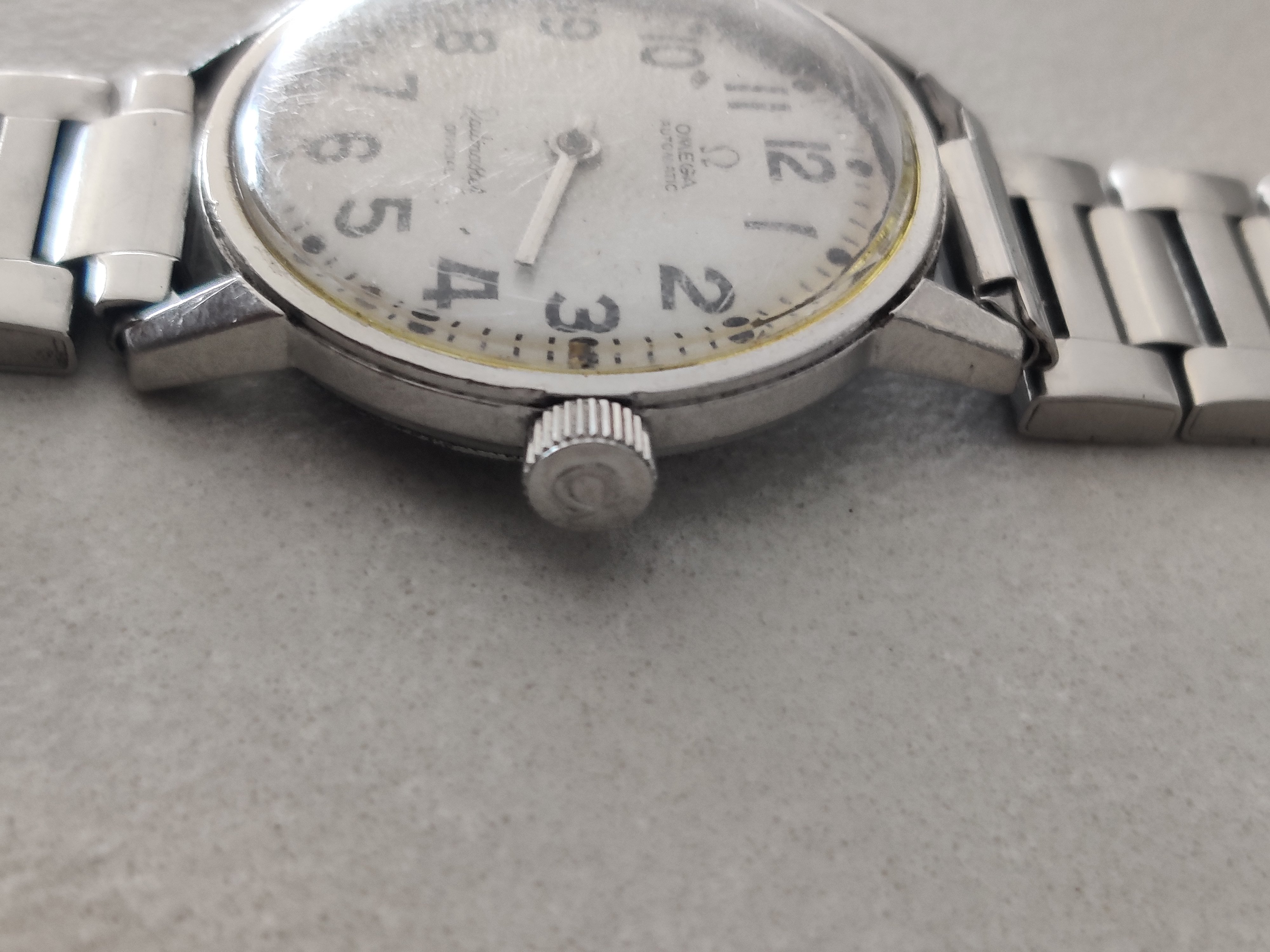

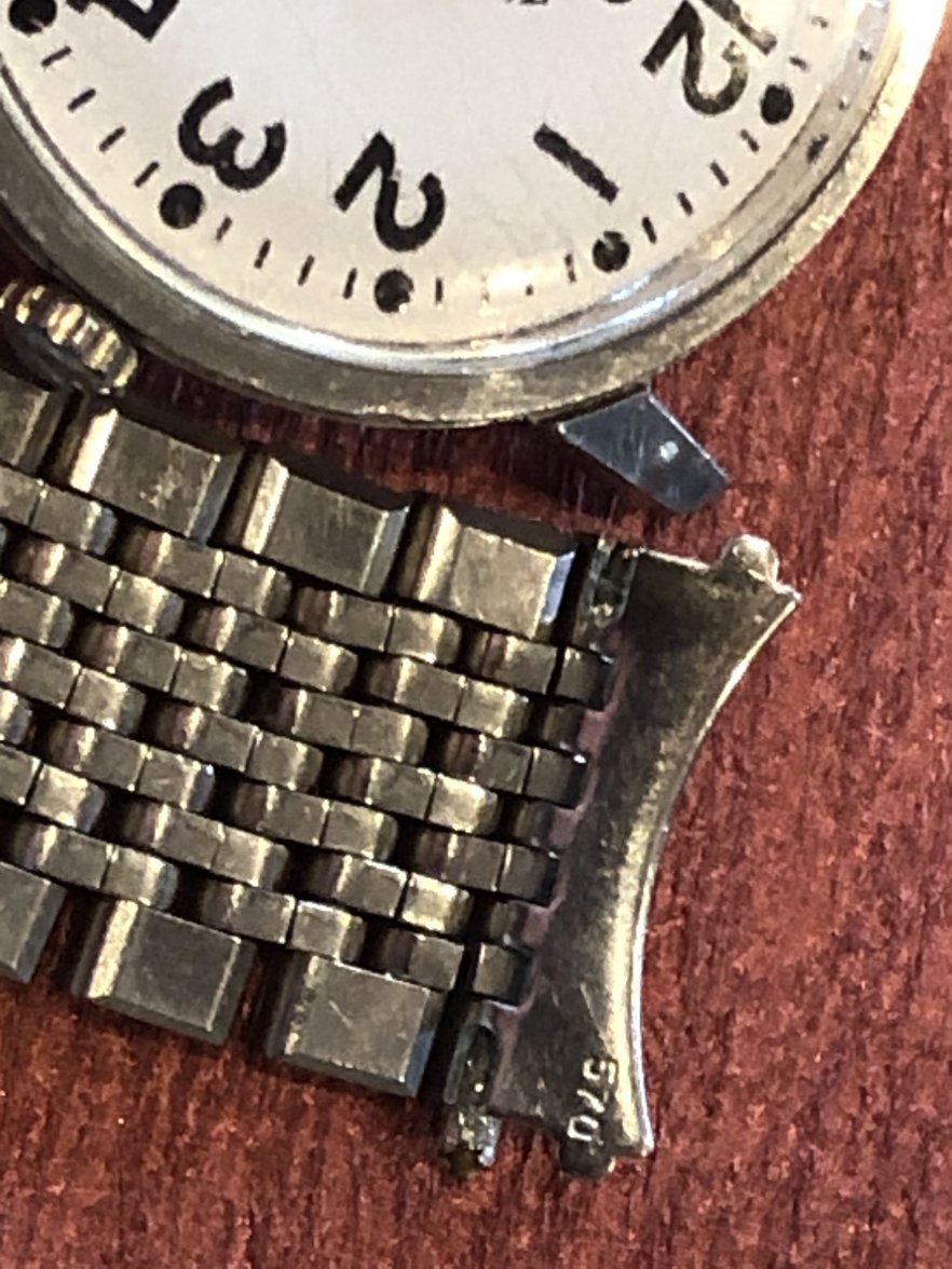

ATSF Dan's watch is most likely case ref 135.005 and I agree was most likely sold with leather strap.

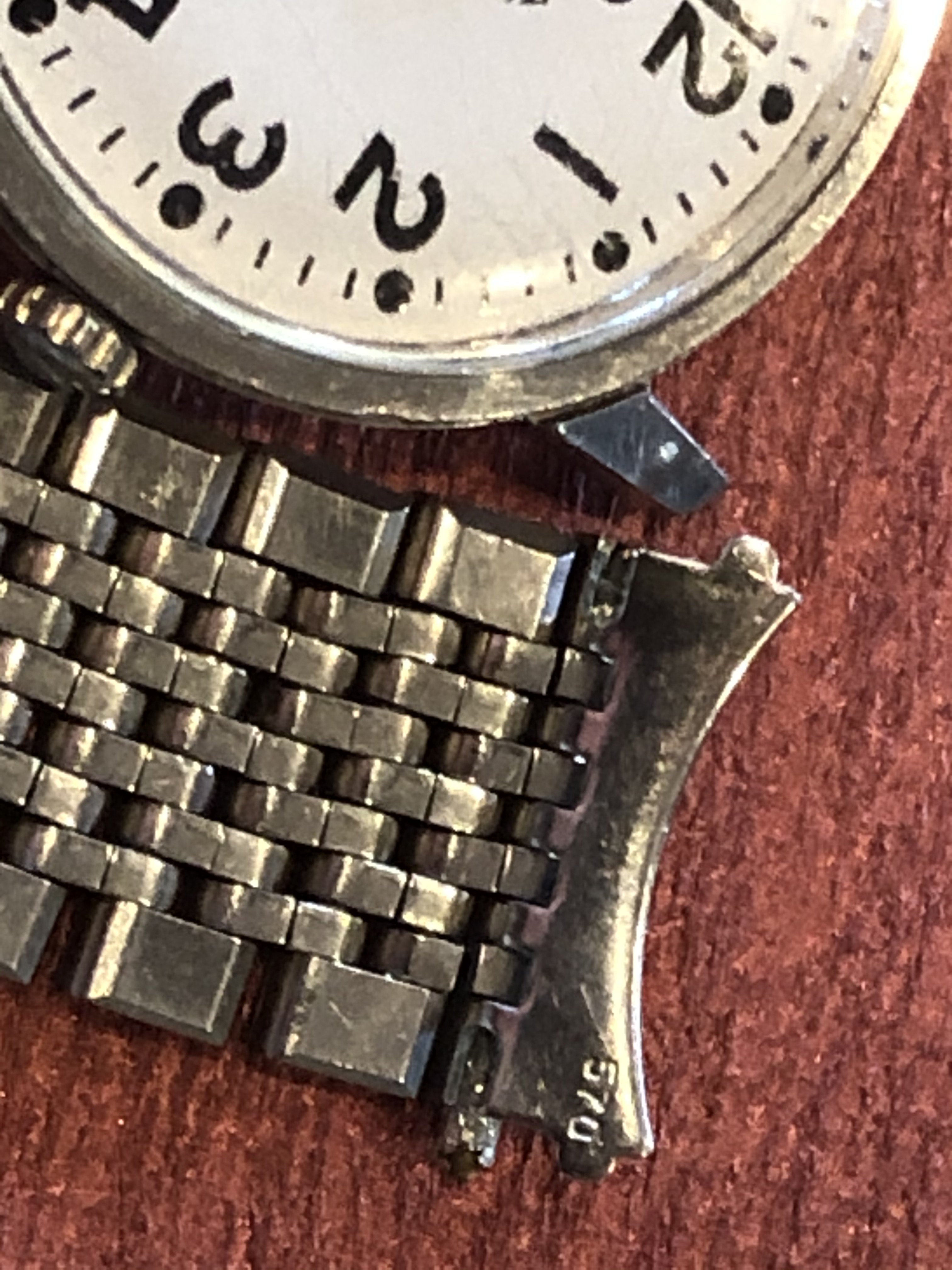

However regarding the other Railroad Official Standard and Railmaster Official models with case ref.s 165.001 and 165.002 did have original bracelet options. (https://omegaforums.net/threads/case-bracelet-endpiece-list.81618/#post-1045310)
case 165.001 : Bracelet/end piece 1036/511
case 165.002 : Bracelet/end piece 1037/570

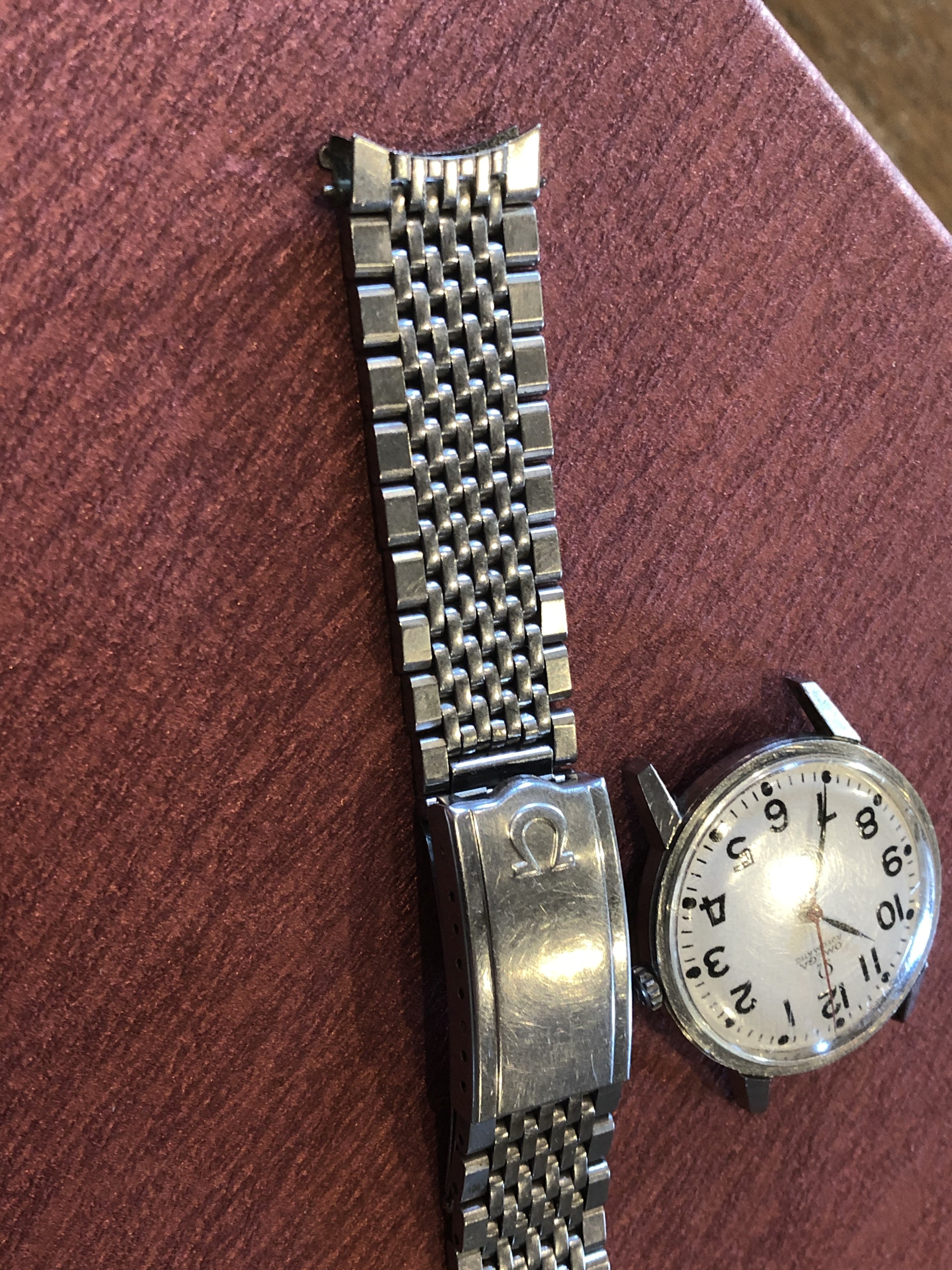

Here is an example 165.002 with bracelet
13
17

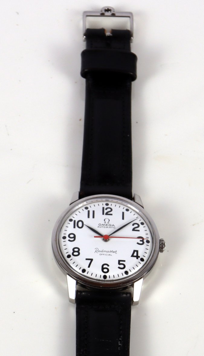

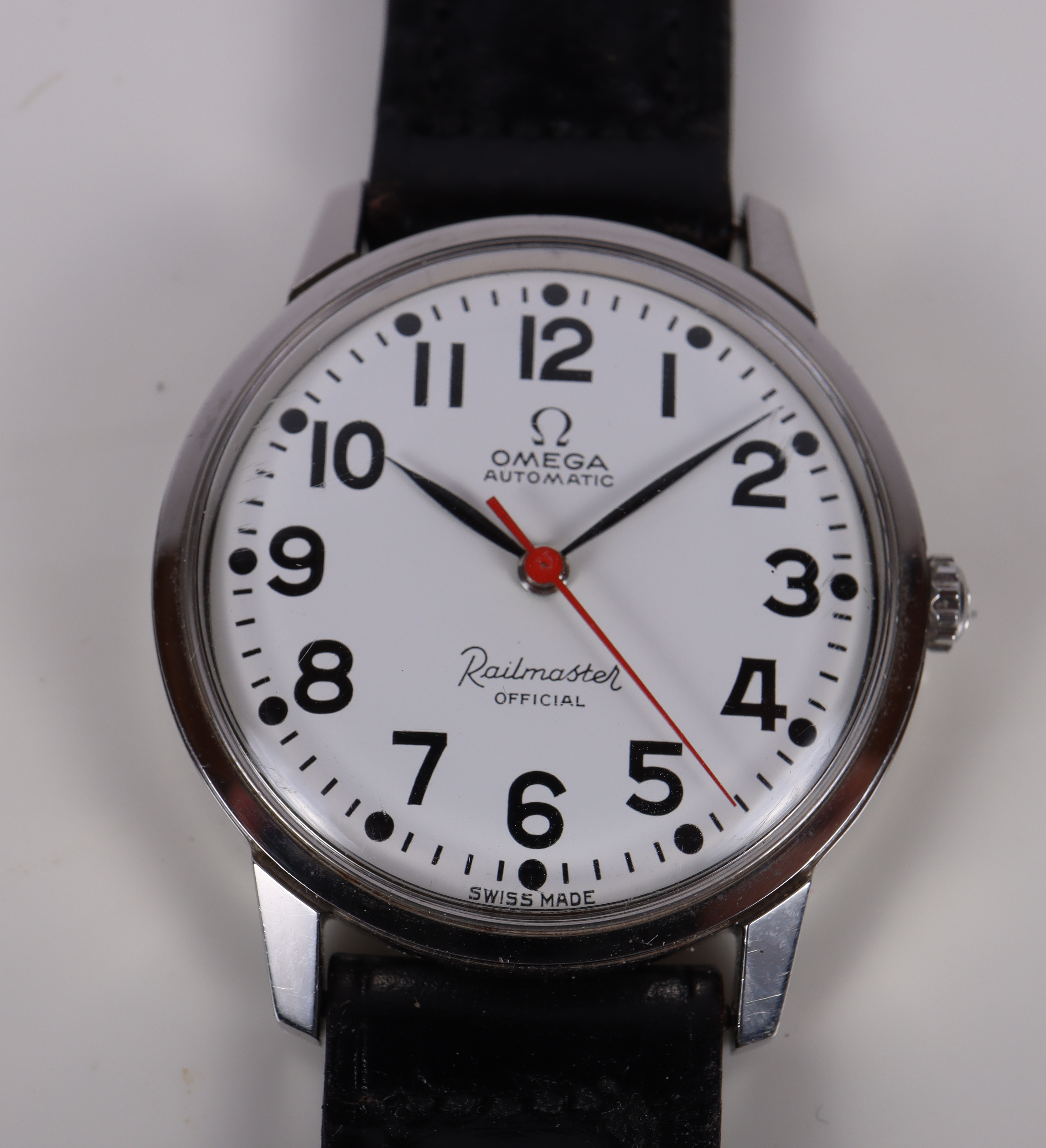

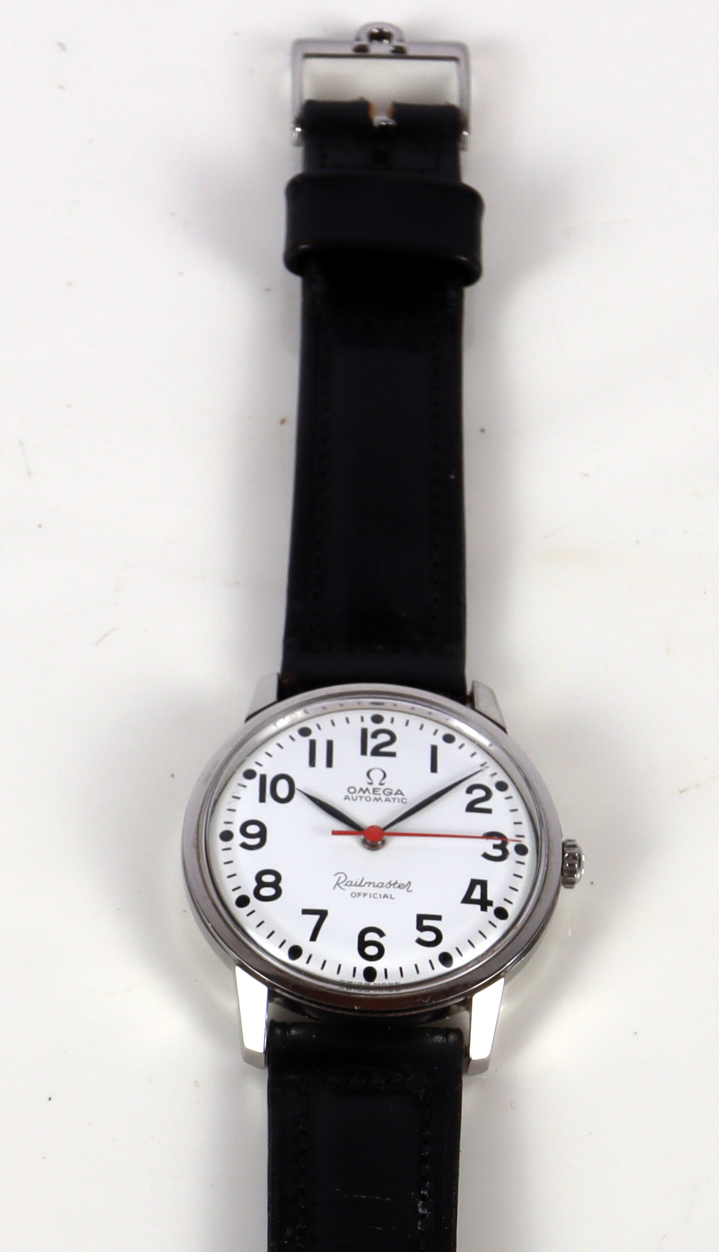

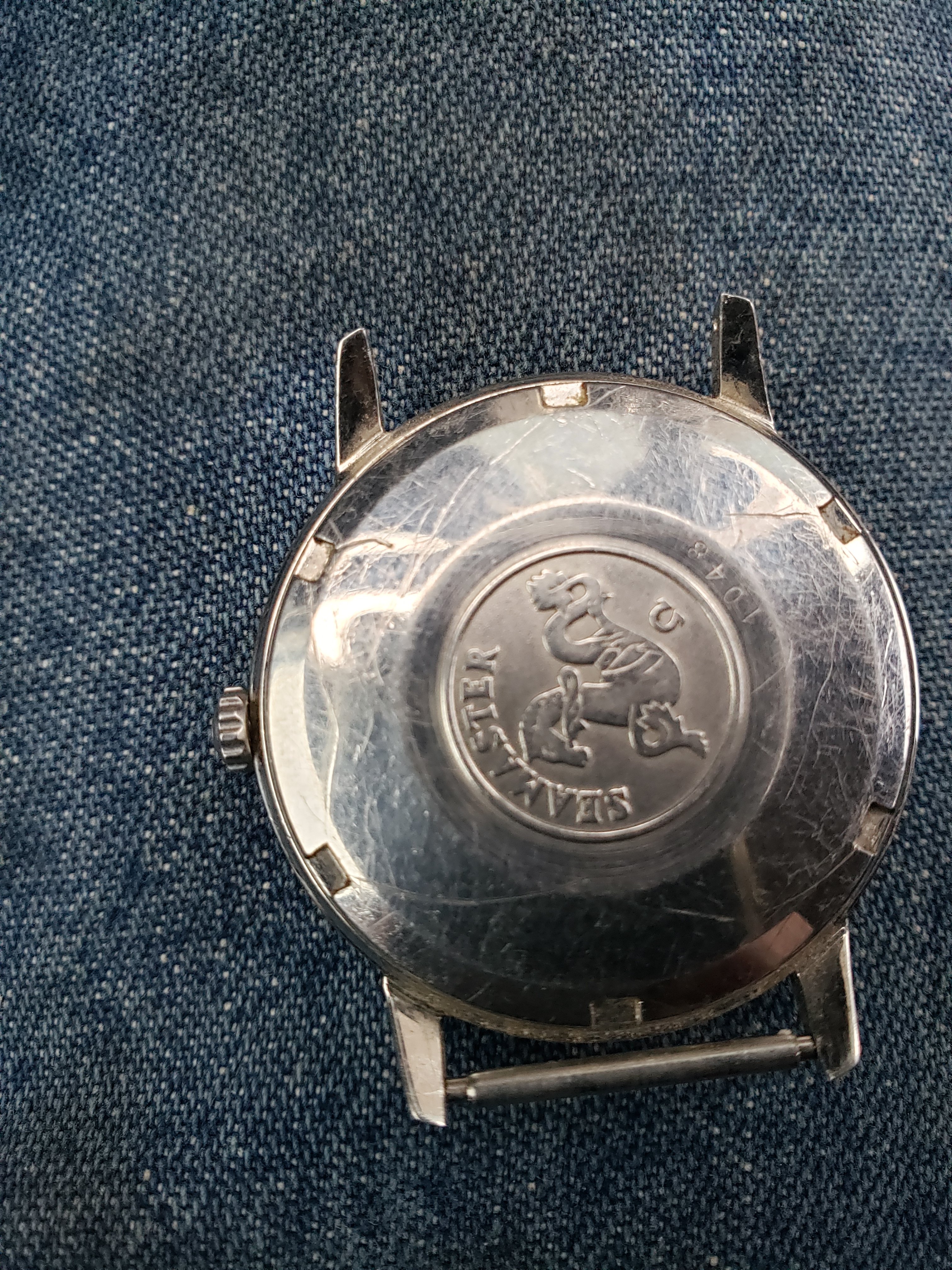

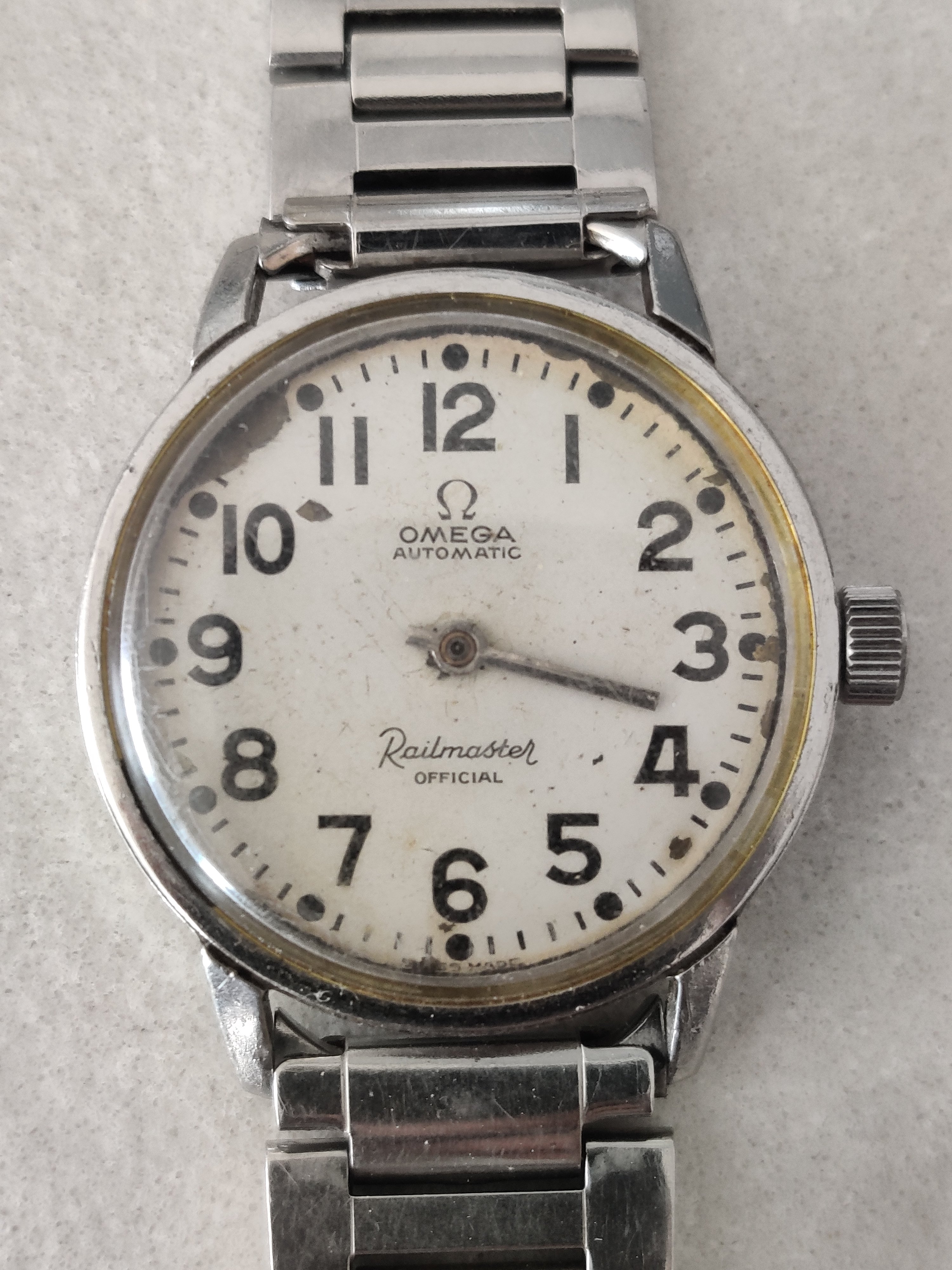

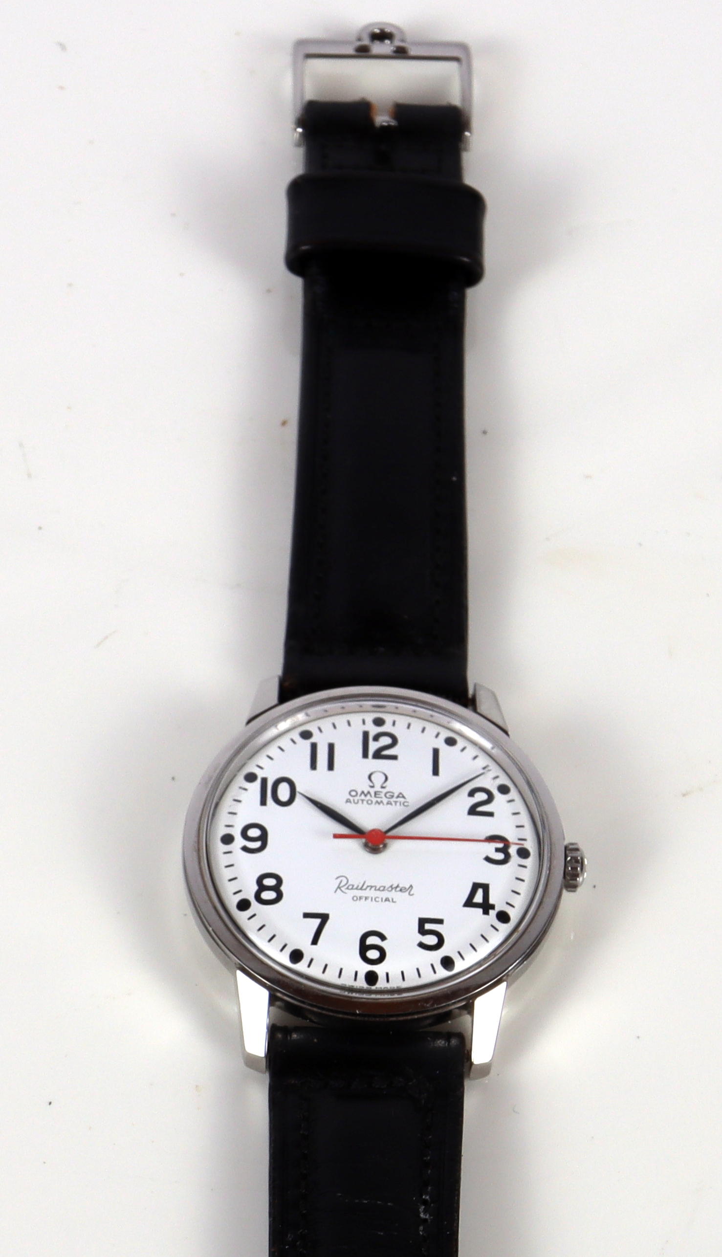

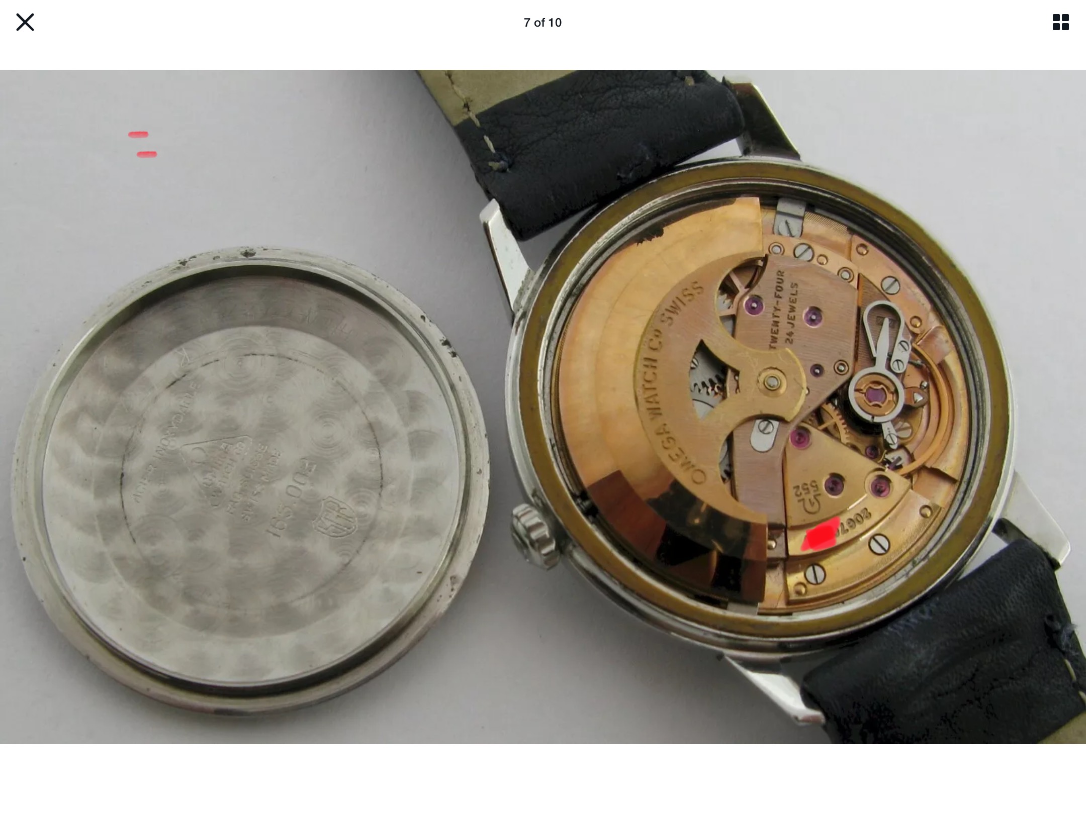

Keeping this great thread alive, attached are some photos of a Railmaster Official that I recently came across that was being sold for spares/repair. Movement is missing parts and at some point it would seem different hands have been fitted. I've also been led to believe this is an early model due to the non - Seamaster logo case back.
Does anyone know where I can find a set of replacement leaf hands and a red seconds hand?
Have sent it off now to be brought back to life!

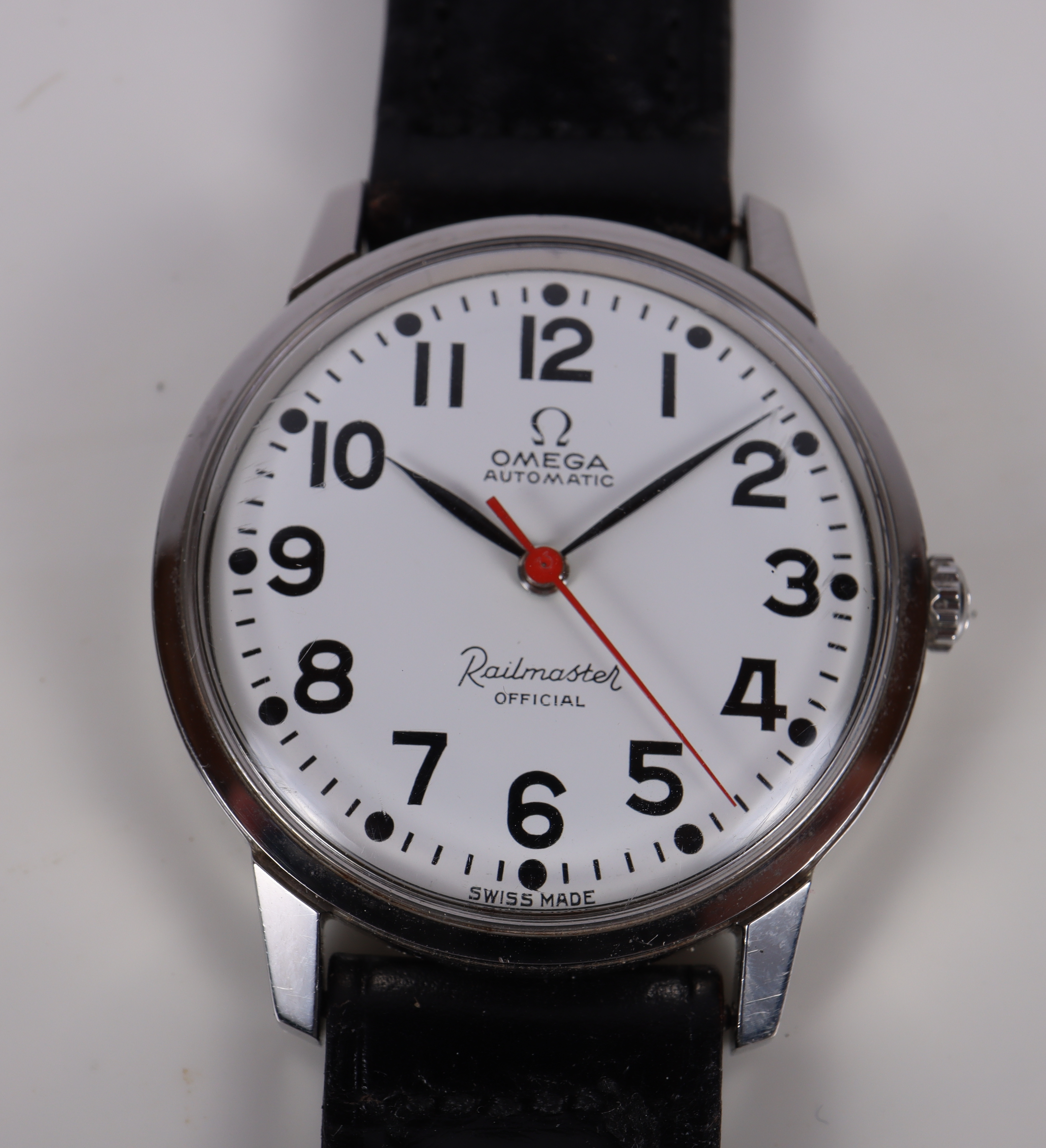

Not sure there is much I can add to the conversation but here are some images of my Railmaster which I like dearly.
