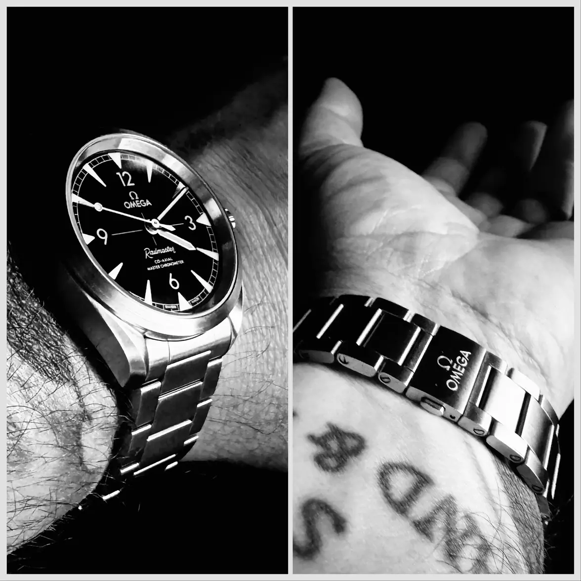

I have the previous model Railmaster 220.10.40.20.01.001 with the butterfly clasp, the bracelet tapers down from 20mm to 18mm. Does anyone have a recipe to switch it out with an Omega clasp that has a micro adjust feature? Your help is appreciated!

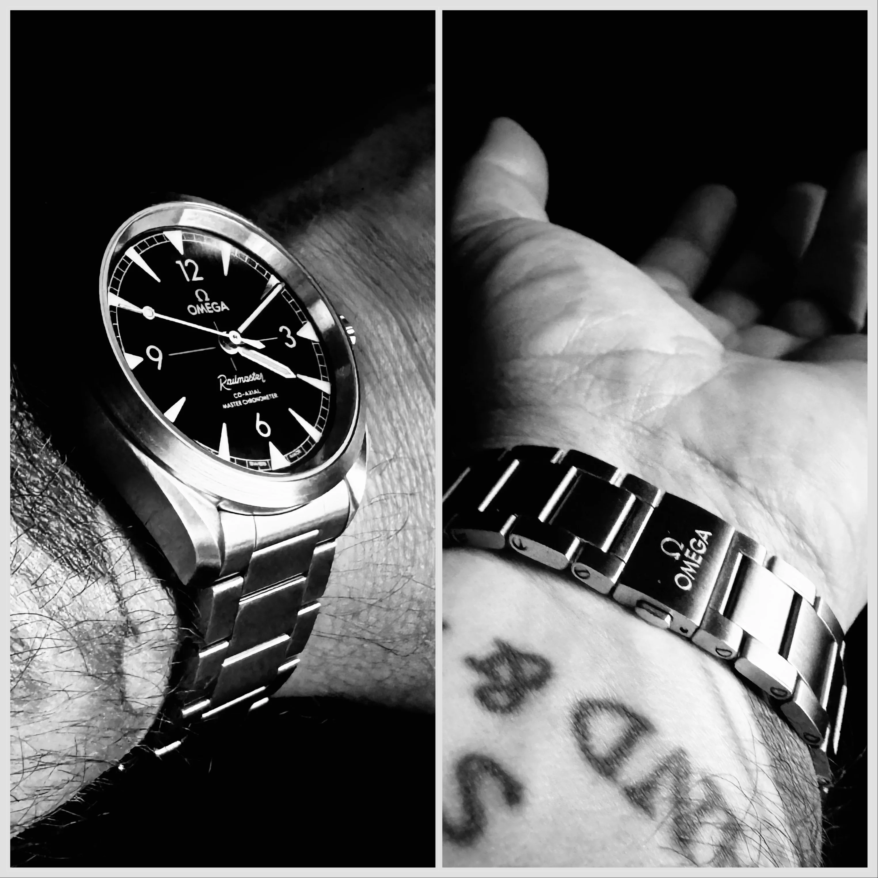

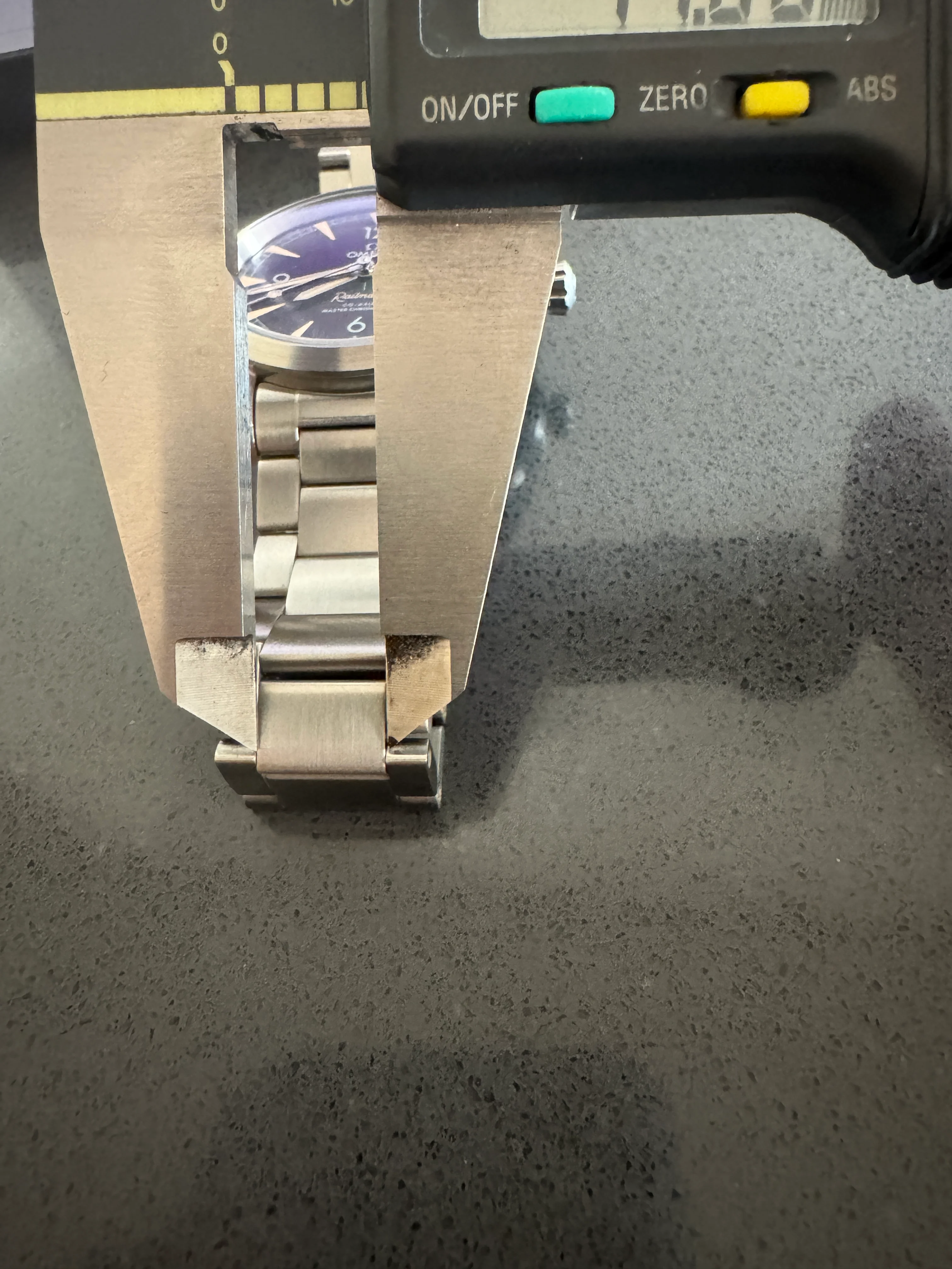

How wide is the middle link (of the three links) on that bracelet? I may have suggestions but I've never had that bracelet so I don't know the measurement.

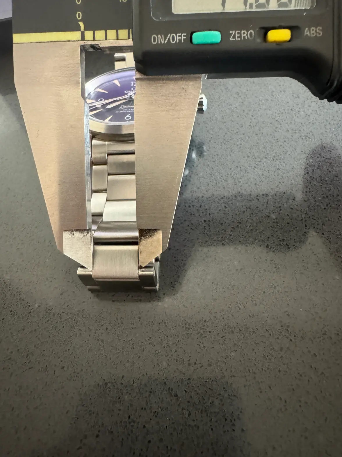

I think you mean this one, it's 11mm.
Yes, that's the measurement I was referring to.
Unfortunately, I don't know of any OEM adjustable clasps that will mate with that bracelet due to the 11mm middle link. There are links with a middle link width of 9.5, 10 and 10.5 that will work. But 11 is too wide.
