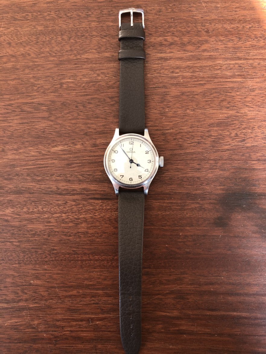

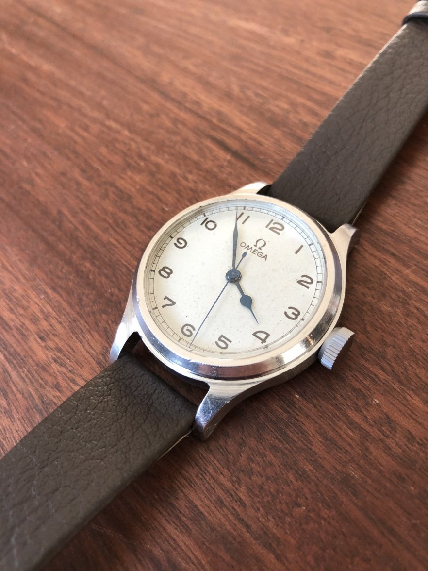

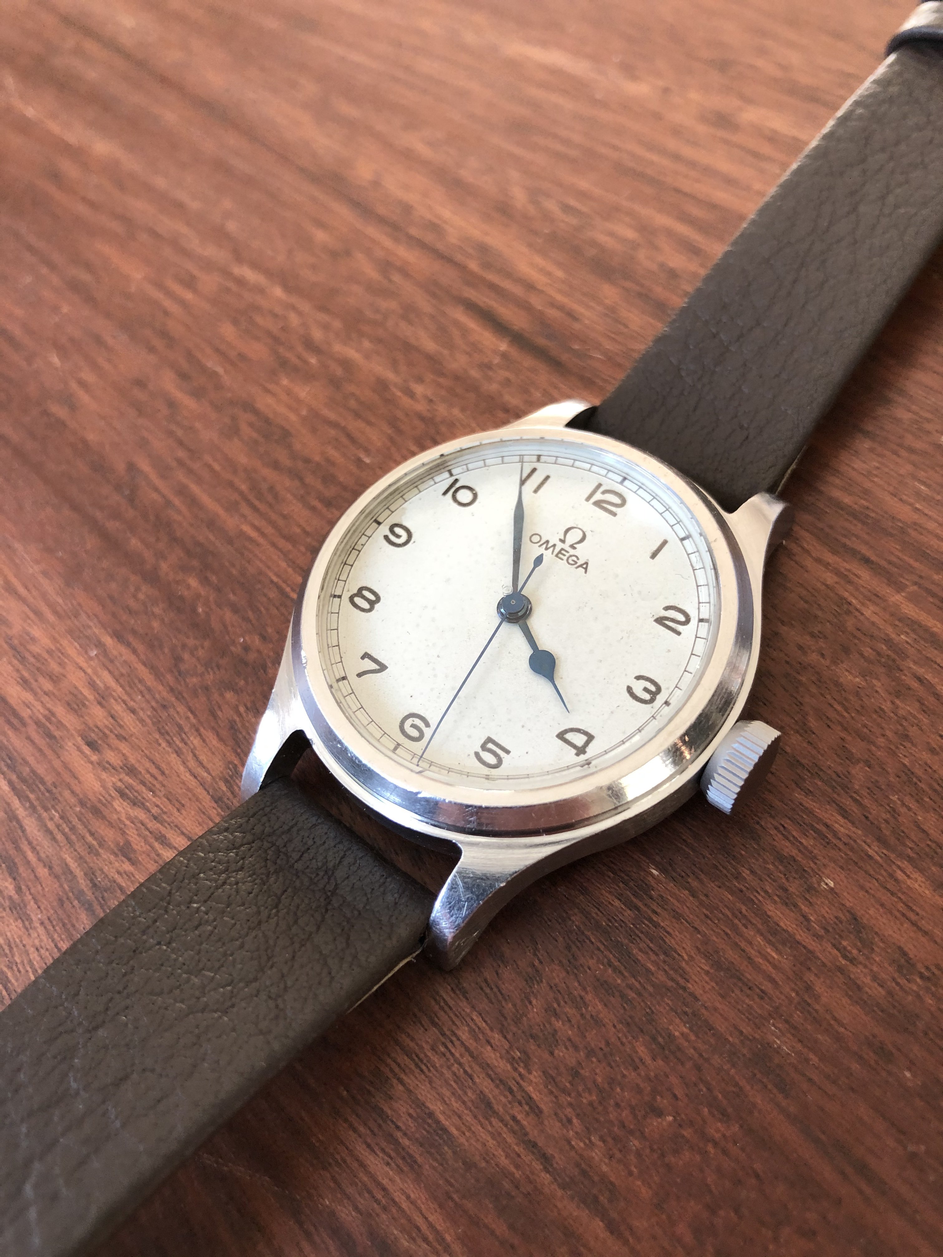

Hello all.

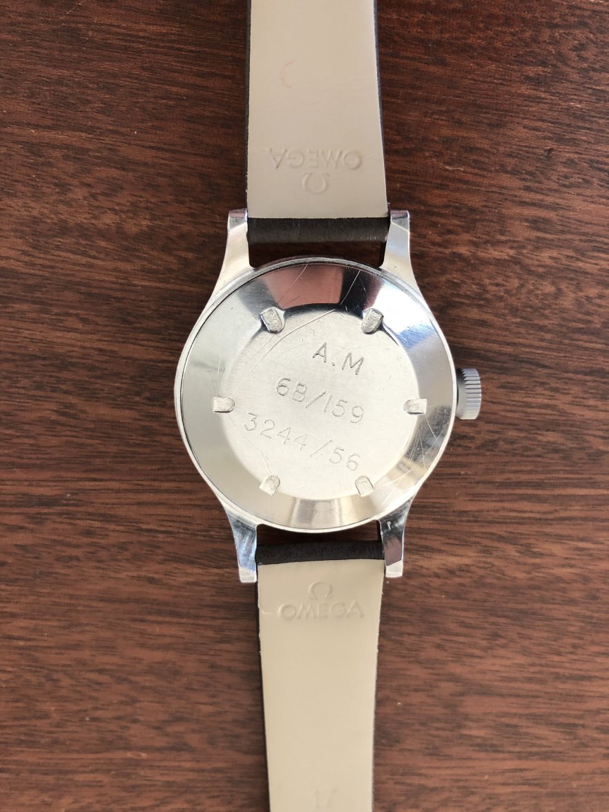

I have been gifted a very lovely vintage omega from my grandfather who paid £20 for it about 10 years ago from a local jewellers! I believe it was issued to RAF airmen during WW2 then re-cased in 1956. I think it is the CK 2292 model with the 30T2sc movement. It has A.M 6B/159 3244/56 on the case and 9862276 on the movement.
I sent it into omega for a service and a new strap and it looks great! However I am just a little concerned that it doesn’t have Swiss made either side of the number 6 on the dial. Everything else looks in order (it still has the fixed lugs and un modified blued hands). But all the other CK 2292 watches I have seen online have Swiss made on them.
Does anyone know what this means? Could it be the dial has been replaced at some point? If so why would it not have Swiss made on it? If anyone has any other information about the watch I would love to hear it? Thank you

I'm not a military watch expert, but given the condition of the case and movement, and the font used (much later than the ~1945-50 period during which the movement was produced), it is almost certain that the dial is a later replacement. Not unusual for military watches.
As for "Swiss Made", the absence of it is never proof of anything, and in this case largely irrelevant, I would say.
13,674
19,043
It means that the dial was redone at some point. It is probably the original piece of metal with a newer paint job.
Sometimes this was done within the Ministry of Defense (American spelling), but this one doesn’t look like it was done military standards.

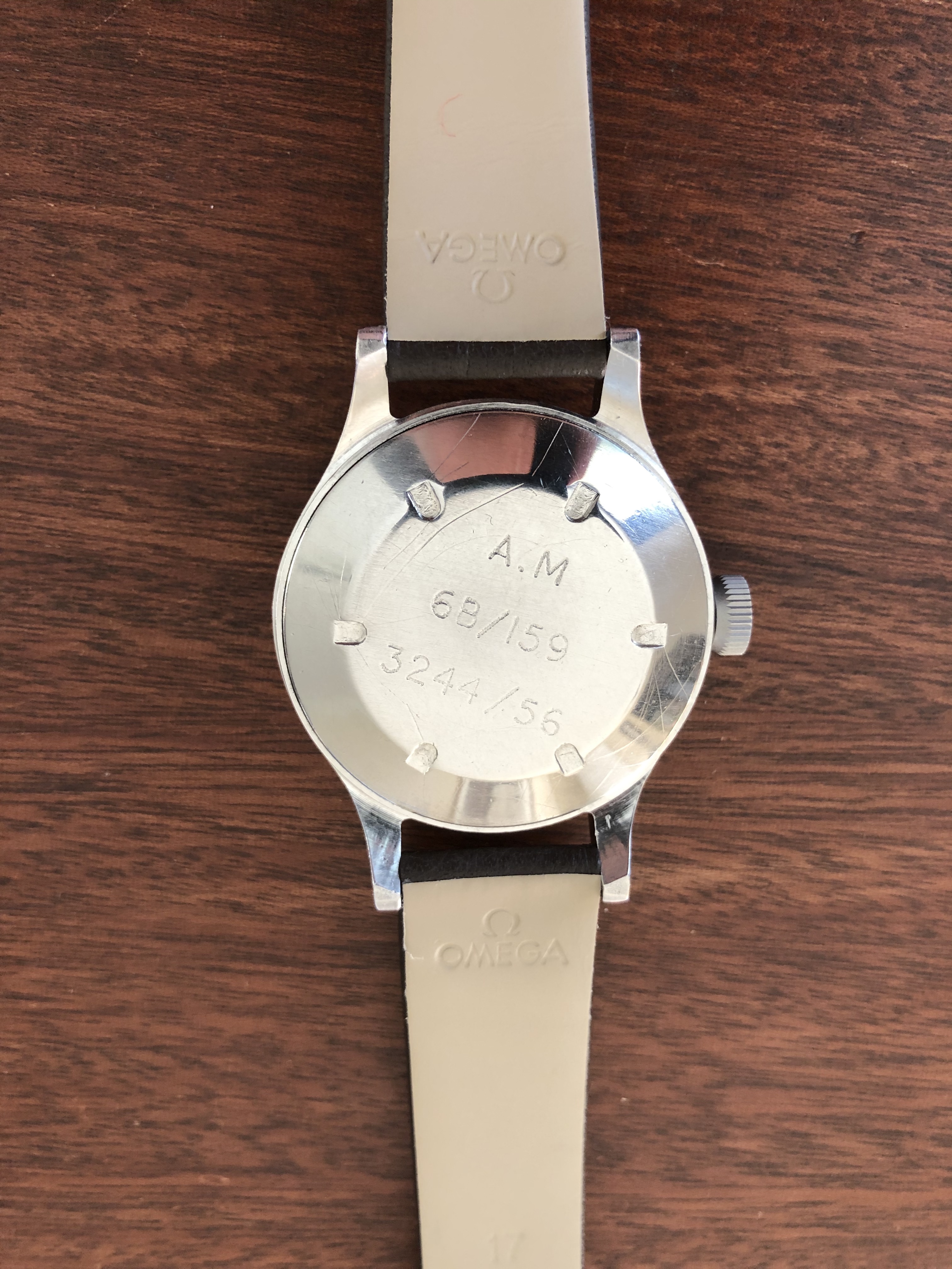

Has the crown been replaced? It looks different in the second picture. The newer one doesn't seem to match quite well.
8,283
29,288
Definite replacement, and much later.
2,086
2,899
Yes. And it doesn't even look like SS.
The watch appears to be the same, judging by the lugs. That's what I had just been asking myself.

Great watch with an MOD redial, great heir loom, lucky you. If you ask over on MWR you will find a correct crown for it.
Good spot! Yes omega replaced the crown when I sent it in for the service. I still have the original in the bag of bits they sent back.
5
I still have the original crown from when omega serviced it. How would I swap them back?
I still have the original from when omega serviced it. How would I go about changing it back?
781
1,342
I don't think the crown in pic 2 is an original crown either tbh.

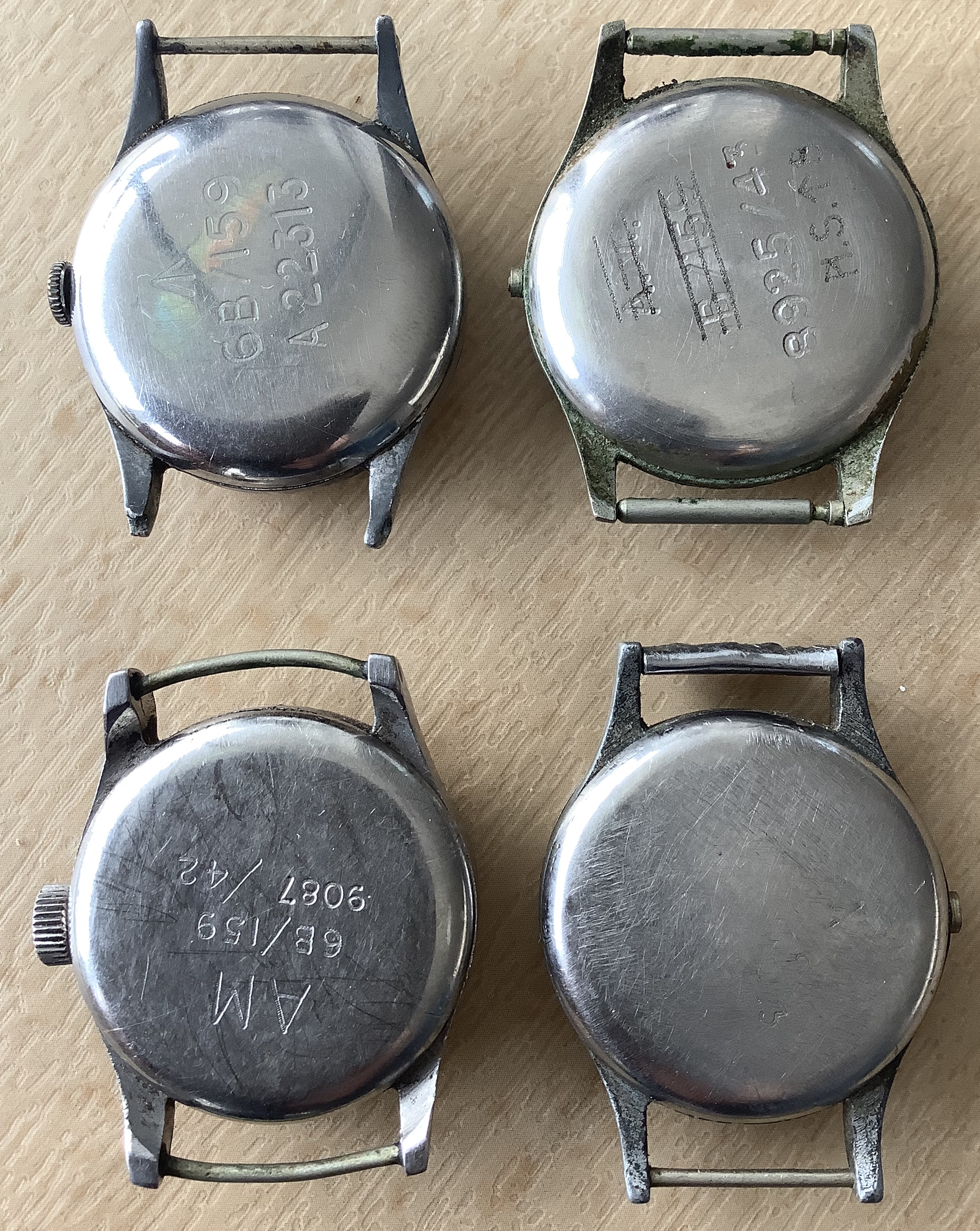

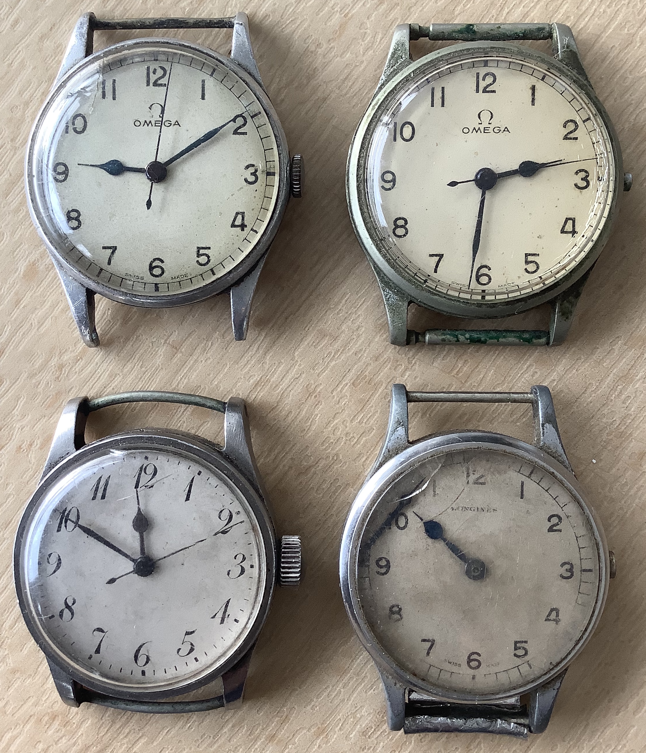

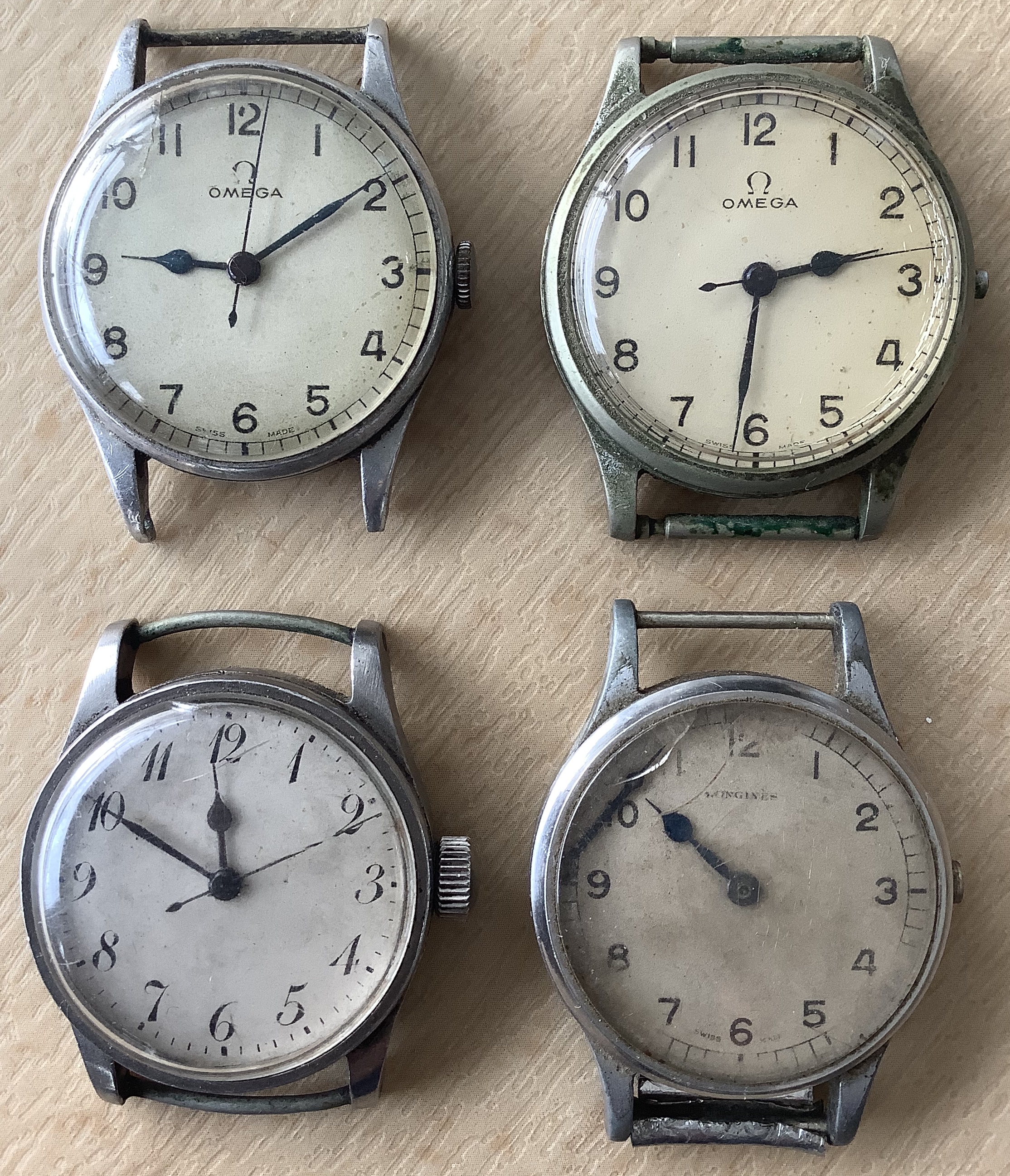

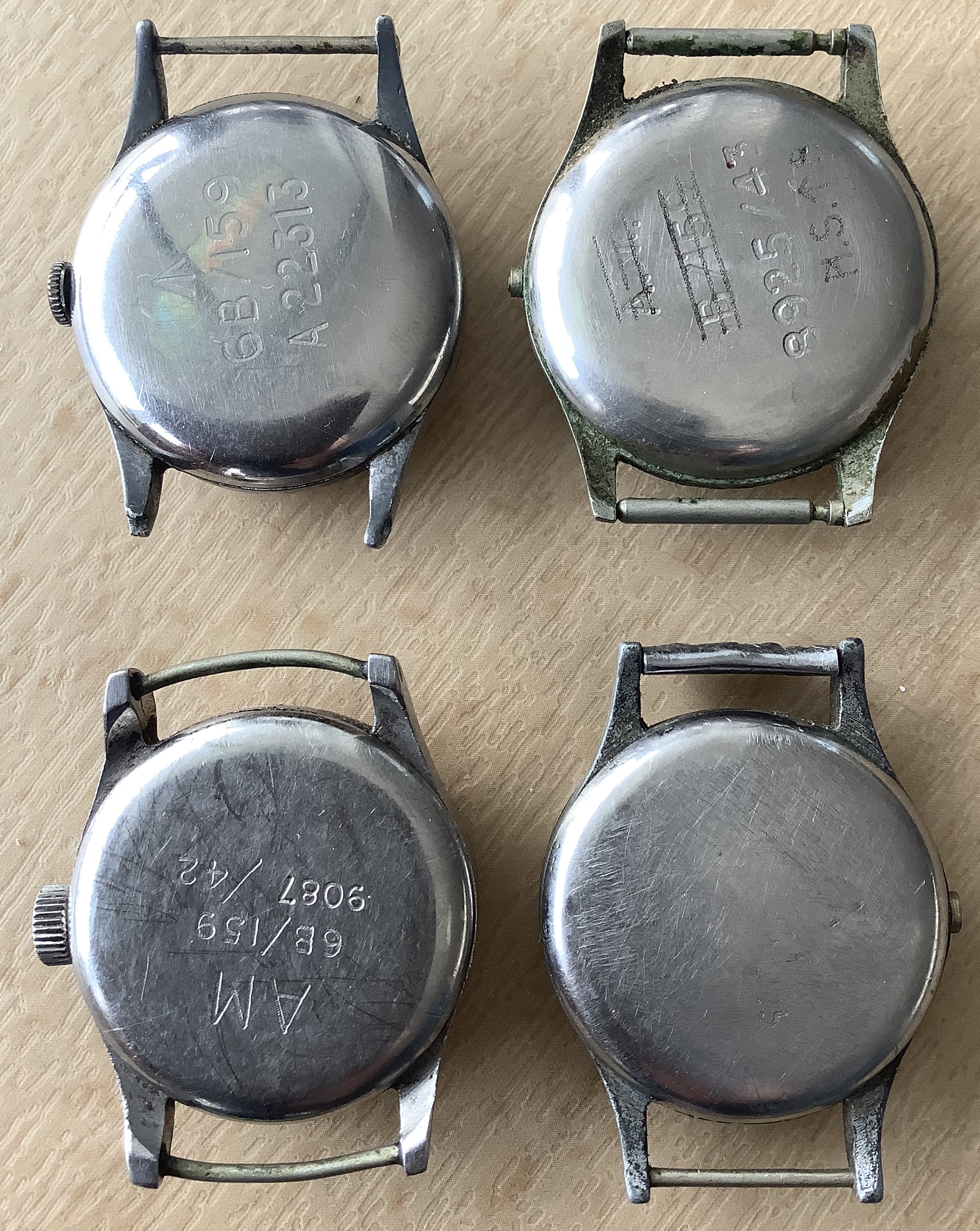

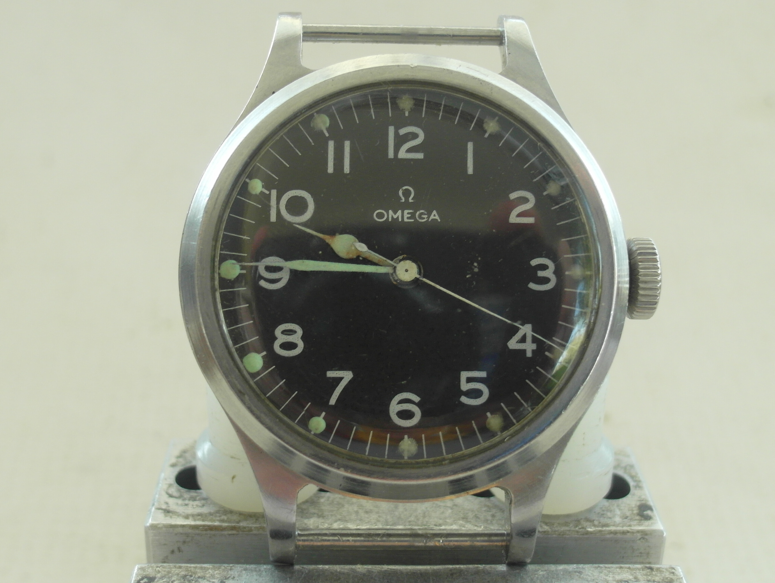

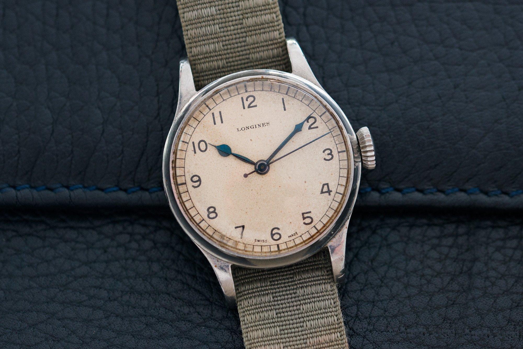

Here are 2 rough ones with original dials, plus a redialed Ebel and a Longines.
2,086
2,899

The OP watch isn't a ref 2292 any longer, it has been rehoused in a (Dennison) '56 screw back case by the MOD.

Hi w154, I think Antoine's crown is for the CK2292 case, the 6b/159 and the HS8, I bought one for my HS8 in the alloy case but the OP's watch is in the later stainless steel screw back case made by Dennison (most likely) for the MOD to recase the CK2292 watches in 1956.
That Ebel looks like a stainless steel cased one with the cal 101 in it. Rare thing, and very nice. Congrats. Please excuse the thread driffffft.
