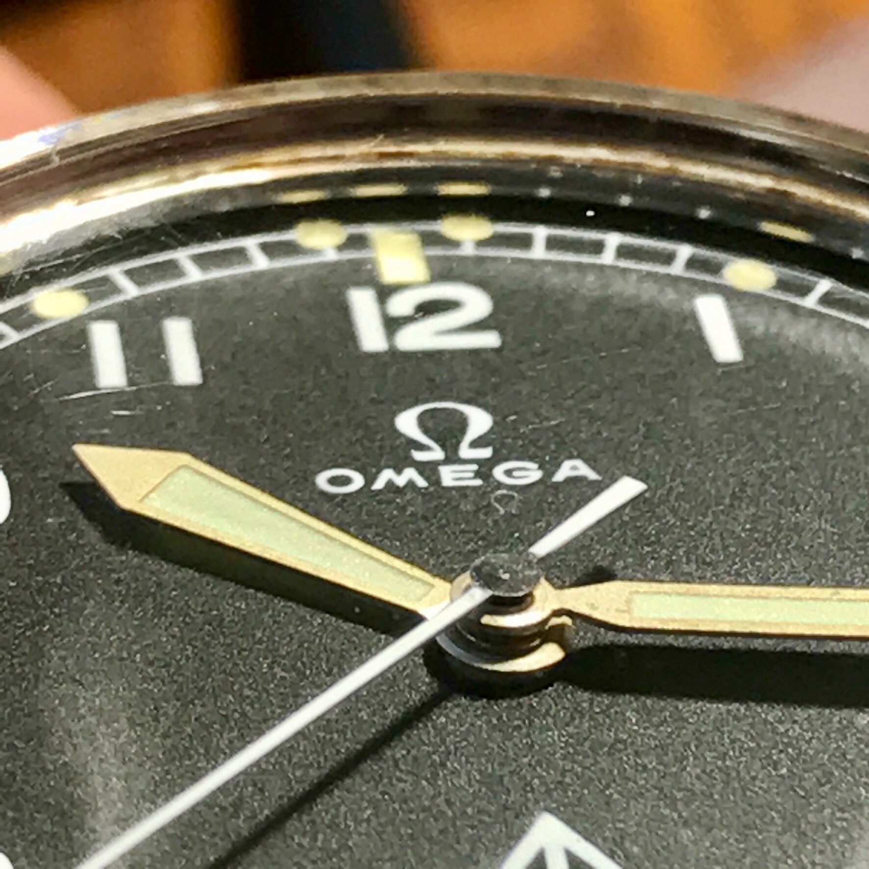

@mac_omega Both of my '53s are signed.... damnably hard to photograph. Afraid I do not know the symbols by era or if they were originally signed when issued. As a non-collector, I have not bothered much about originality of crystals unless it is for a reference that is difficult to fit properly.
'53 Fat Arrow
'53 Thin Arrow (Bienne dial)

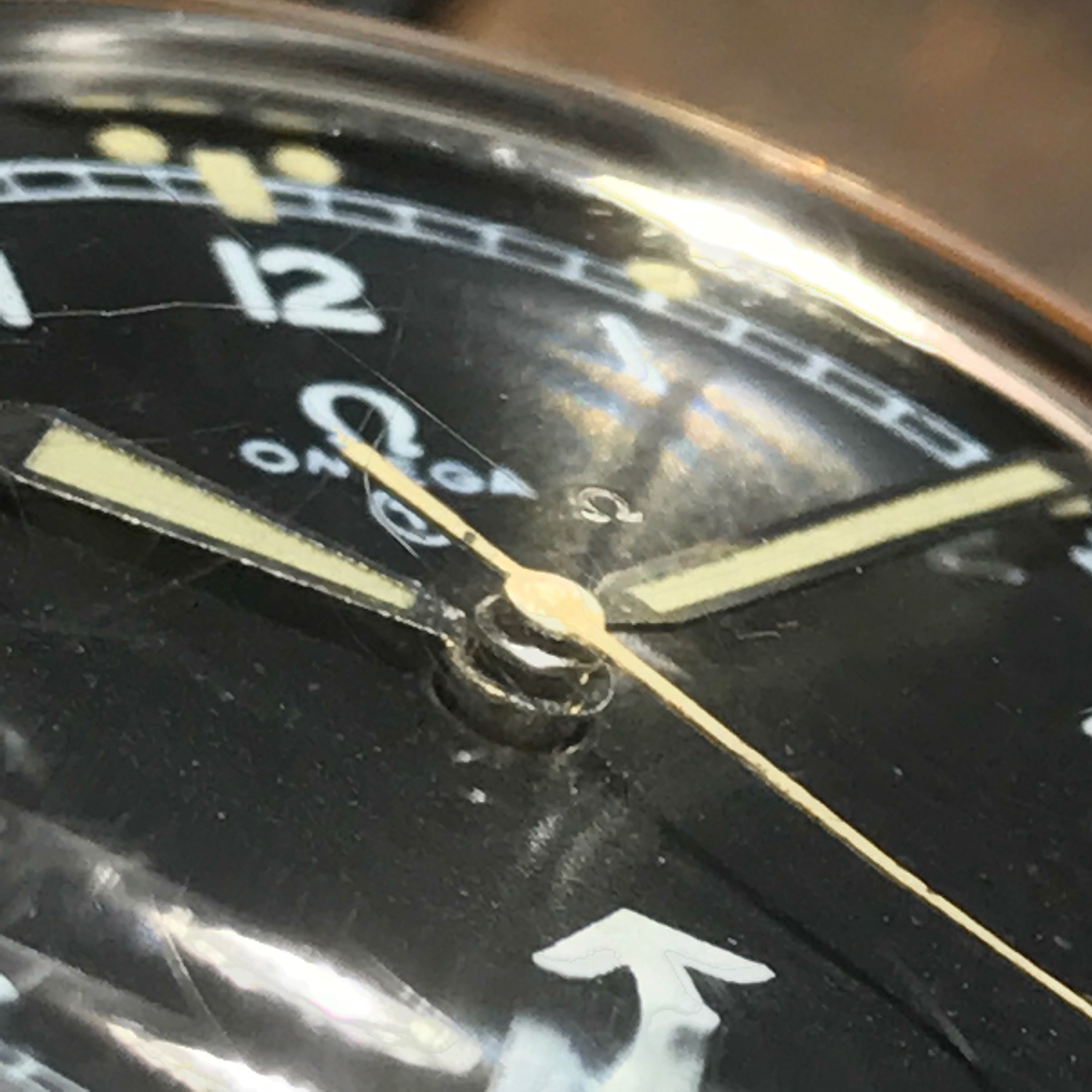

Hi Eric, here is one that turned up nice and gunky, I think the crystal is unsigned, will confirm this for you with a closer inspection when i get access to it later in the week
My common rule would be if the watch has been worked on/serviced it has a logo!
Isn't @MSNWatch the king of this reference?! 😁🙄😜

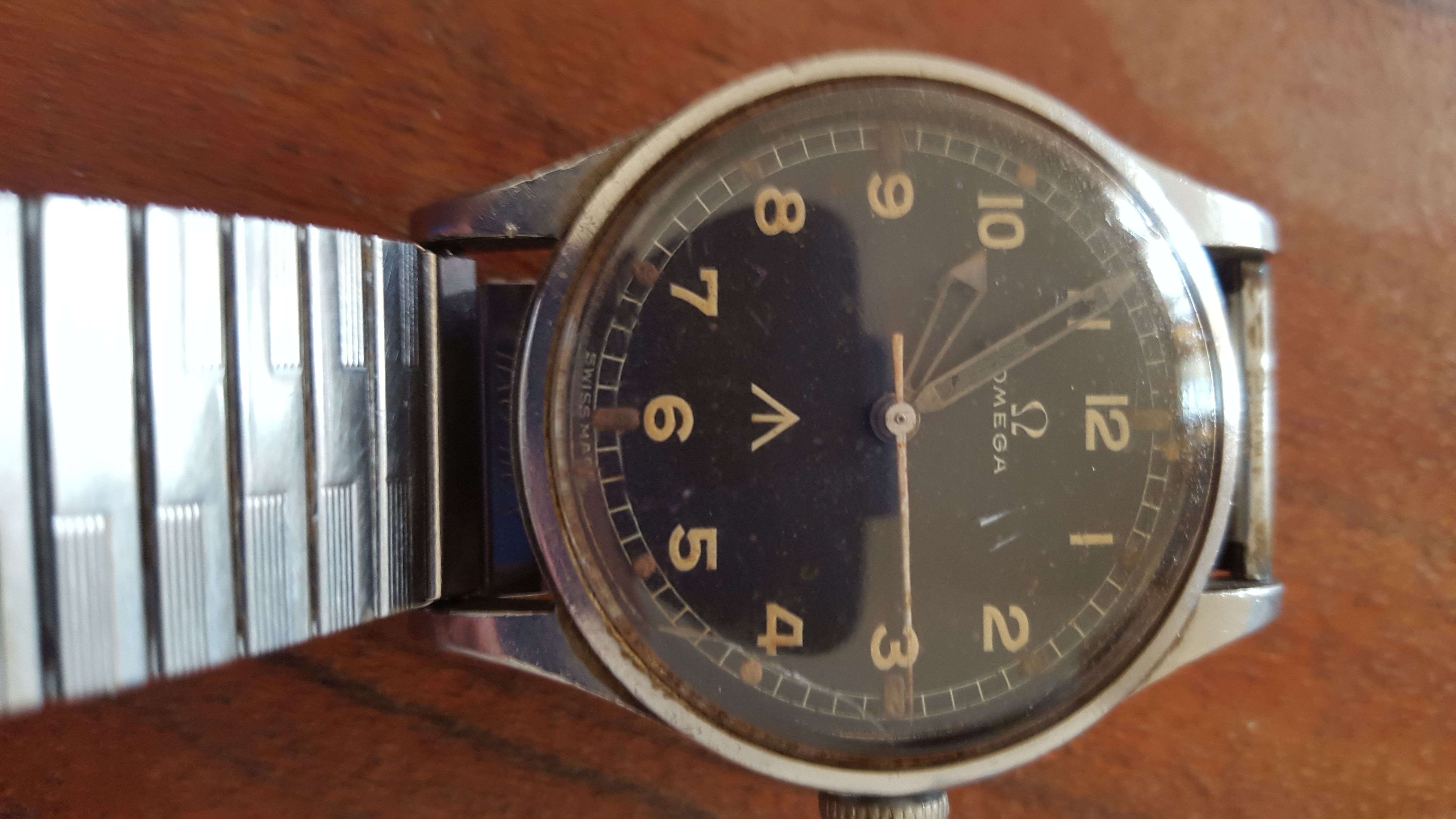

Mine hasn´t seen a watchmaker for decades. Movement is really dry. Crystal is unsigned, but is it original? How to answer that question?
