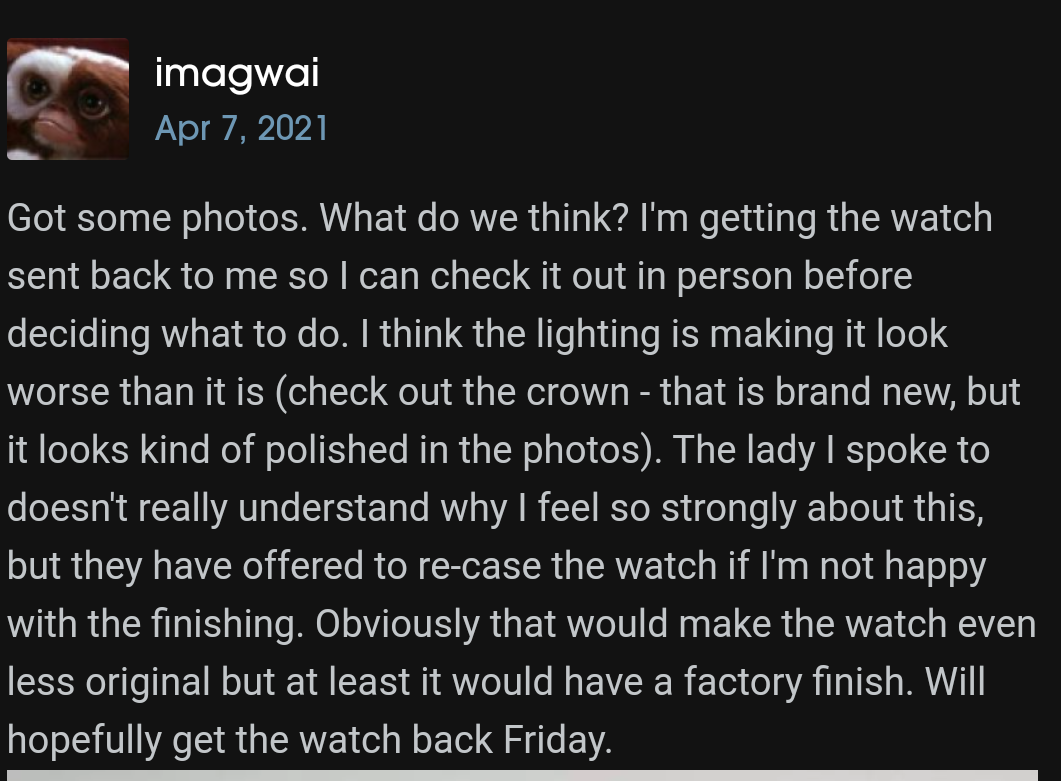

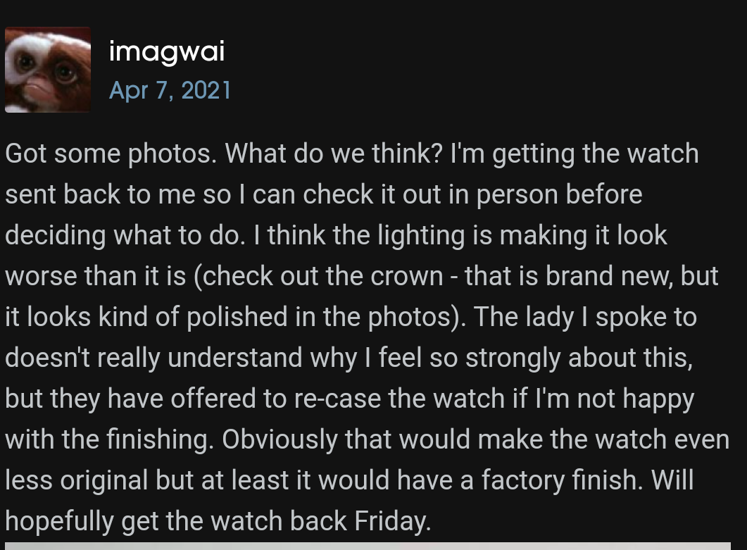

I recently sent a Tag Hauer for service and they don't polish the watch unless you ask them to.
@imagwai would disagree.

Please ask him to show the service documents. It may depend on the reference and caliber number. A different reference they may charge a different fee and offer a different standard level service. In 2021, and in my example I serviced a CV5111 calibre 17, and it was returned un polished and it's going back to be polished, I was told it is a different level of service to get case polishing, which means higher service fee. Please print the service documents for us and post them here. I am sure we would all learn from this experience. Thank you.
6,487
31,960
His word is good enough for me, you can read his posts here;
https://forums.calibre11.com/threads/tag-heuer-servicing-times.125452/page-4#post-1761045
And an offer to re-case further in the thread;
