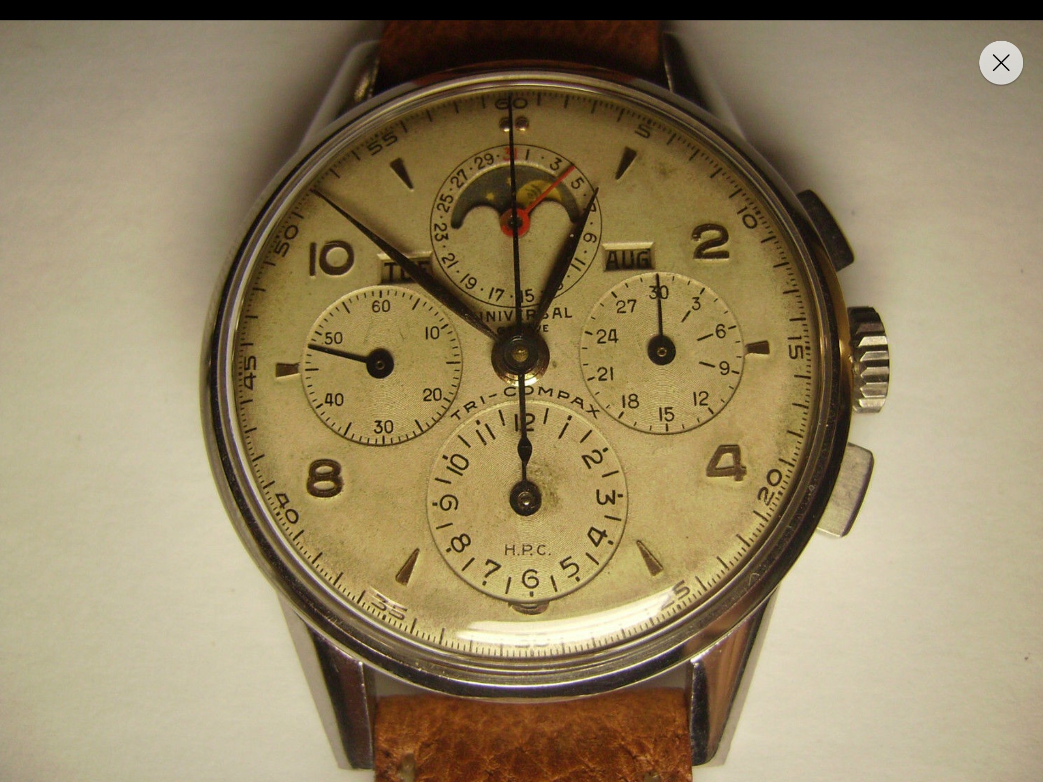

    Last question is I came across a tri compax a couple of months back. On the dial apart from the normal signature and trademark. There was the initials "HPC", according to the owner it stood for "High Precision Chrononometer". Is there such a variation for a tri compax? Thanks so much for your kind opinions.

    I have been looking up the "HPC" signature in the past few days. Looks like there are many samples out there with it, and the dials with them look quite okay. could have been a legitimate cosc related signature.
  8. woodwkr2 Feb 22, 2014
    1,366
    819
    You got it.
    H.P.C.: "High Precision Chronometer", designation by Universal for the watches tested at "Le Bureau de Controle des Chronometres".
    --From 100 ans de tradition horlogere
    Any pics from the HPC dial you spotted?

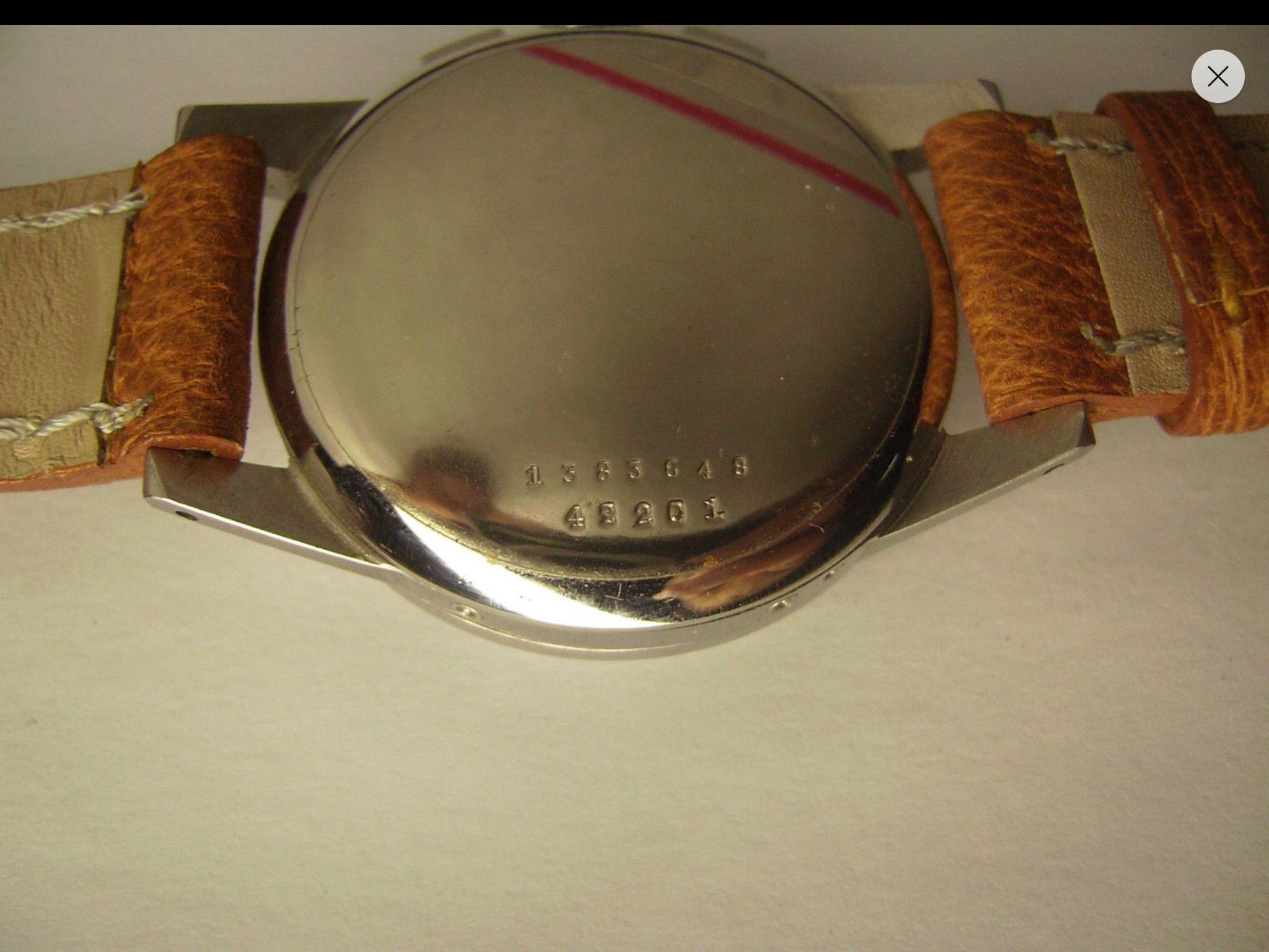

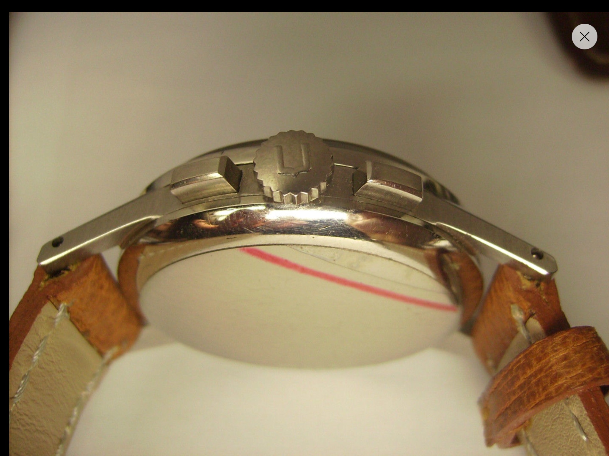

  9. ELV Feb 24, 2014
    14
    From my amateur eye the dial looks legit but the ref. no us 42201 which doesn't seem to match the case
  10. woodwkr2 Feb 24, 2014
    1,366
    819
    The caseback should go with a gold plated case. The same reference number in Sala appears to have different lugs as well.
    The crown is a replacement--though, obviously a signed UG crown; these came later.
    Dial and hands look original.

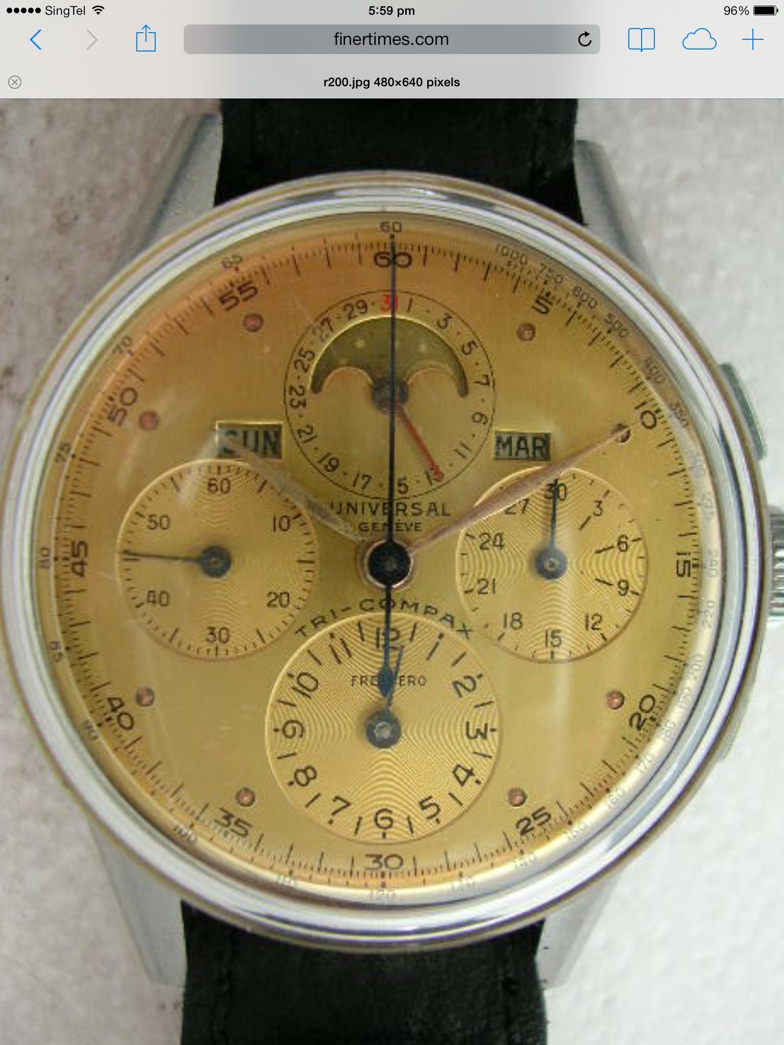

  11. ELV web Feb 24, 2014
    2,668
    24,651
    throwing in another slightly different dial, with the word "Freccero" (a South American retailer, kind of like the illustrious "Walser Wald", freccero is still operating today though.
