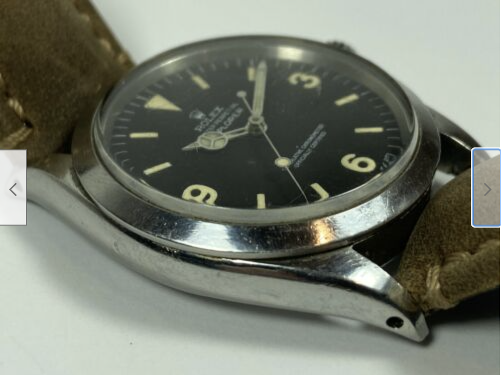

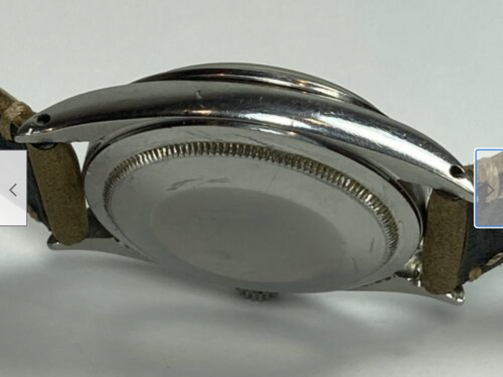

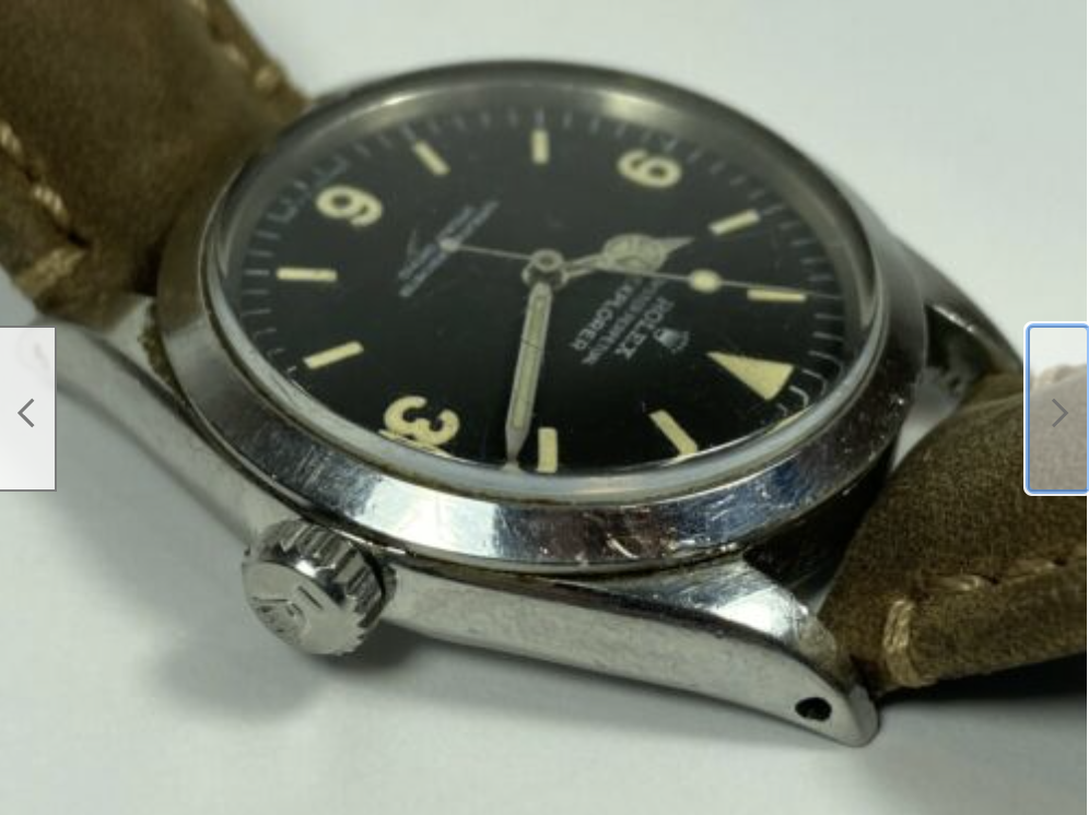

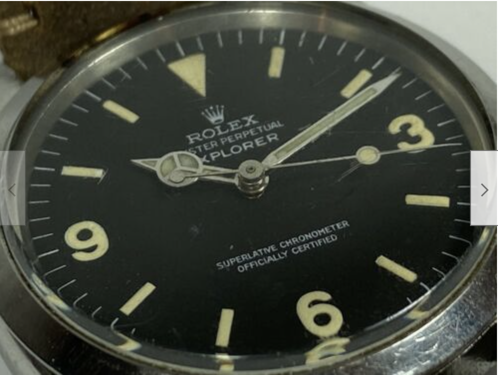

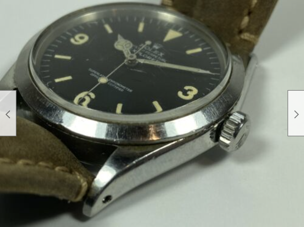

Hi all,
Sourcing a genuine, non put together Rolex 1016 in any condition is no easy feat.

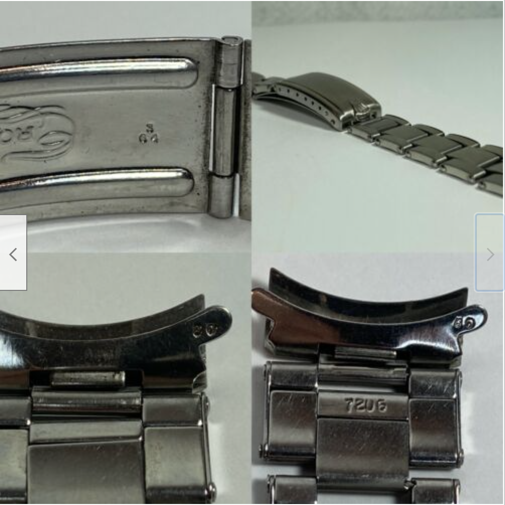

I have my eye on this one and would like some advice on condition and originality before making an offer.

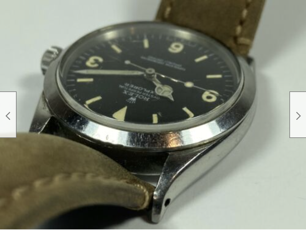

Dial looks nice and genuine, with nice homogenous lume. I can't tell if it's a Mark II or III.
Hands seem correct and match the patina of the dial. Hour hand is damaged but not beyond repair.

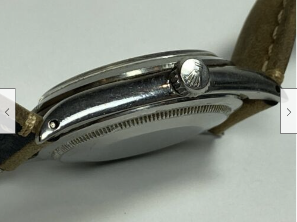

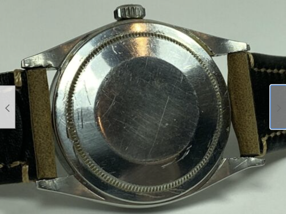

The case has the most issues, as it appears in poor shape with heavy wear and a badly bent lug.

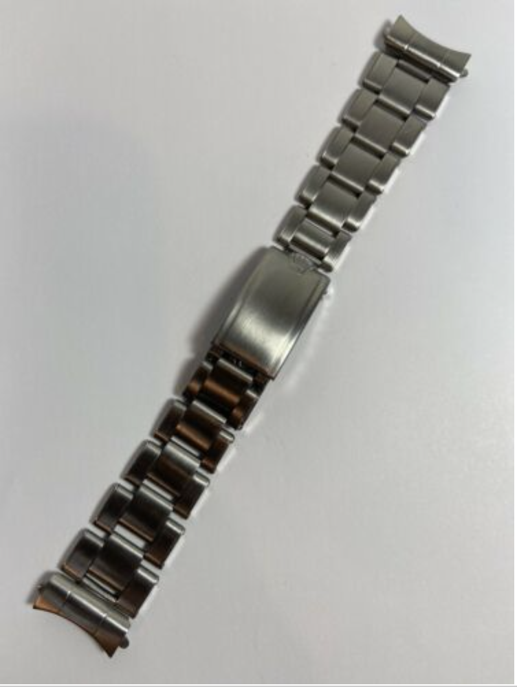

Any originality issues I may have missed I should be aware of? I realize the bracelet is older than the watch but that's OK and it looks in much better shape.
How about the case? Is it too far gone? Any idea of how well the bent lug could fix up and how much that may cost?
Is this one a pass or could it benefit from some TLC and a well placed offer?
Appreciate an input!

The dial is a later replacement. While the hands are the correct length, the tritium in them is not particularly attractive, to my eyes at least. Finally, the holes in the lugs for the bracelet pins look to have been enlarged, maybe to take the bigger Submariner pins.
I’ve never seen a lug on one of these as bent as the 11 o’clock lug on this one, which is also smaller than the other three. I’m sure it could be remedied, but at a cost.
While I don’t think the price is completely crazy, it’s not any deal - particularly because not having the correct frog foot dial is a big deal. I’d save my money for one closer to correct.
If I can find the correct 1016 hands for mine (after many years), I know you’ll be able to find your 1016 within only one year. Nice ones do come up.
15,943
47,864
The bent lug appears to also be cracked! The better the Explorer you are looking for, the tougher it will be to find. But THIS one? By the time you attend to what it needs, you likely could have bought a better one, for nor much more money. I’d keep looking if I were you.

All above good information, lugs to thin for me. And the price is at tops. I bought one last year 1.6 with a later matte dial for not much more than half bid shown. Wait for a better but be aware a period nice example is not cheap.

Thanks you for the responses. Exactly the advice I was looking for. I do think the case is too damaged to repair within reasonable cost. Of course, this could be used as leverage to request a lower price. There is an "offer" option, and the watch has been advertised for a couple of weeks, so the price is obviously too high.

Don't get sucked into settling for one that needs help. I know the heart wants what the heart wants, but lowering your standards and settling for a potential money pit will only lead to heartache and disappointment- and eventually you will just sell for a loss because it isn't exactly what you wanted. Save your pennies and hold out for an honest survivor pull the trigger without hesitation when you find it- one shot and done.
The dial is not a later replacement. This is a Mark 2 matte dial, which has only been seen on 1016s with a 2.1m serial, which is the serial listed for this watch (https://explorer1016.com/matte/mark-2/). The frog foot / Mark 1 dial was around over a large range (at least 1.5-3.5m), which includes this serial, but it was not the exclusive dial over that range.
I've bought both Explorer and Submariner spring bars and the pin width is the same, its just that the pin length is longer on the Submariner pins. They weren't wider, so not sure if that's explain the enlargement.
I agree with the rest of the opinions on the lugs and case. Of note, it also has a service crystal.

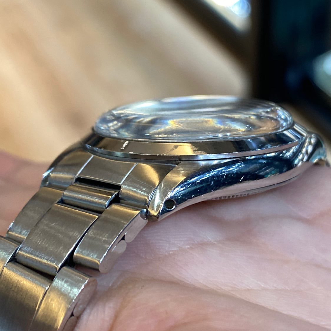

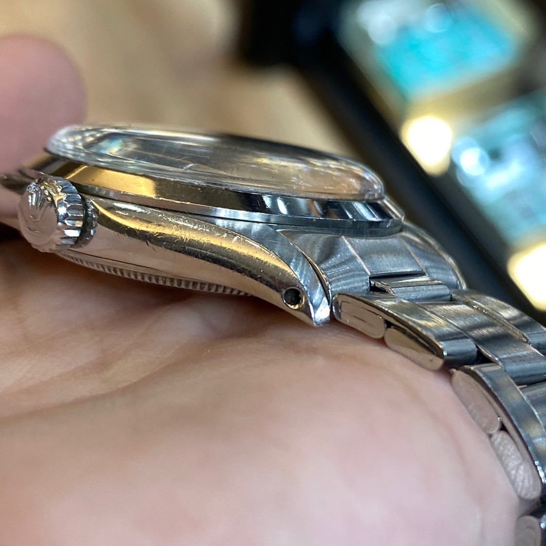

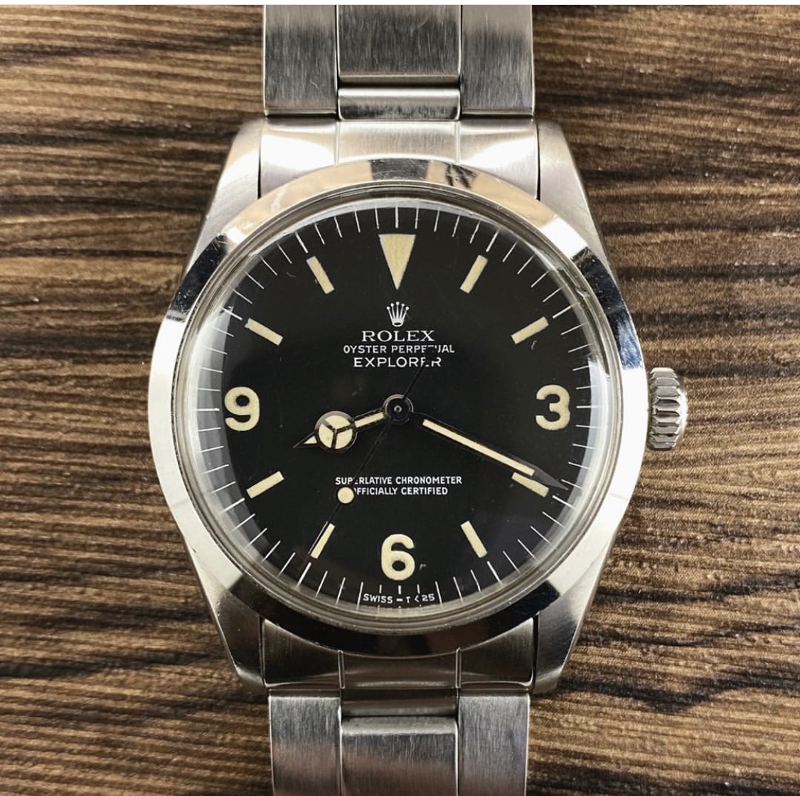

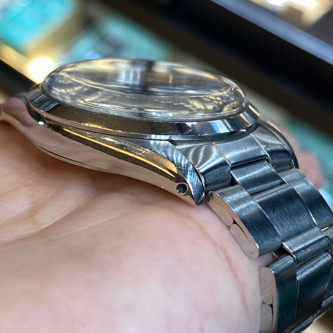

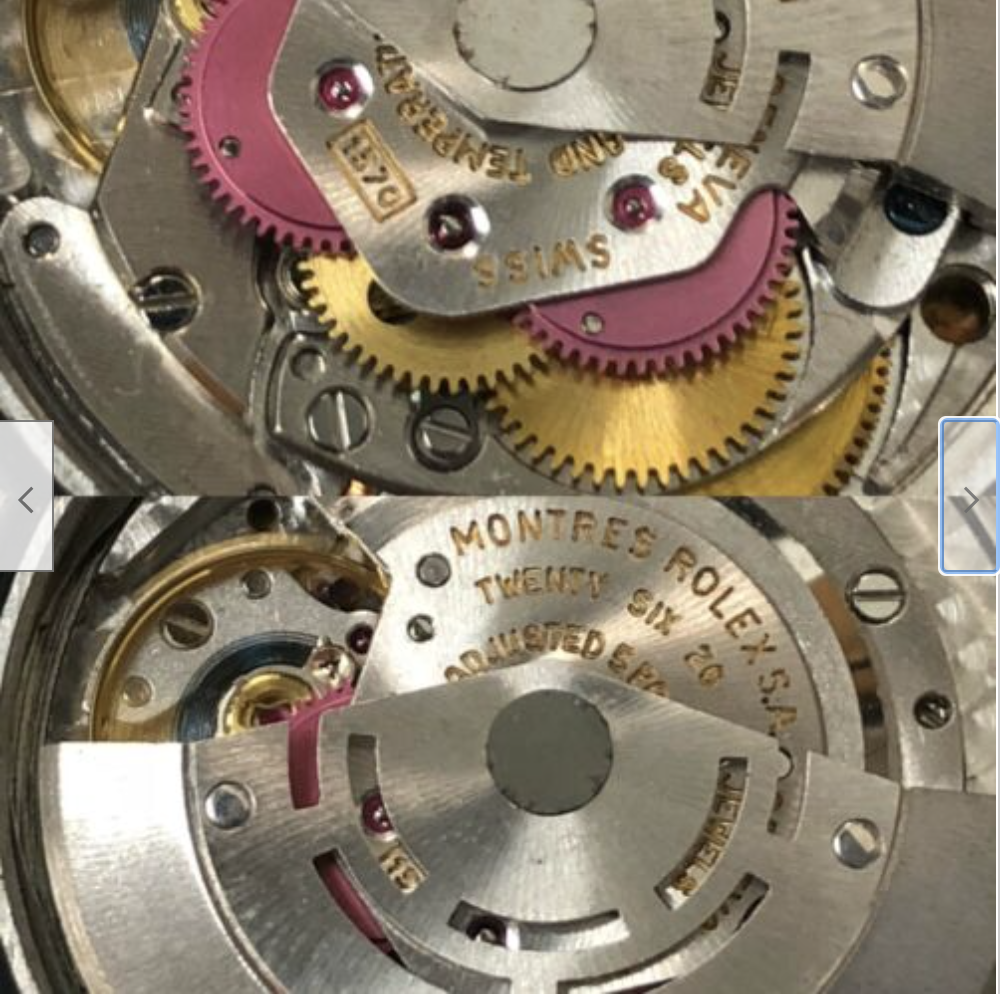

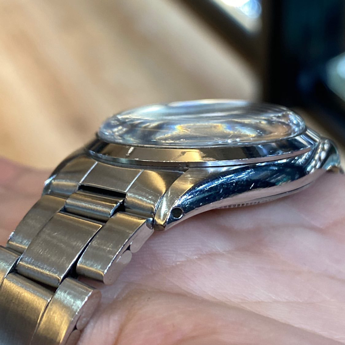

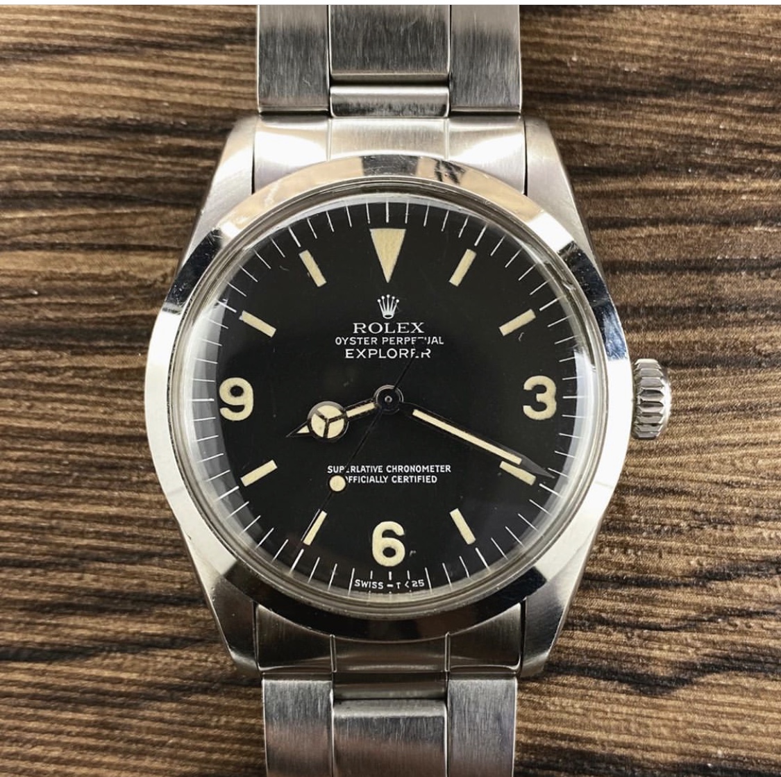

Here's an example being offered by a dealer, at a higher price. The Mark 3 dial looks nice and original, and so do the hands.
I'm not sure about the originality of the crystal and it seems to have some marks. I'm also not sure how good the case is. It looks like it's seen some polishing, but I don't realize how bad this is. Asking price seems a little high at $18k— what do you think a reasonable price would be should I feel inclined to make an offer?

Assuming the bracelet is original to the watch, and considering the spring bar holes are open, this watch is likely about 50 years old. It probably is one of the calibre 15xx series movements in it. I’ve heard that parts for these might be tough to get because Rolex would prefer these older calibers be retired in favour of buyIng a new Rolex. Given the asking price, I’d give serious thought to buying a new Explorer, rather than one that might be a liability.

Buying a new Explorer would be beside the point, as I'm specifically looking for a 50 year old vintage example. I'll happily have it serviced regularly and would wear it in a rotation and not on a daily basis. 15xx movements are very reliable if well maintained, and I'm not too concerned about that aspect.
Looking at the spring bar holes however, these seem to be too close to the edge/angle of the case, which makes me think it may have been excessively polished.

You are right about the 15xx series movements being reliable. BUT, how well maintained has the movement in this one been? And what might be needed if it hasn’t been well maintained? And can you get what might be needed? Add the price of an expensive repair to an astronomical purchase price. Your choice!

Your points are very valid and are making this hunt more difficult than the previous ones. There is a huge premium on vintage Explorers in collectible condition, and no guarantee that the movement has been well maintained and recently serviced. The premium I can deal with as I'm now at point in my collecting journey where I have acquired enough watches that I can sell/trade off a few to afford this particular reference that really appeals to me. The hard part is identifying the watch that I won't regret purchasing or need to upgrade in the future, and that won't turn into a money pit to maintain!
I like what I see in the photos. Obviously, I’d want caseback and movement photos before I committed.
I also agree it seems expensive. If it were really nice, it might be worth it at that price, but the polishing and those lug holes (position and size) worry me a little. Has the seller told you anything else about the watch?
@Canuck is a wiser, more knowledgeable collector than am I. But, any vintage watch is a potential money pit - in ways that a new watch won’t be. If you’re risk adverse, then there are safer collectibles. And, the more money you lay out for purchase, the more money you’re likely to be willing to pay out for unexpected repairs. I assume you know this already.
Second, I’d much rather be looking for Rolex 15xx parts than many of the 40’s era chronographs that we see (and maybe want). Sure, spare 15xx movements and parts are expensive, but you can find them - less so for those old chronos. Now, if @Canuck says that there have been 15xx parts he hasn’t been able to obtain at all, I’ll accept his superior experience - I’m not a watchmaker, but I’ve yet to have a problem servicing any of the 15xx watches I own, all of which came to me as used. Fingers crossed.
Finally, $18k for a watch, any watch, is crazy. Proof of this is: How many people would you be happy to tell you’d spent that much on a single watch? I know it embarrasses me to admit to most of the people I know that I spent that much. I generally avoid telling anyone but you people here.
(Indeed, I’m sure there are plenty of OF members who can’t imagine ever spending anything like that much on a watch, and others here who think that spending that much on a watch is simply fuçked up. I’m sure they’re right.)
I’m a fan of Rolex’s family of 15xx movements. They are better than what came before (I think) and, properly maintained, they will last a very very long time - I am told. I guess my children will find out. 😁
If you can wait, a better Explorer will certainly come along. For $12k, this one would be a compelling deal, which it is not at $18k. If I received sufficient assurances about the condition of the movement, I’d try to get it for under $15-16k. If not, I’d wait.
