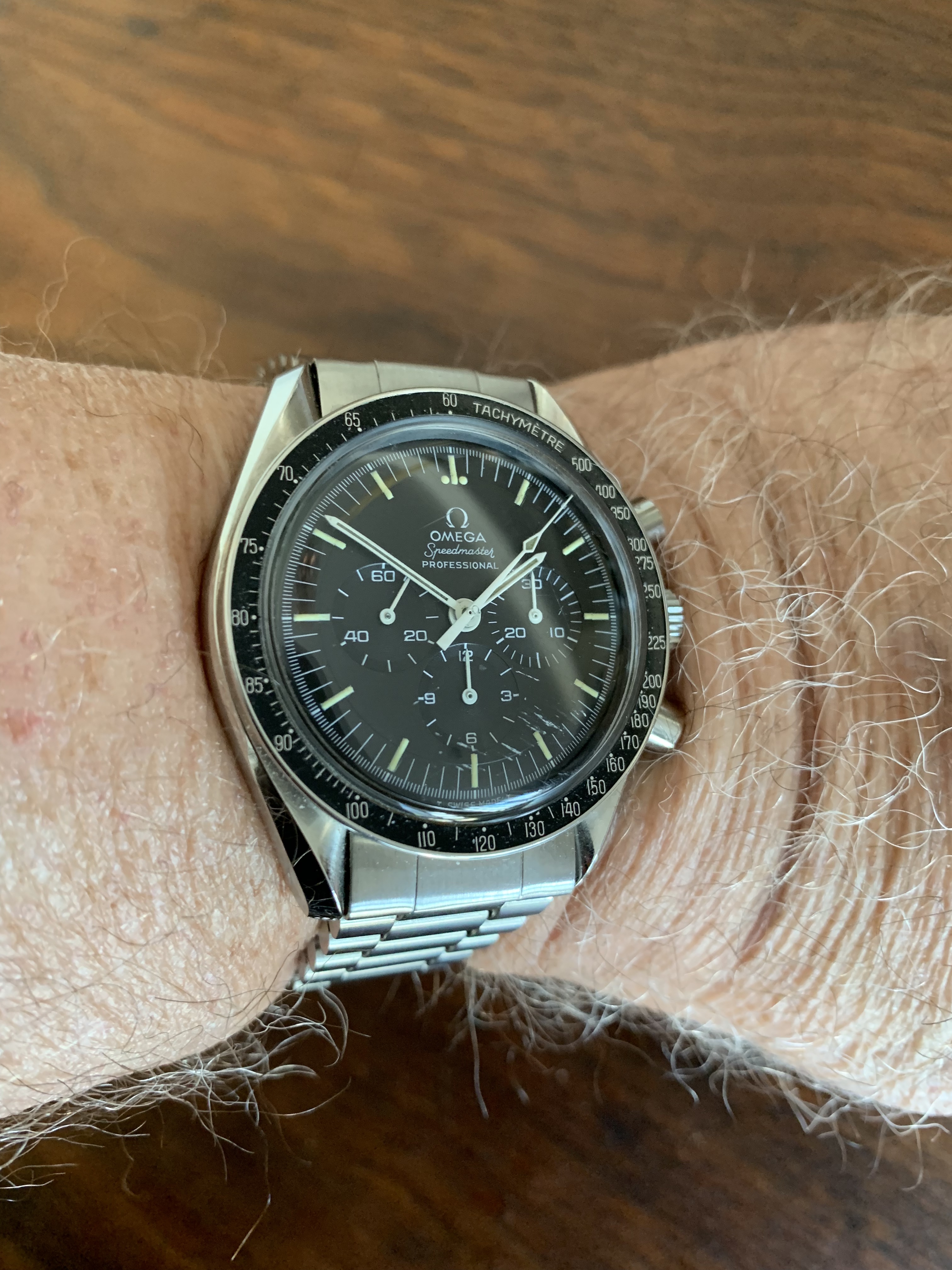

My watch with DON is 30584xxx so probably one of the last ones. Waiting for an extract but expected to be mid 1970.
