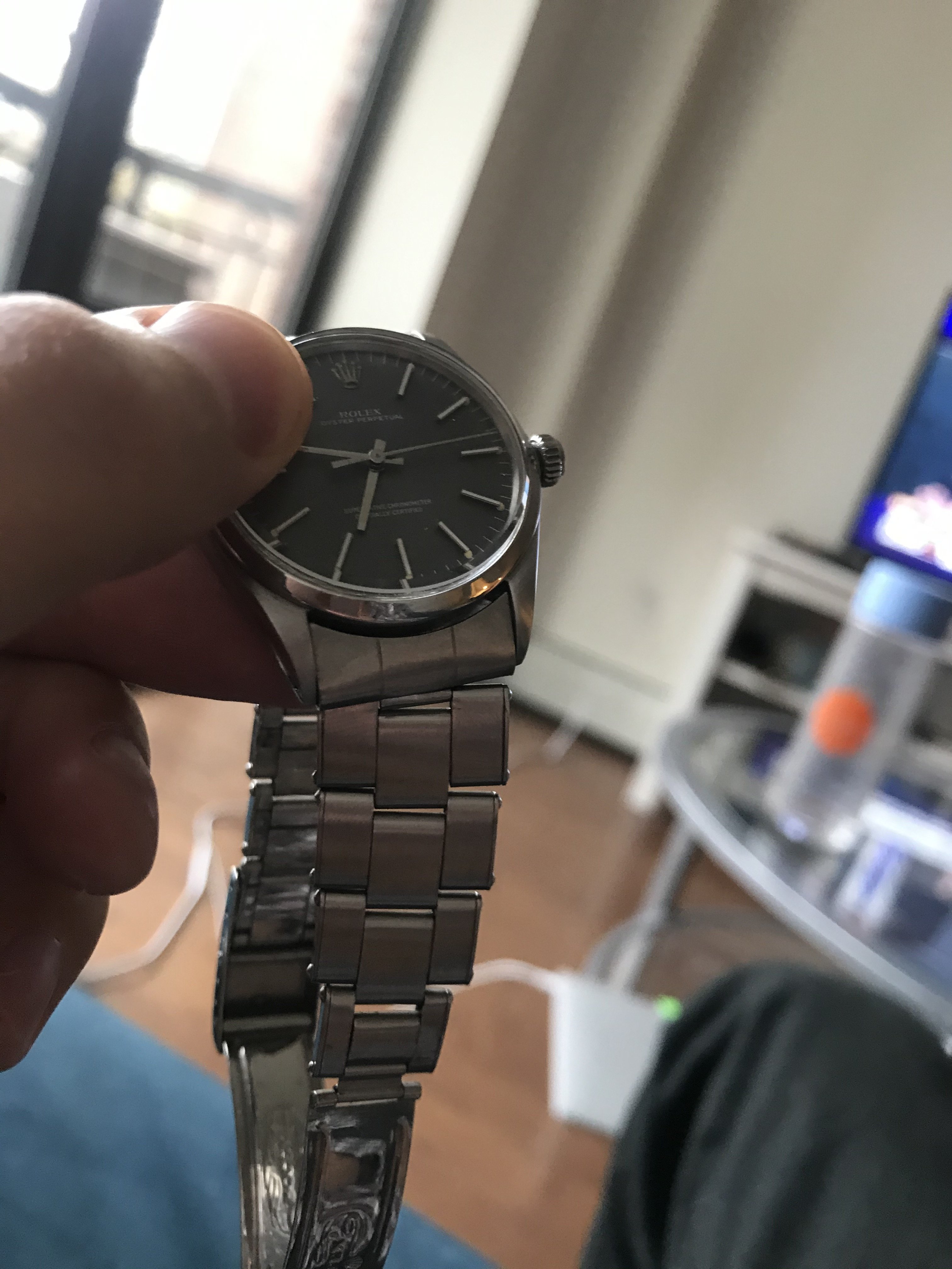

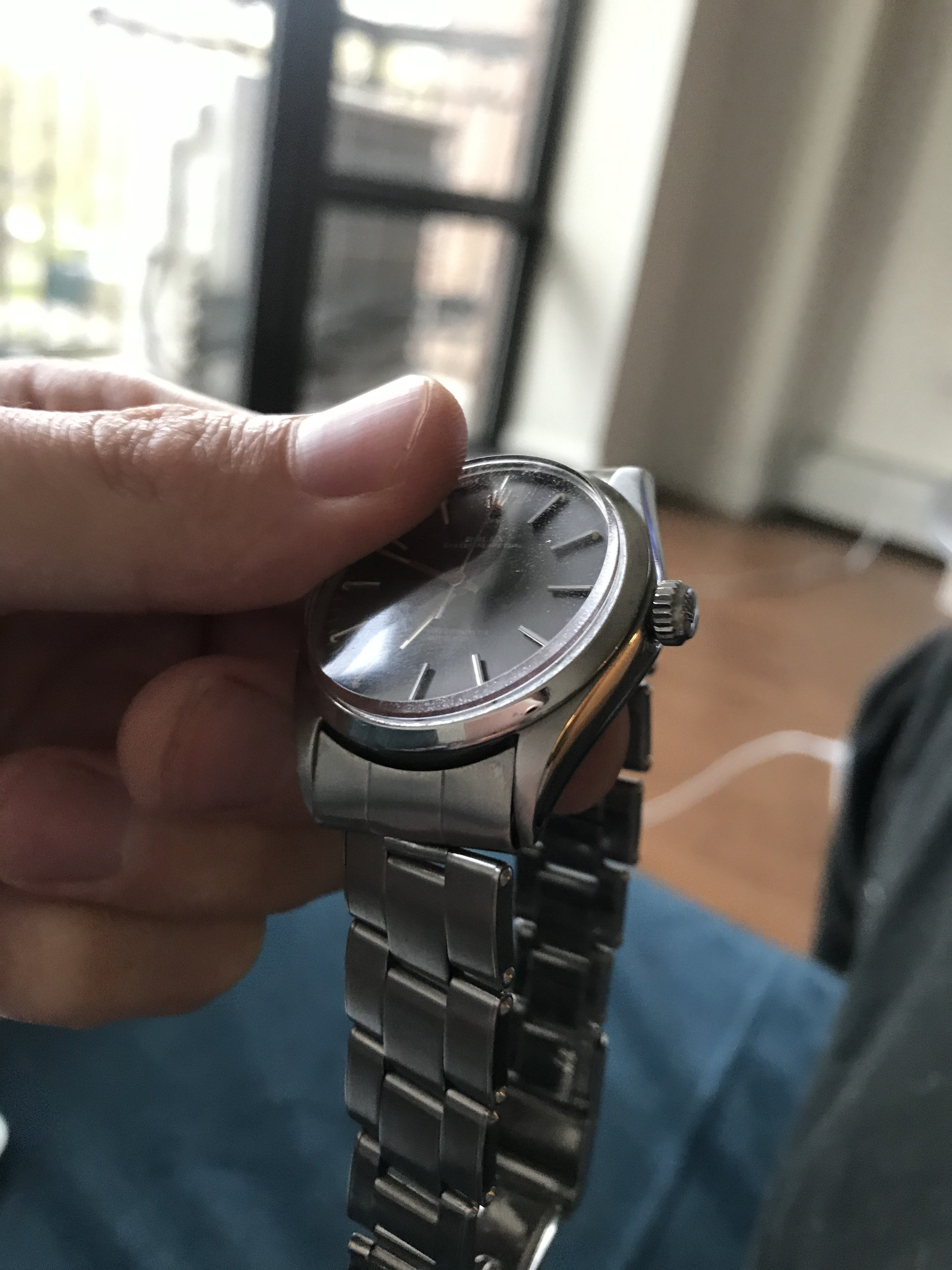

I've noticed an issue with the bracelet on my Oyster Perpetual from 1969 (ref 1002).
It's on a period correct 7205 Swiss Rivet 19mm bracelet with 12 links and 57 end links. The bracelet has light stretch for its age but I've noticed that on the link below "6 o'clock" the bracelet is twisting a fair bit. I've tried to capture this in the pictures.
Is this expected from these old rivet bracelets? Any suggested remedies?

That “T” piece at the lug end is made of flat stainless sheet of thin gauge, formed to a suitable shape. It is common after many years of wear for the metal to wear thin at the hinge pin, and this sort of problem is the result. At one time, those “T” pieces were available for repair. But probably no longer available. The bracelet is 50 years old, after all.

I don’t know anything about those bracelets, but I’d be worried to wear it in that condition! Looks like it could break at any moment. The pin connecting the link is supposed to be straight and one piece, correct? If so, then how is it able to twist like in the second picture unless it has broken in two?

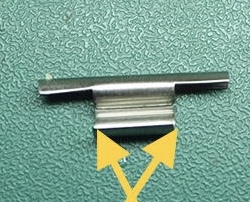

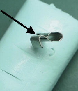

I’ve included two images of the “T” piece that has worn out on the bracelet. You can see how flimsy this component is, considering the job it had to do, and the expected lifetime of the piece. The arrows point to the area that wears thin over decades, from wearing against the rivet that’s runs through it. The only answer would be to replace those “T” pieces, IF you can find them! They are long obsolete, but the pictures might help you locate a firm that may still have them in stock.
