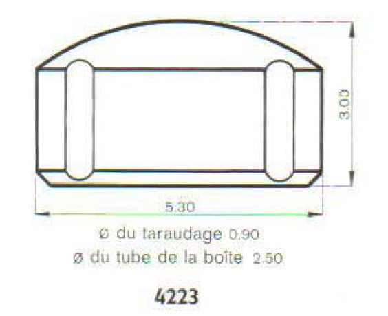

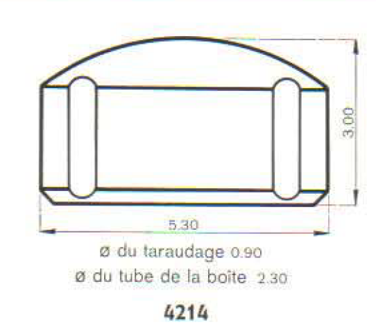

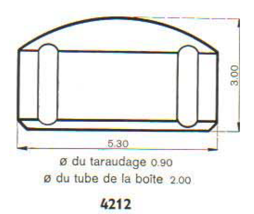

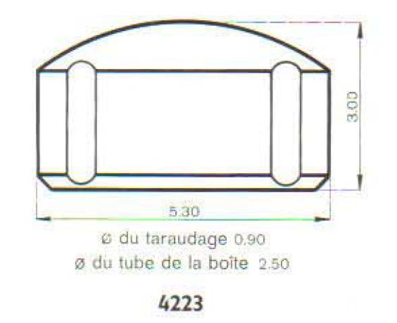

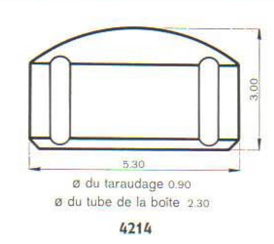

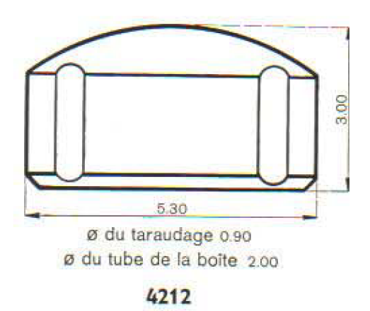

I *believe* all had the same stem size. However, some have 2mm tubes and some have 2.5mm tubes. You can usually tell by looking at a photo of the back. I’m happy to help if you’re not sure.. I’m also yet to figure out what the 2mm tube ones fit... but you need the 2.5mm tube.
Also, lots of newer replacements are available with newer logos. The correct originals would have had flat-foot omega logos, similar to the Speedmaster crowns.

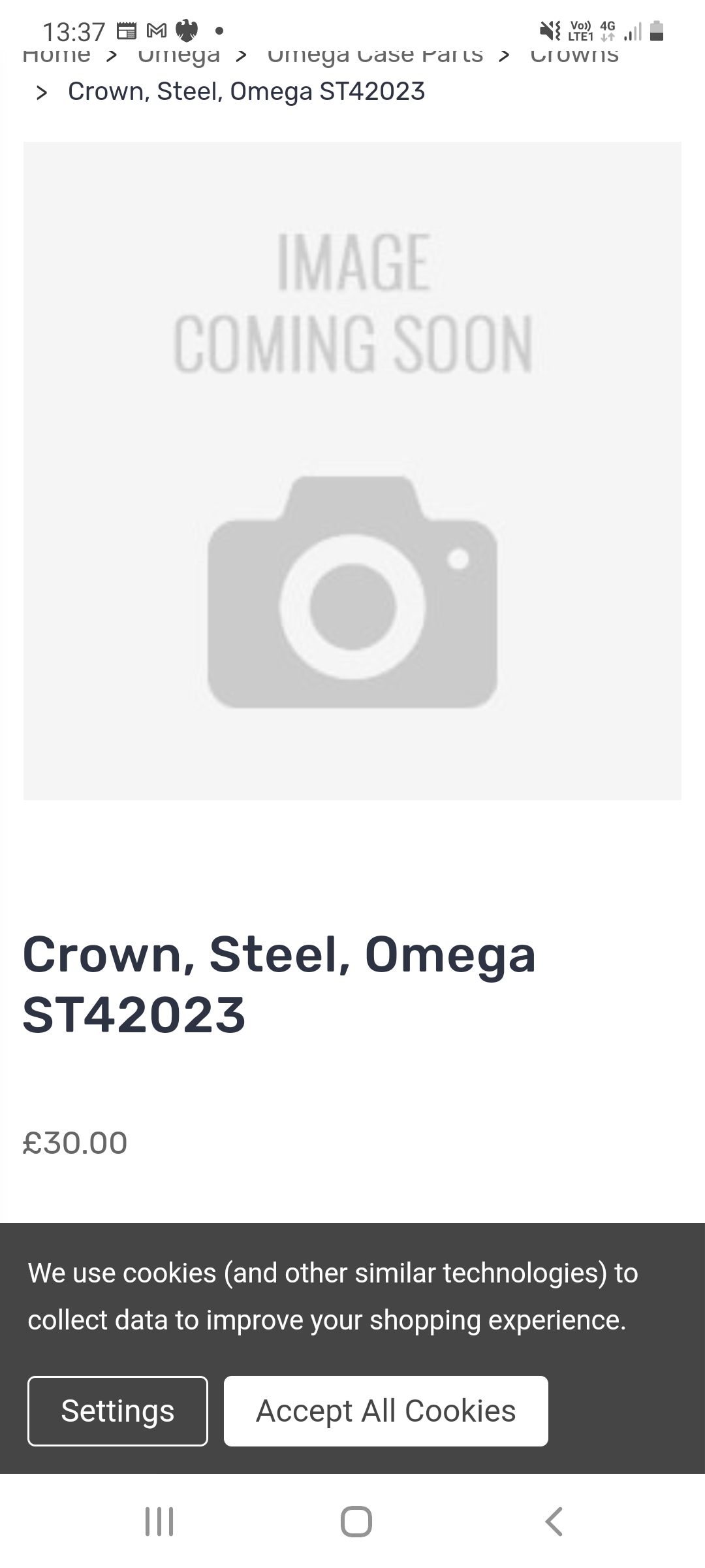

Hi, I believe I have exactly the same problem. @Archer helped me identify what I need.Here is what I found here in the UK.

This is available at Gleave and Co

It's a 42023, as referenced in the link I shared. Otto Frei will sell a Bestfit that may or may not be made by Omega for $25 or one could search using 42023 and see if an original can be sourced.
For example https://www.watchmaterial.com/omega-watch-crown-stainless-steel-42023/
