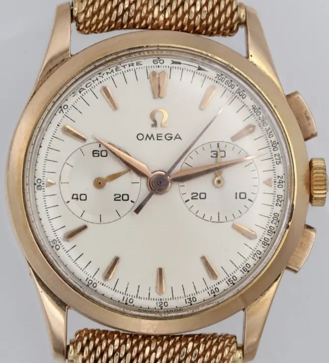

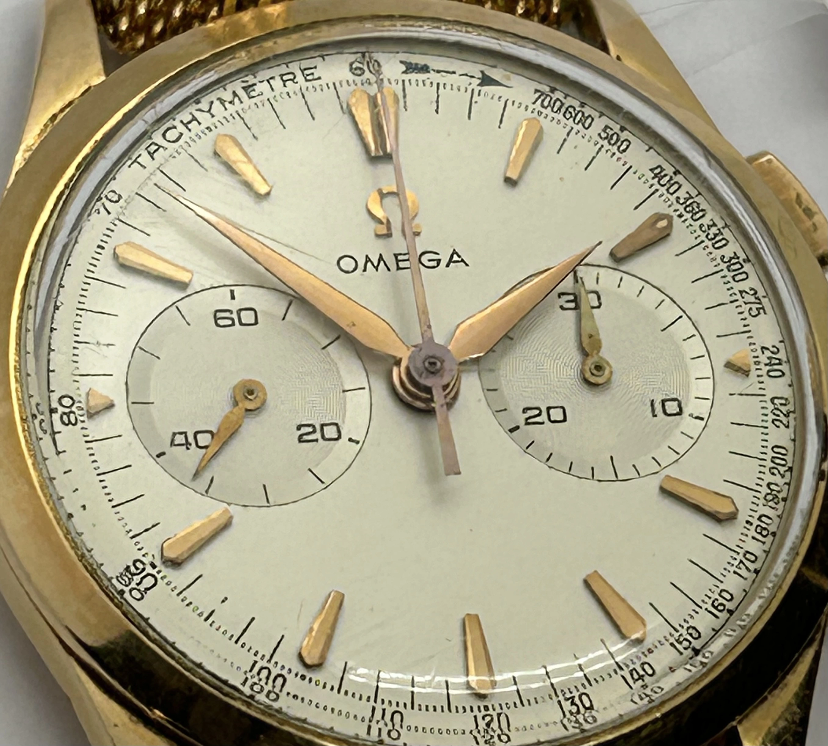

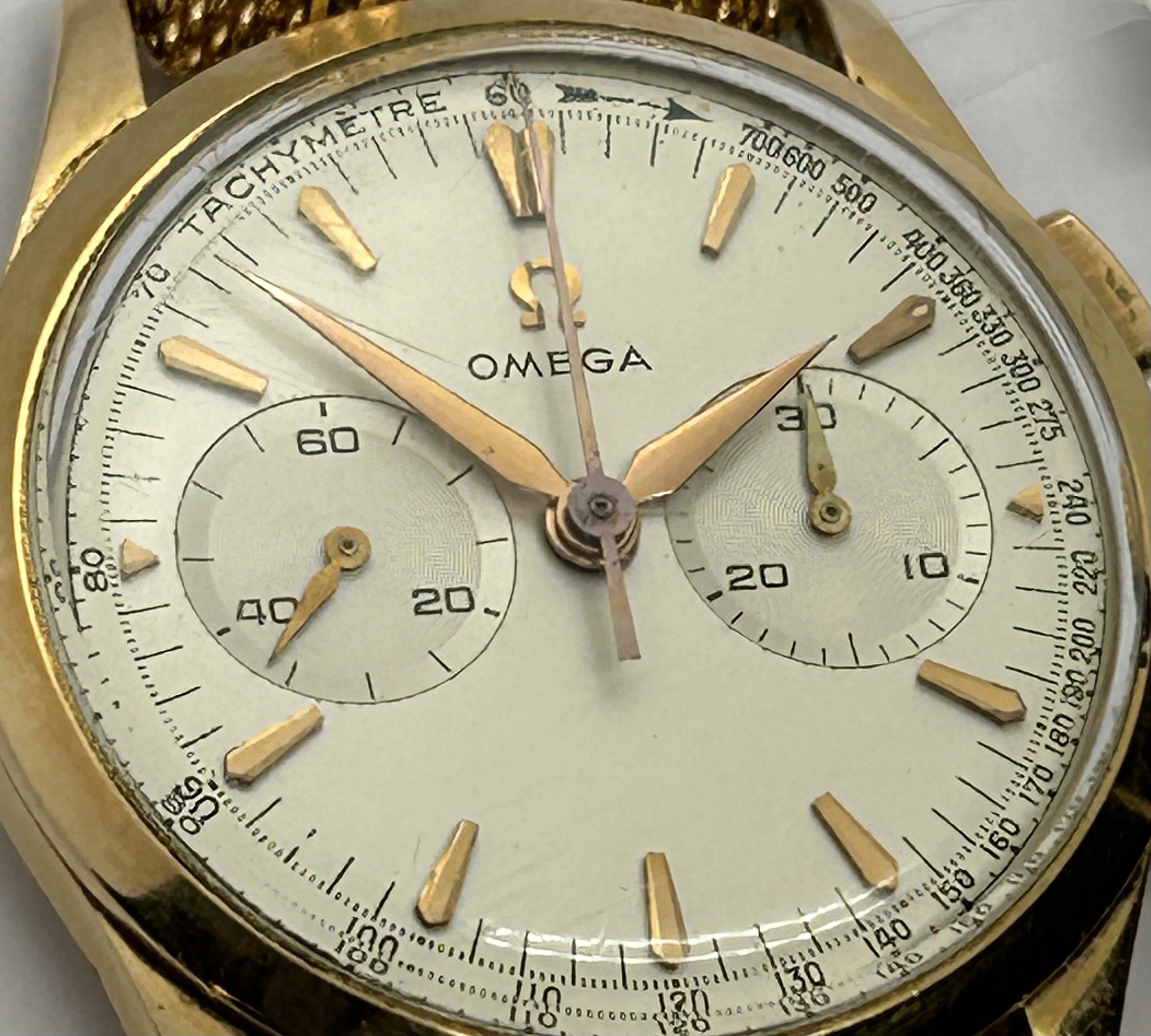

Hi everyone, I am thinking of purchasing an Omega 2872 with cal. 320 but I cannot find any “source of truth” online in terms of pdf catalogs of the era. I am trying to understand whether this dial is original or reprinted. A couple of red flags come to my mind, first of all the fact that the dial is very clean for a 80+ year old watch.
Thanks in advance for your advice.

I cannot immediately tell. These are very hard to reproduce convincingly, and for me I'd want to see higher resolution photos, preferably from slightly different angles.

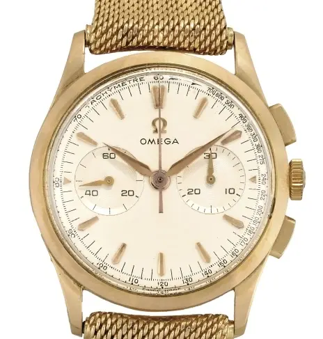

What happened here?
2,184
2,397
Someone definitely messed with some of the minute markers (re-painting). That 12 oclock marker is messed up as well. Theres a few other markers that don't look straight.
My best guess is someone tried to clean the dial and took off some of the markers and touched the dial up.

The OMEGA and sub-dials look pretty good.
Yeah, I agree completely, which makes me lean towards 'repaired' side rather than a whole-cloth redial.

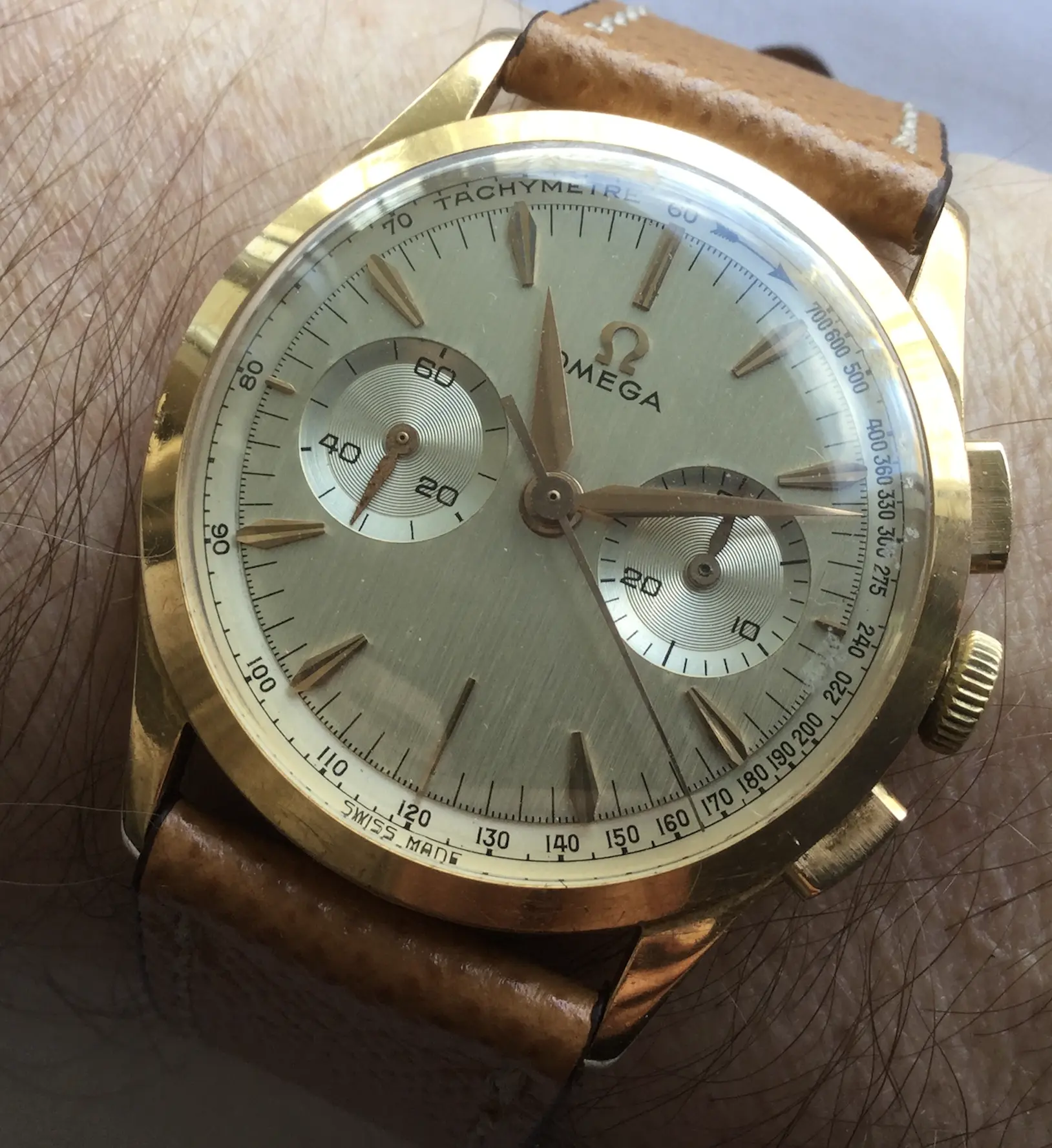

welcome @munich.watch
I can only commend you on your choice of watch - these watches are very lovely to wear (and if they were only a few millimetres larger would be worth significantly more than they are)
There is no definitive information on these two-dial chronographs and pretty much all that has been written about them is here on OF (and it isn't a great deal but you can search the site for threads about them)
Due to a lack of water-resistance most dials on this reference have been repainted due to damage from water ingress.
On top of which the original dials varied depending on the year of production, with different hands, furniture and subdial 'outer ring' sizes.
Regarding the watch you posted, the pictures are very poor and could lead to a 'misdiagnosis' of the authenticity of the dial.
The incorrect crystal and retaining ring are doing the layout no favours at all by crowding the outer tachymetre ring.
The scratches on the crystal don't help either - distorting the text.
There is one initial 'test' that I always apply to these watches and that is the '2' test in the subdials.
It would be sensible to think that they should match but in an unmolested dial they differ slightly - with the right hand dial 2 having a more acute angle between the sloping stroke and the base, whereas the left-hand dial 2 has a rounder angle.
Whilst the pics are poor I think this watch passes the '2s test'.
Plus I think the concentric rings are present - which often disappear with a redial.
The furniture does look as though it has been messed around a bit- especially the 12 markers but this could be quality control.
The 9 marker is twisted too but we have seen many rotating stars on Constellations where the marker is only fixed with a central peg.
in summary - we need much better photographs.

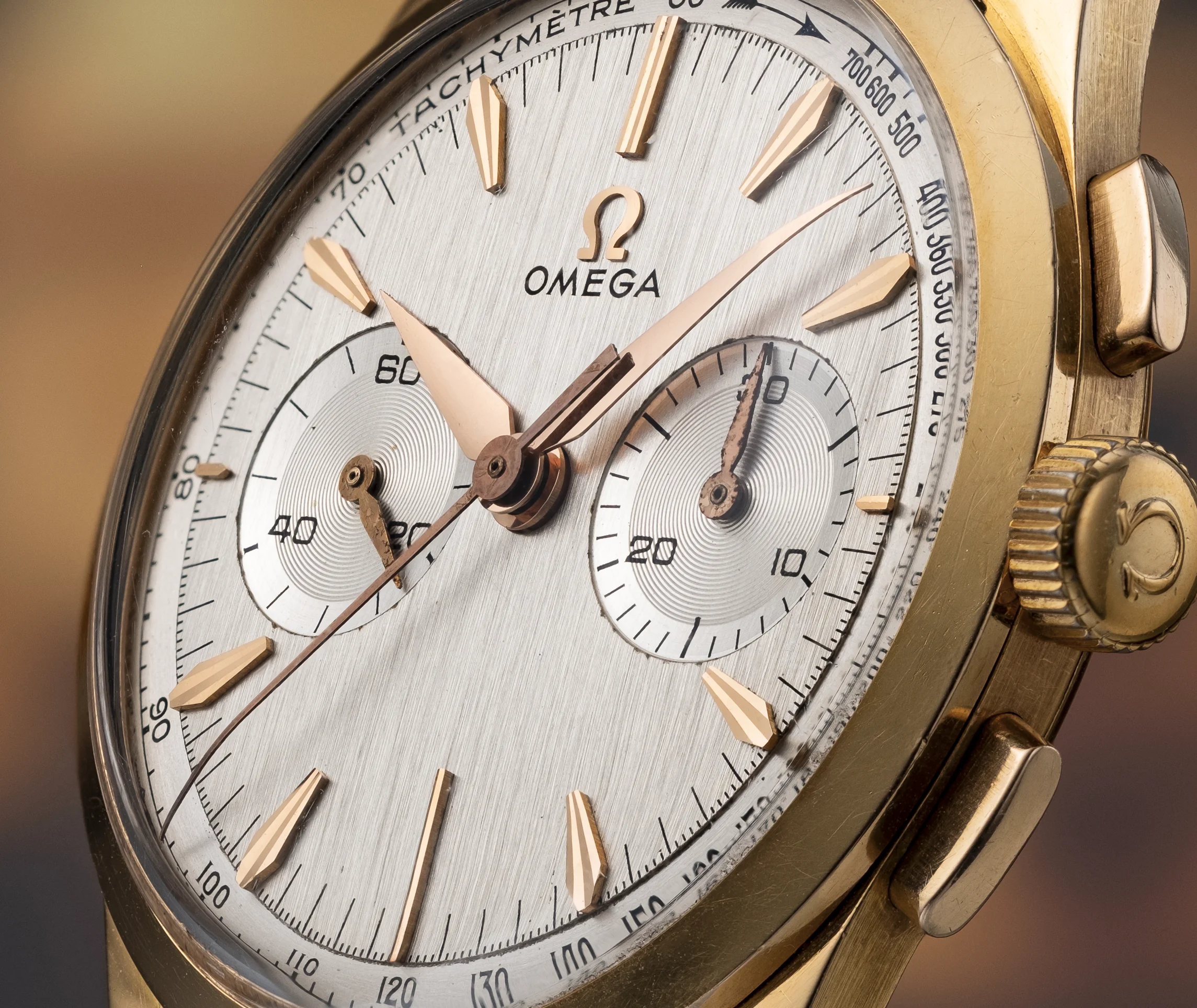

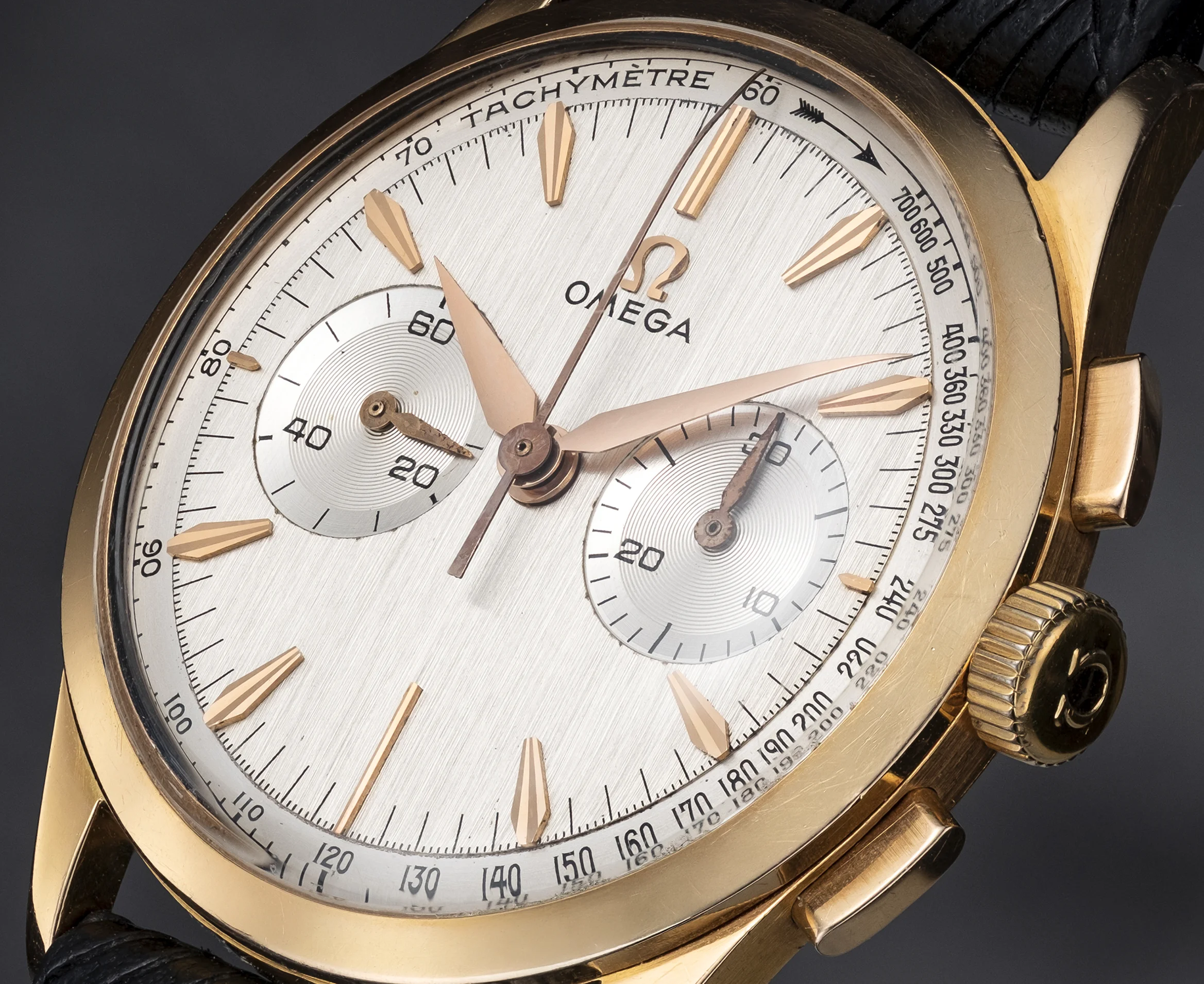

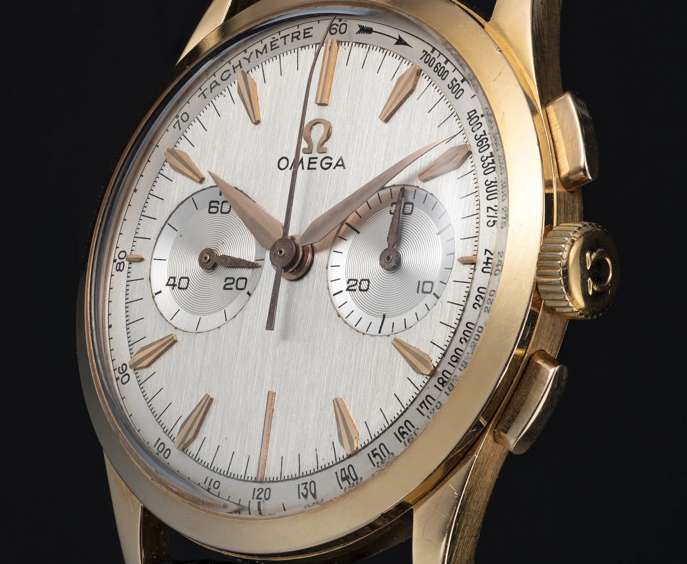

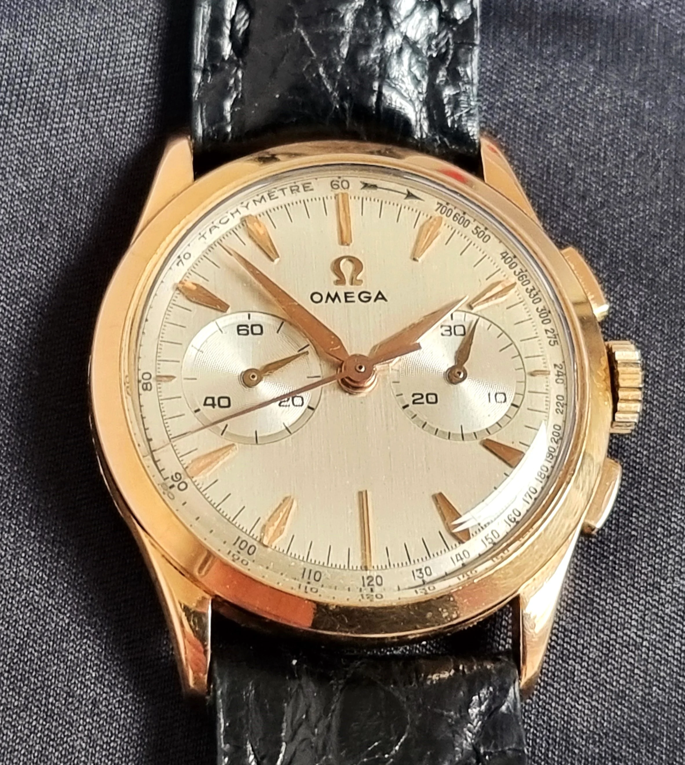

Here is my slightly later pink 18k version for reference (note the different 'coffin' furniture, wider subdial outer rings and correct differing 2s)

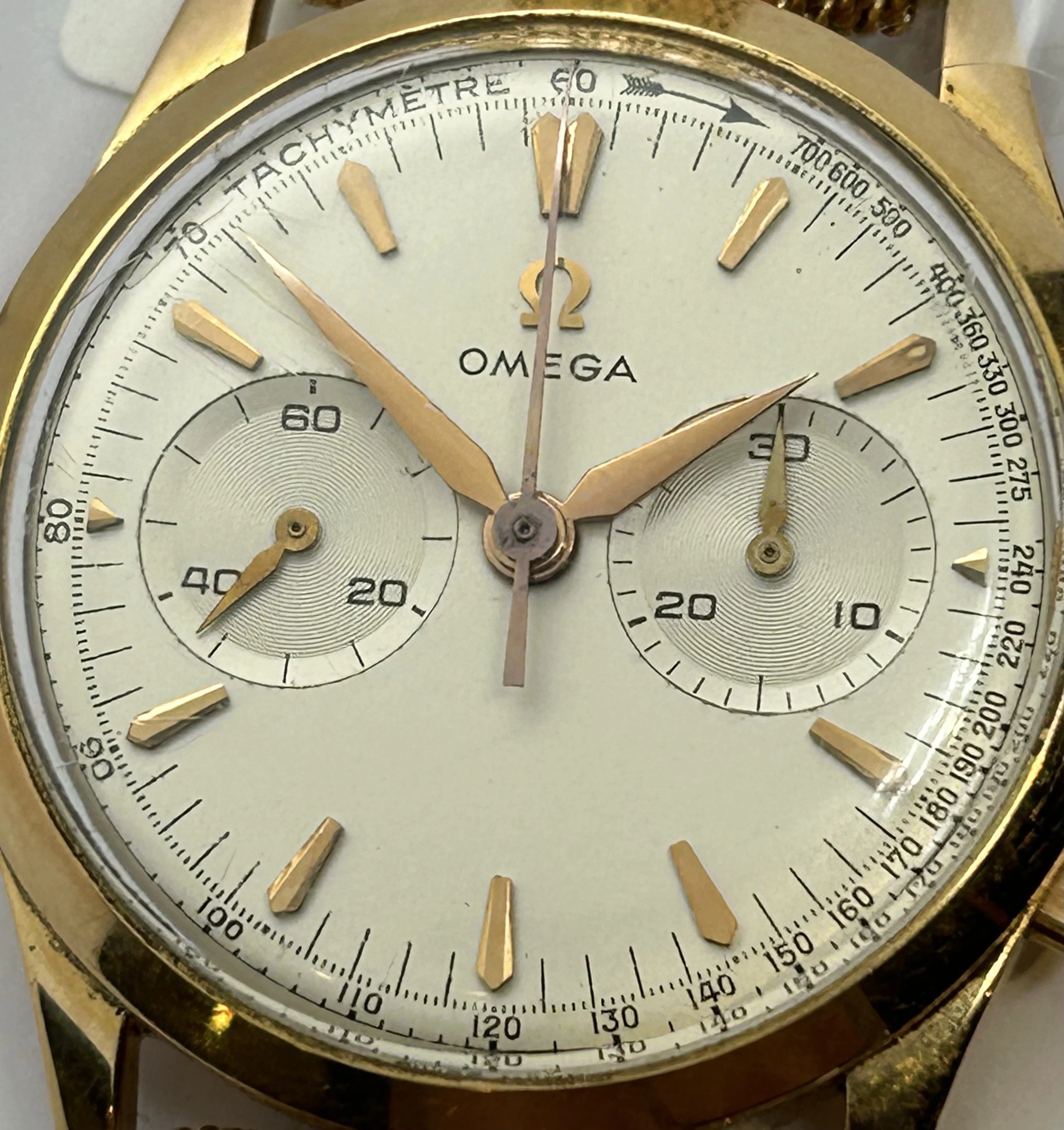

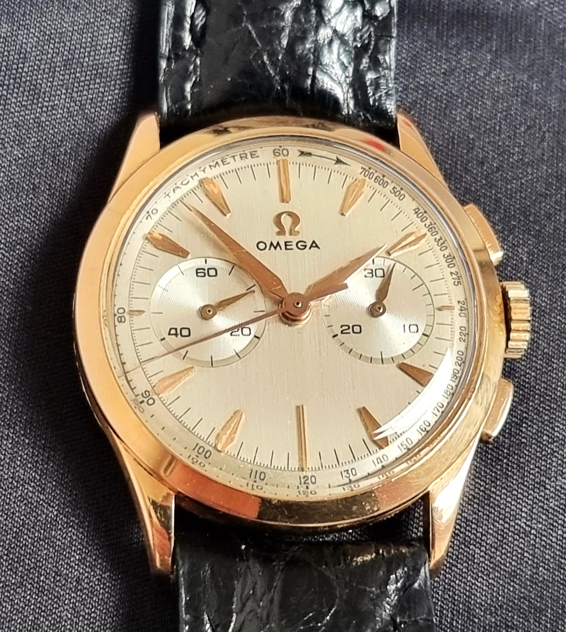

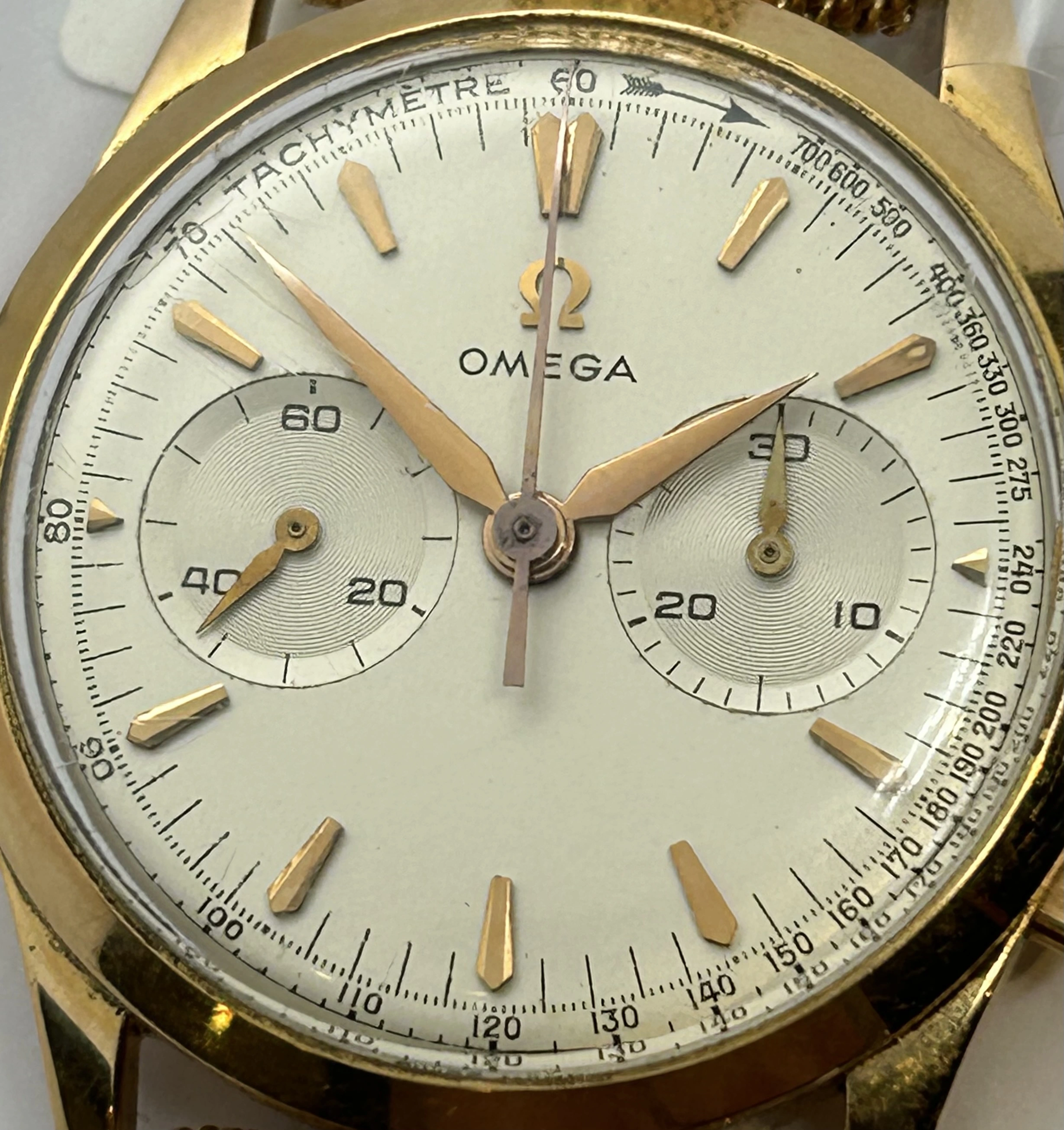

Thank you so much for the answers, I’ve already learned so much. I’m attaching better pictures hoping that they help with the analysis, although they do not solve the doubt at 12 o’clock since it’s covered

Your arrow feathers look good, the differing numbers appear to check out.
The 9s look like they are open, the 6s are closed - which is correct - except the large 60 at 12 when the 6 should be open
The subdials look correct.
The problem is that even the new pictures are nowhere near enough the quality required to assess the dial with certainty.
You need to be able to see all numbers clearly and compare them individually to a known (contemporary) genuine dial.

There are a couple of threads on genuine versions of these watches, so there is some info on them to use as comparison (and at least one sales advert)
- and for what it is worth, while the 'OMEGA' text looks a little bold in the pic, everything else checks out IMHO. (yours having the same dial as mine but with slightly earlier narrower rings around the subdials)
Those are not great pictures, but I think they tell me that the crystal is in pretty rough shape, which explains all of the anomalies on the small ticks that I saw. In these pictures the indices also look pretty good too, though the 12 oclock one is still pretty blocked off. I wonder if the crystal shape is the reason for the goofiness we saw above.
I personally wouldn't spend 'top dollar' on this one unless I could see it in person and figure out whether the concerns are visible/real or not. BUT, I'd probably pick this one up if I had the chance and wanted one. It definitely needs a clean, and almost definitely needs a service, so make sure you add ~$1k + losing it for 6+ months to your mental math here (in addition to the difficulty of finding a good watchmaker!).

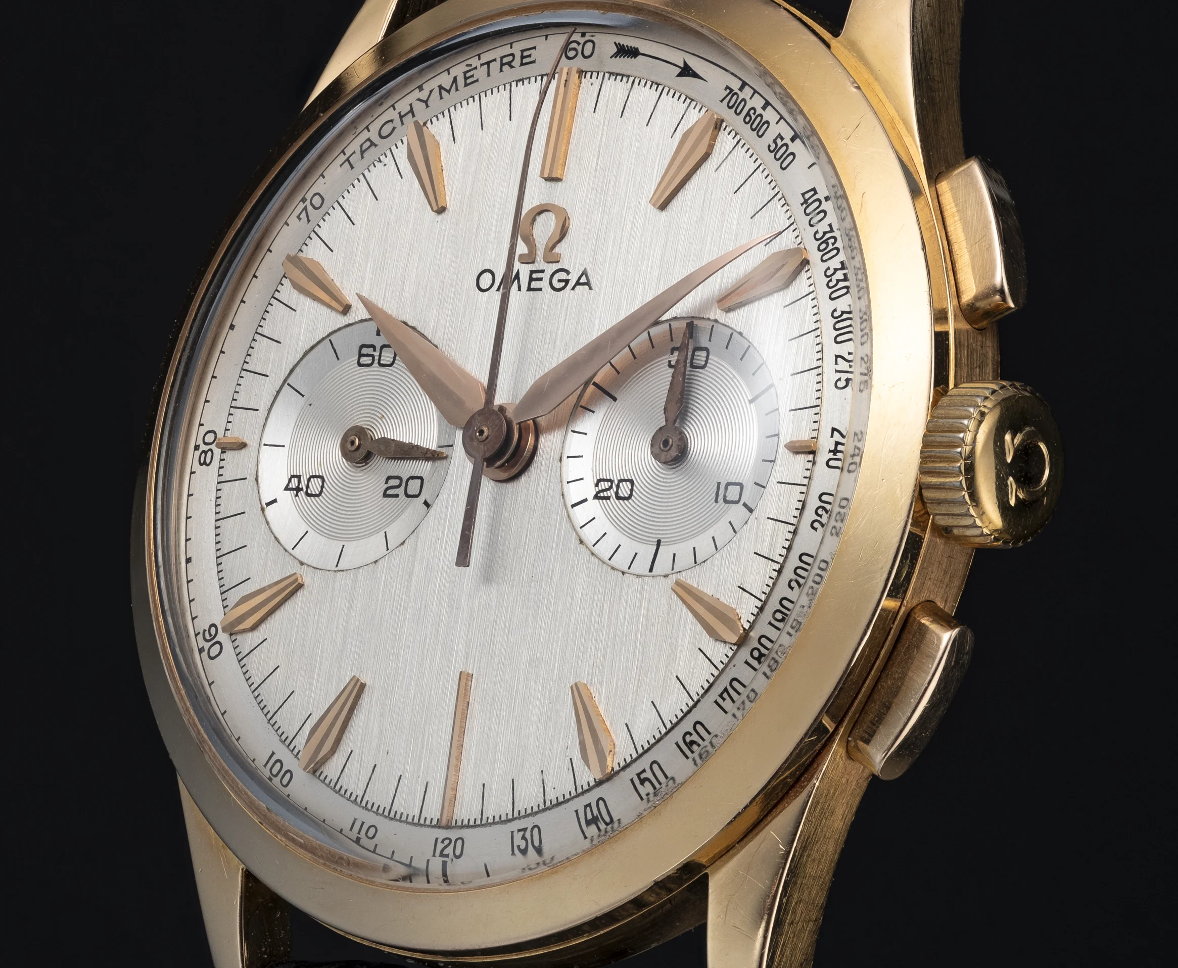

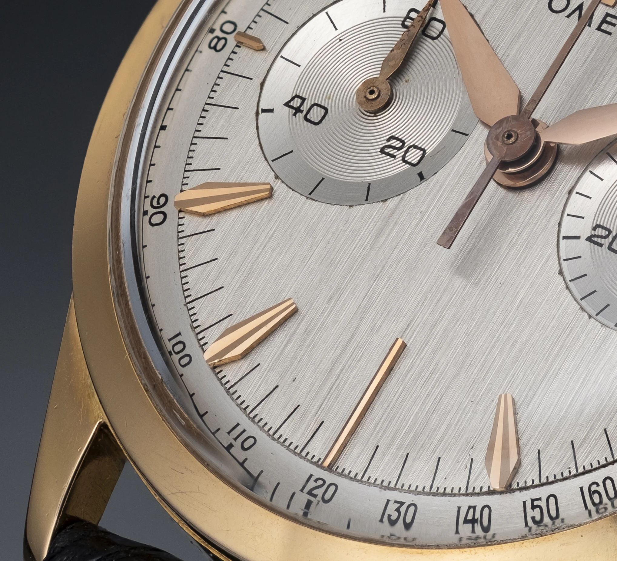

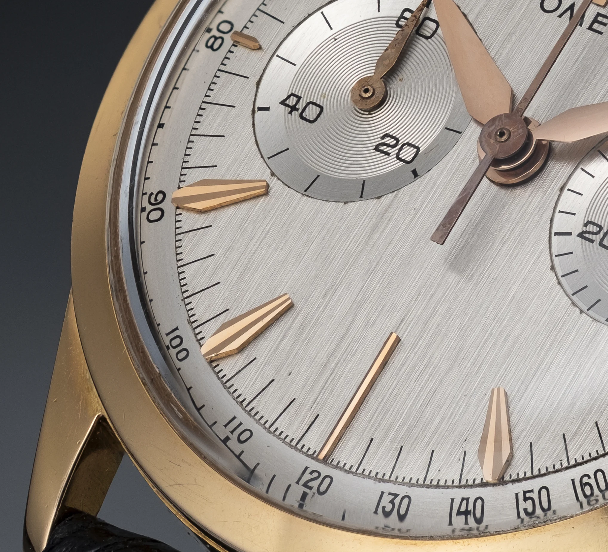

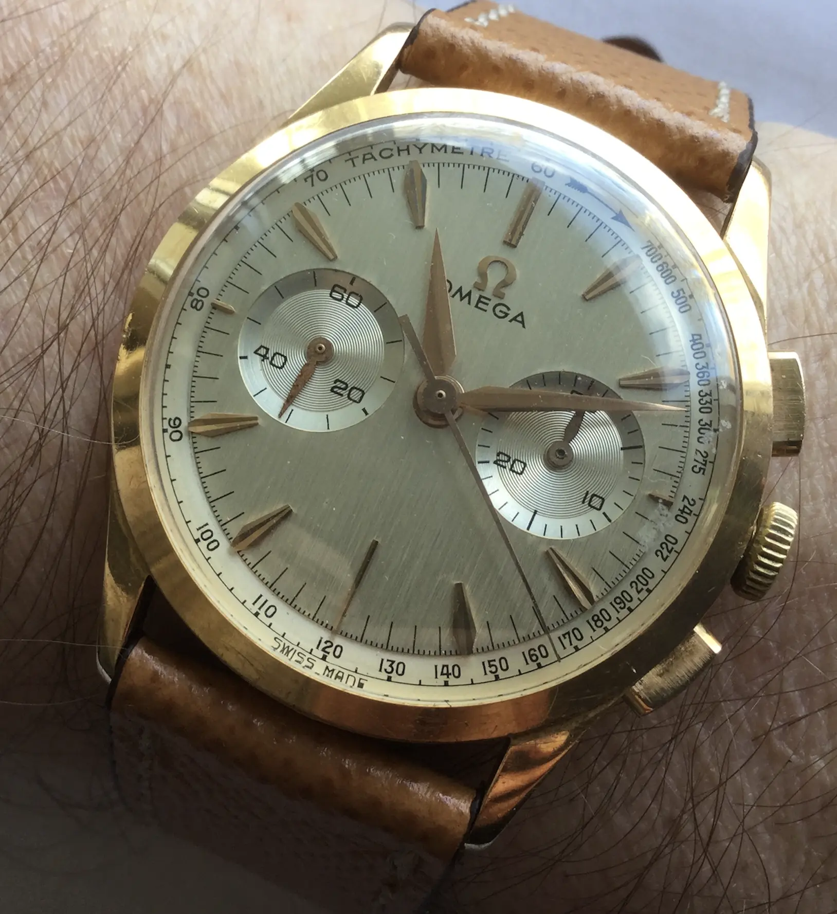

Not sure, but it doesn't look too off. For me, the more interesting aspect is that, as these watches lack protection from the elements, there should be more patina.

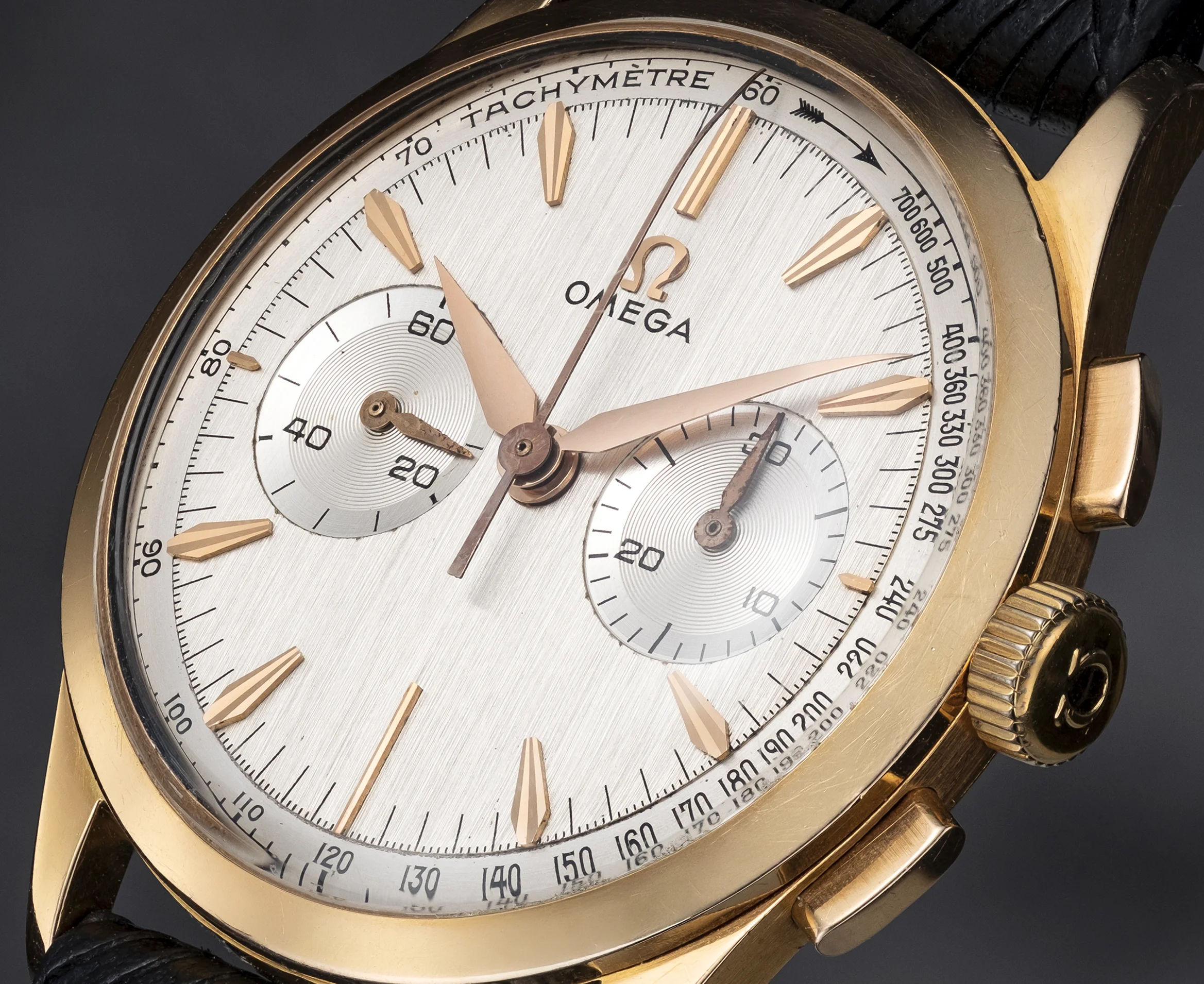

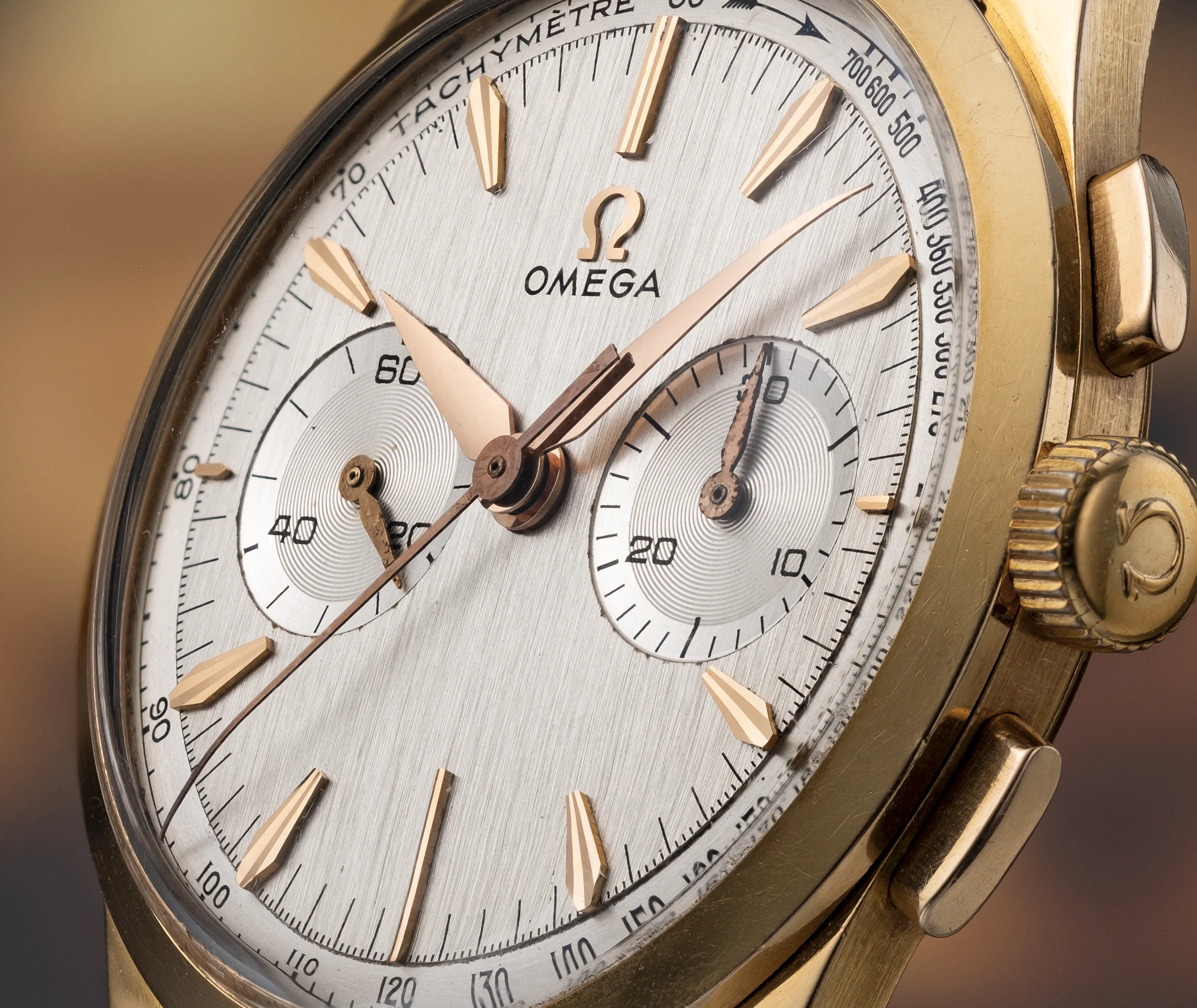

Here's a vertically brushed 2872 dial. Perhaps these macro shots are useful.
