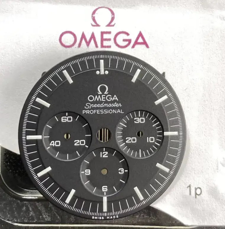

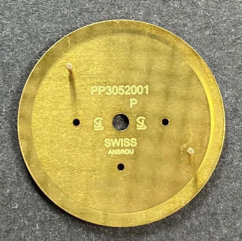

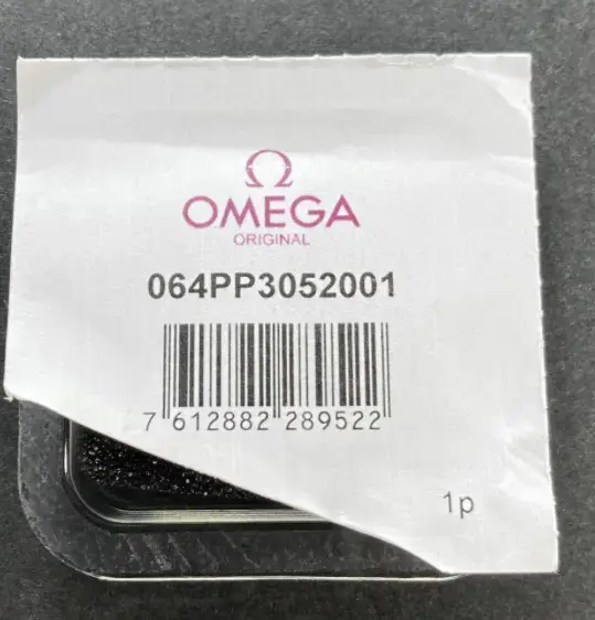

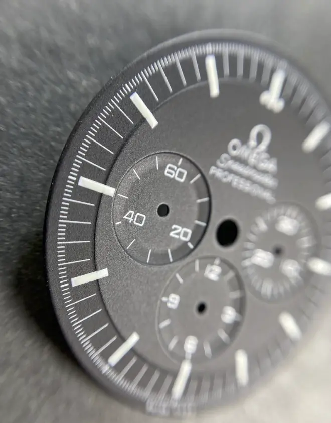

Hi all,

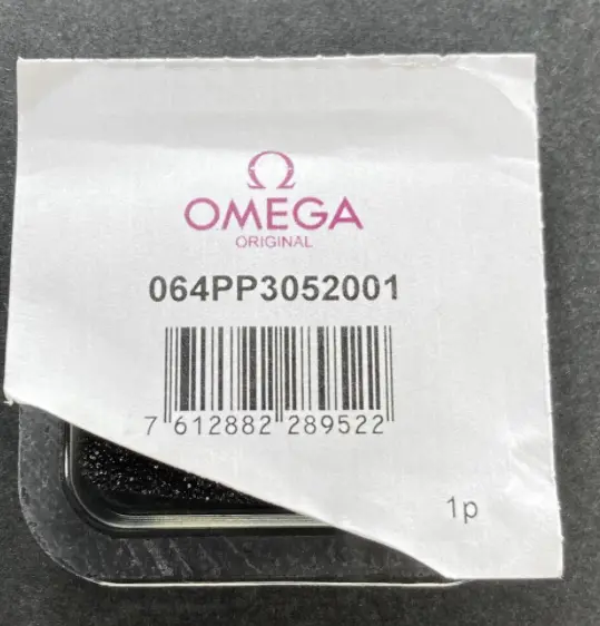

I’ve recently seen photos online of what appears to be a stepped dial (step dial) for the Omega Speedmaster Professional 145.022, with the service part number 064PP3052001. This is surprising, since most sources say modern Omega service dials for the 861/1861 are flat, not stepped.
Has anyone here received a stepped service dial from Omega recently, or heard of this happening?
Is it possible Omega has started producing stepped service dials again?
Would love to hear your experiences or see photos if you have them!
Thanks!

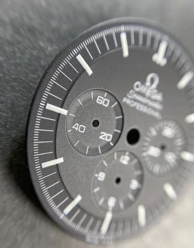

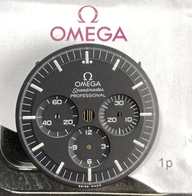

Maybe not the original blister for this dial, i think this dial is for the cal 3861 watches which do have a step.
6,484
31,920
3861's only have 2 hashmarkers between the seconds.
1,992
3,883
Good spot ! Which leaves me puzzled ...
30,276
78,129
It's too bad the date code is cut off the package, but I'm pretty sure this is a fairly new dial based on the location of the date code and the printing.
Clearly not for the 3861, and this dial is for all the 1861/1863 based watches, so from the 35705000 to the last watches before the 3861.
