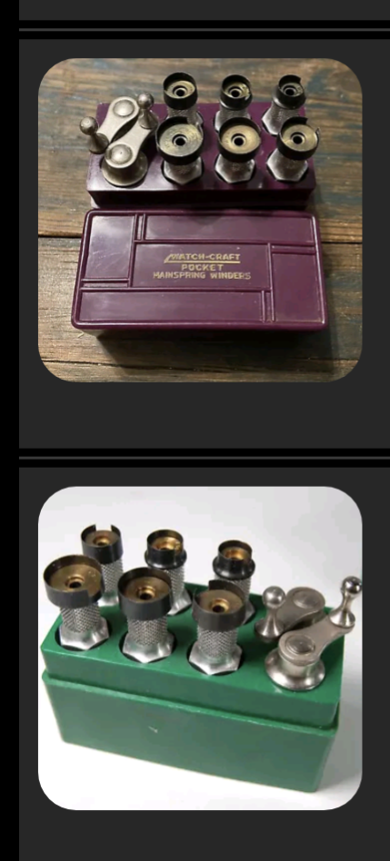

Before I had the set on the left, I used the set on the right. Smaller set so a little more limited in sizes, but it works...
Made by Watch-craft, and you can usually find these sets much cheaper than the full Bergeon set.
$170 for the cheap Chinese one. $200 for a watch-craft. $600+ for the bergeon. I know which one I'm buying in a few minutes. Thanks, as always, Al!
Is there a difference between the purple and green sets?

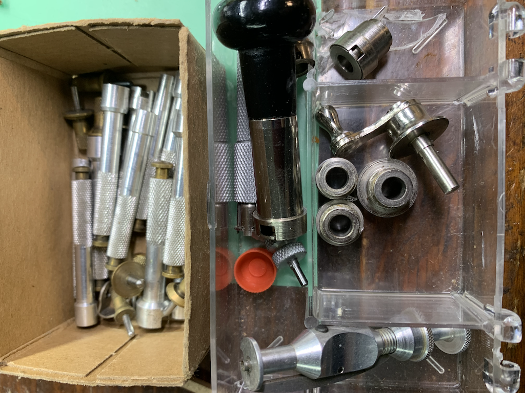

Here are some of my 'vintage' winding tools. I have acquired over the decades. I find the ones on the right do not work very well. I think the lower one is actually a spring extractor. Never can get it to work. There is also an adjustable one under the L&R handle. That is the worst of all worlds.
I like the 'small' ones as I tend to work on smaller watches. The main issue is the center pin never seems to quite fit. Not sure why the do not have some sort of adjustable grabber. I have kacked a few springs over the decades (like the Omega 650 one) As the centers can be brittle.
When I can I now get a new spring or use one of my NOS springs. Mostly I use these to put springs into washers so they do not tangle in the box.
The reason I got them out, is it looks like I can save the GW spring from El Rusto. and since I was photographing El Rusto I I figured to show them here as well.
