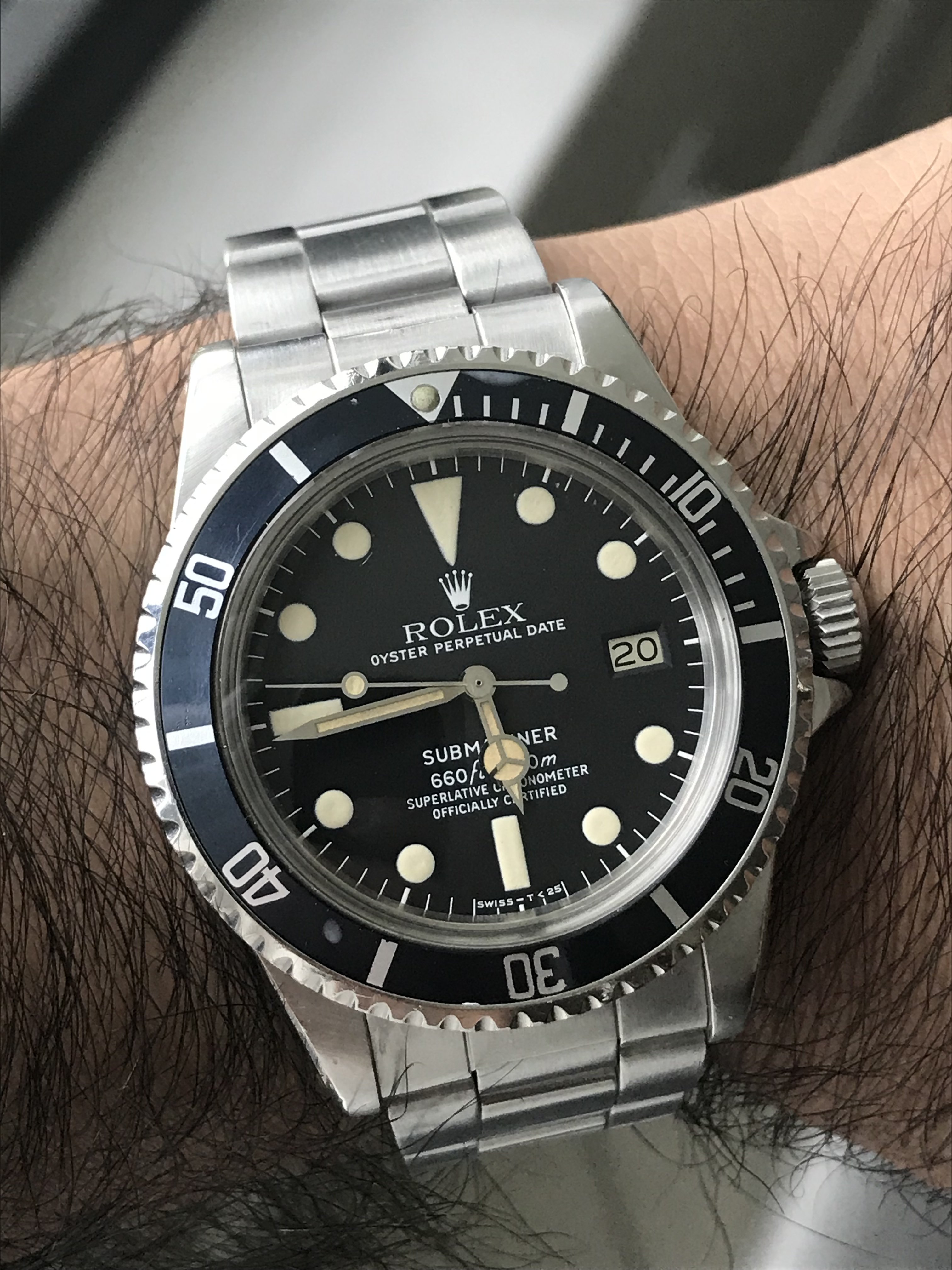

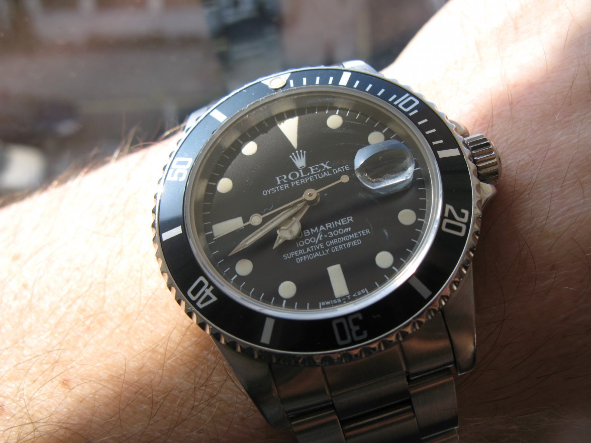

    I've been looking at vintage Submariners for a while. When the prices of 1680s got out of hand, I broadened my search, and recently picked up a really nice 16800. Serial dates it to 1980. 100% original, including the VE code bracelet; never been in the same room as a buffer; flawless dial. It recently underwent a full service at LA Watch Works, including stabilization of the hands which were starting to show some tarnish. It's the most accurate mechanical watch I own: +5 seconds in 2 weeks.
    I do love acrylic crystals though, and against the better judgement of everyone I asked, I decided to put one on the watch. I took a chance on an aftermarket crystal from eBay, and it fit perfectly. Here's a brief pictorial of the tools involved:
    1. Tried to remove the caseback with a standard tool; couldn't. Apparently LAWW really torqued this thing down. crystal0.jpg
    2. Went with the LG Openall to get it off; that worked:
    3. Removed the bezel with a Home Depot paint scraper and a Fayette R. Plumb hammer from the 1920's:

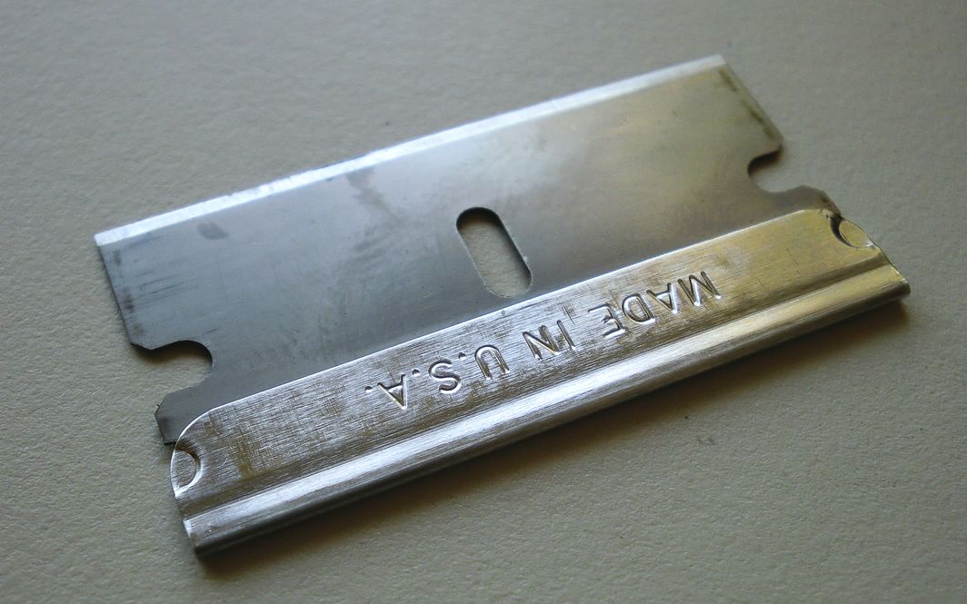

    4. The crystal retaining ring on these watches is extremely tight; sometimes it's hard to tell it's a separate piece from the case. I carefully lifted it a tiny bit with a razor blade:

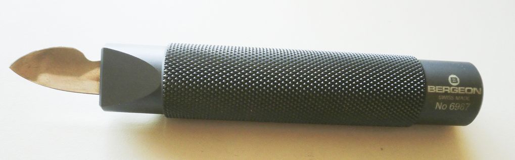

    5. Then I used an eBay bezel tool to lift it most of the way:
    6. And finished popping it off with a case knife:

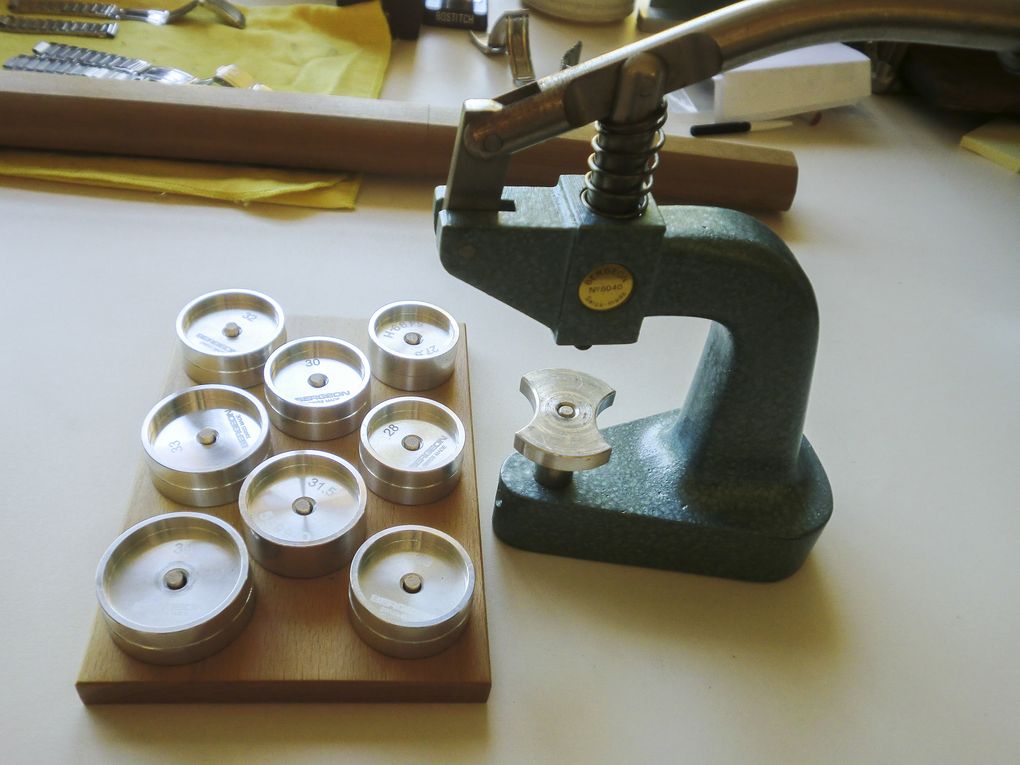

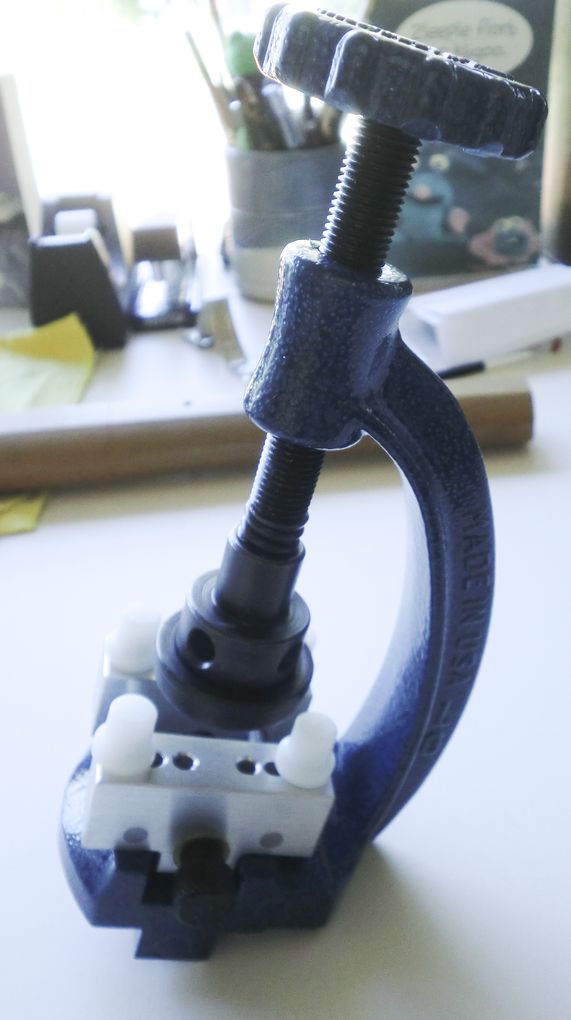

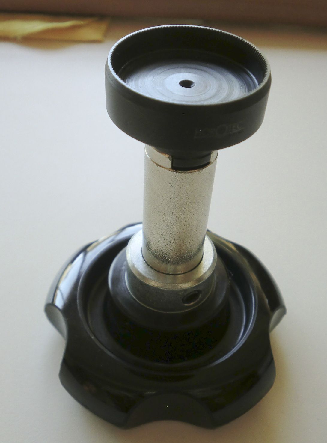

    7. I used a crystal press to (a) remove the sapphire crystal from the retaining ring (no damage, can be re-used) and (b) to install the new acrylic crystal:

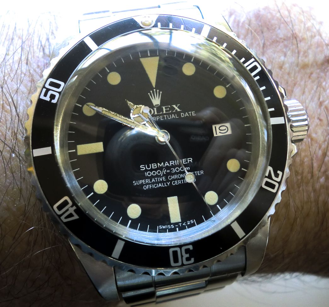

    I love the result. I understand the watch is no longer waterproof, but I have Seikos and Seamasters for diving.

  2. Meme-Dweller Oct 19, 2018
    1,921
    3,015
    Great (and brave) work you did. The crystal looks kinda weird on the watch, though, because it's more curved like on a Speedy than mostly flat like on the 1680. Also, no cyclops.
    mayankyadav, watch3s and 77deluxe like this.
  3. wsfarrell Oct 20, 2018
    2,441
    4,133
    Thanks. I don't miss the cyclops, but the crystal is indeed not identical to the 1680. Having done this once, the second time will be a lot easier--so I'm on the lookout for acrylic crystals of the right size that might be a little flatter.

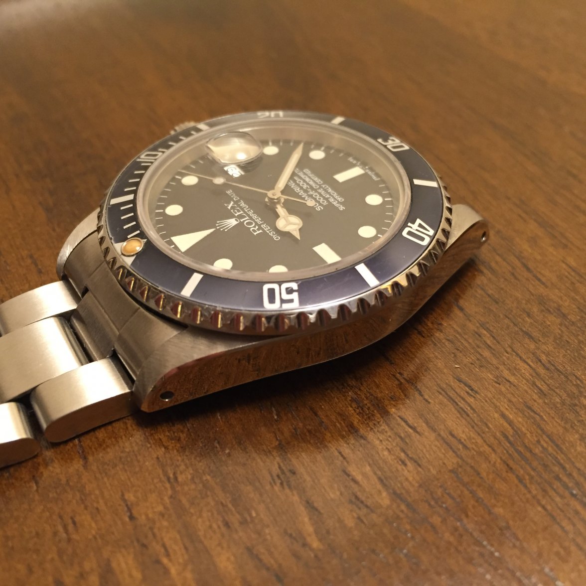

    I also have a 16800 and dislike the cyclops. I’m not sure I’d go as far as replacing the crystal but can the cyclops be popped off?
    I’m thinking about doing the same with my 16750 (which does have acrylic)
  15. fergusm Feb 3, 2019
    250
    661
    Forgot to include a photo of my 16800
