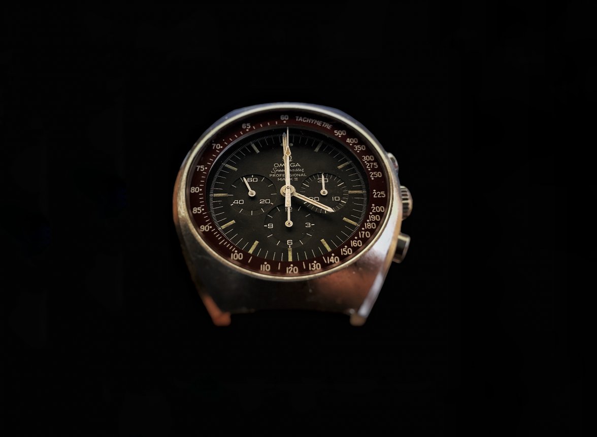

Hello everyone! My name is Tyler Simon and I am a 19 year old watch enthusiast studying mechanical engineering at the University of Michigan. First time poster here and I wanted to share with you an interesting build that I have been working on for the past few months. I realize that it may not be up the alley of the Omega Purists, (I totally understand) but this watch is 100% for me. I like to build and tweak things to make them my own for my own purposes. So I hope you can look at it that way and appreciate it in its own way! Thanks for taking the time to read, and I am excited to join this community. I do also have a completely original Omega Project that I will be sharing as well when it is done, for those looking for something a bit more factory spec (and 80's!!).
The final result of my "Perfect Speedmaster mk.II Build"

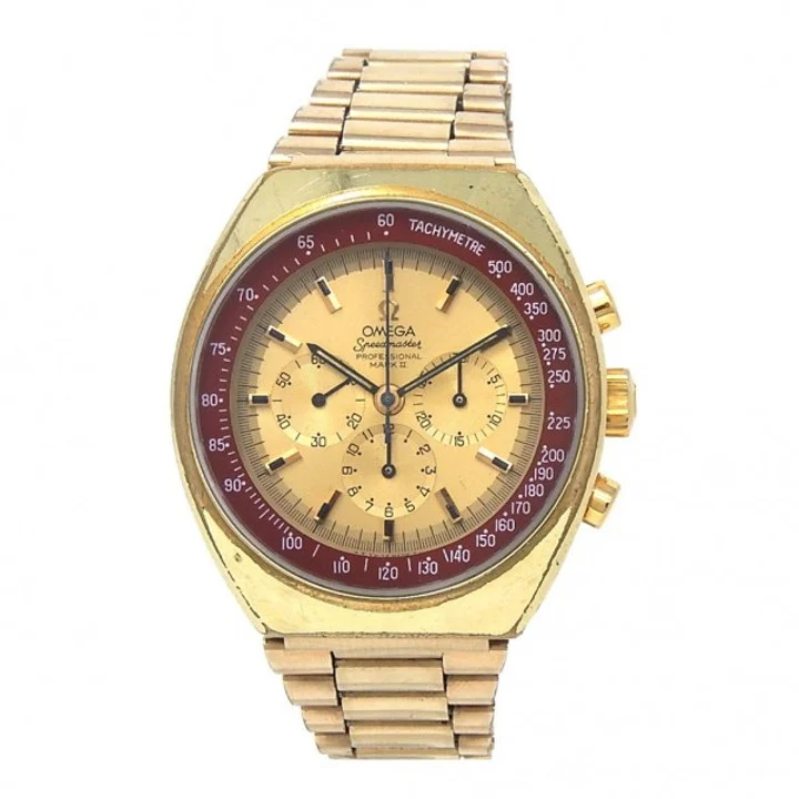

An exemplar 145.034

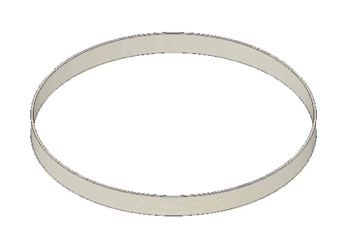

I ordered a new maroon crystal. Once it arrived, I got the dimensions that I would need to make my custom gasket to adapt the crystal to my case and CADed it up so I could 3D print it on the schools J750 printer.
The gasket that I made in Autodesk 360.
Once I had everything that I needed, I put the printed crystal gasket and crystal into the case, it looked just like I had hoped and fit perfectly! No Omega specific tooling require, my standard crystal press did the job just fine.

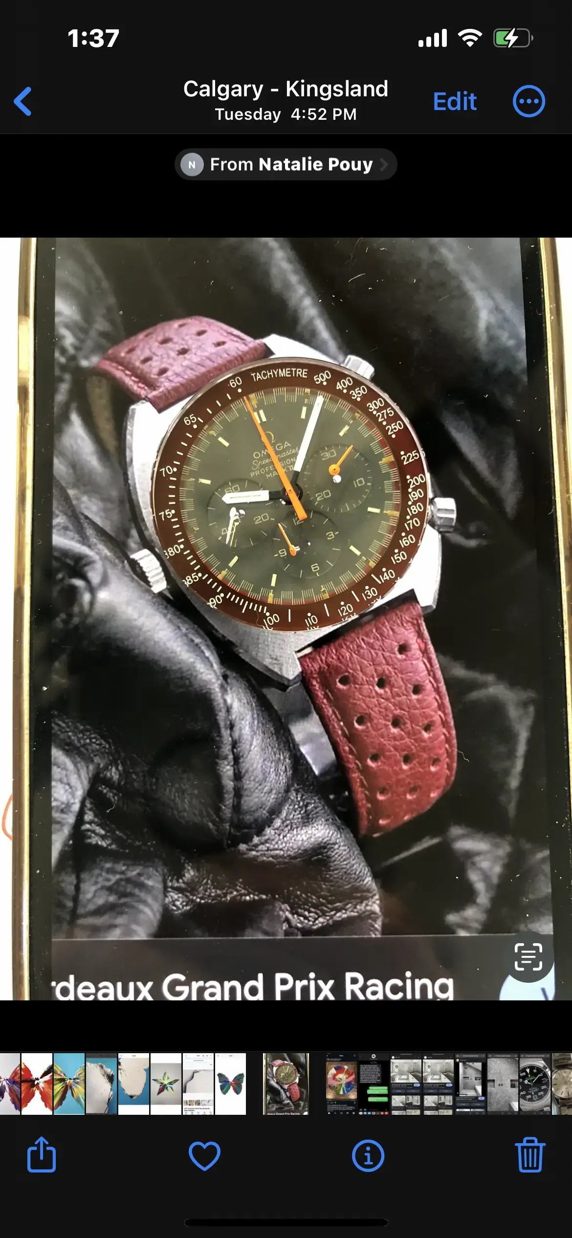

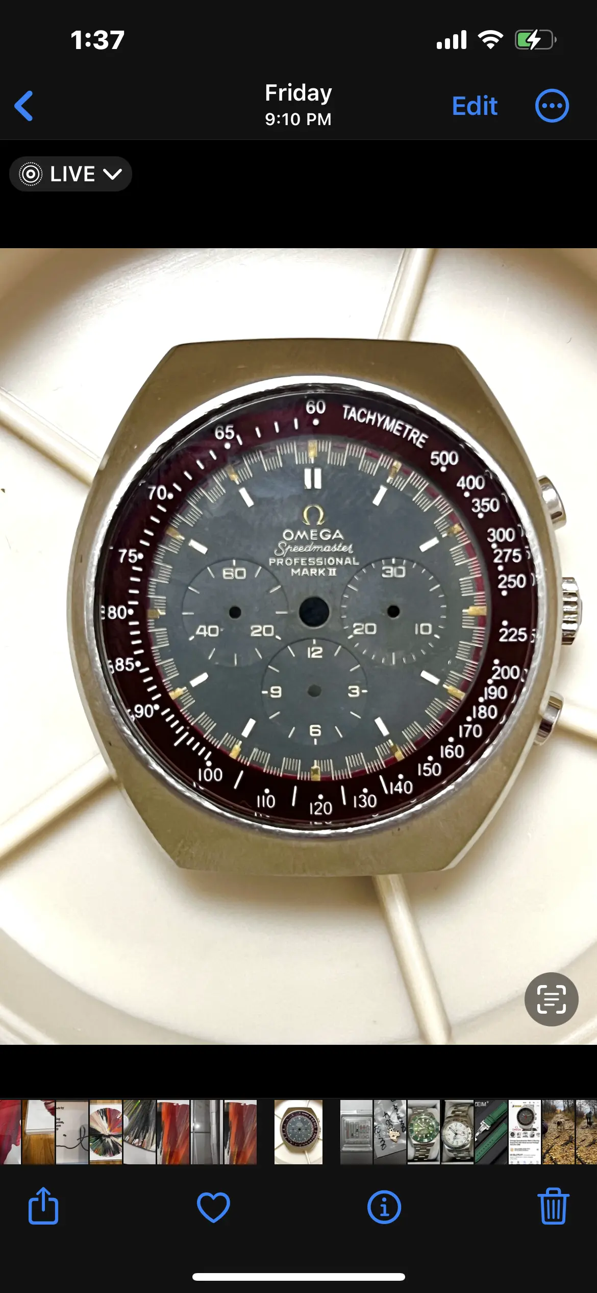

Hello. I am currently rebuilding a 861 movement and dropping it in to a 145.014 case with a maroon crystal and a Japan racing dial. I鈥檇 dig any info on making my own gasket. I鈥檓 pretty sure I can have one printed up with any info you might be able to offer. Would you mind dropping me a note at findingmrsmith at hotmail dot com? Thanks.
