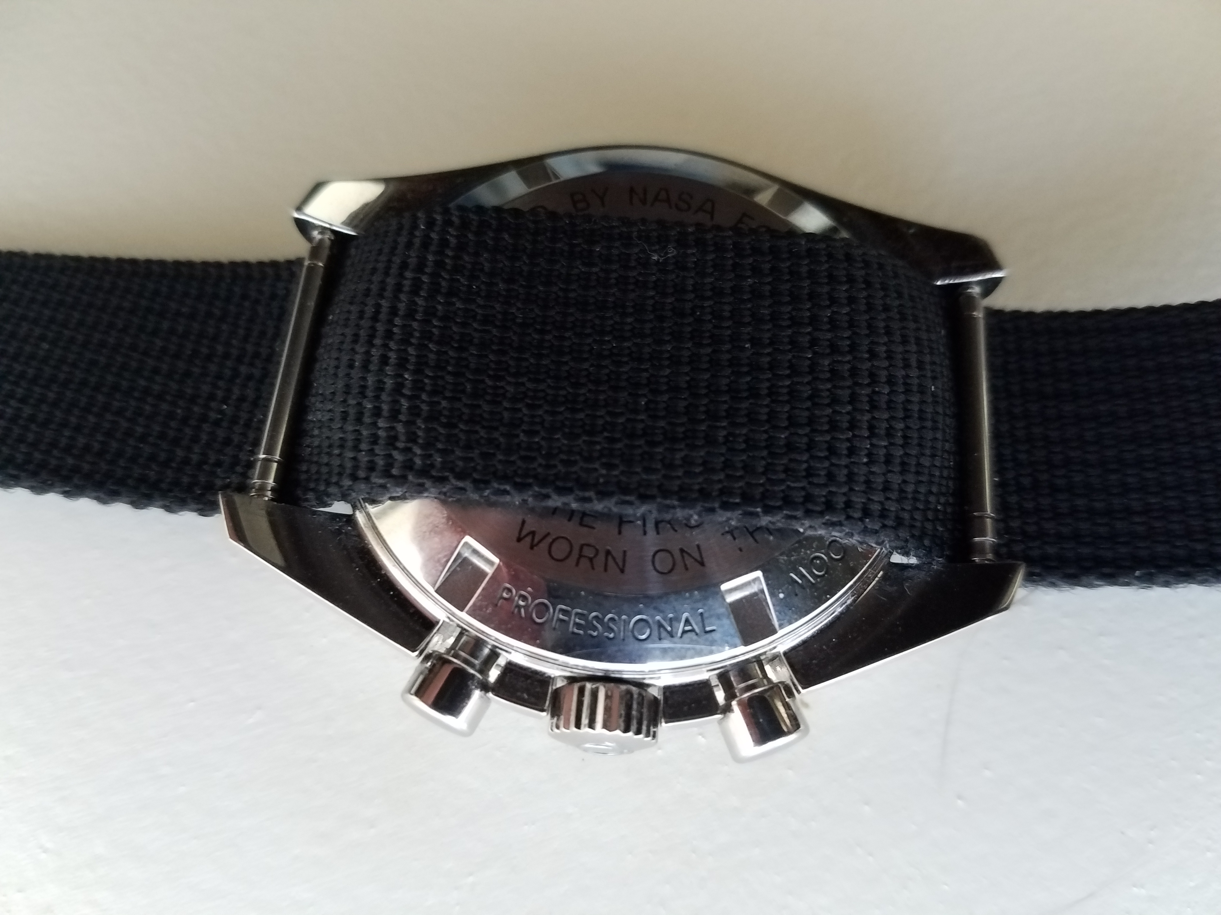

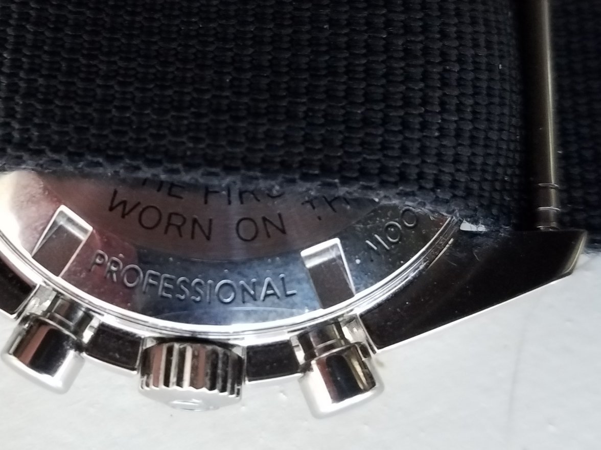

  16. time flies Jul 9, 2019
    1,225
    4,549
    Is this the new caseback you are referring to? 20171219_130101.jpg 20190709_172321.jpg #78759...

  17. krh7 Jul 9, 2019
    239
    101
    now that you mention it, i have only been looking at sapphire sandwich 1863 models. they are on at least 877.
