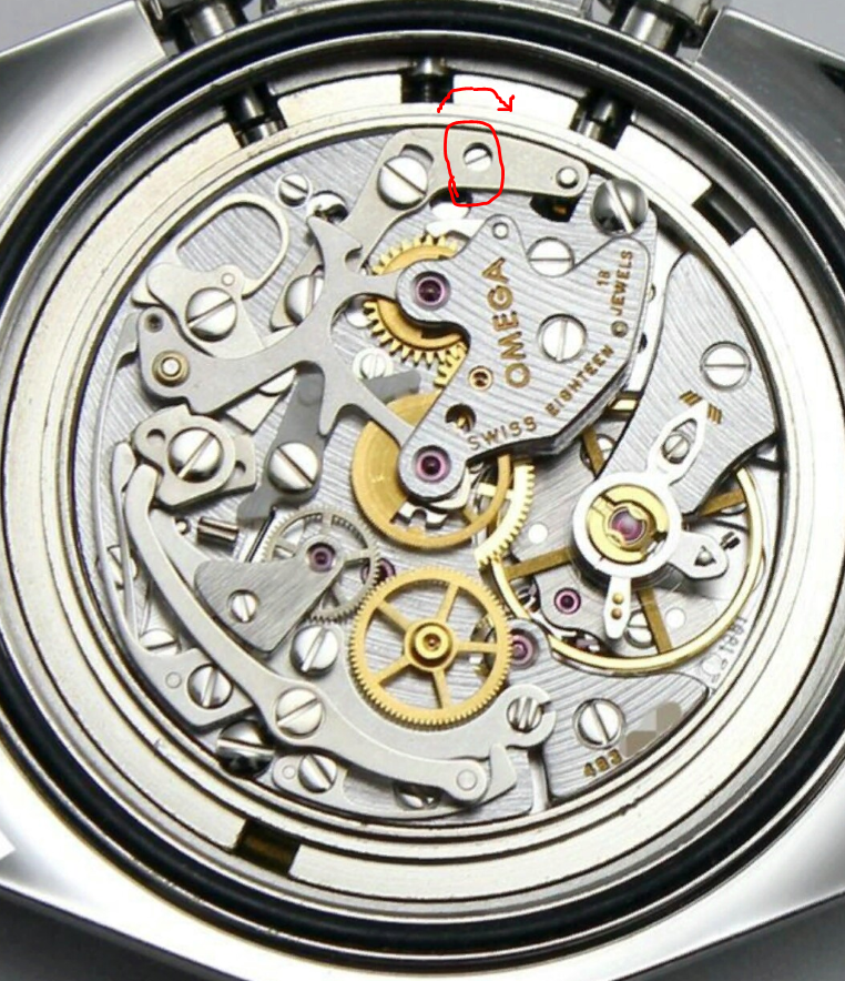

  6. ext1 Mar 11, 2019
    1,134
    1,673
    I think the stem came loose. There is a screw (detent screw I think it's called) that you can adjust to fix it. With the proper tools it's a very easy job for a watchmaker. Of course, this is assuming there is nothing else wrong!
    Turn in the direction I drew to tighten.
