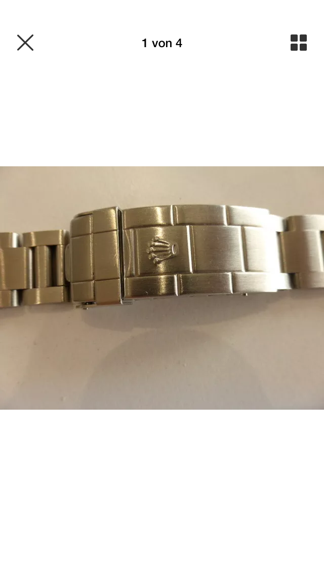

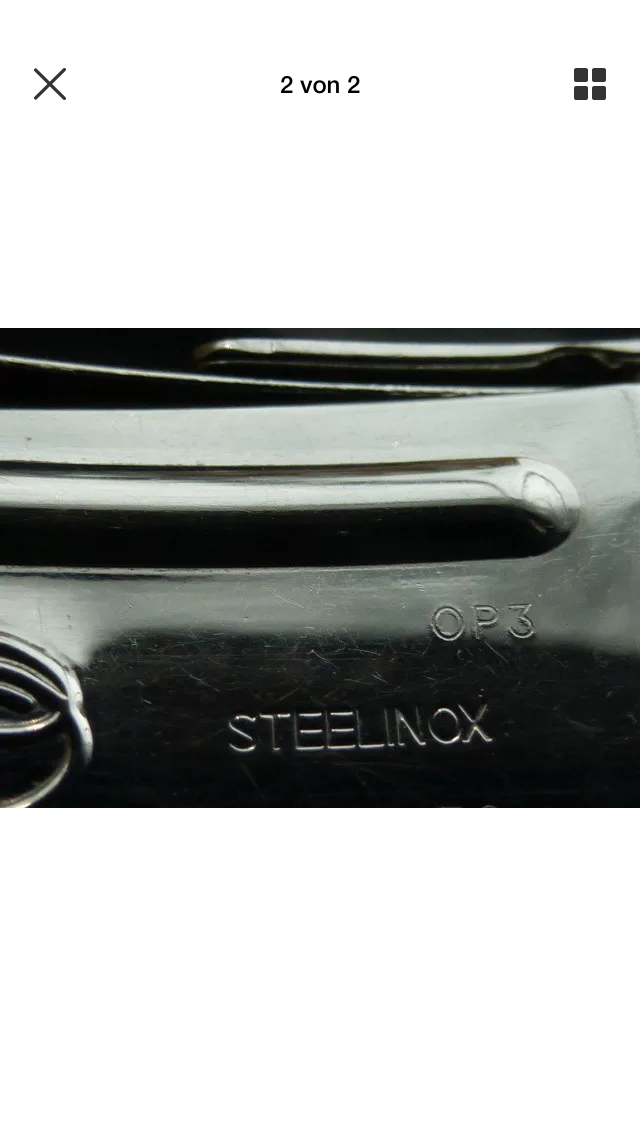

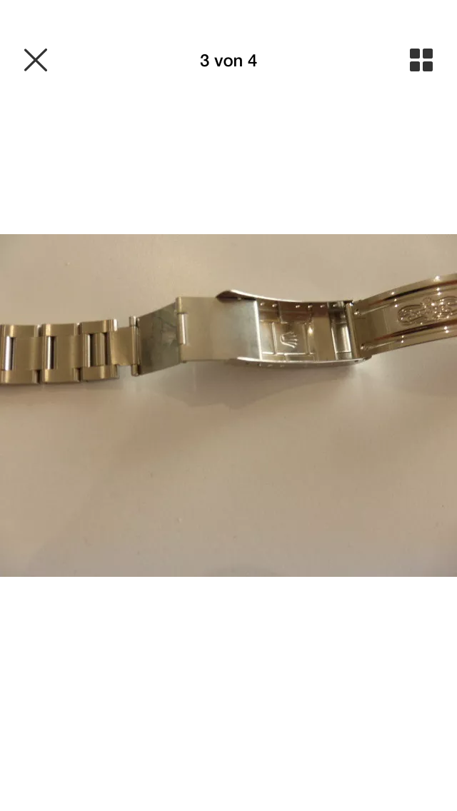

Well, I just purchased a 93150 Bracelet.
Pictures showed an original and NOS bracelet with Clasp code OP3.
Seller has lots of positive references, sells lots and lots of Rolex parts and seemed trustworthy.
I paid via PayPal with buyers protection.

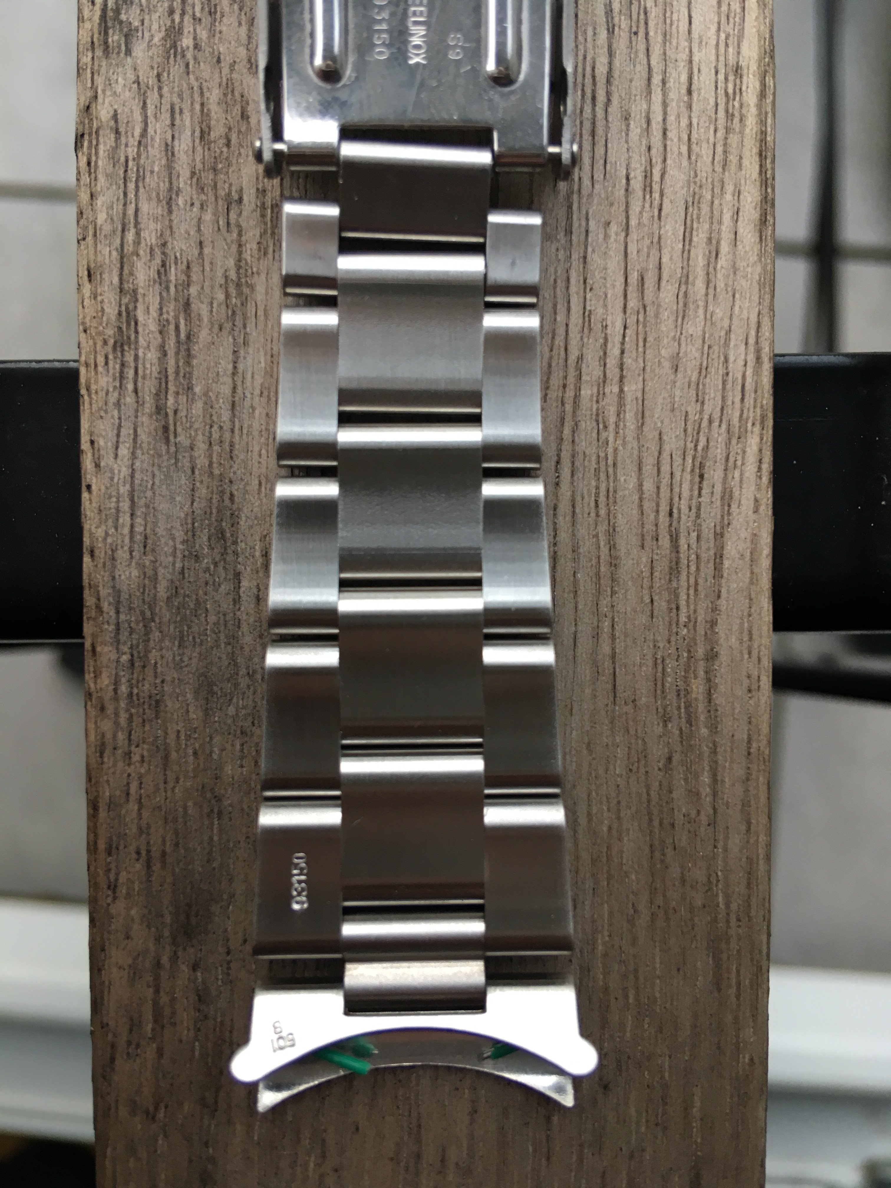

When I received the bracelet today it did not have the OP3 Clasp mounted but a definitely fake Clasp (at least the buckle is fake) with Clasp code s9.
I contacted PayPal than and tried to get my money back.

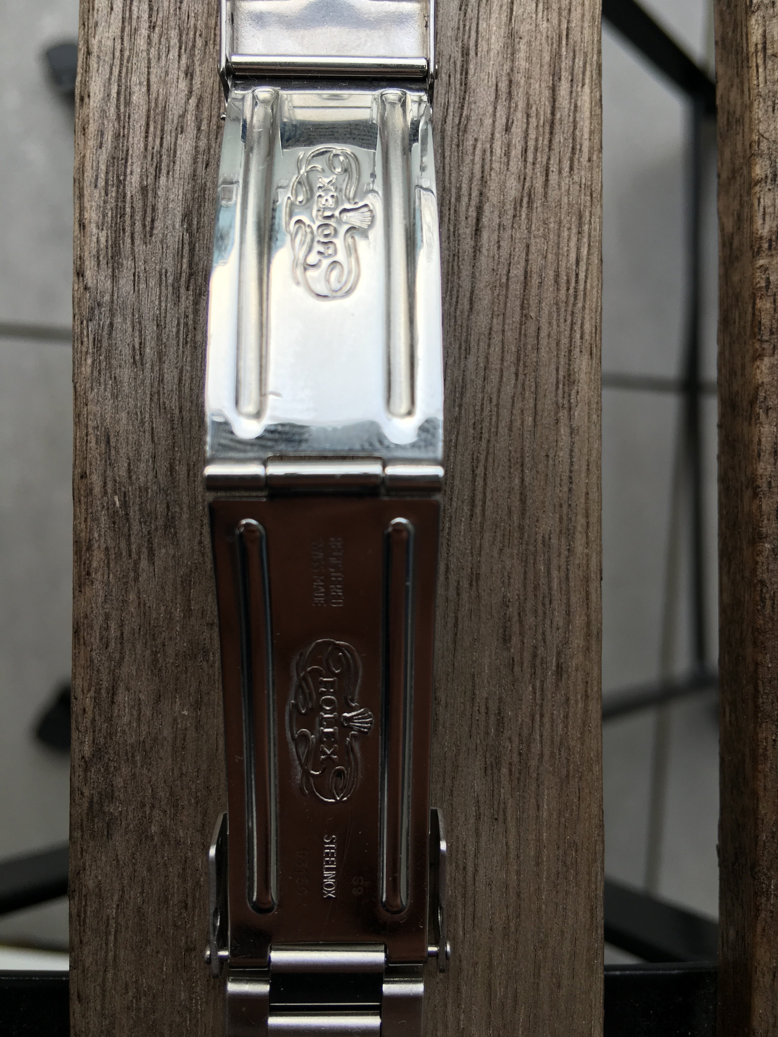

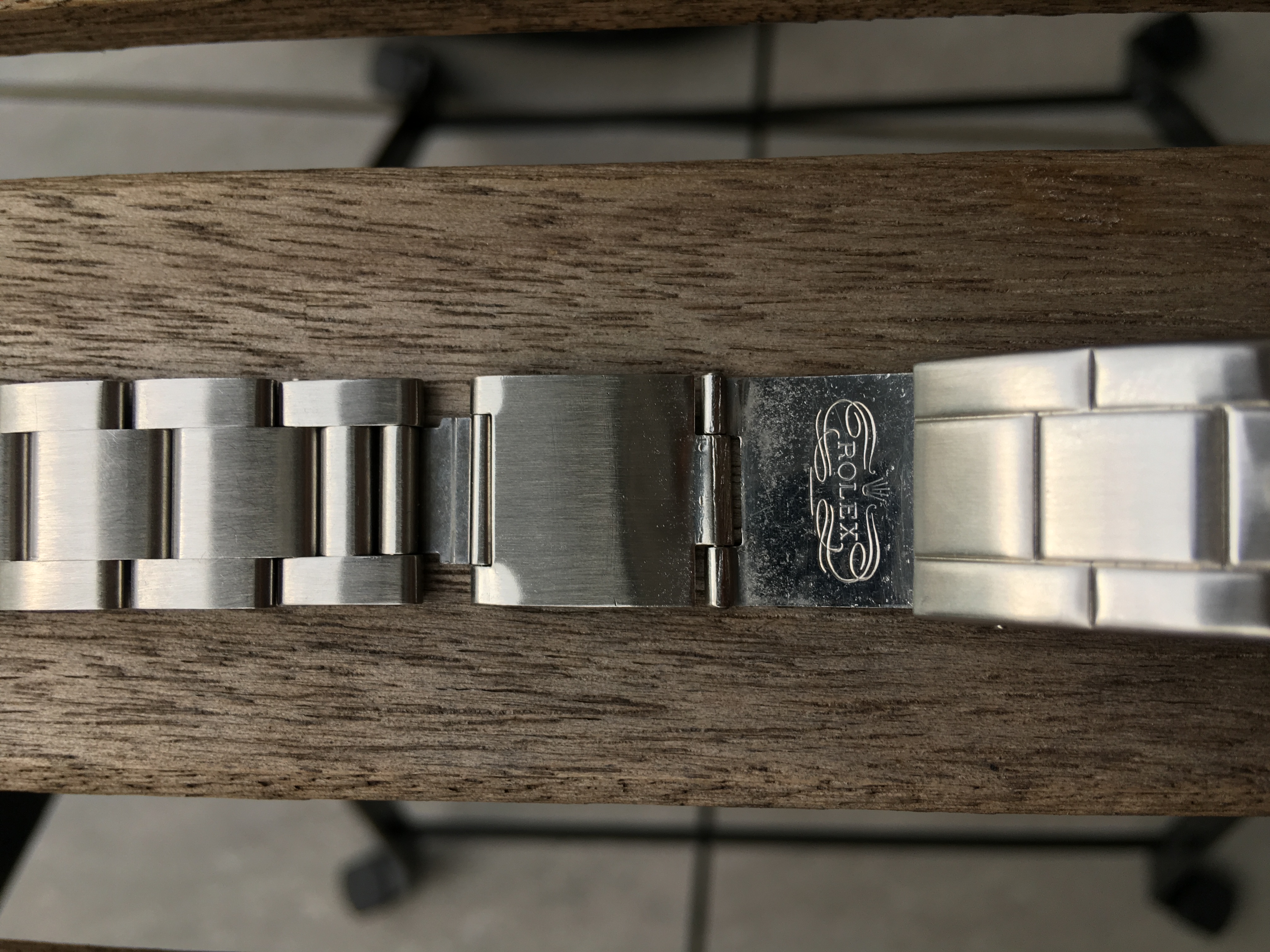

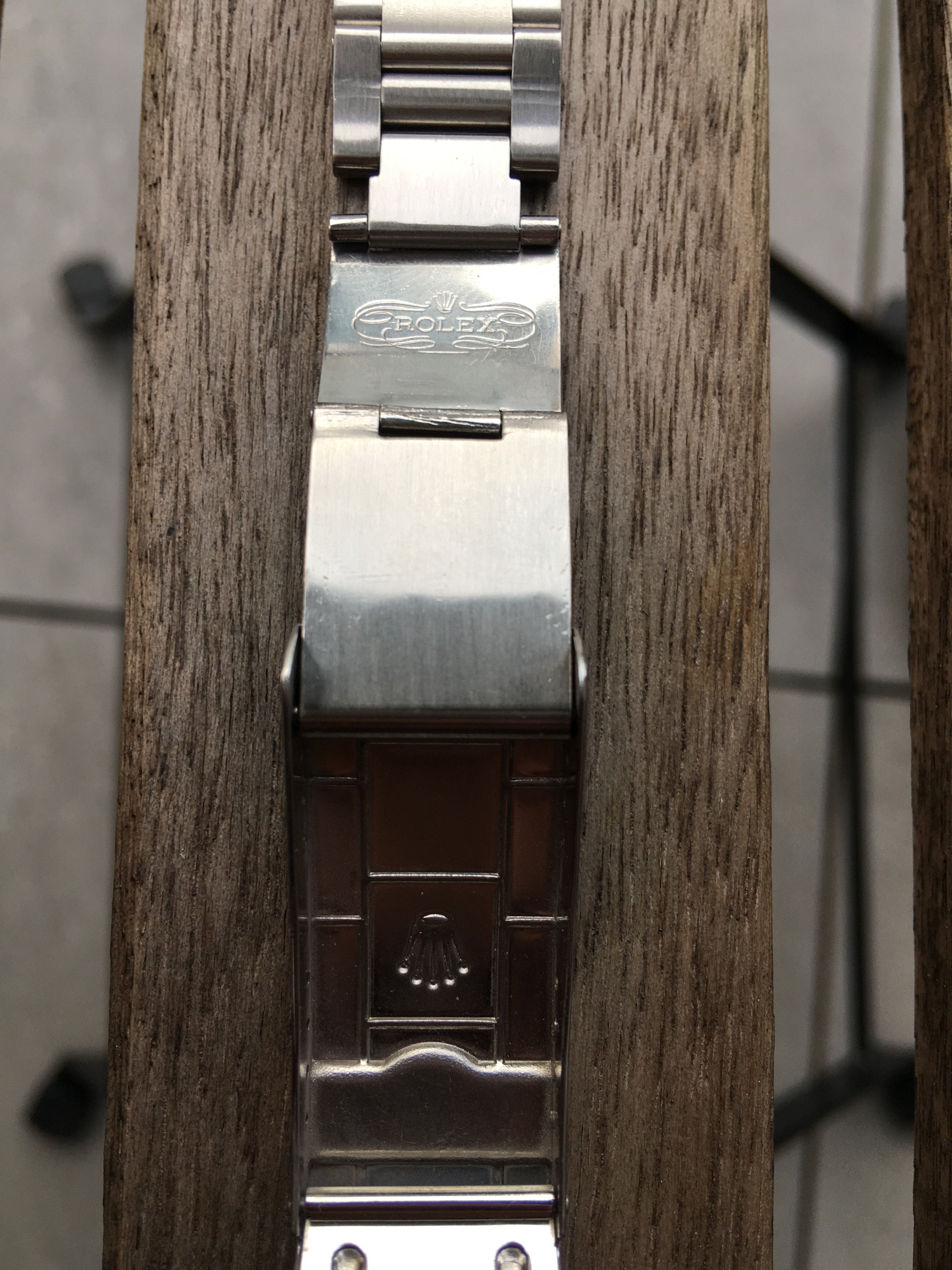

The seller contacted me claiming it was a mistake and that he would ship the original Clasp with Clasp code OP3 - please see pictures - to me.
Of course the seller is a dork for shipping fake stuff - but:
Are the other parts (Endlinks, Links, diving extension,...) Original?
Would you agree to that deal (keeping the received item + the other clasp?

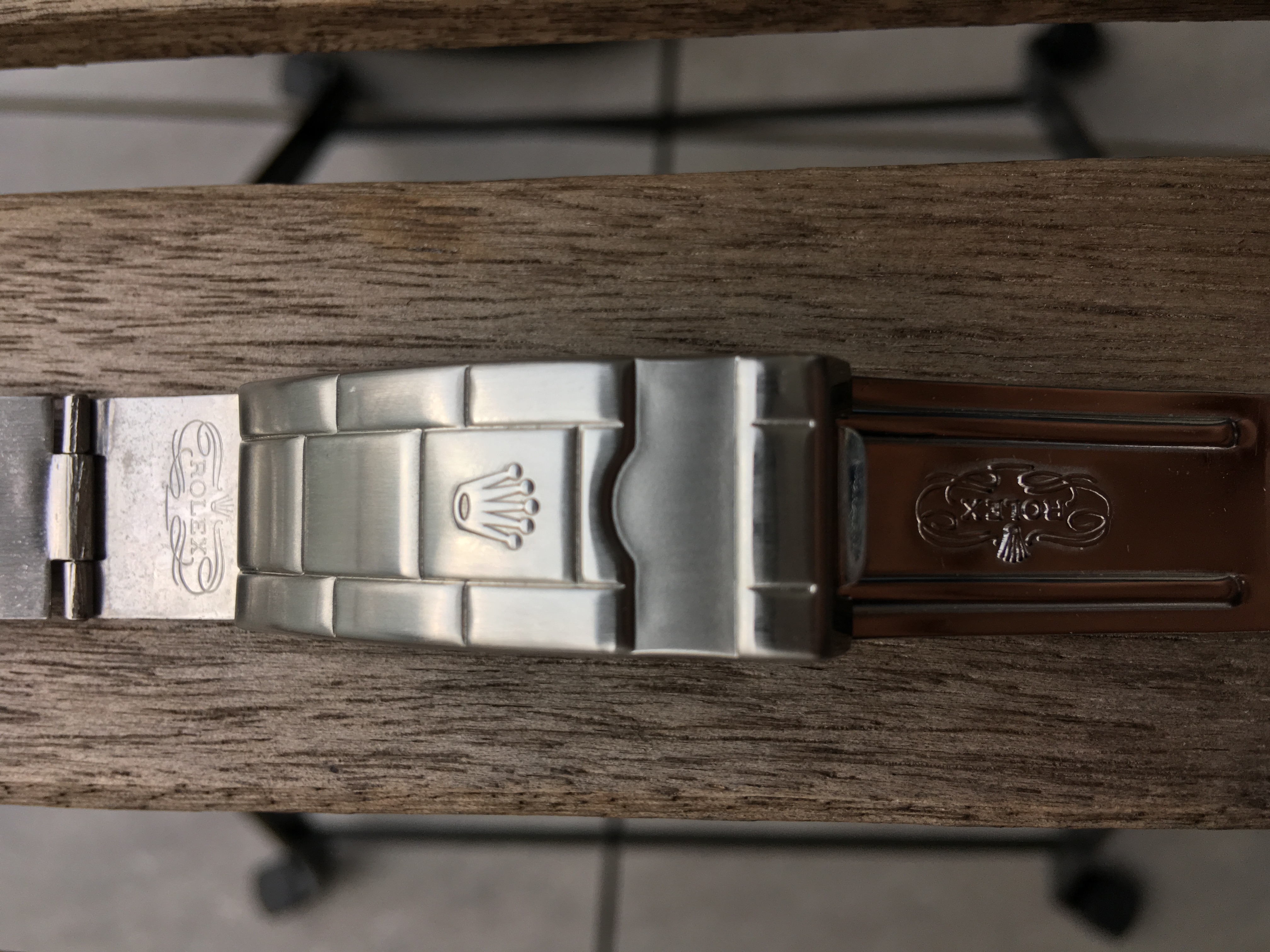

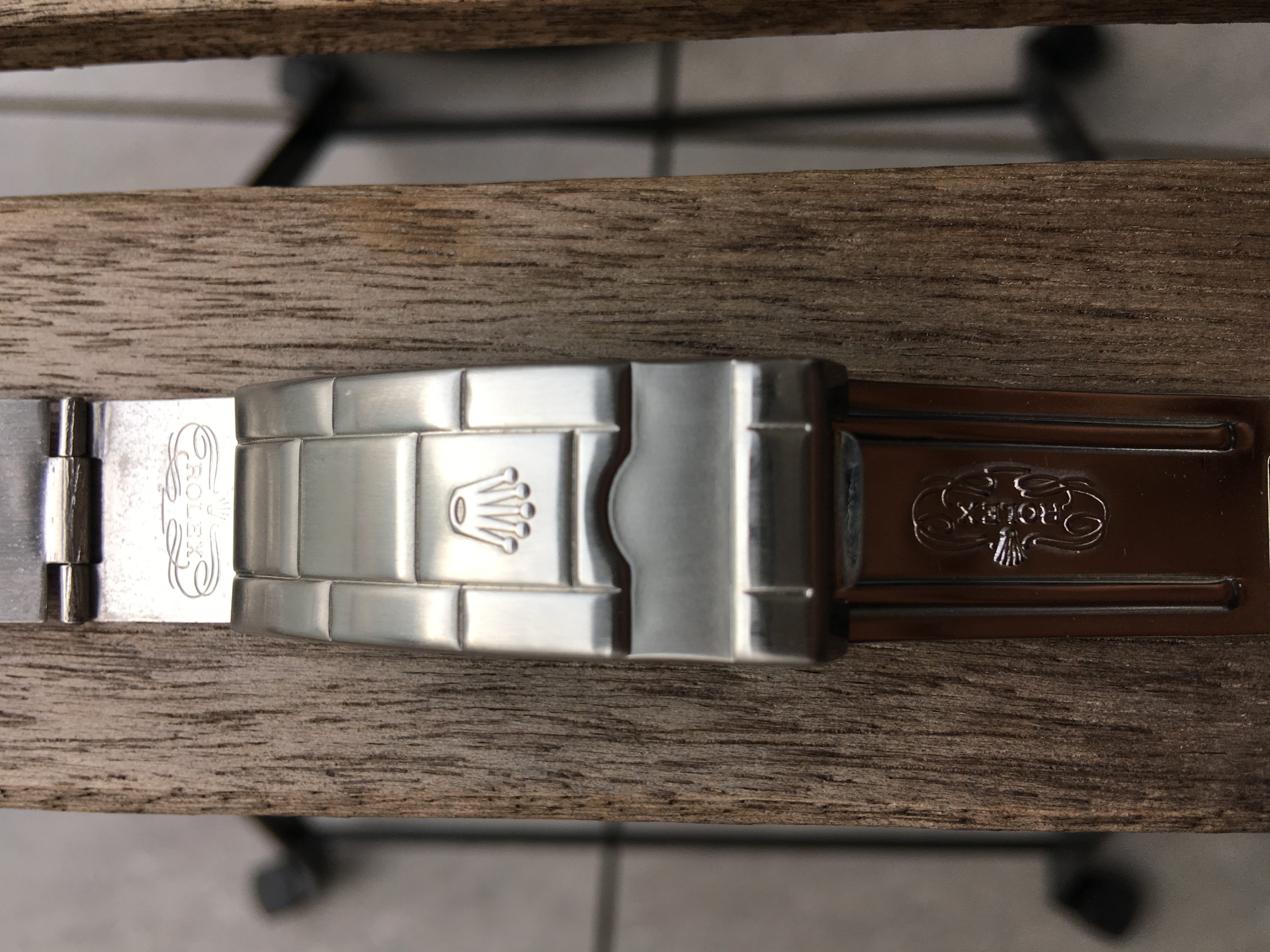

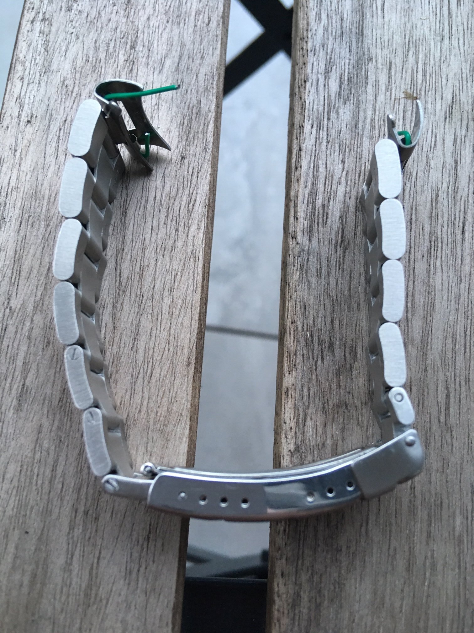

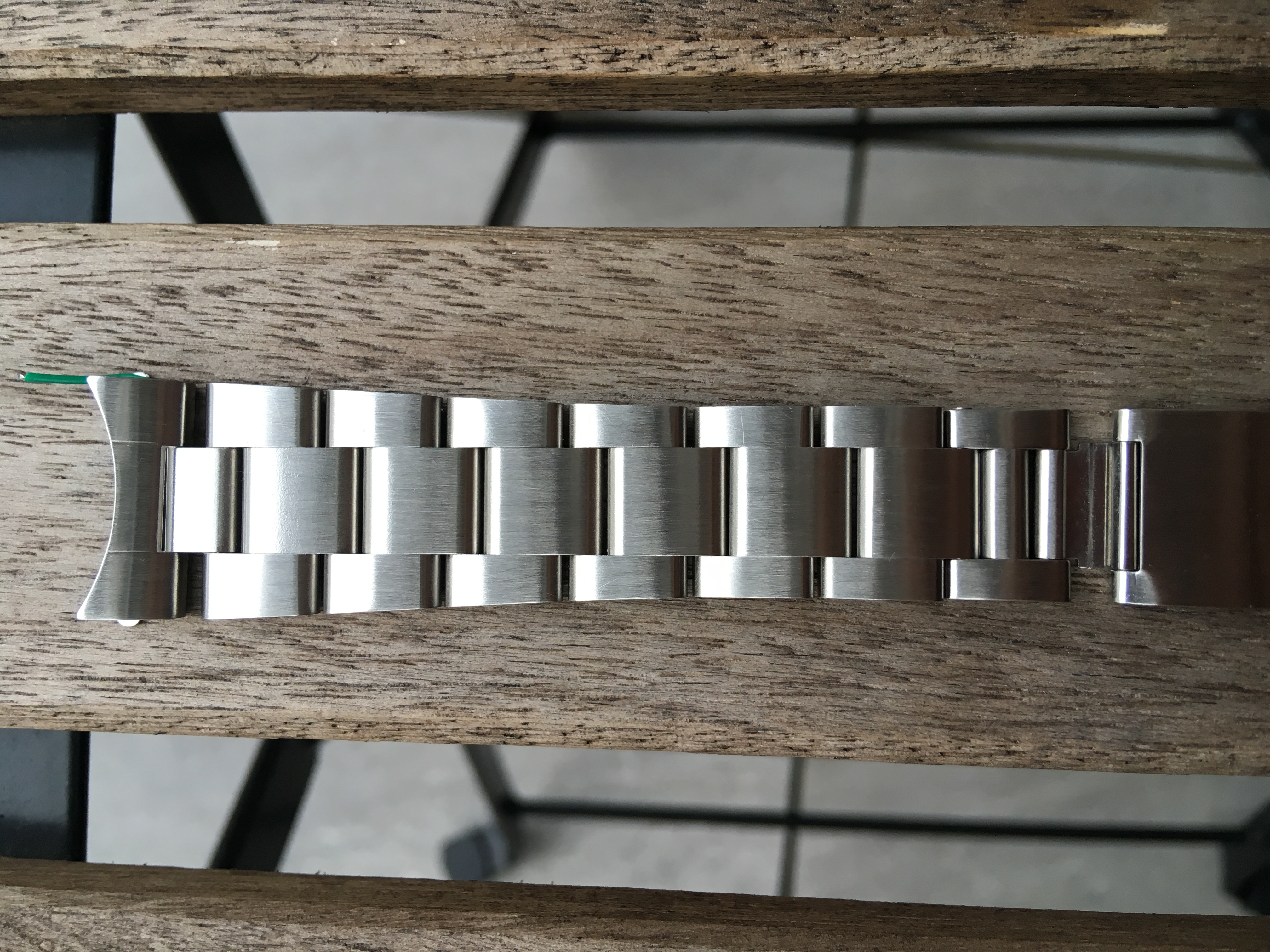

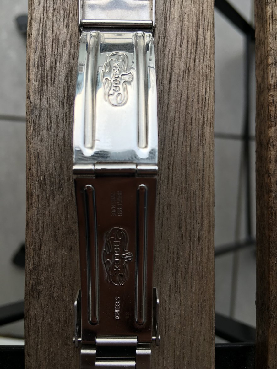

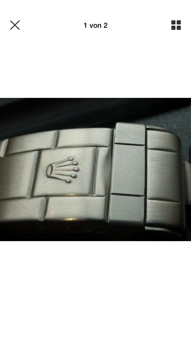

What I purchased:
What I received:
3,800
22,725

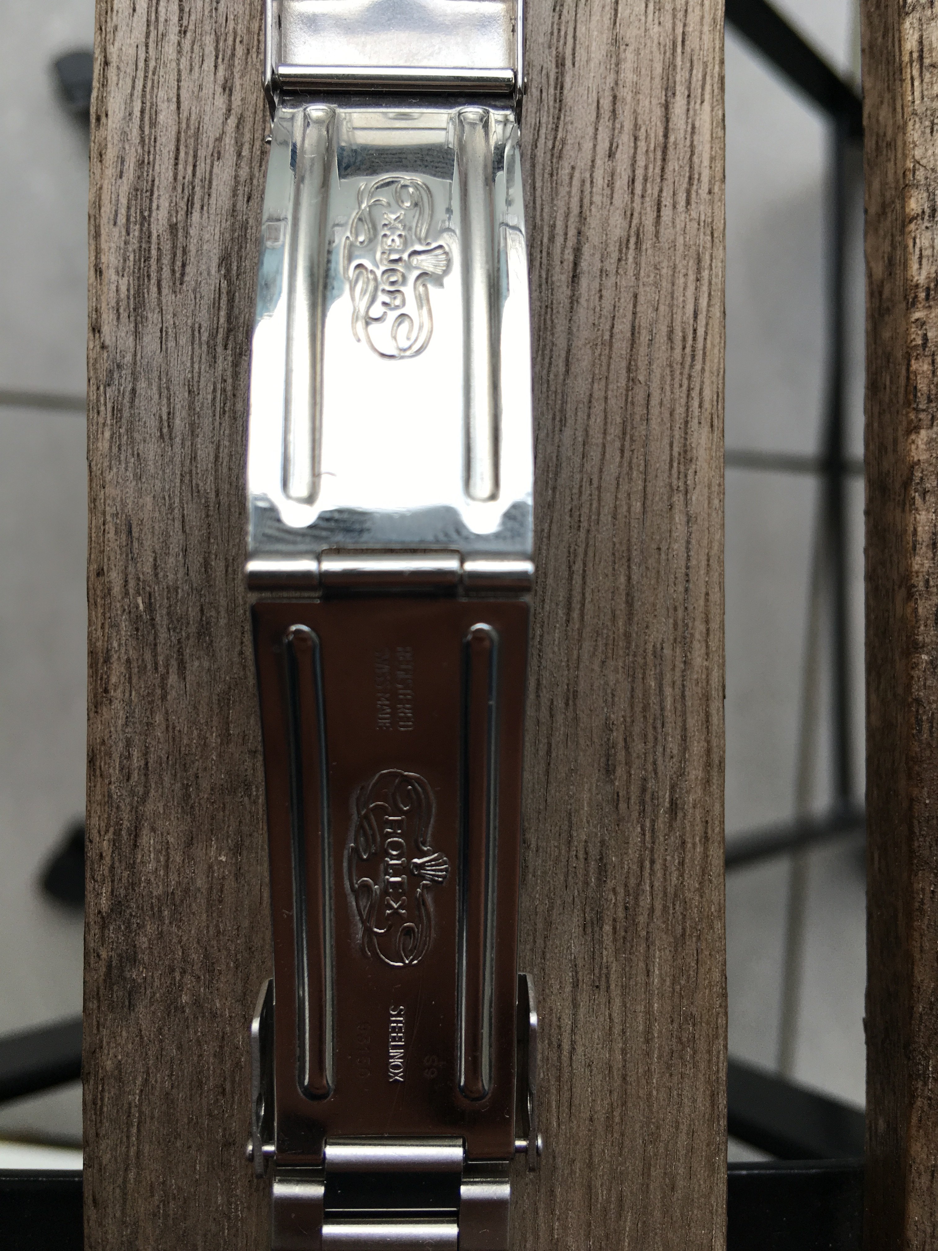

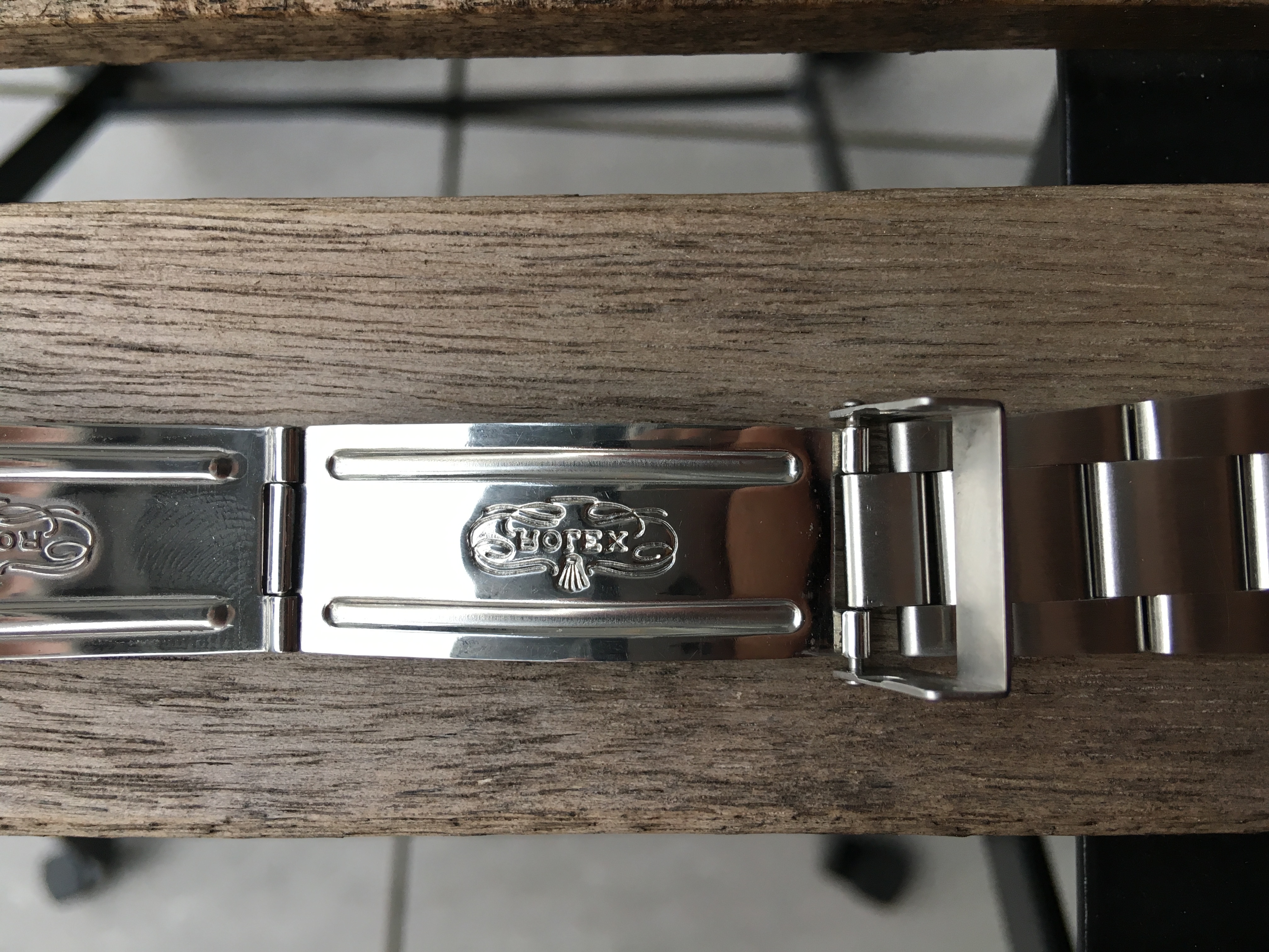

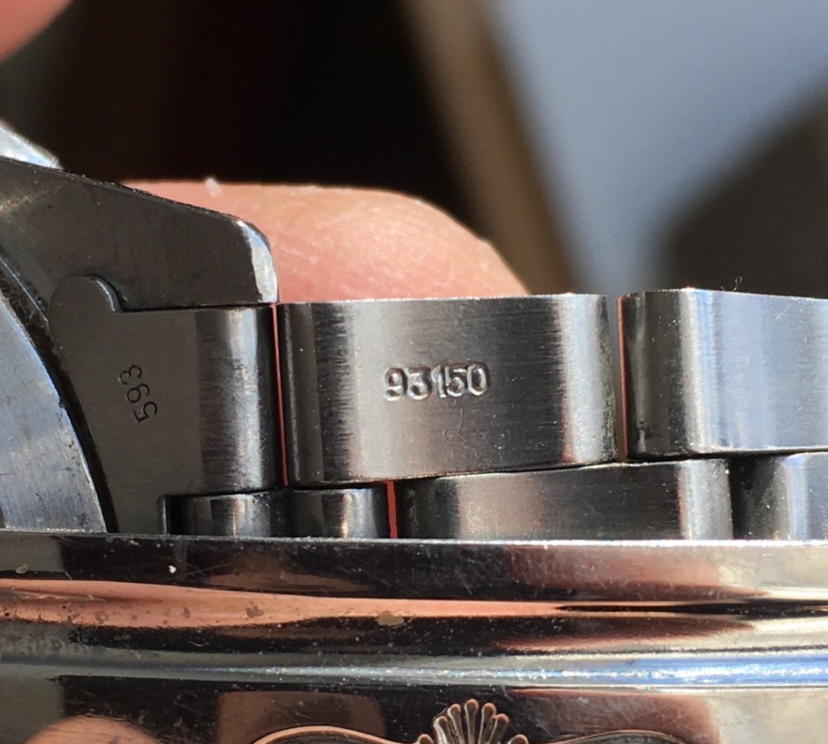

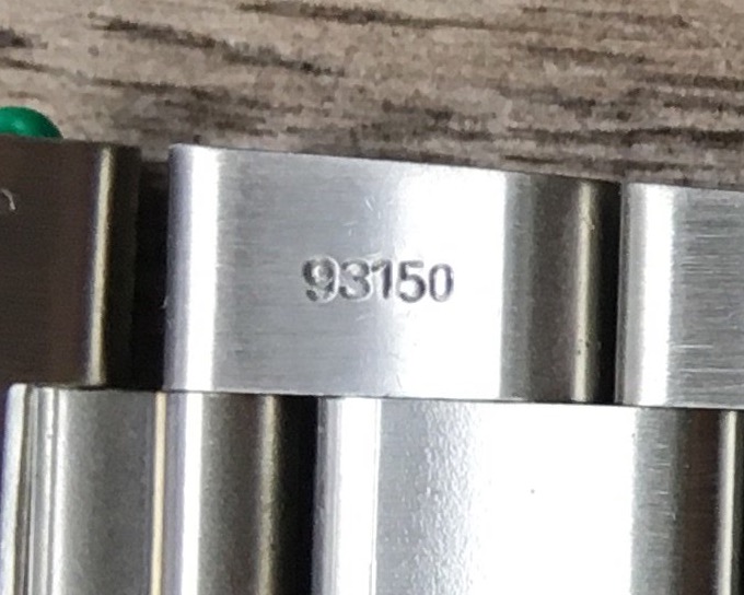

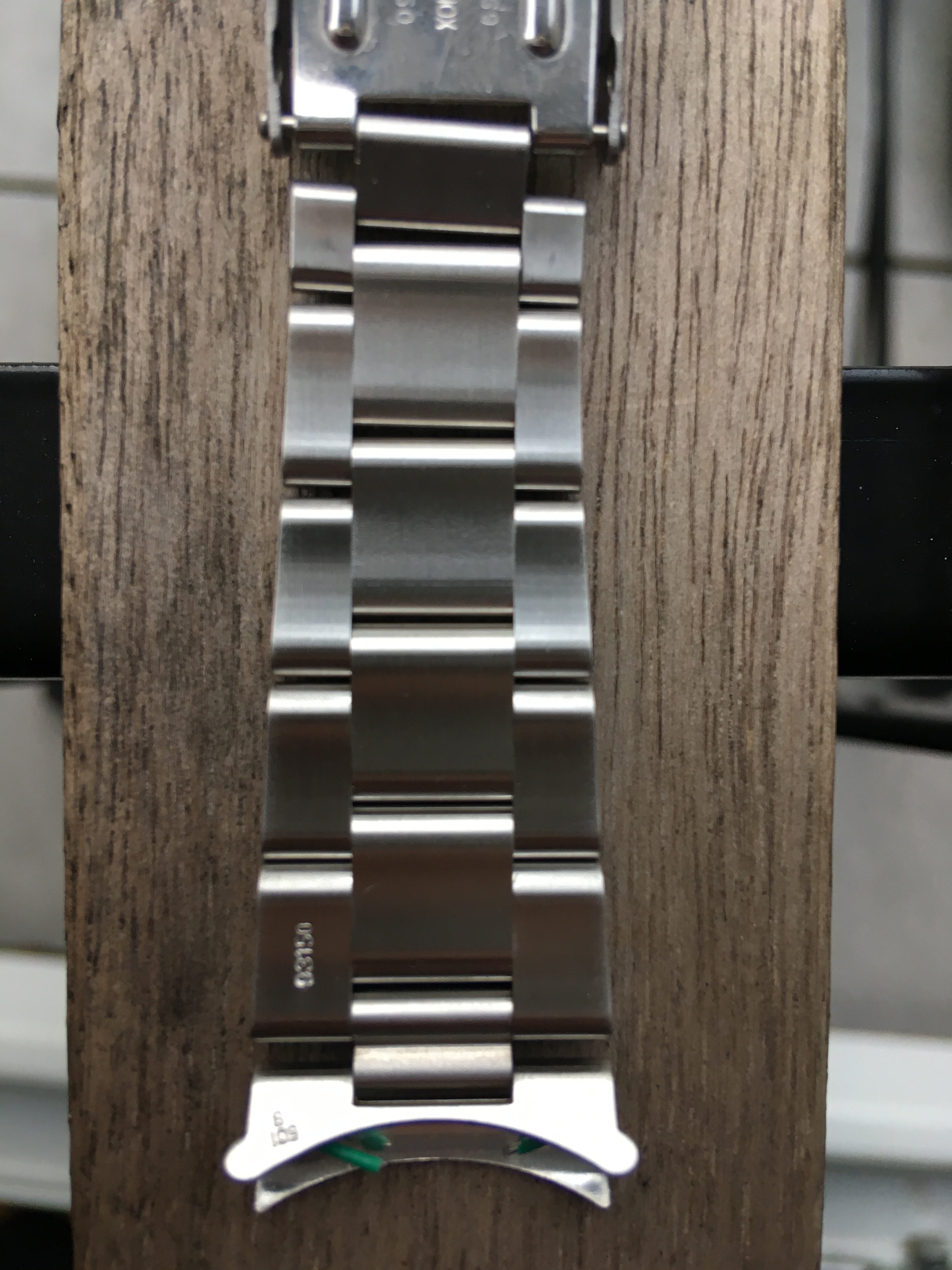

The 93150 engraving is definitely off. So are those end pieces. No doubt a fake.
I would return the whole thing. If the seller sent you a bracelet with a fake clasp, guess what, the whole bracelet is in question.
Yours on the bottom pic..

Seller just offered to send a completely different bracelet which he claims is all original - and I should ship back this one.
3,800
22,725
Get a refund and shop elsewhere. Don't go down that rabbit hole. He's burned...

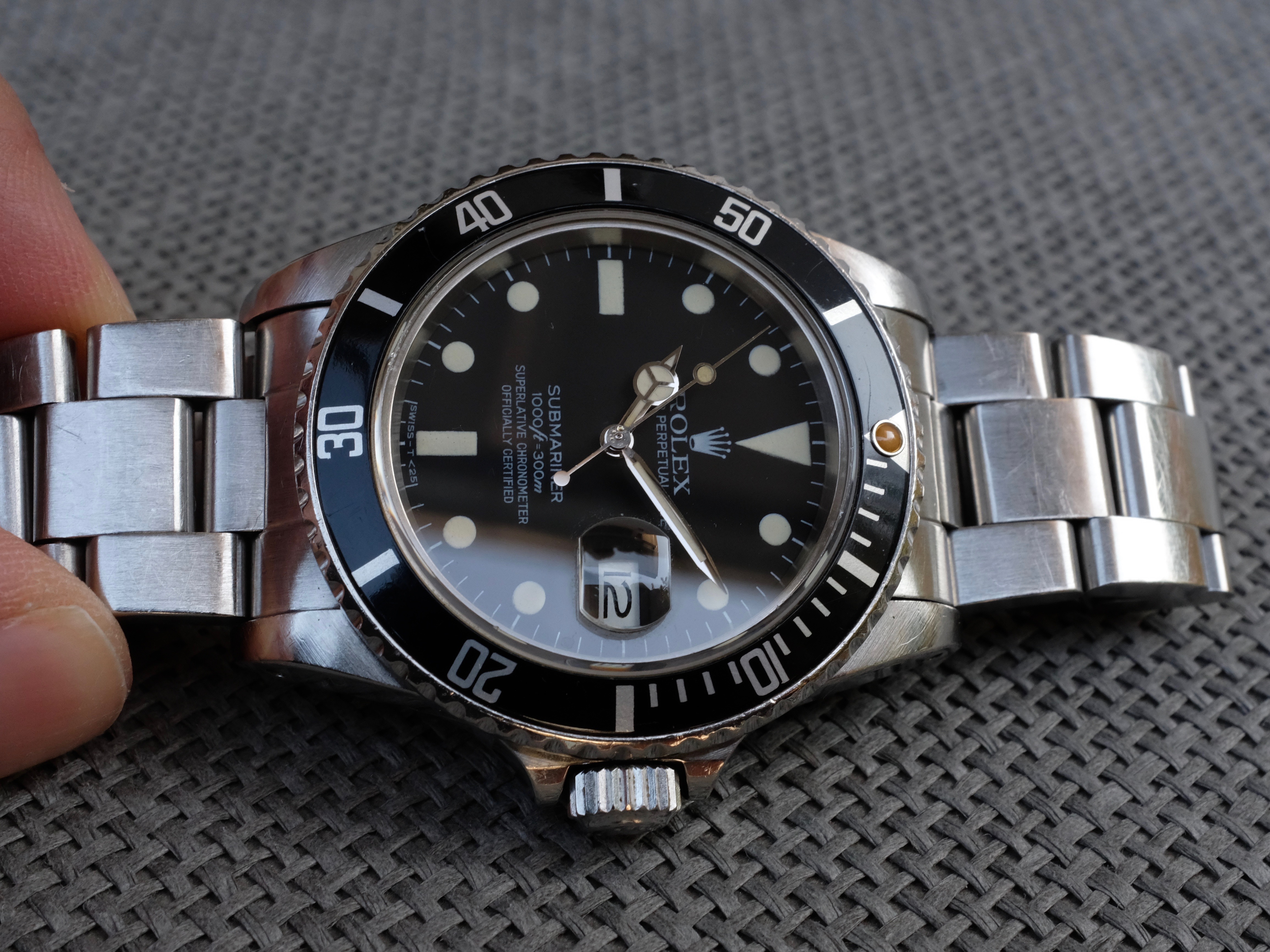

My 16800 is first owners and was only serviced at Rolex with period correct bracelet, the right clasp code, etc. It has lots of stretch though... but at least I would know what I got.

My bracelet is also on my 16800. Original issue with 593 ends.
494
239
Also 593 here...

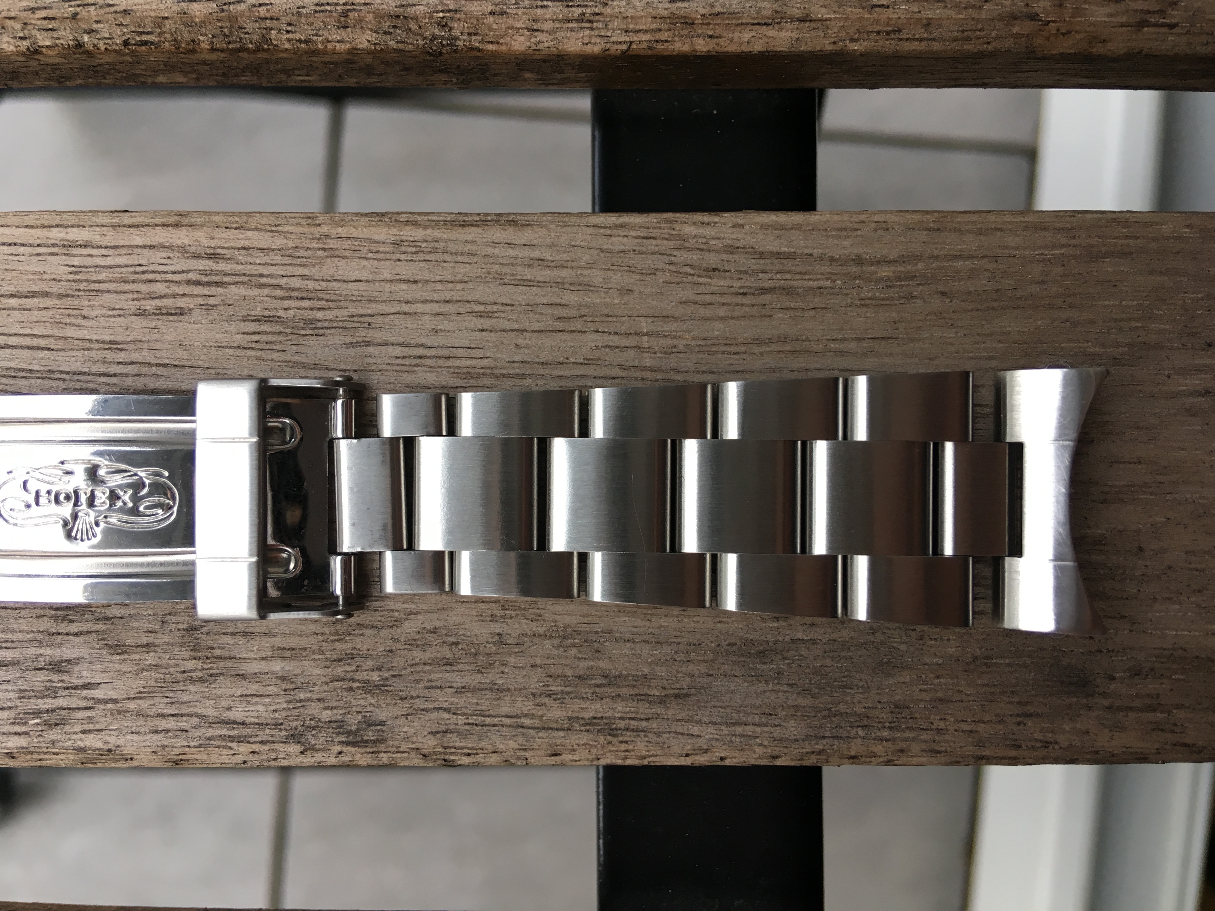

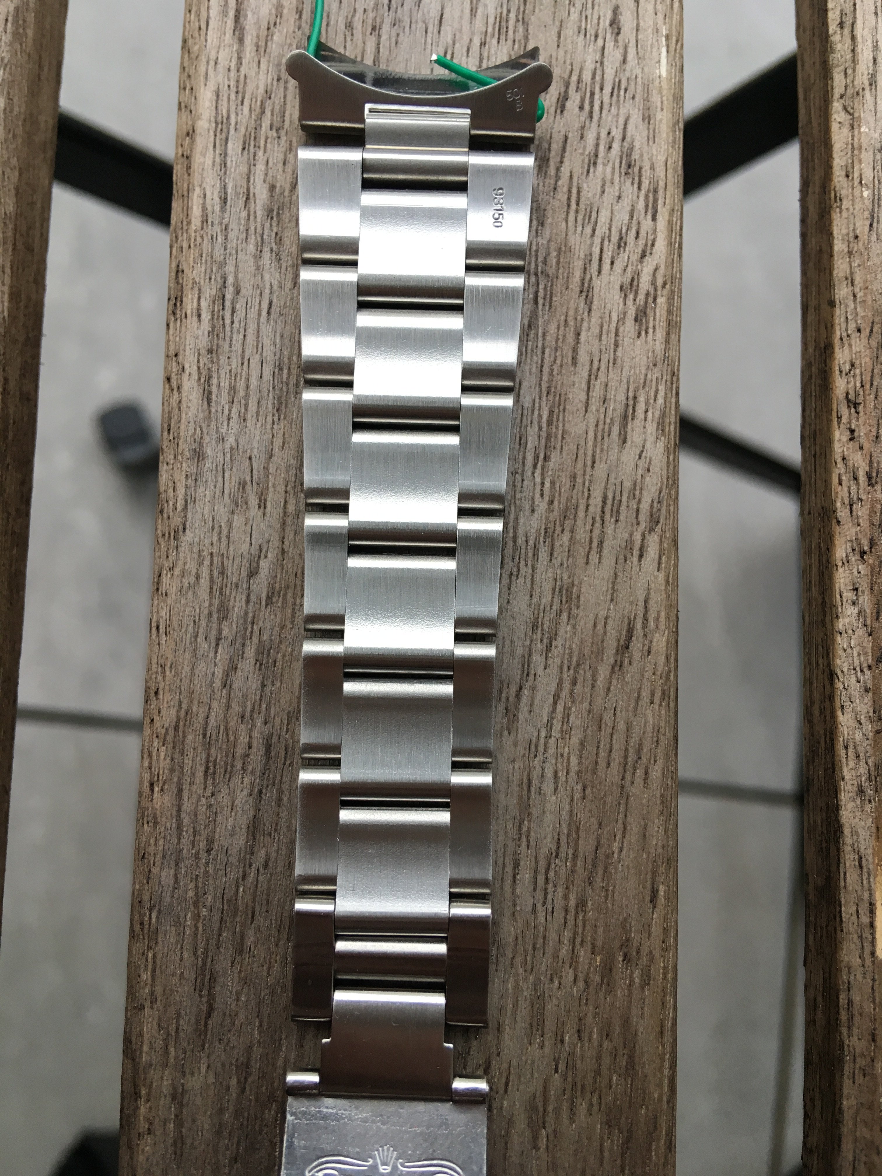

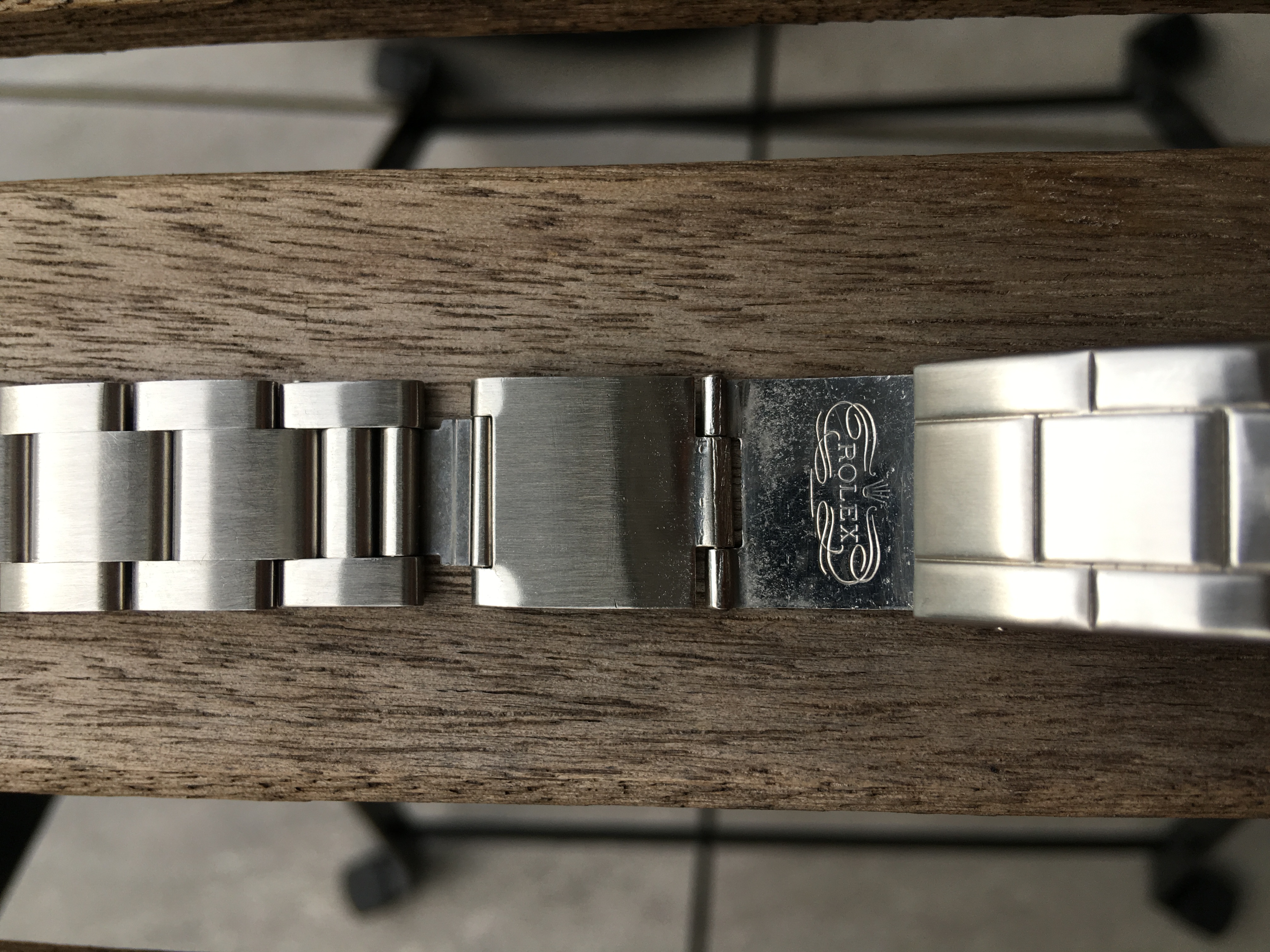

To have some nice pictures on the thread as well (and not just the crap from above... 😀):

have you sent back or kept it some of it looks genuine but hard to tell from your pics
