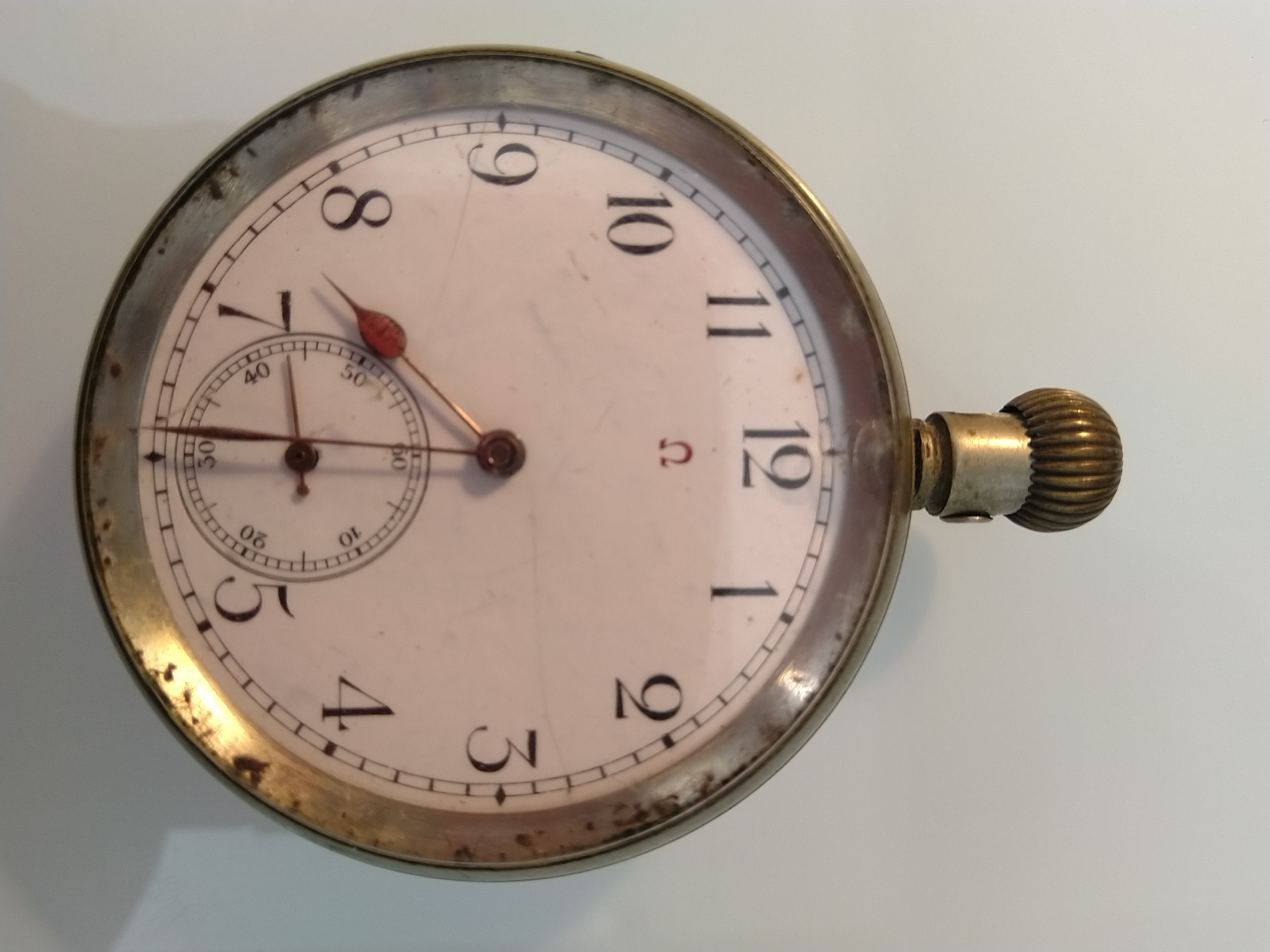

Hey Everyone,
My name's Martin and I'm from Sydney, Aust. I'm a complete newbie to the Forum and indeed to Pocket Watches, although I seem to have acquired a number over the years! But I'll start for now with just this one ...
I am doing some preliminary research into an 'Omega' pocket watch from my partner's side of the family ... Supposedly belonging to her great-great grandfather (but he died in 1858, so that number doesn't work!)
I think it's called a half-hunter?

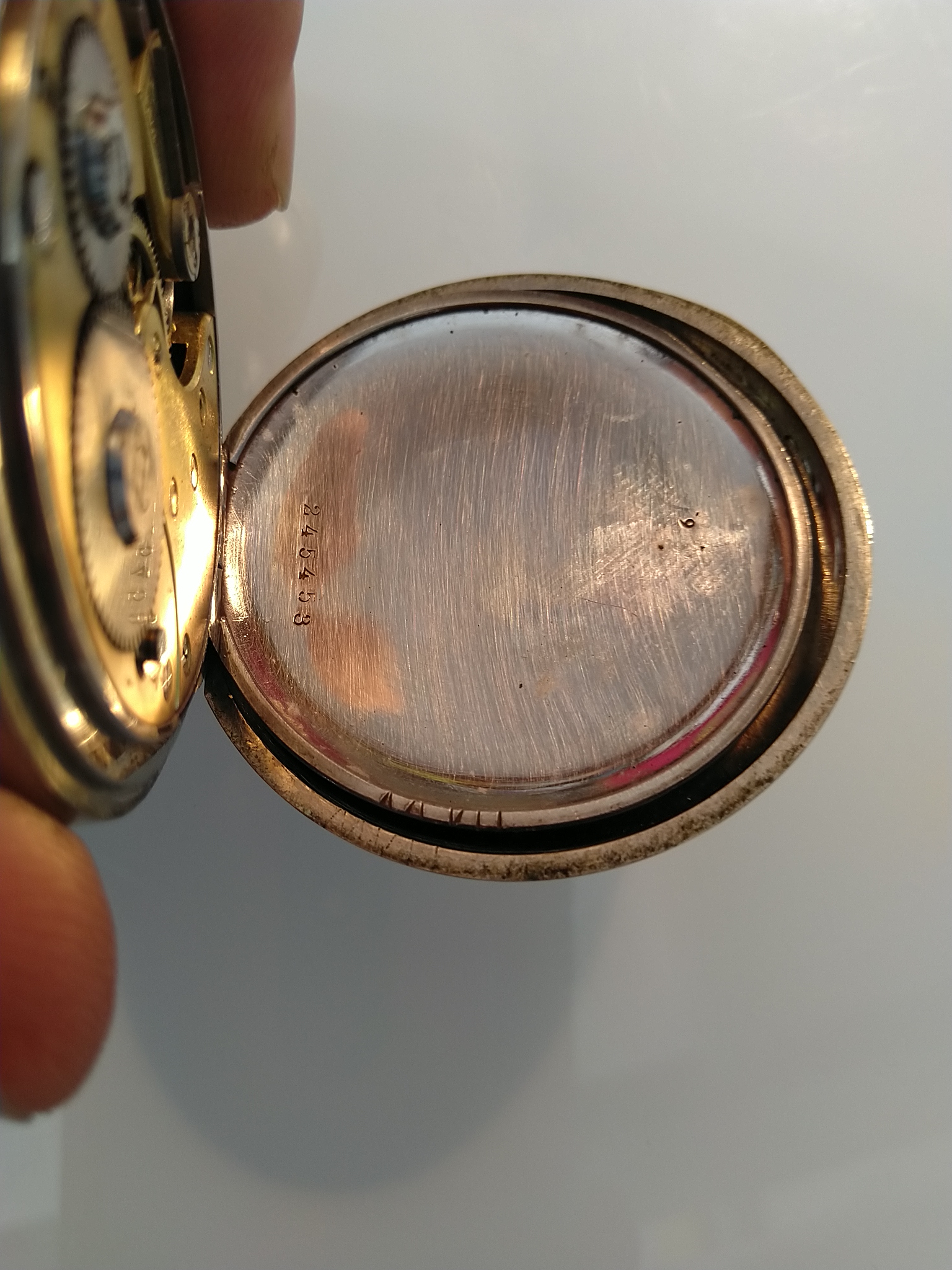

As you can (hopefully) see in the photographs, the omega symbol on the dial is poorly proportioned and the only other identifier I can see without removing the movement (not sure I want to try that without advice) is a better-formed omega symbol stamped into the balance cock (please just correct any of my errors in parts naming?).
I can find no serial number (or any marks) under the balance or on any bridge.

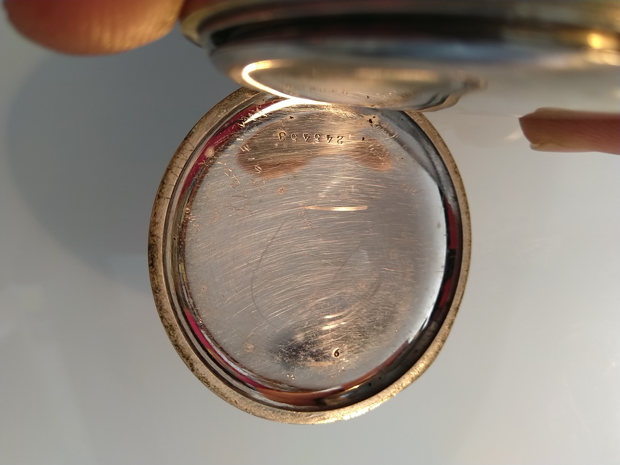

The only case numbers I can see are identically stamped into inside face of both inner and outer rear lids, but it has only six digits - 245453 - and a floating 9 (or is it a 6?) in a different typeface. So none of those numbers seem to tally with anything I've yet read either.
There are a good half-dozen inscriptions by various repairers over the years, but that's it!

Hi Martin,

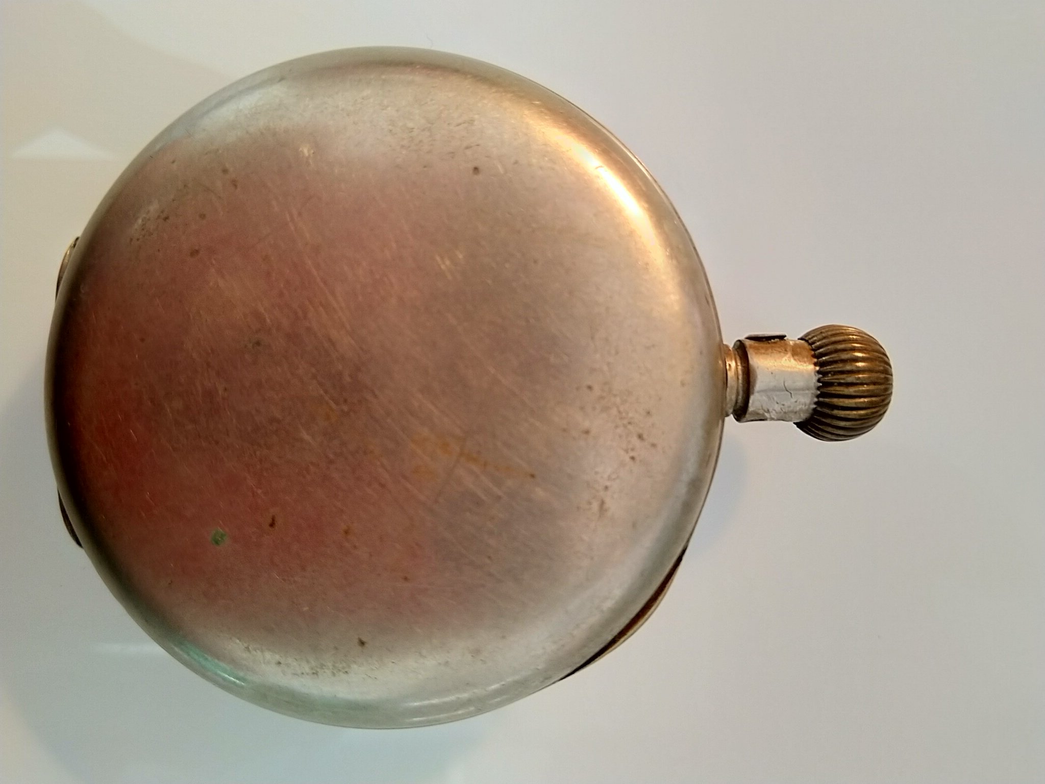

It's a Lépine as opposed to a Hunter, which would have the crown at 3 o'clock.
The numbers don't add up because I suspect it's a locally cased movement, so it doesn't have the standard Omega series of case numbers.

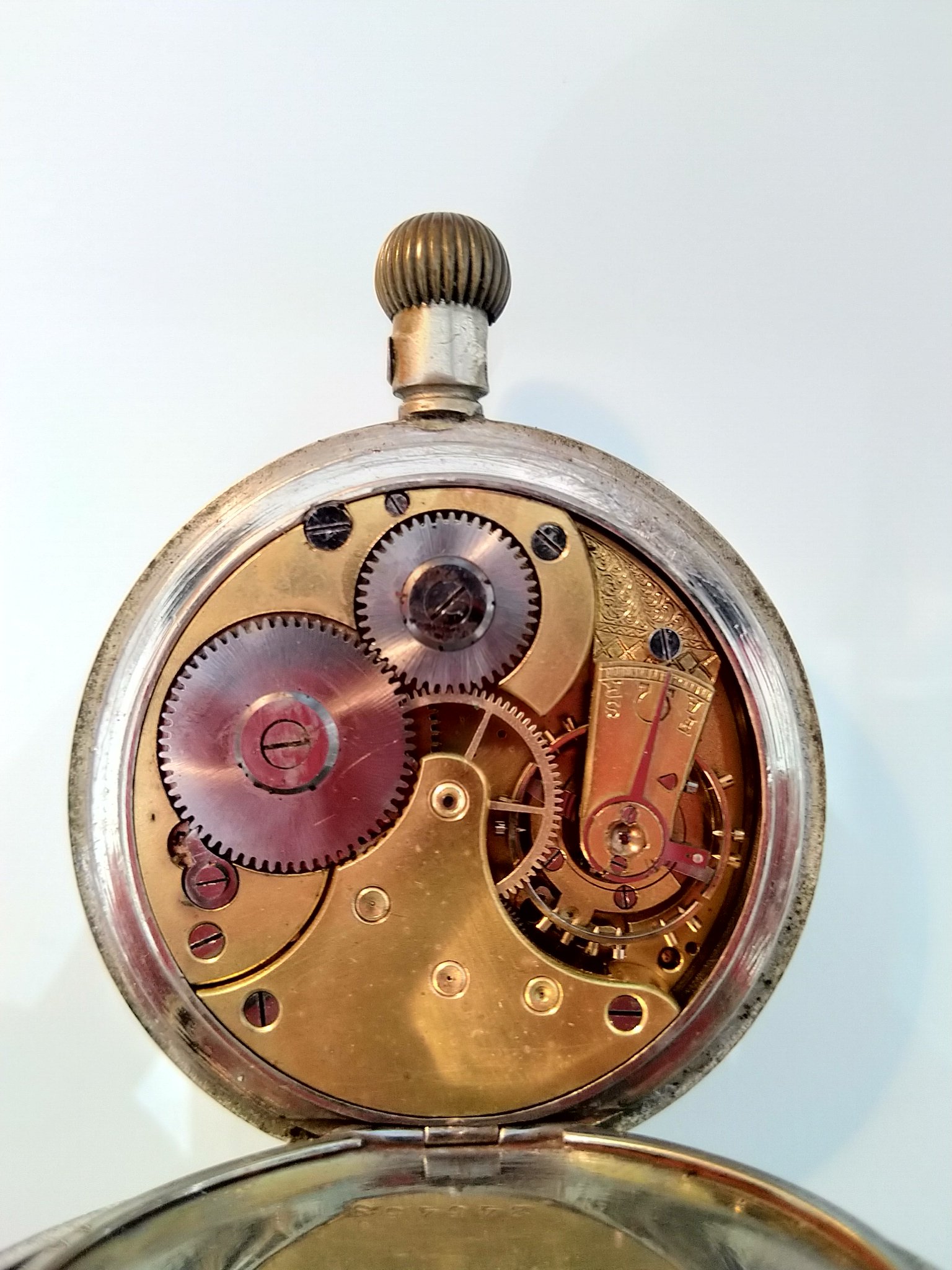

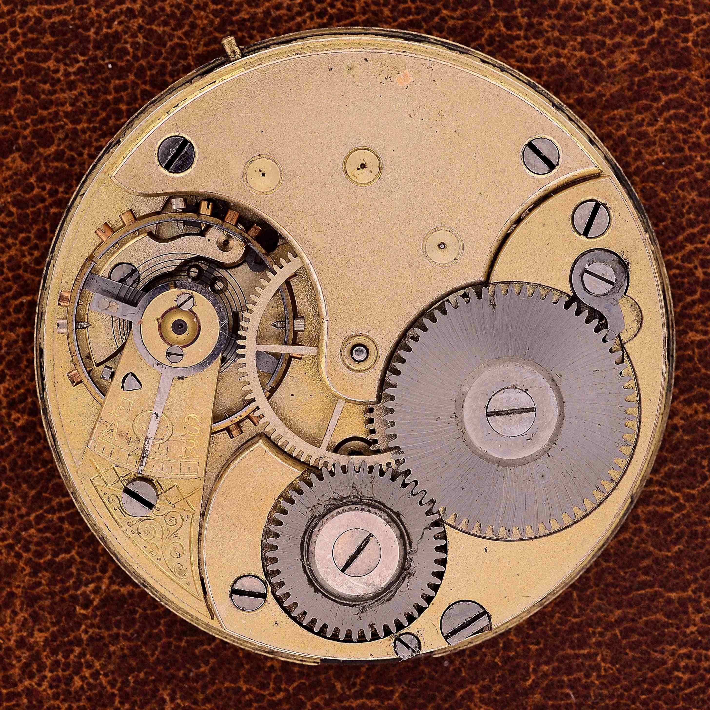

The movement looks to be a cal 19''' L 7P (L for Lépine, 7P for 7 Pierres (stones/jewels). This was introduced in 1894 and was the famous "Omega" caliber that later gave the name to the company. The only thing that confuses me is the layout of the wheels in the train, the fourth wheel seems to be located a bit closer to the centre, maybe somebody else will comment. The serial number will most probably be on the main plate under the dial.
The Omega symbol on the dial is correct for the period (circa 1900) and as it was a movement made for export the "Omega" may have been left off to allow the local jeweller to mark the watch (just my guess).

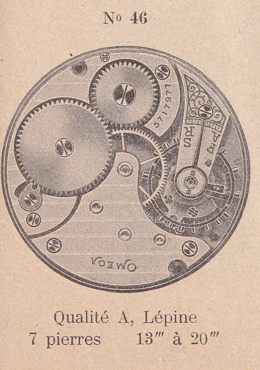

For comparison, see this early 17 lignes, same "A" quality, from my donnor box. The wheels positions seems rather similar:
The OP pallets bridge is different but correct for early 13-20 lignes as shown in the period spares catalog (speres 7107 and 9107) :
We would need to see the serial under the dial to know the production period.
