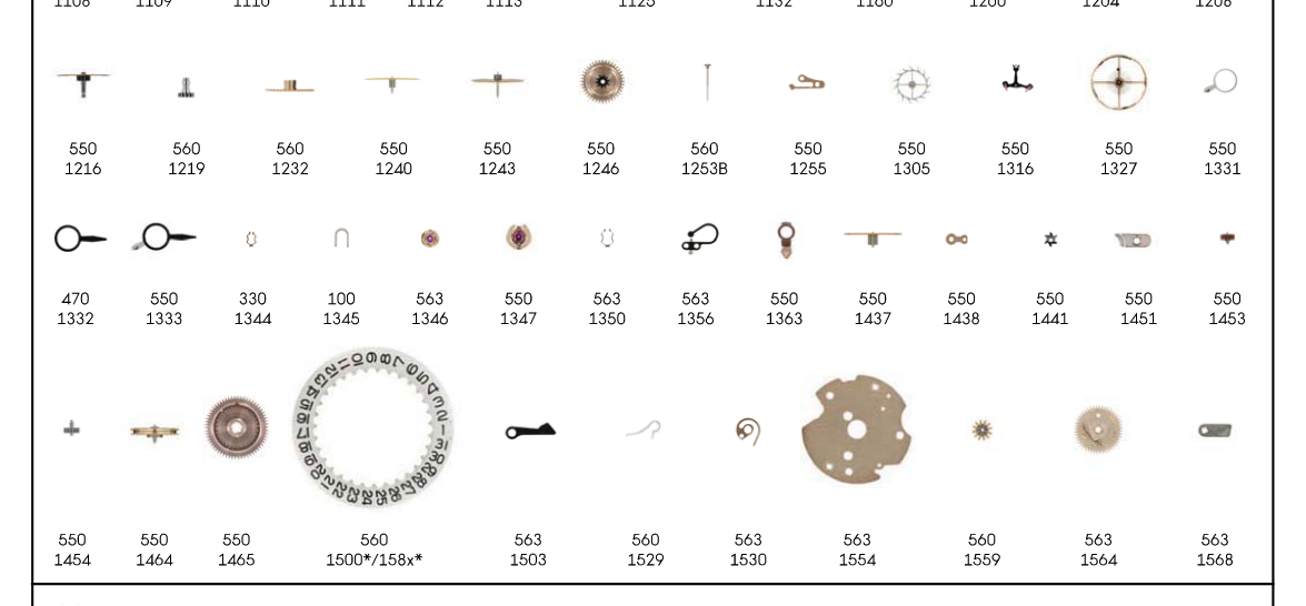

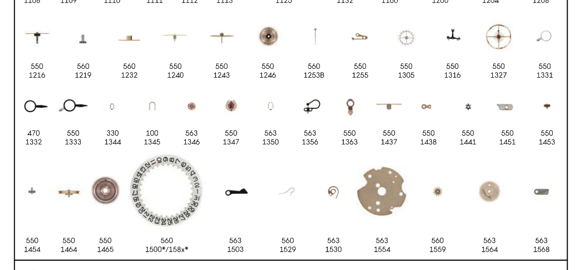

often the part 1530 that fails. It must be one on the only one i don't have in stock...
12
4
Were it that part and maybe the spring I see beside it would the price be justified?
1,889
2,286
This is what he may call the spring because there's no "classic" spring on the quicket. It could also be the part 1568 that is connected to 1530. For the price it depends if there's one or two parts to change.
It could very well be those two!
I could look for them myself, but it seems that especially part 1568 is pretty expensive... maybe the watchmaker didn't give that bad of a price after all
