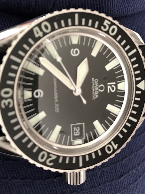

Al, greetings! This post and a number of others inspired me to buy a brand new Watchco 300. It just arrived yesterday from NZ. I opened it after work, placed a strap on, and set it in my winder overnight. Went to wear this morning and it’s not running? Any tricks to get the Cal 565 kickstarted if it’s been sitting awhile? Thanks! Chris

Hi Chris,
You can manually wind the watch using the crown, but if it hasn't built up enough of a charge being on a winder overnight, then the watch may be faulty. I would start by unscrewing the crown and turning it clockwise for 30 full turns to wind the watch - if that doesn't get it running, then you need to talk to the seller (I assume Watcho/abouttime) about sending it back as defective.

Al, here is my follow up (and also what I sent to the seller, (abouttime):
Follow up: I unscrewed the crown and wound it clockwise 20-30 turns and it ran for a minute or two. It then got hung up shy of :45 and then released for one more minute or so. Came up shy of :45 and then stopped again.

Are any of the hands touching?

I'm going to take that as a "no". That seemed the most logical reason for it to be stopping at the same spot.

Sorry, my text was cut off when uploading. I'm at a loss to what it's doing, but I've also never opened up a case back, inspected a movement. I appreciate the troubleshooting, as I'd prefer to keep it and get it running as opposed to sending it back.

Well, you should at least get them to cover the cost of getting it serviced...

So, I unscrewed the crown (from the screw-down setting) and the seconds hand took off again making a single pass around the dial before locking up again at the :40 mark.

True, Al. That's what I have proposed in my note to them. Return or they cover Omega servicing the movement.

The second hand is probably touching the crystal if it always stops at one point and it doesn't seem to be hand interference.
Unfortunately you need a Watchmaker who can re-align the hand(s).

Fellas, after a holiday spent pondering I have decided to return the watch. I do appreciate all of the advice. I think this one has a place in my collection someday, but I'm a bit thrown off by the whole thing.
