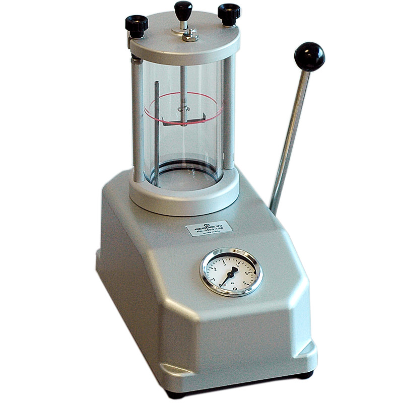

This is a printout from a dry testing machine. My gut tells me that if the machine he has only goes to 6 bar, and he didn't give you a printout, he's probably using an older technology machine like this:
This has a max. pressure of 6 bar...
If the watch was being fully tested to Omega specs, it would have been tested in a dry pressure testing machine using both vacuum and pressure (-0.7 bar and +10 bar respectively) and then placed in a high pressure wet testing machine, and tested to 125% of the rated pressure, so in this case 37.5 bar or approx. 375 meters.

Note that this equipment costs a good deal of money, so not every independent shop will have it, but if they are certified by Omega it is required equipment. Just to give a sense of costs, the Bergeon tester that goes to 6 bar costs about $800 US or so. The combined cost of the dry tester and high pressure wet testing equipment I use is 10+ times that number.
