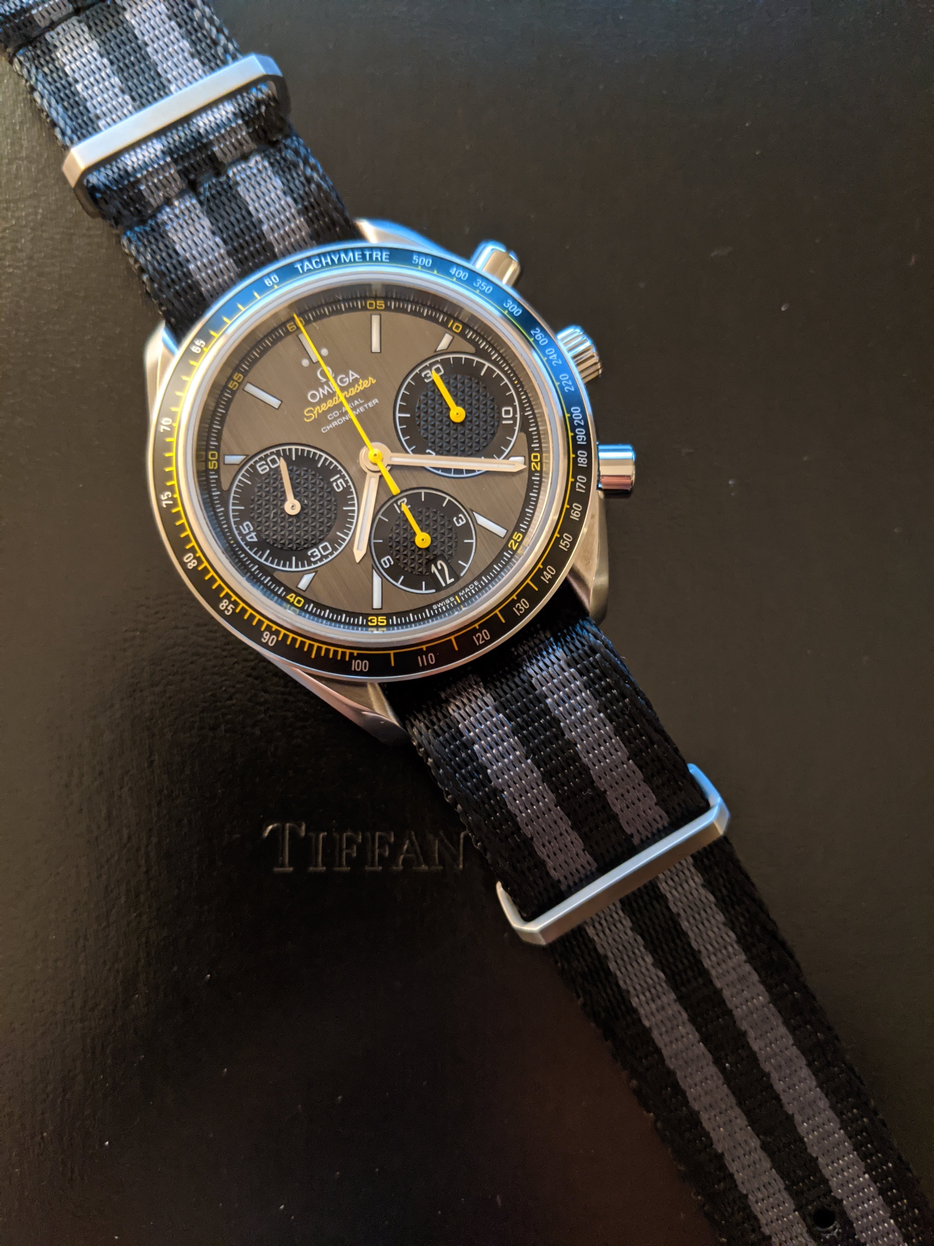

Hey just got an unworn Speedmaster Racing with the 3330. Gave it a full wind until the crown stopped me, then laid it in my watchbox. Barely 24 hours later, I noticed the seconds stopped. I'm assuming it ran out of juice. Wound it again and took only about 10 revolutions of the crown to get fully wound.
Ain't this thing supposed to have a 52 hour reserve? Thoughts?
The crown is not supposed to stop you on an automatic watch. 10 revolutions is not enough. You need around 40.
Can confirm those 7750 based movements don’t stop winding.
