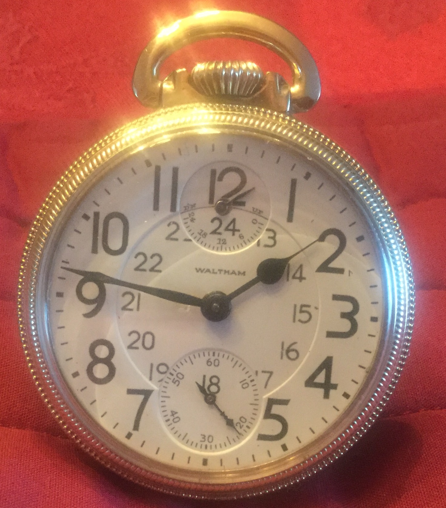

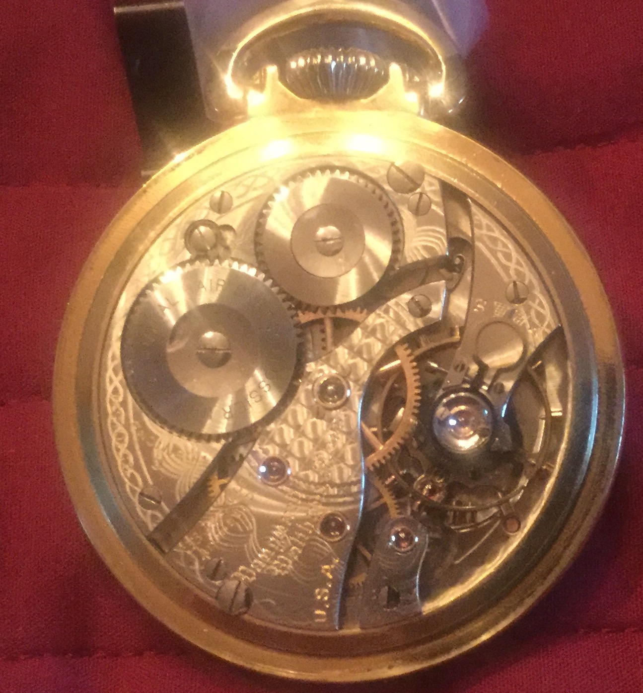

This 16-size Waltham Vanguard with the up/down indicator is an example of a watch with quite a complex system to drive the indicator hand. These are only a problem if the watch falls into the hands of a bad technician. I serviced the one in the images for a friend. His watch had been in the hands of an incompetent who was afraid to dismantle it, so he doused it in WD 40! THAT one was a problem! It also came with three teeth out of the pinion on the barrel arbor. I was able to acquire a barrel arbor from an 18-size Waltham with the indicator. A tricky bit of lathe work modified it so the arbor fit the 16-size Vanguard. This is a before shot, pictures taken when I found the watch for him, so they aren’t great. I have one, as well, but no pictures of it.

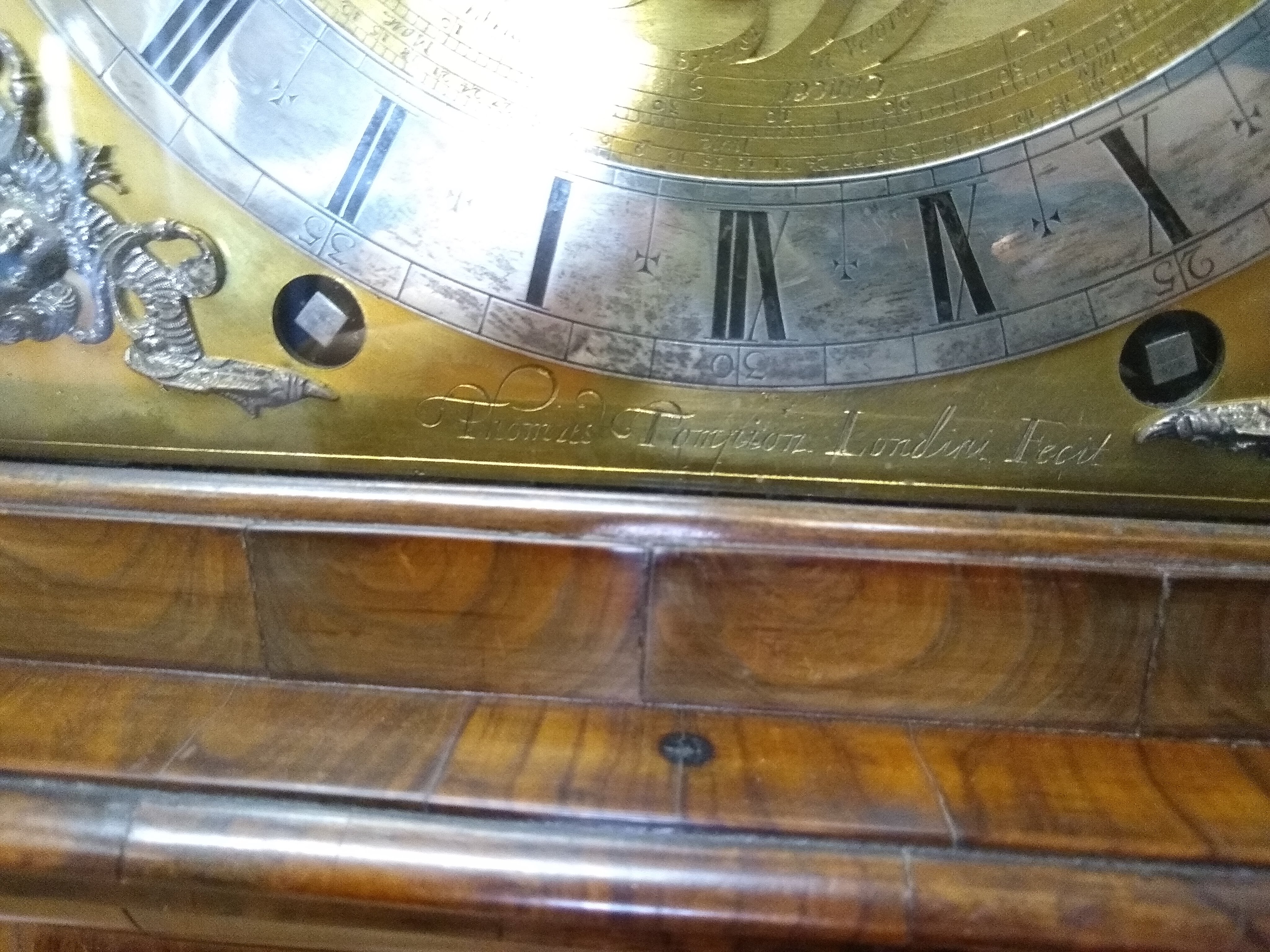

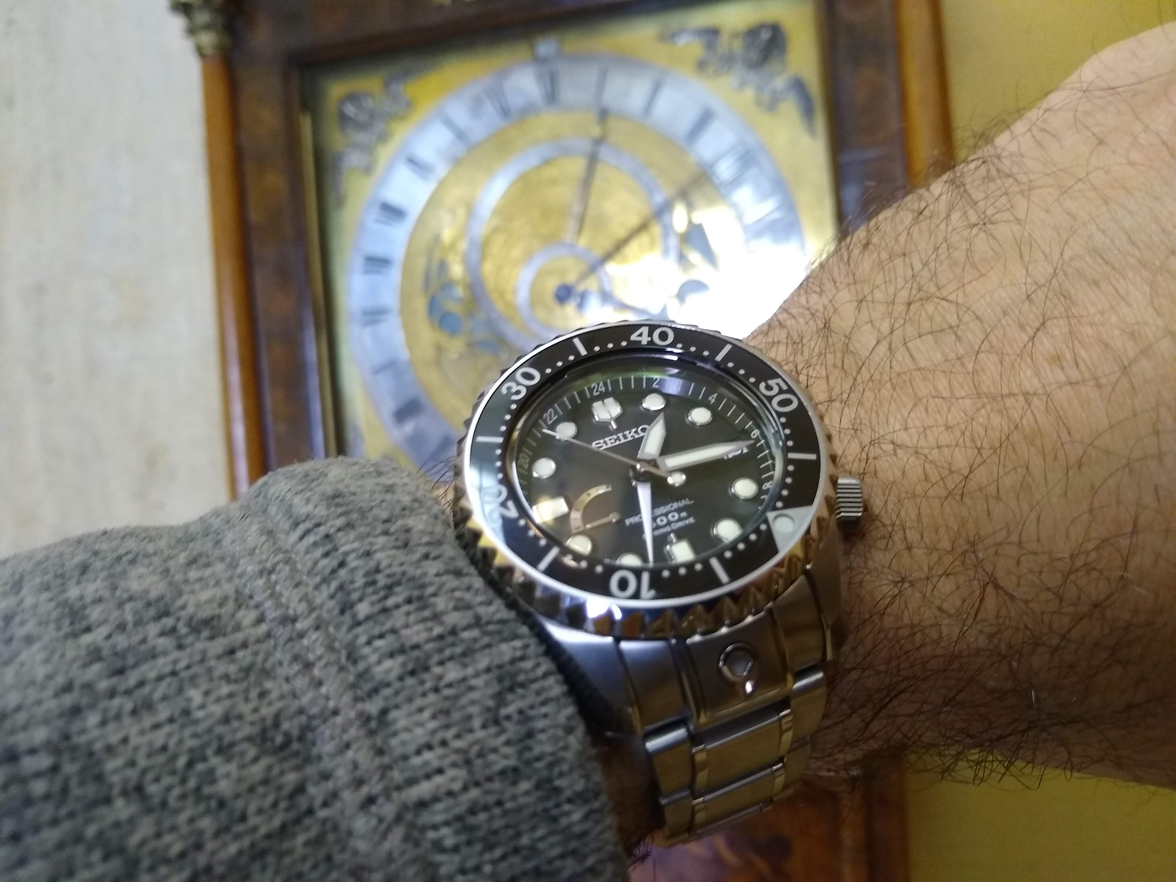

Power reserve is not exactly a new idea and if well executed, should not bring any reliability issues.

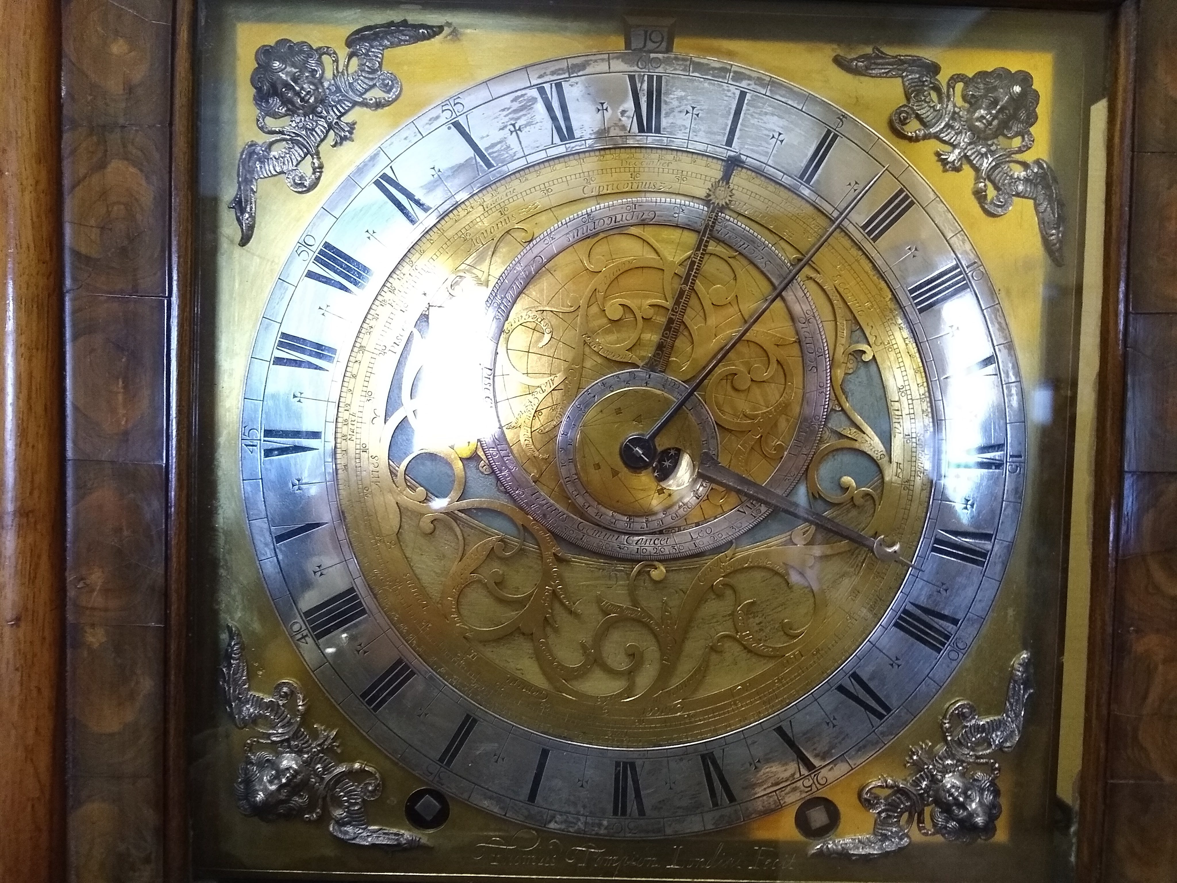

My Seiko Marine Master 600 Springdrive has a power reserve as also a true GMT hand.
Photo of it using as background a clock made by Master Tompion (I think he would be amazed with a water proof wrist watch made of Titanium with a precision of 0.1s/day).

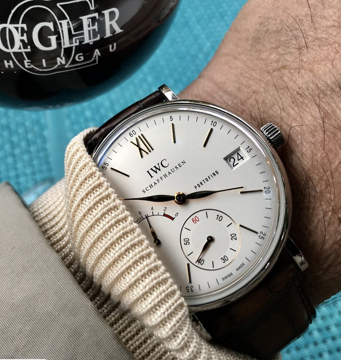

one of my two watches in my box with the power reserve feature...

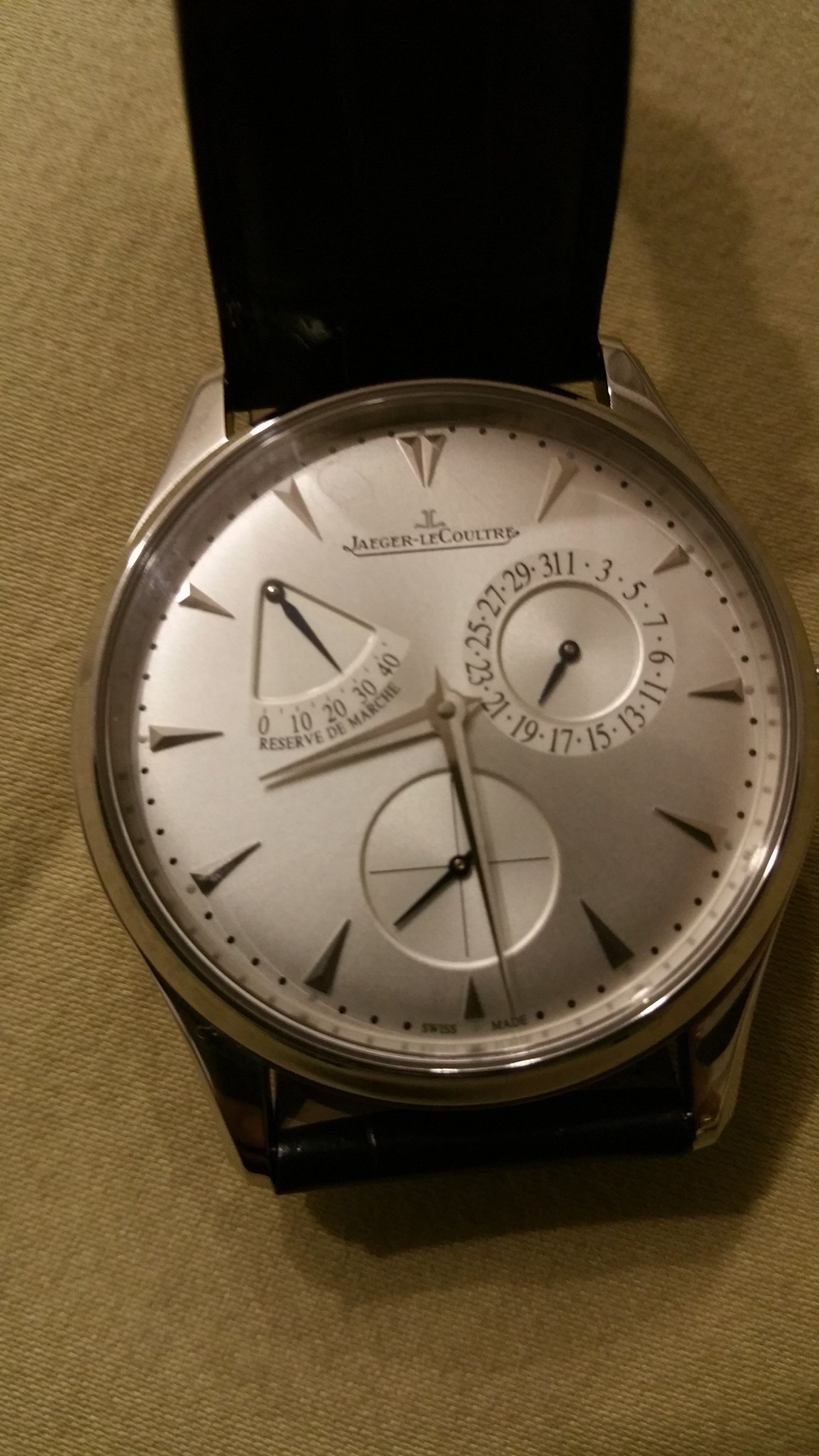

I have a thing about the sixties jlc power reserve but over my budget
