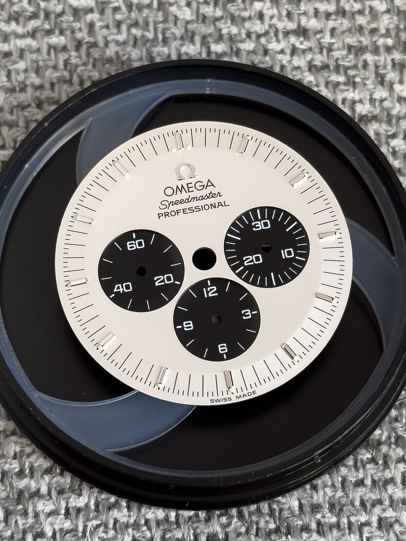

I have a Speedmaster 311.30.42.30.01.005. Whimsically researching dial swap modifications. Will a 3570.50.00 dial fit.
Yes
I really like the salmon Sedna dial, but that is for the 3861.
Not too long ago someone sold a Speedmaster mod with a 3861 dial on a 1861 movement.
The listing made no mention if the dial had been modified to fit, so compatibility may not be your issue with this. Parts availability for sure will be as you won’t be able to find the Sedna dial as a standalone part.

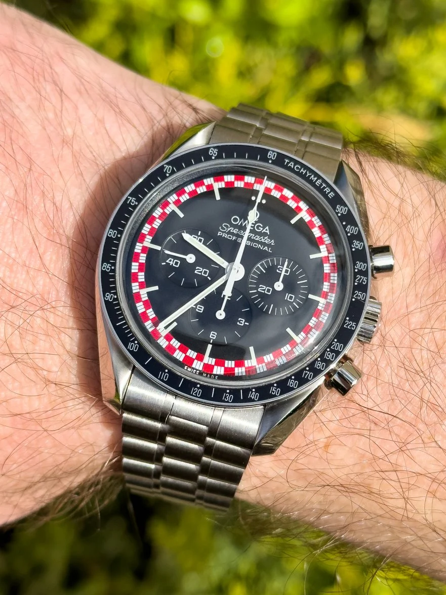

My biggest suggestion is to search with patience. Connections on this forum can be your biggest asset as well a quick response time for if a deal pops up in our parts section. In 2021 I picked up this TinTin dial from another member on here. A couple months after buying the dial, I bought a 311.30.42.30.01.005 specifically to put the dial in.

It is and has been my most worn watch

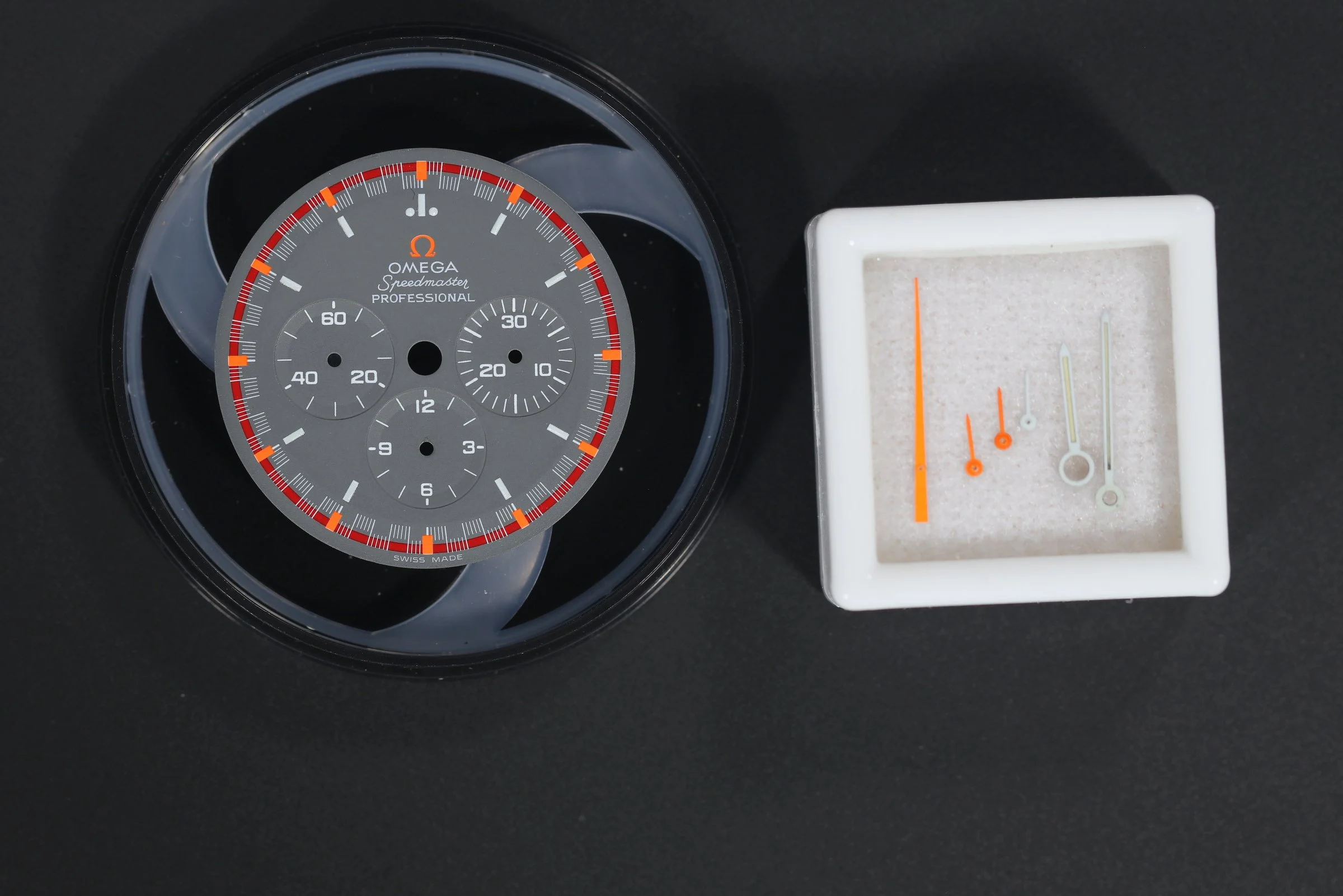

And through a super lucky turn of events and a quick response time, I bought a Mitsukoshi dial/handset earlier this year from our parts section.

Patience is definitely a virtue. Earlier this year I picked up a NOS Mark II Racing dial and handset on Yahoo Japan. It will eventually make its way into a Speedmaster service case with a serviced 1861 movement. Not quite the same as a 3570.40, but as close as I’m likely to get in the foreseeable future.
