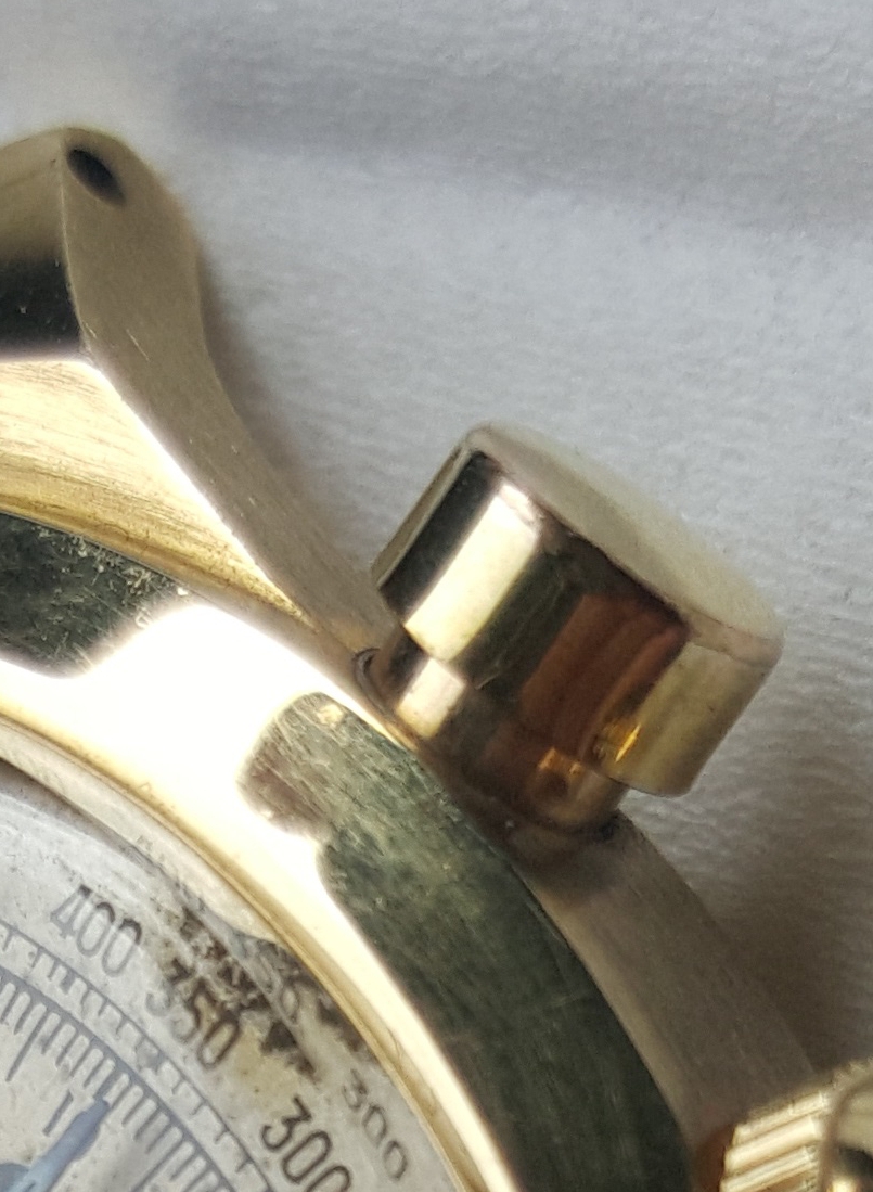

This is a very nice an impressive watch ! But since you asked a feedback, it seems that the pushers are wrong for this ref. and that it was heavily resatinated, no ?
Hi thanks for feedback.
Pushers seems to me equal to the one you have for sale.
Are they different?
What do you mean by "heavily resatinated'?
Thnks

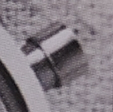

Picture from SALA

Picture from SALA
If you look at the photos of the spillman pushers you can see the pusher cap to pusher tube ratio is very tight, meaning there is almost no lip on the pusher cap where it meets the tube. I believe it's around 4.5mm on the cap and 4mm on the tube. With your gold spillman you can see the diameter between cap and tube is very different.
I'm not saying that is wrong, I have no idea......

You are righ for the pushers ! I guess that we have ultra rare prototypes ! 馃槈
I ment rebrushed case and back but maybe not, the watch looks absolutely great anyway !

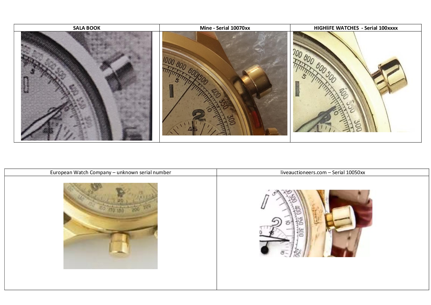

You mean this difference?
The cap in mine is larger than in Sala is that?

yes, that difference. It is hard to say if the cap is larger, it's the relationship between the cap and tube that is different. Perhaps the cap is the same size but your tube is smaller? Or perhaps both are different? You would need precise dims with a caliper.....
I can't tell if yours and Jo's are the same, they look different to me, and perhaps both different to Sala, although Jo's looks closer to Sala offhand, again, I think you would need accurate dimensions to tell what is going on....

Please have a look to this.
I can agree my cap is thinner, but also tube size in my Compur is similar to SALA than in Highlifewatches compur.
I found some others on internet, and I can not precisely say which is correct, but highlife is the similar I could found.
Also when one size and crop the picture the ration between large and high changes and that might have some influence.
Any way watch is now at SPA, and to my watchmaker tubes are correct, and caps fitted perfectly to him, but who knows.
I am pleased with the watch, and in the end that麓s what matters to me.
Thanks for all your feedback
Sorry if I offended someone for posting these pictures without due permission

yes, obviously some variation going on between all those different photos, but who knows why, and which is "correct"....
enjoy 馃憤
