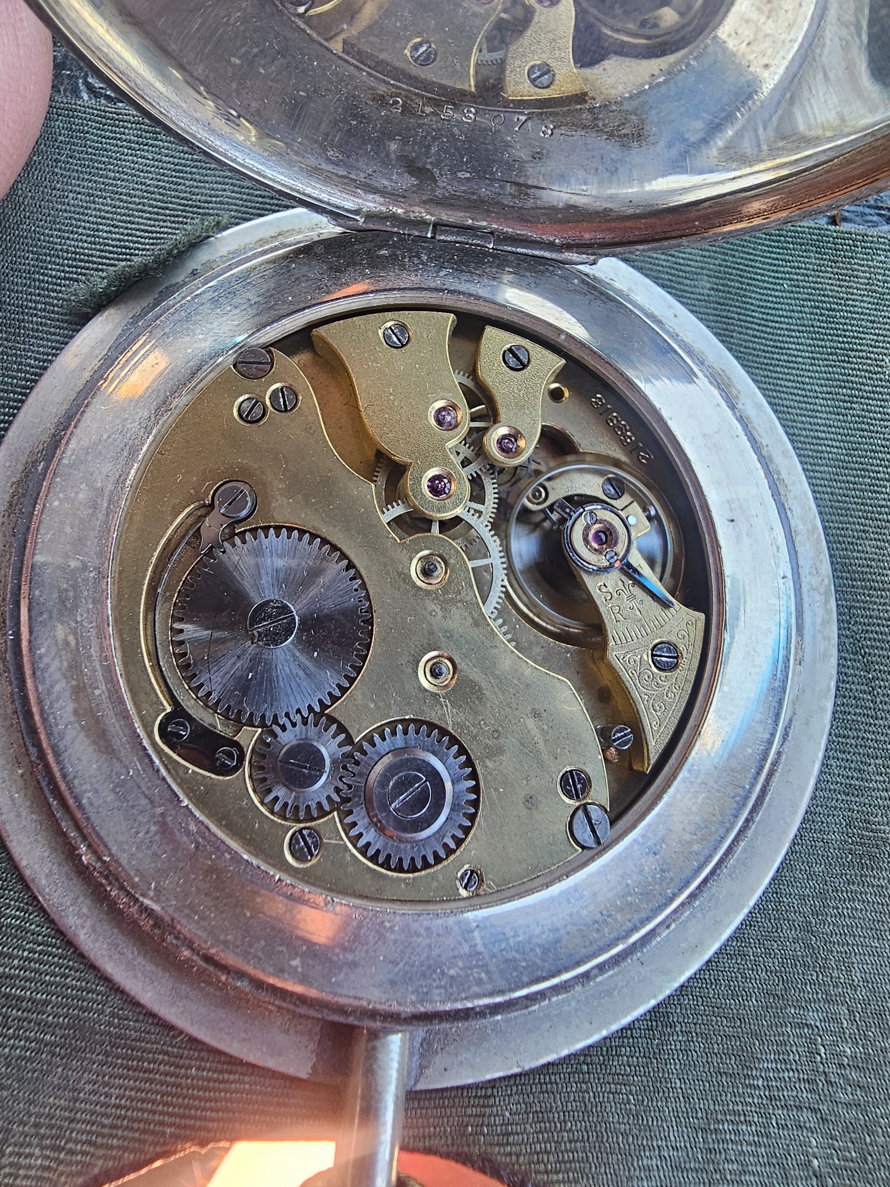

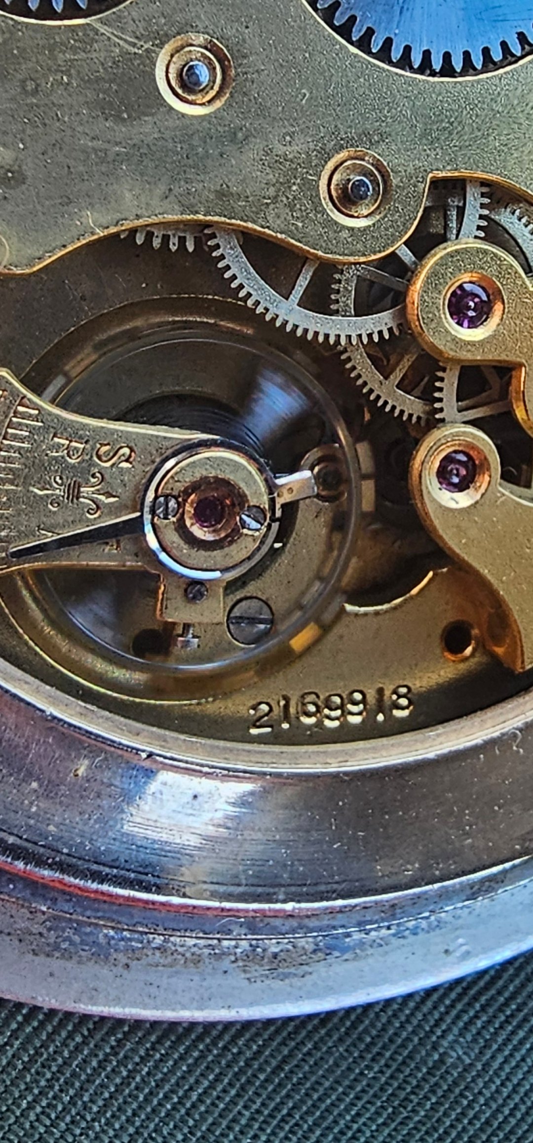

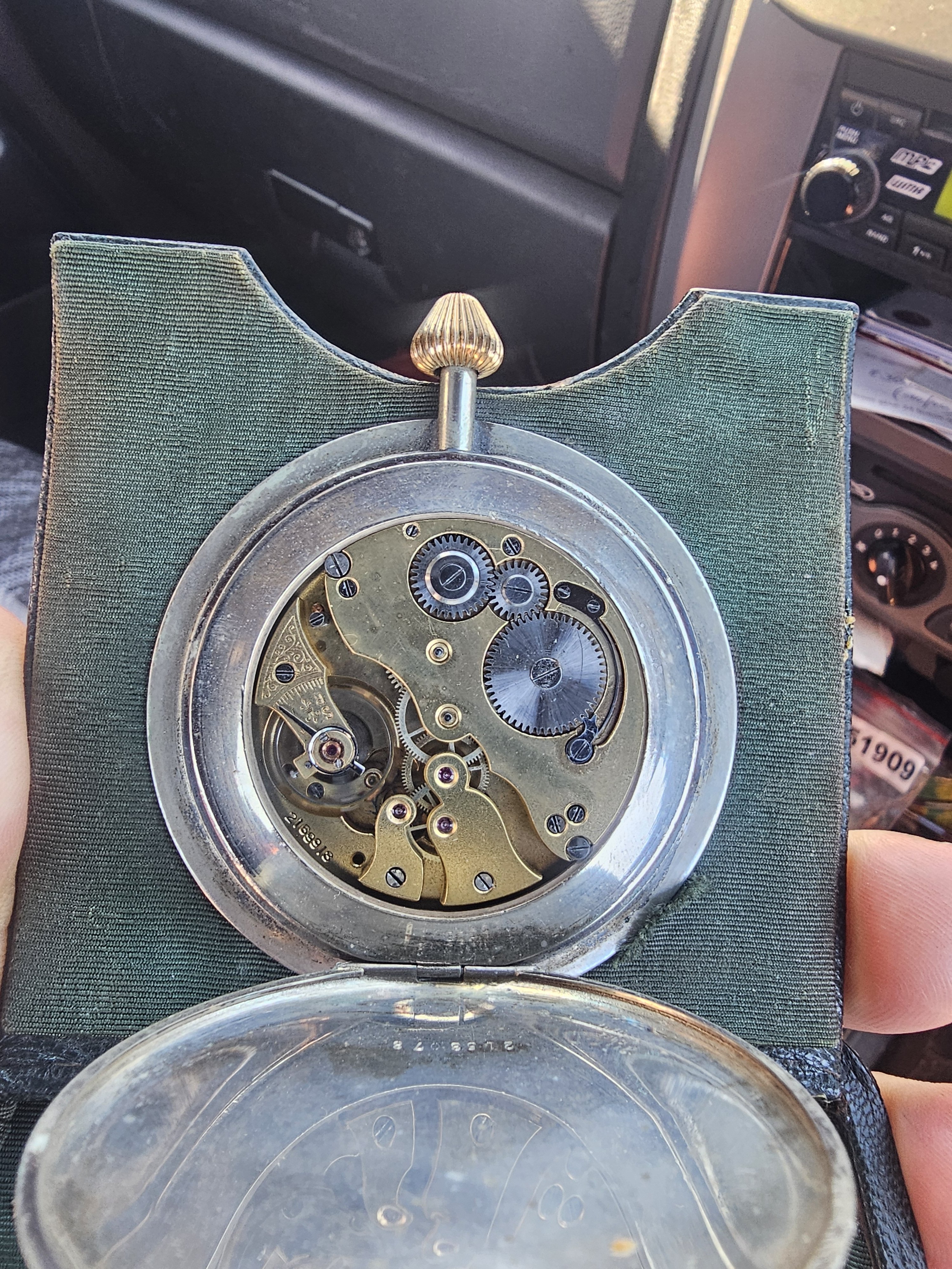

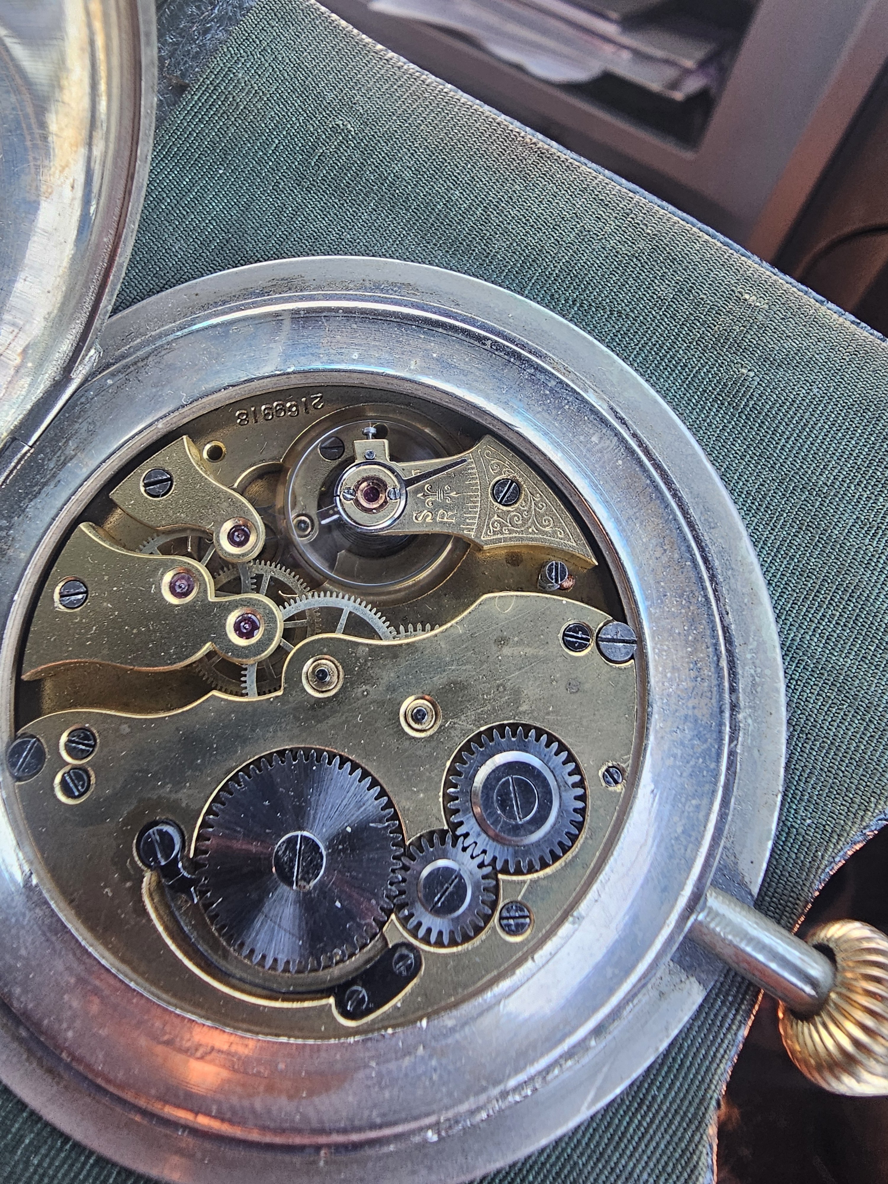

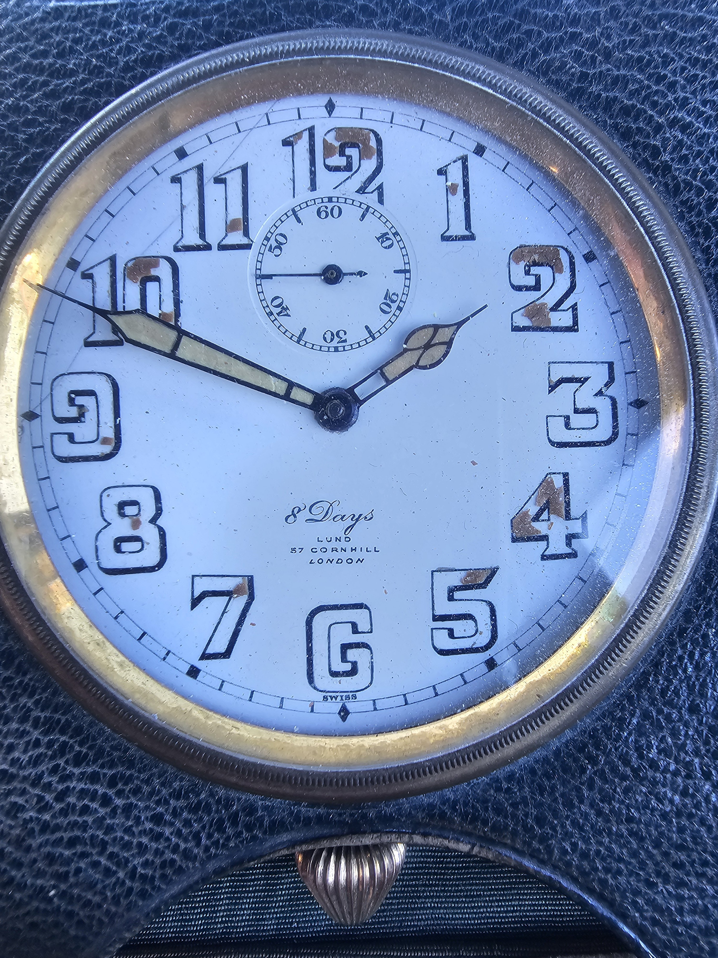

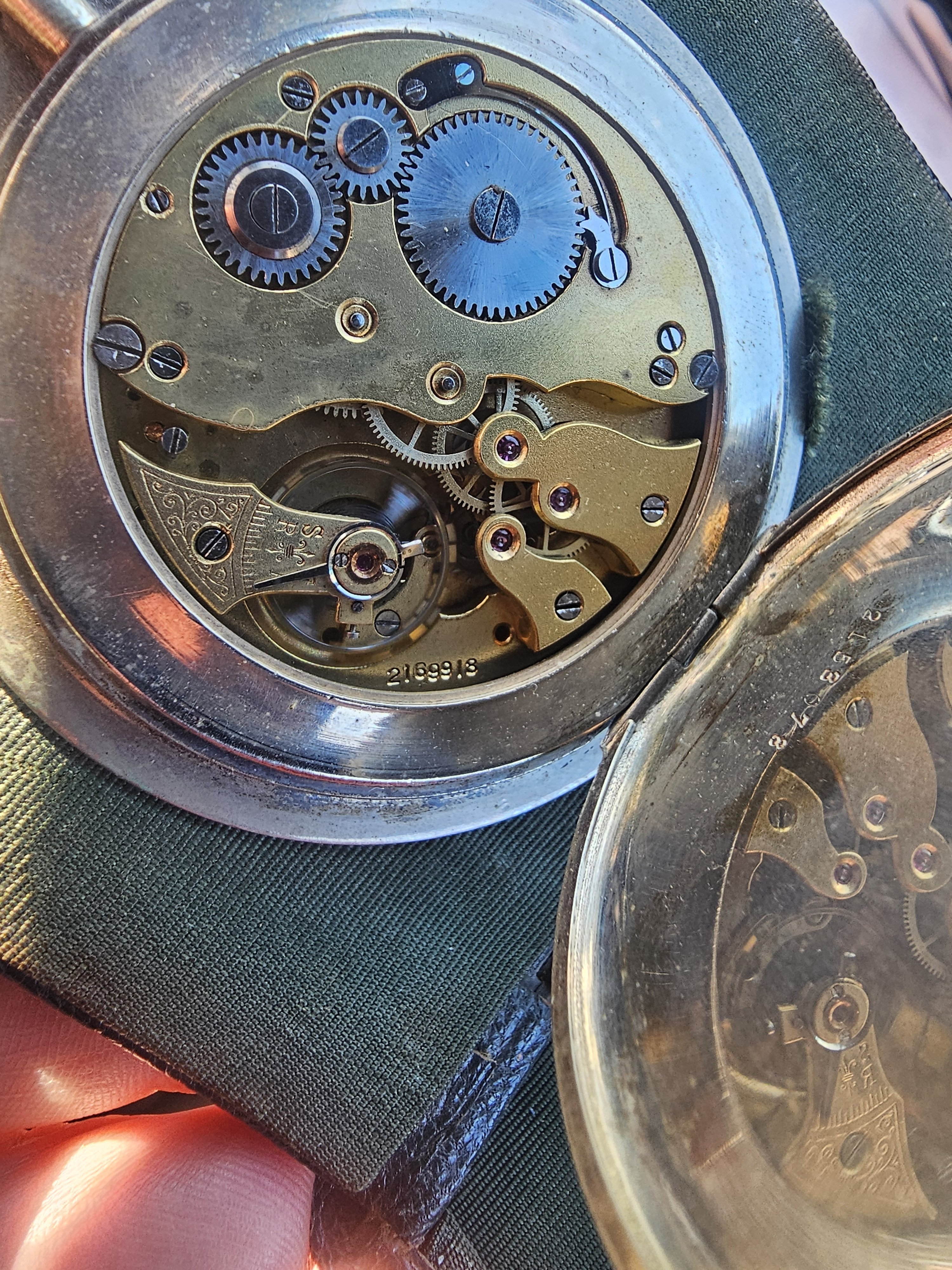

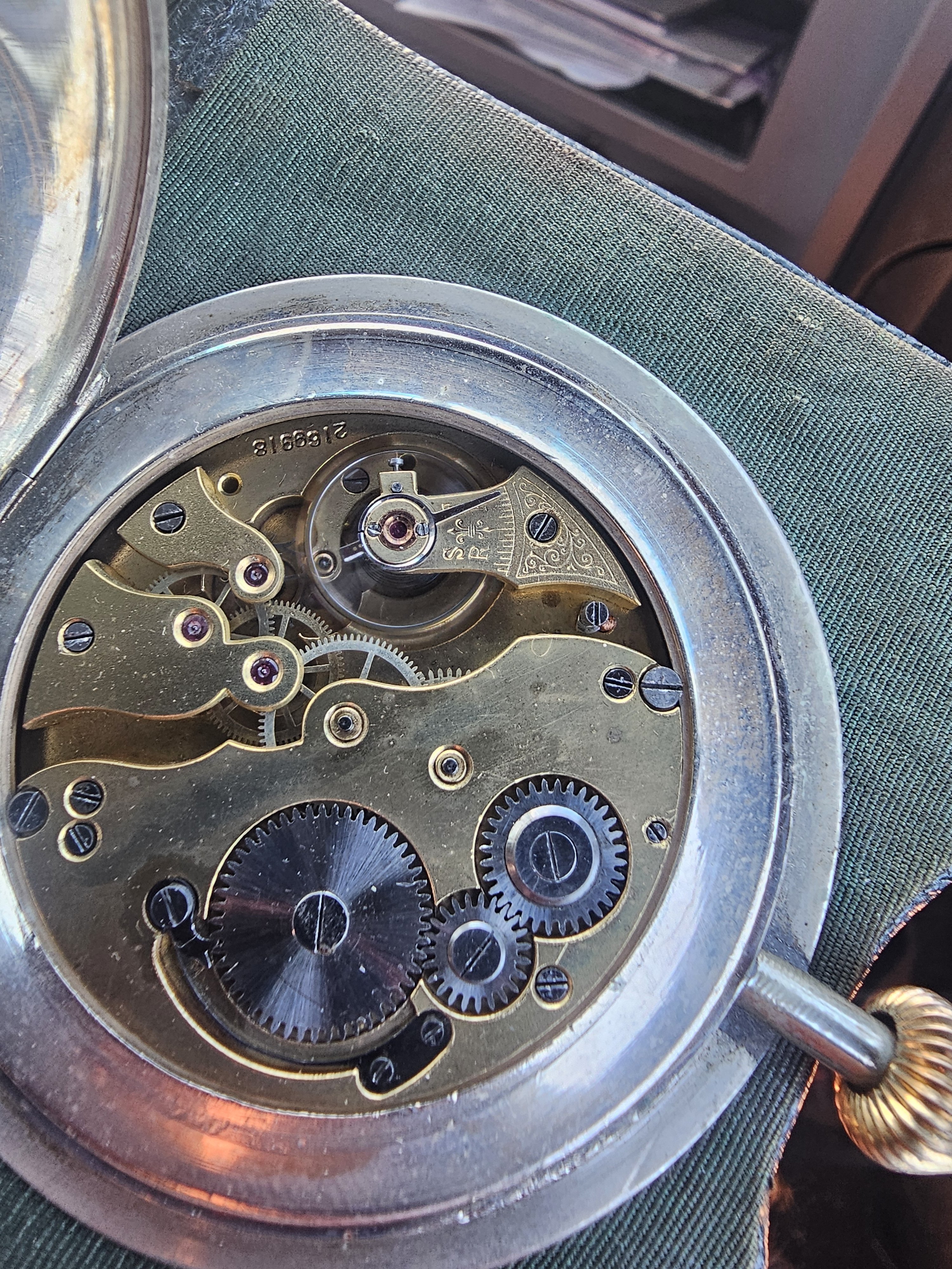

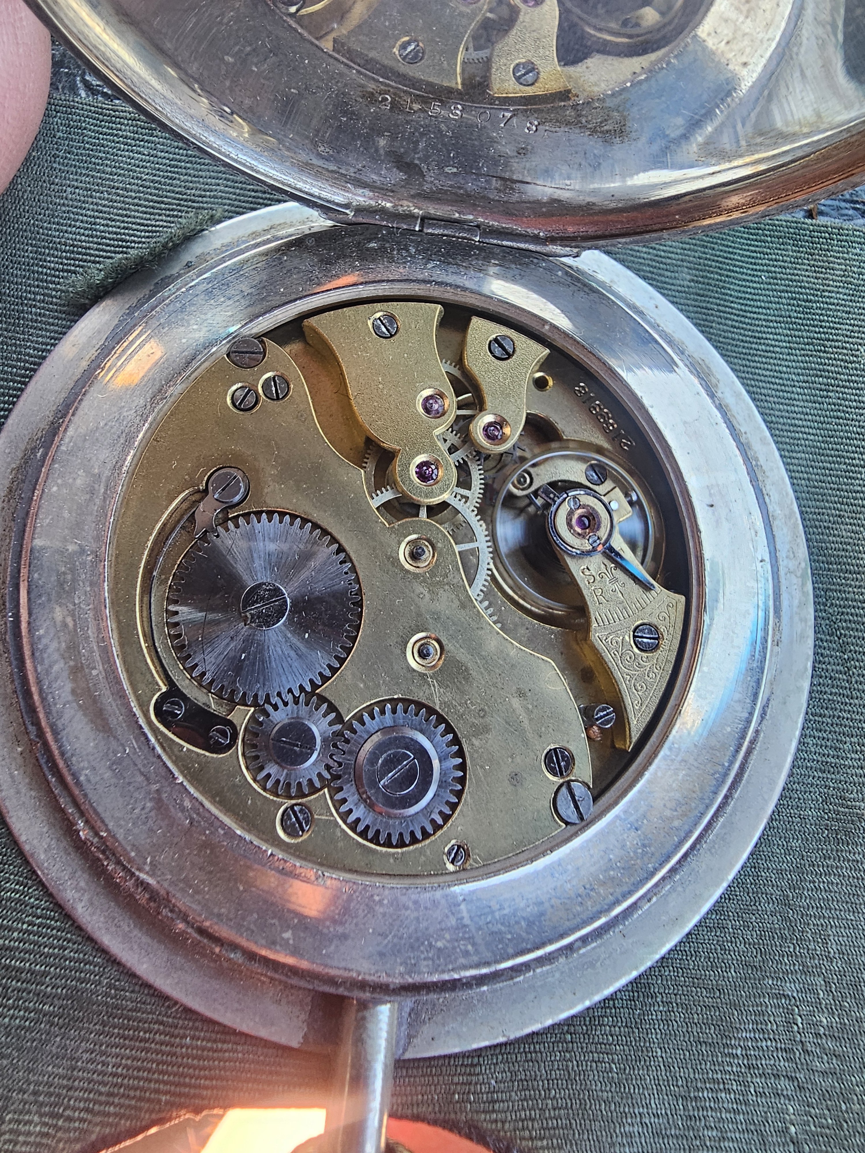

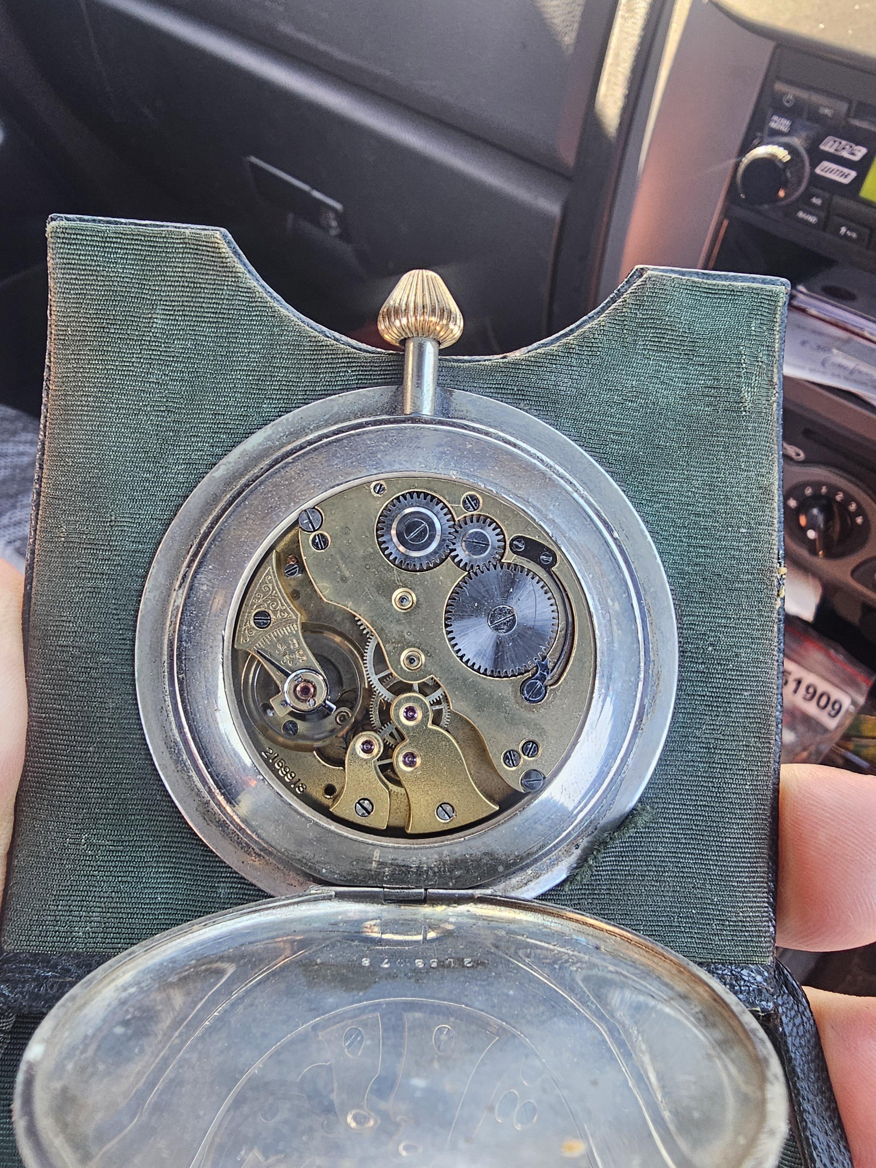

Posts 740 Likes 4,699 Raymondo5508 ·Apr 22, 2024 Hi, I just picked up this 8 day travel clock and was wondering if the movement could possibly be a non signed Longines?? Can can any of the members helps since we can't send to the online Longines site. Cheers Russell.

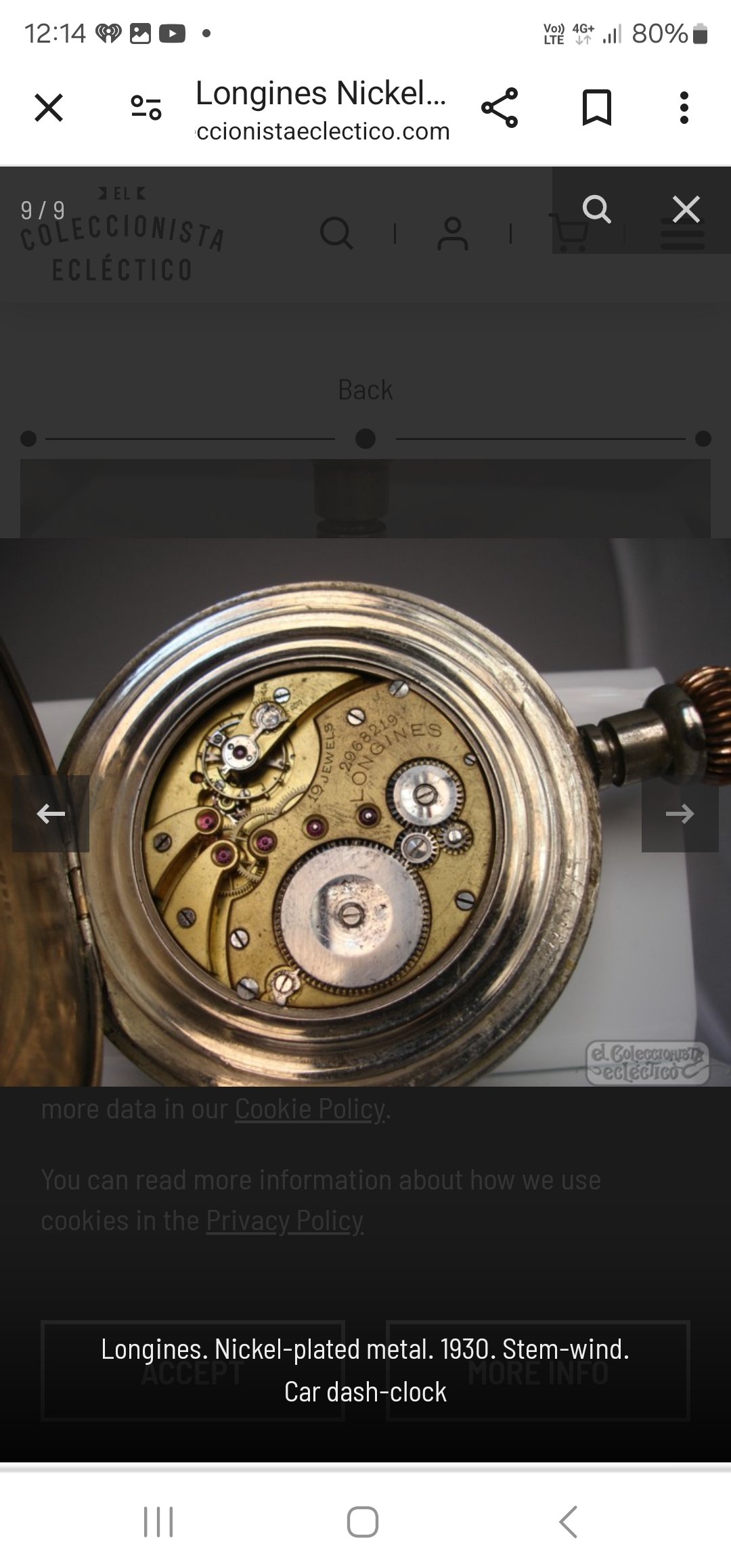

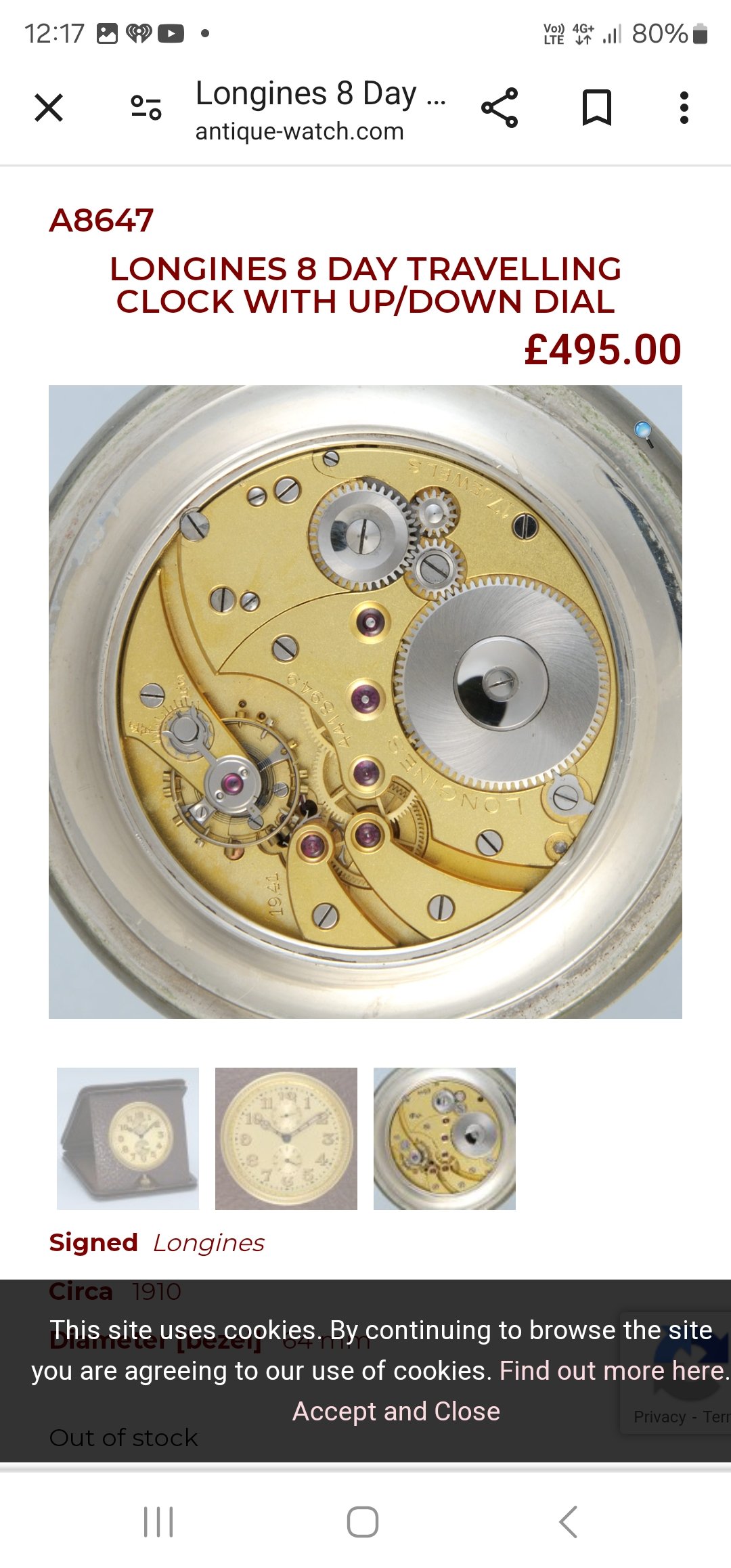

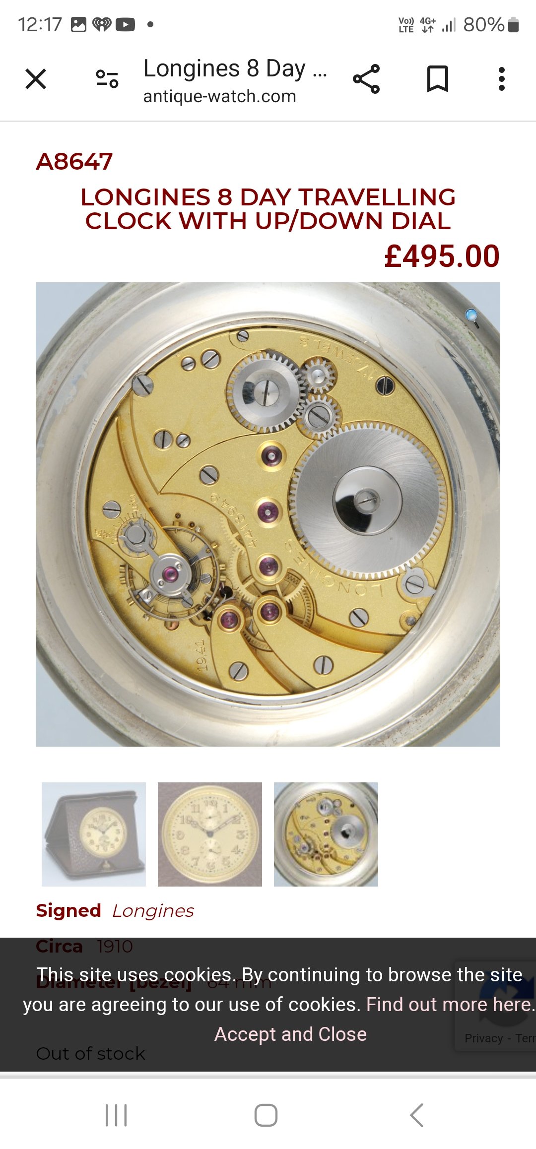

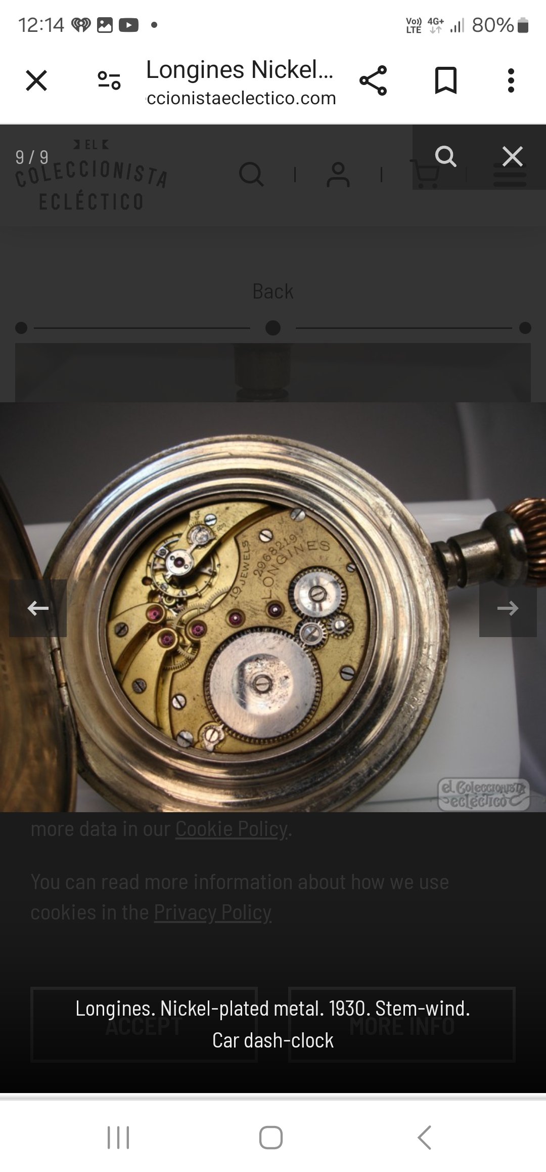

Posts 740 Likes 4,699 Raymondo5508 ·Apr 22, 2024 DirtyDozen12 Neat movement, but does not look like Longines. These are Longines 8 day travel clock movements I found on the net for comparison?
Posts 2,829 Likes 4,948 DirtyDozen12 ·Apr 22, 2024 Raymondo5508 These are Longines 8 day travel clock movements I found on the net for comparison? Indeed, that is Longines' most prevalent 8-day movement, caliber 19.44.

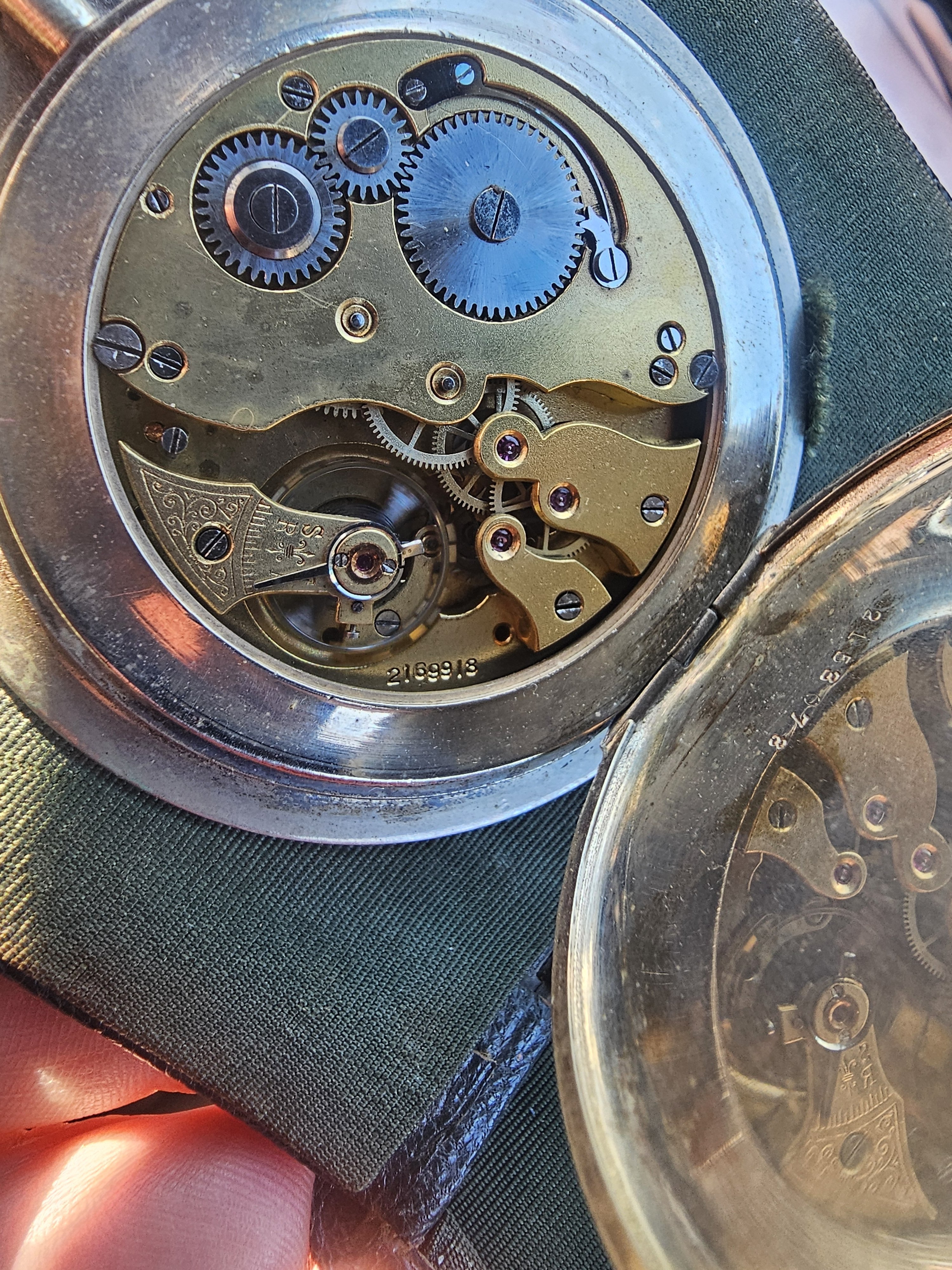

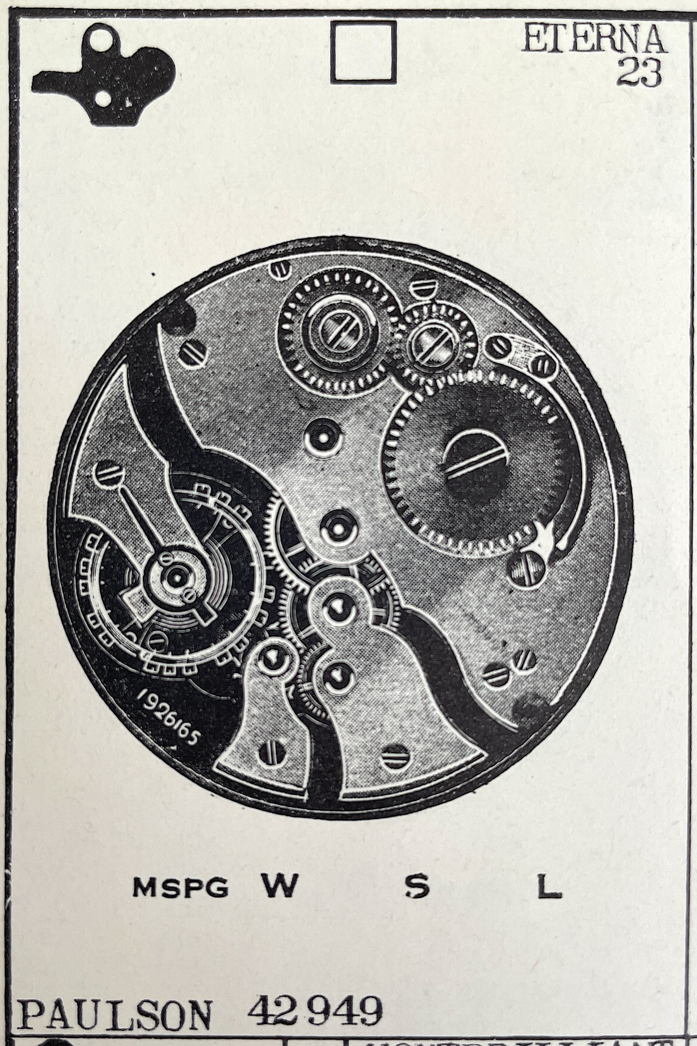

Posts 18,851 Likes 39,205 JimInOz ·Apr 22, 2024·Melbourne Australia If it's a 19''' size it looks to be an Eterna caliber 23.
Posts 740 Likes 4,699 Raymondo5508 ·Apr 22, 2024 You are on the money JiminOz.... I will measure the moment. But 19 ligne looks right. Many thanks. Cheers Russell.
Posts 2,829 Likes 4,948 DirtyDozen12 ·Apr 22, 2024 JimInOz If it's a 19''' size it looks to be an Eterna caliber 23. Thanks for identifying it!
