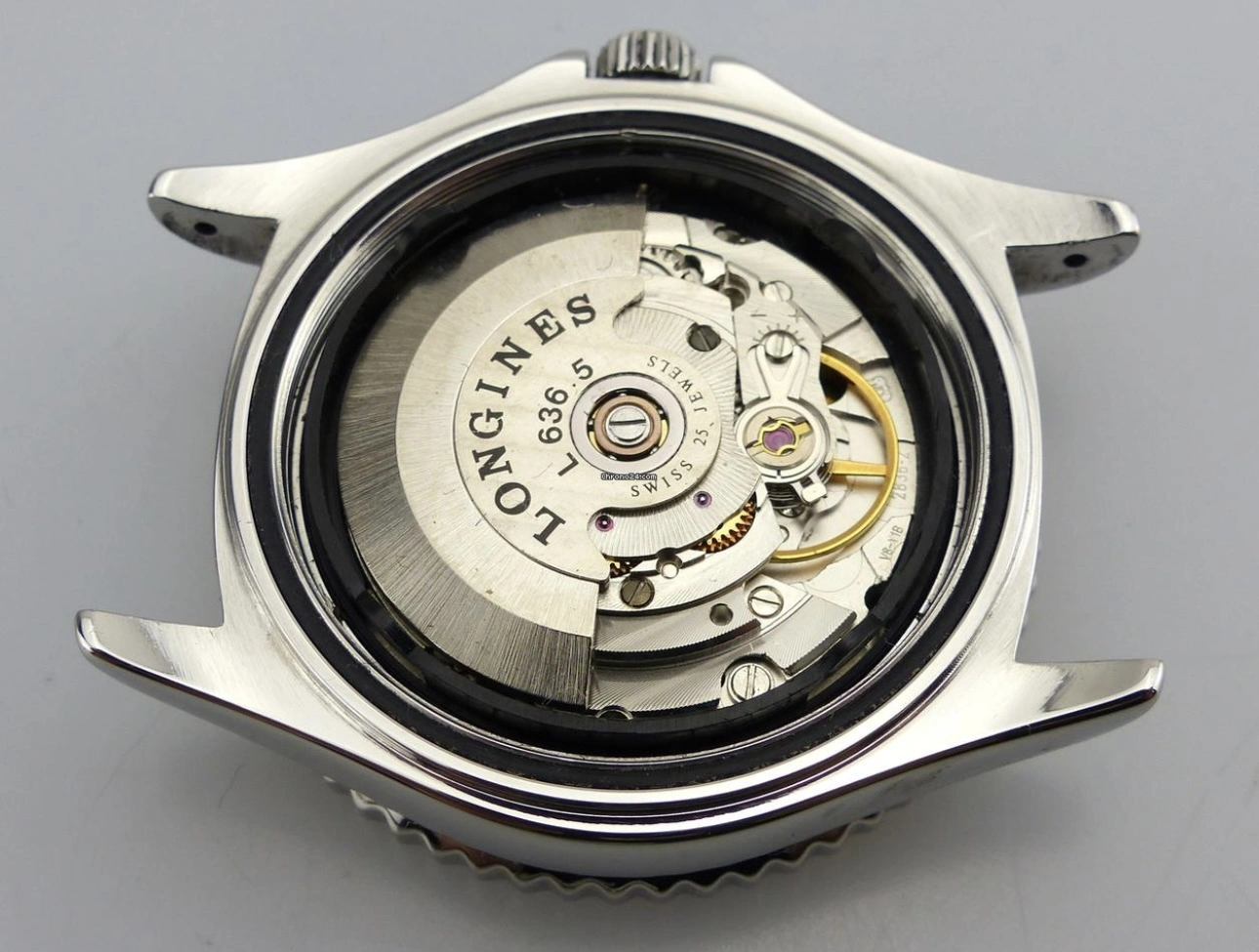

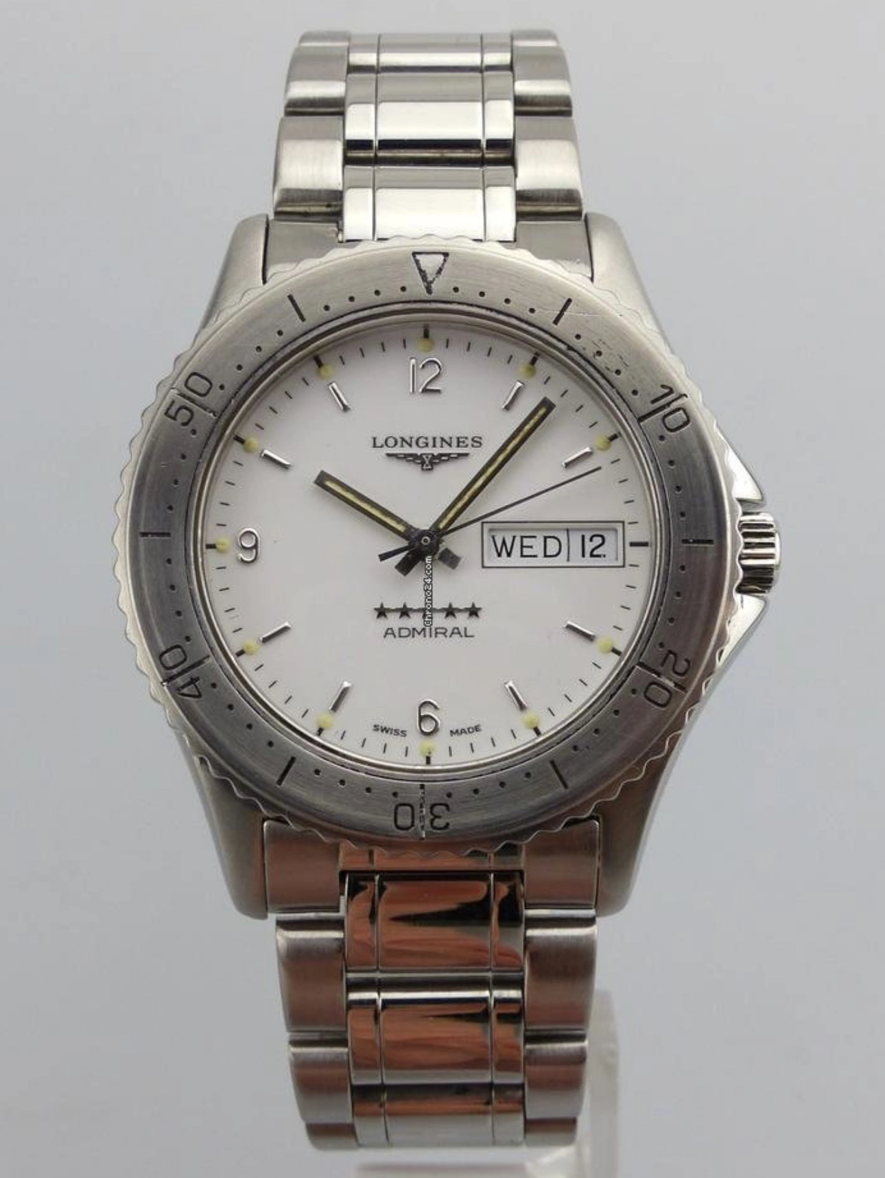

I’m starting to understand more about vintage watches, movements, calibers, etc. I was wondering about this watch that I just got. The admiral line from the 90s with the Day/Date function. They included a picture of the movement and it had me wondering. I had looked up the movement and watch, not many references on it so I’m questioning the authenticity.
Any help would be appreciated.

Honestly: I think that might just be real. That L636.5 was just a rotor on an ETA 2836, and that image looks like a lot of them.
It MIGHT be missing a screw on the far side(between the balance bridge and the automatic bridge), and the ETA logo looks different (they are usually clover leaf things, so IDK what the logo is under the balance), but that actually looks 'about right' to me.
Some manufacturers did some... pretty questionable looking (low effort perhaps is a better word) customizations of movements in the late 80s/early 90s, and this model is 100% that.
I also doubt someone would pay to custom engrave a fake Longines 30 years ago.

Interesting, I kept looking up L636.5 and nothing came up, so it’s good to know it’s a genuine movement. I was originally put off by the black lettering for the Longines logo on the rotor so I’m happy to know I have a new genuine daily watch. When I get it in the mail, I’ll add better photos of that ETA logo

Its a L636.5-7404, you can see a couple of photos of them on the internet. They came in a couple of color schemes. The bezel on this one is quite worn, but the rest seems OK. A little crud in the movement, plus maybe a missing screw (or a bad angle).
The logo is weird to me, but I can't imagine a fake would do EVERYTHING on it except the ETA logo, so perhaps there was a model where they did a square logo instead of the clover leaf that I'm unfamiliar with.
The black text DOES look fake as heck, but it seems real as far as I can see, plenty of ones online with it (see https://store.shopping.yahoo.co.jp/closer0510/840002.html , you can also see the ETA clover on that one vs your square one).
It also looks like Longines did a better job on the rotor finishing (with gold inlay instead of printed black) at one point, but that is probably just year differences.

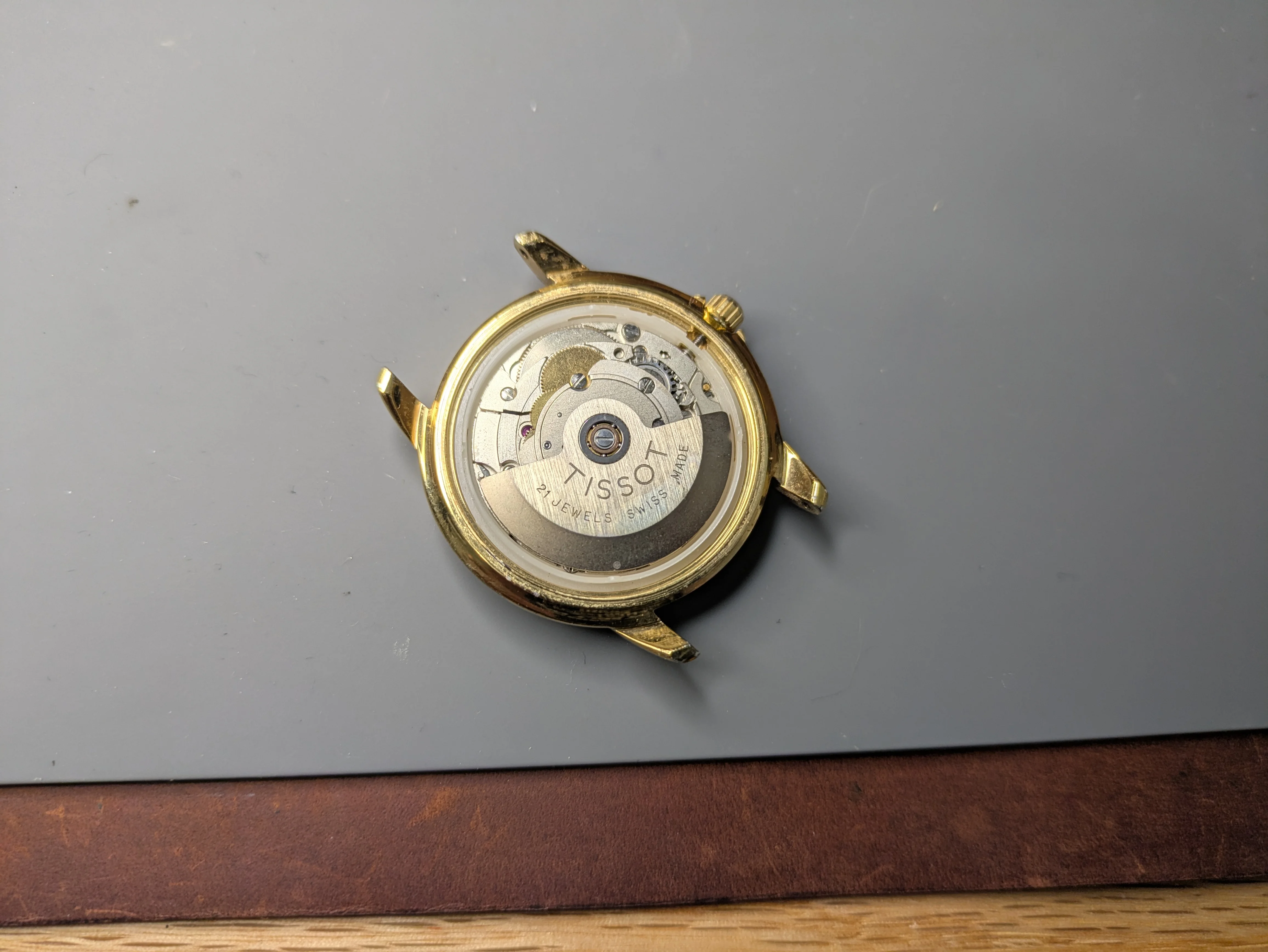

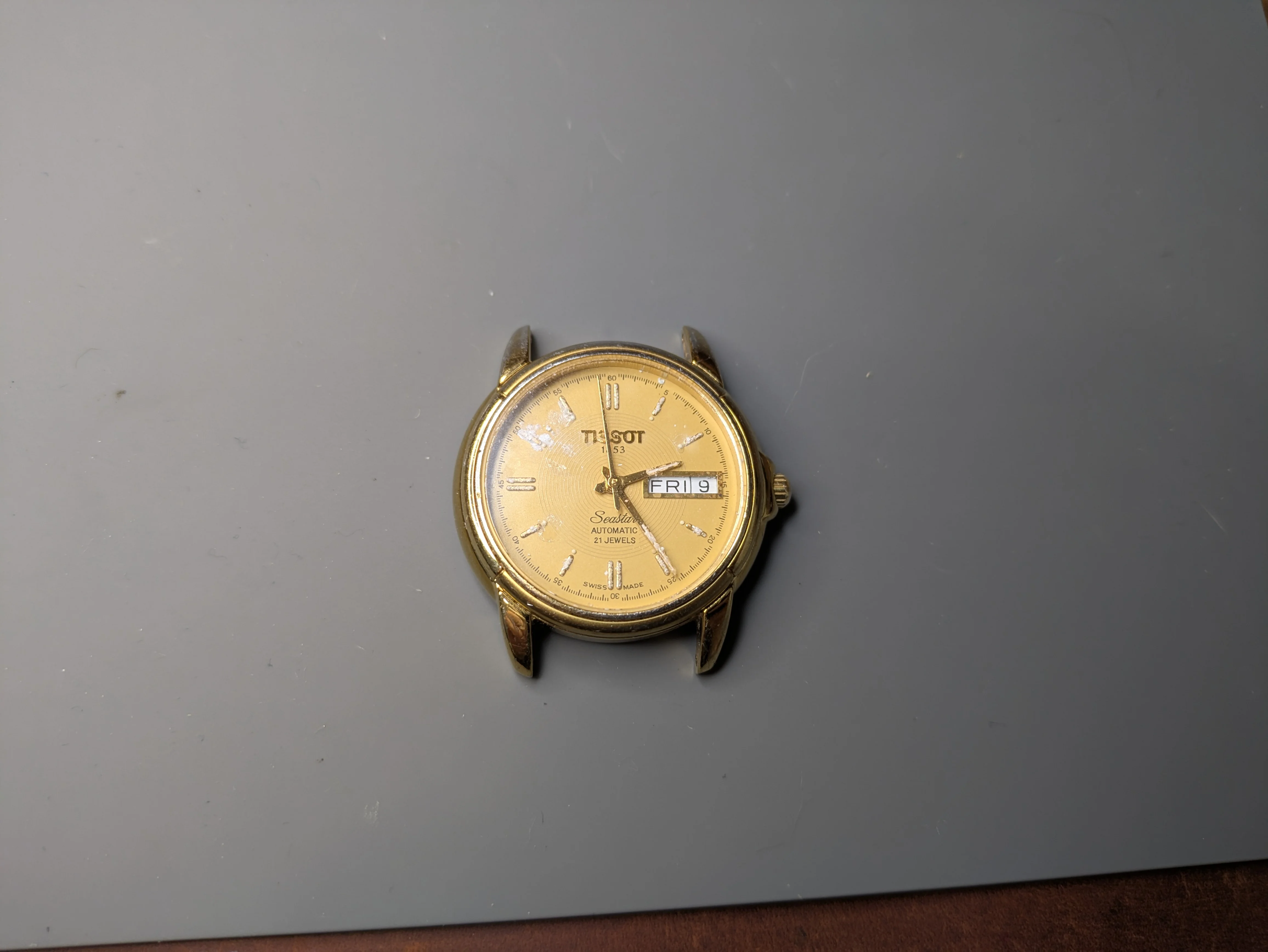

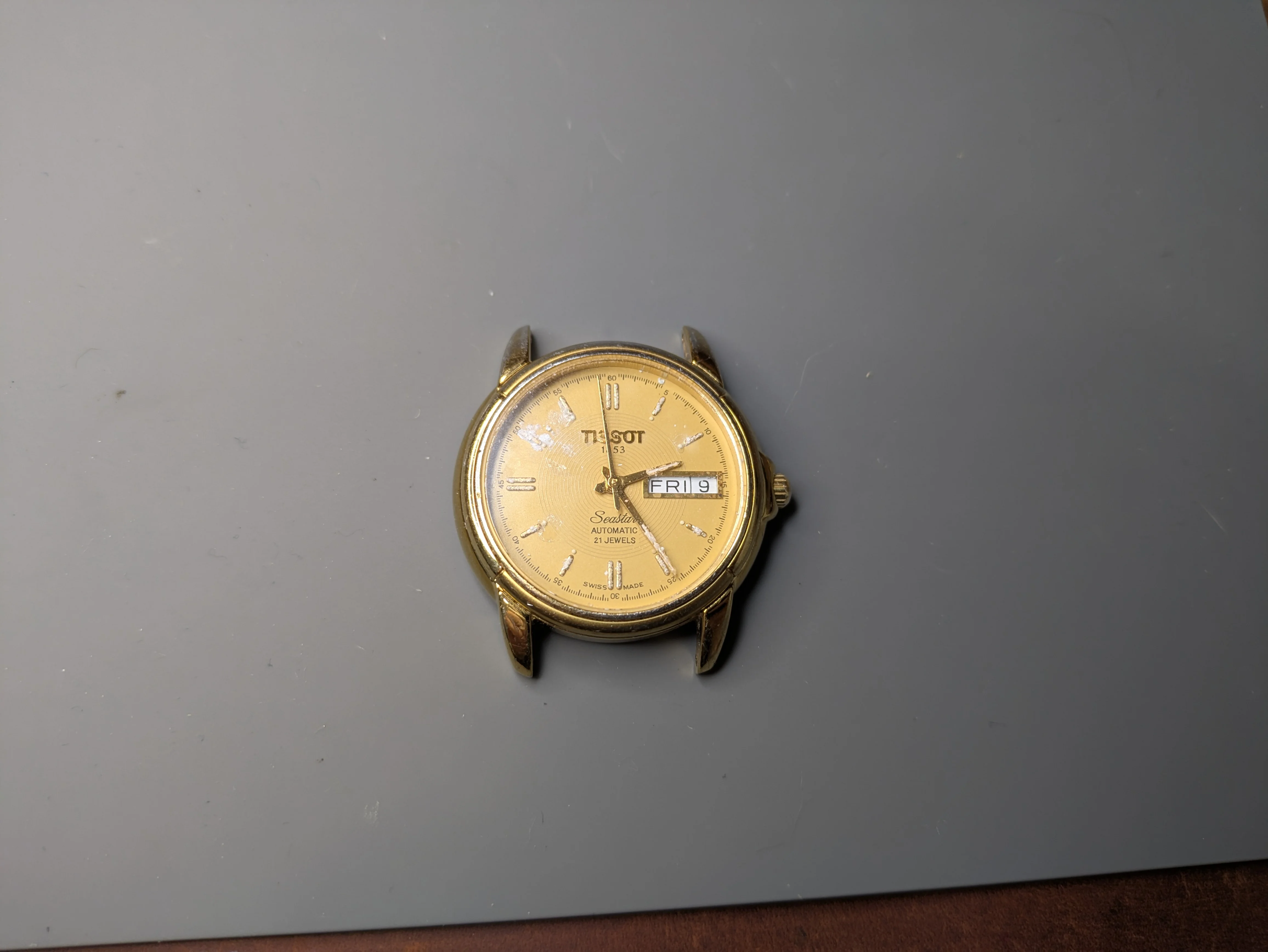

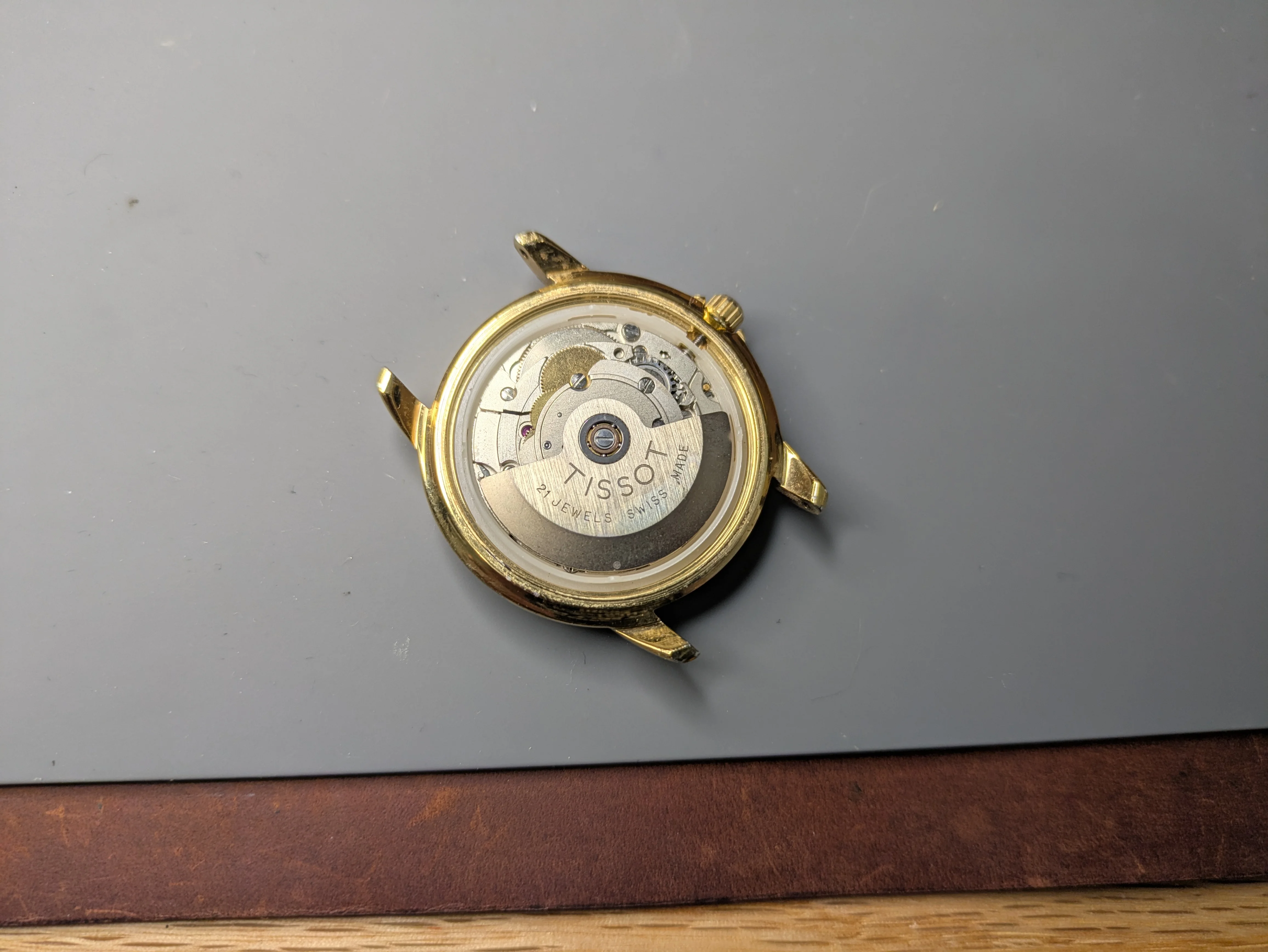

For example, I have a 90's Tissot torn down on my bench that was even lower effort. BUT, I paid VERY little for it (~$100), and was able to find NOS hands/dial for it for pretty cheap too. SO, worth the effort 😀

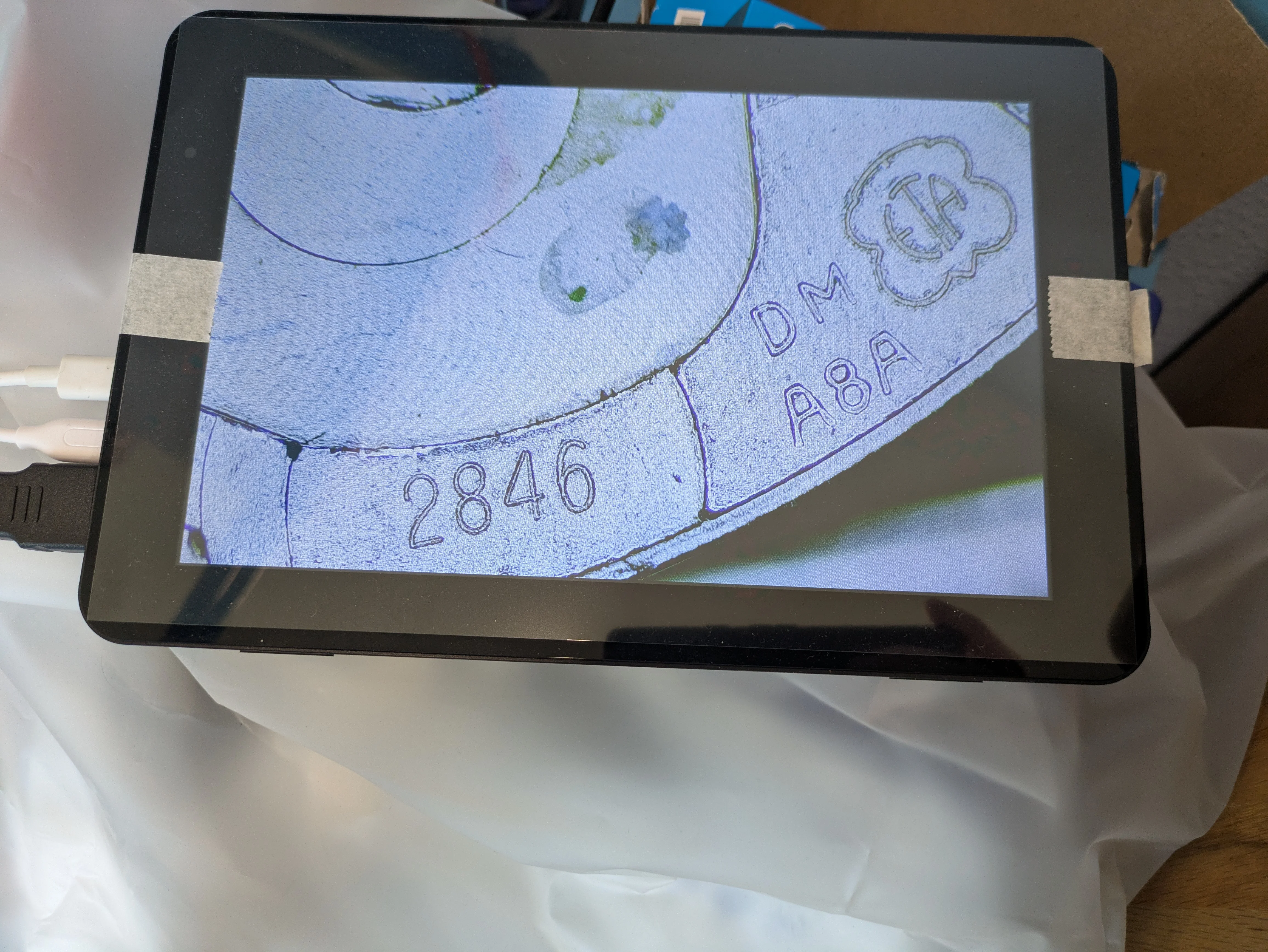

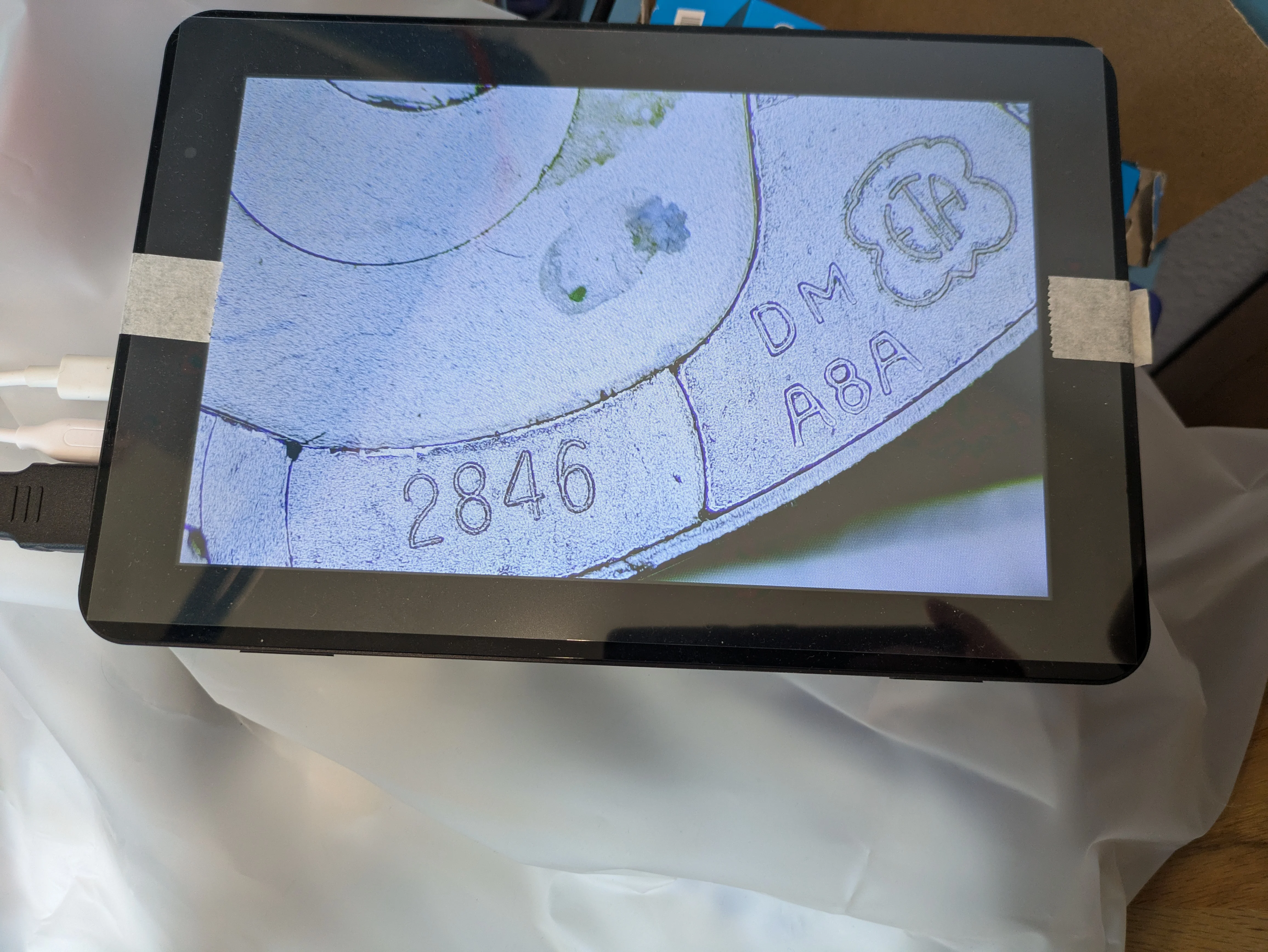

It's just bad photo resolution.
Standard ETA logo. All looks OK to me.
Hm... maybe? You're probably right, but that looks like a flat bottom/squared bottom in the picture 😀 Definitely could be a bad picture, plenty of 'count the pixels' in this post.

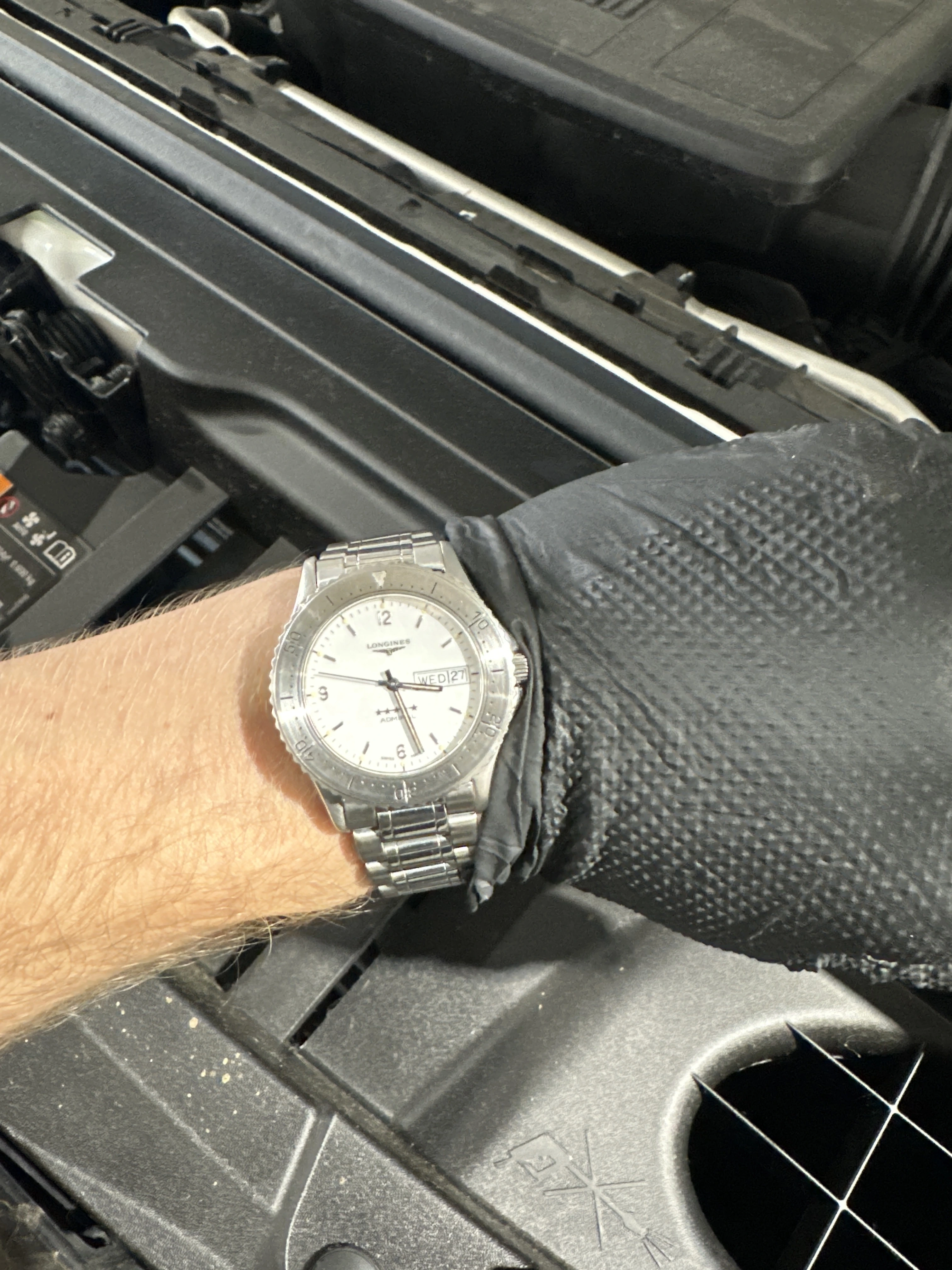

I’ll open it up later at home but I just wanted to put it on for right now
