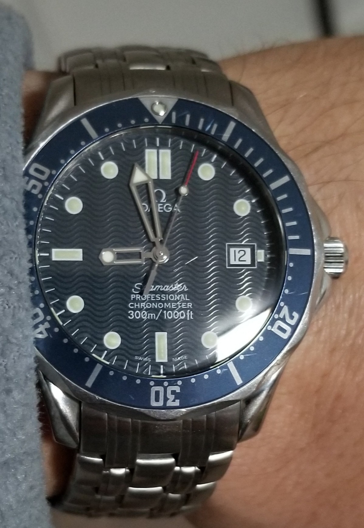

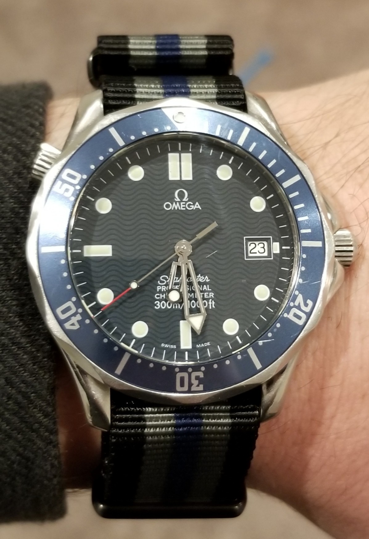

Hey guys, just wanted to share my recent success at removing scratches from my sapphire crystal that have been bugging me. I purchased this SMP used and it came with a couple mild scratches on the crystal right in the middle of the watch. You can make out the bigger one in the pics.

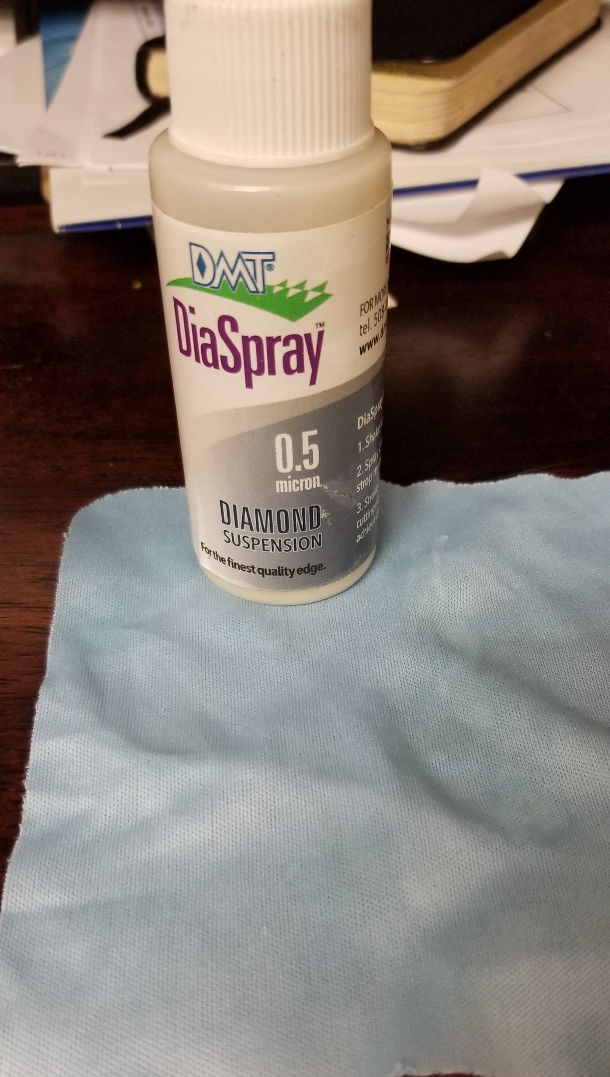

I didn't act on this for a while because I didn't realize that the 2531.80 only had AR coating on the inside, and I was worried about making my problem worse. I also didn't know if diamond would leave even more scratches. I have read of others using diamond paste, but I wanted to try this .5 micron diamond spray that I use for stropping high end knives.

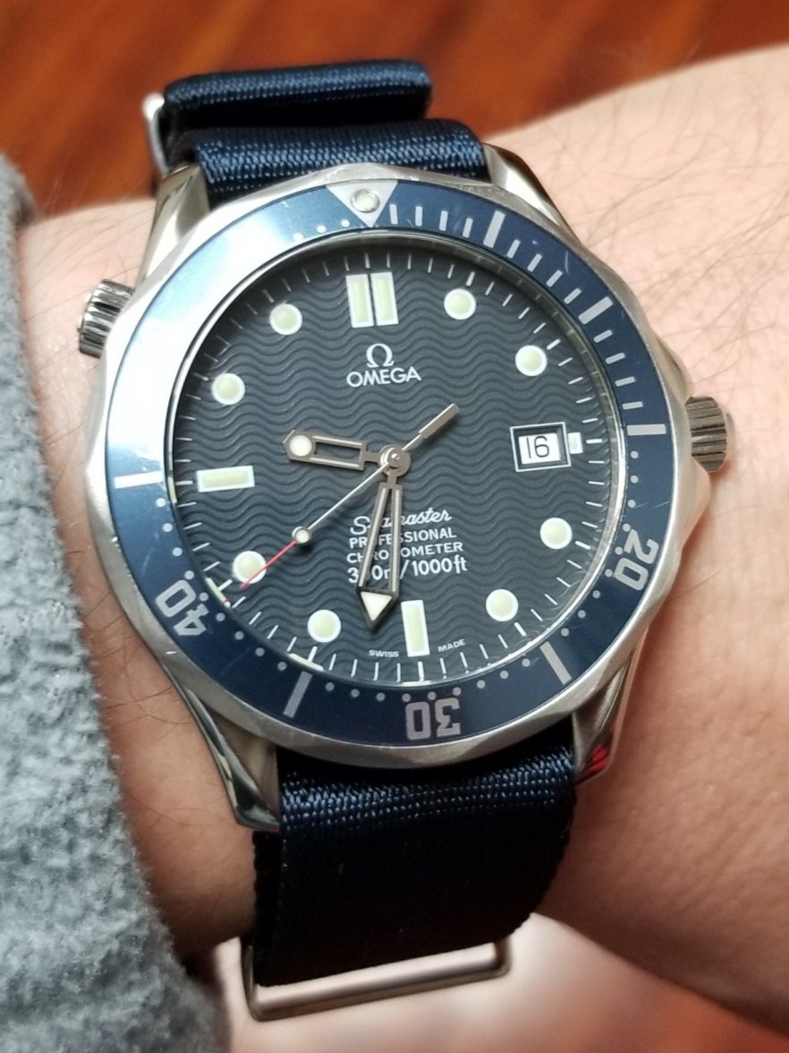

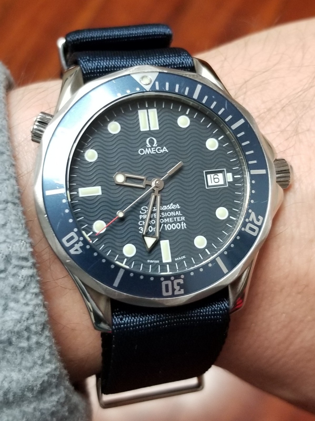

I almost went straight to the dremel, but decided to try the coarse cloth that came with my acrylic Polywatch first with a dab of the spray. It took about ten minutes of elbow grease, but my scratches are gone and I couldn't be happier. The crystal looks brand new! I am also loving my new navy blue nato strap from Phenomenato.
