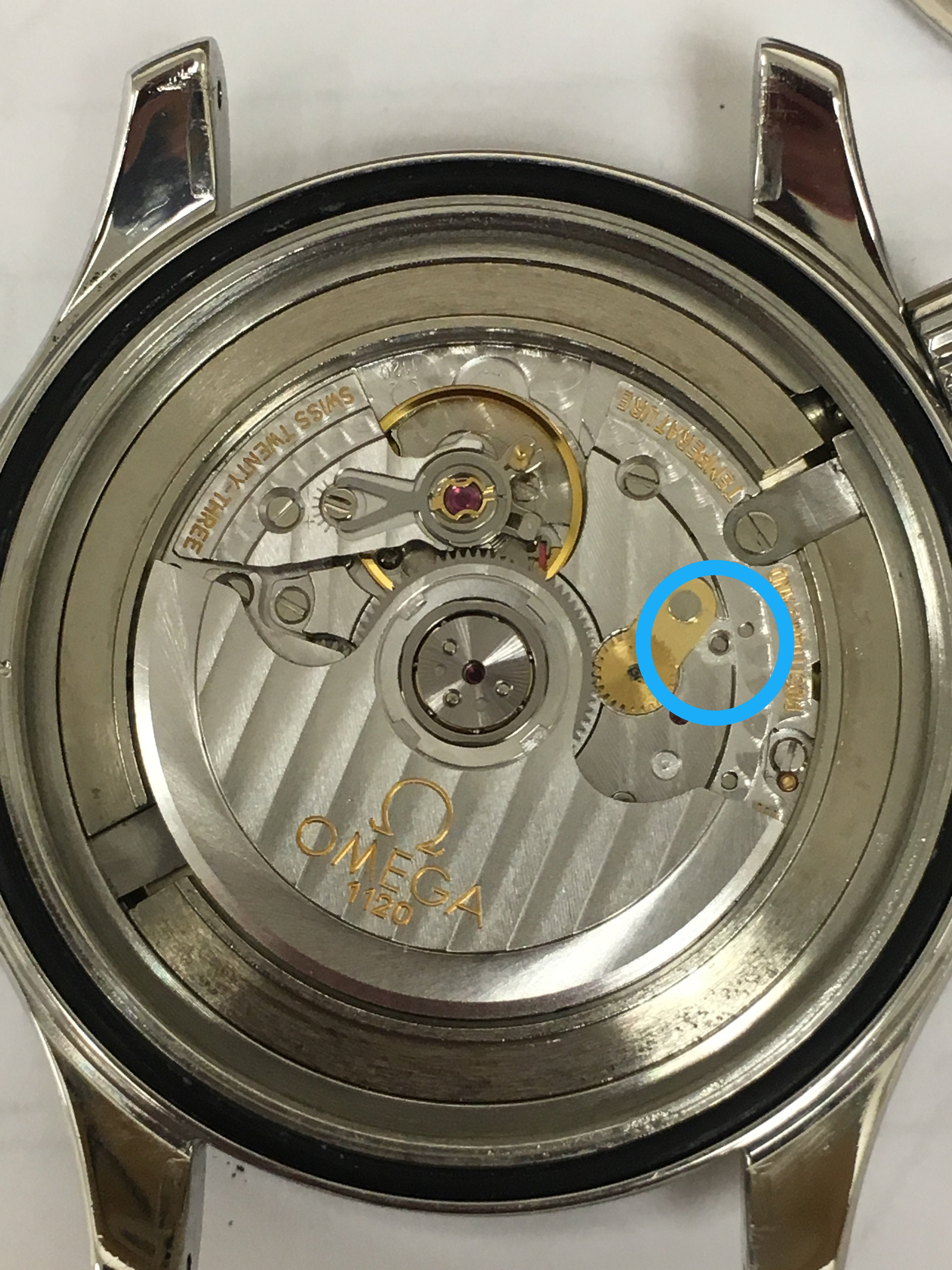

Did someone grind off a screw head ? At 3?
No, it's fine.
I'm also blind I see no serial removed.
The serial number has been removed from the lugs. You can't see the one on the movement in this photo, as it's on the barrel bridge and is being covered by the rotor when the photo was taken.
For the OP's benefit I would want to make sure the serial number is still on that bridge. Note that in later versions of the movement they moved the location to the balance cock, because that rarely needs replacing, where the barrel bridge can get damaged and require replacement. Replacing a serialized bridge is not more expensive, but takes a lot longer.
