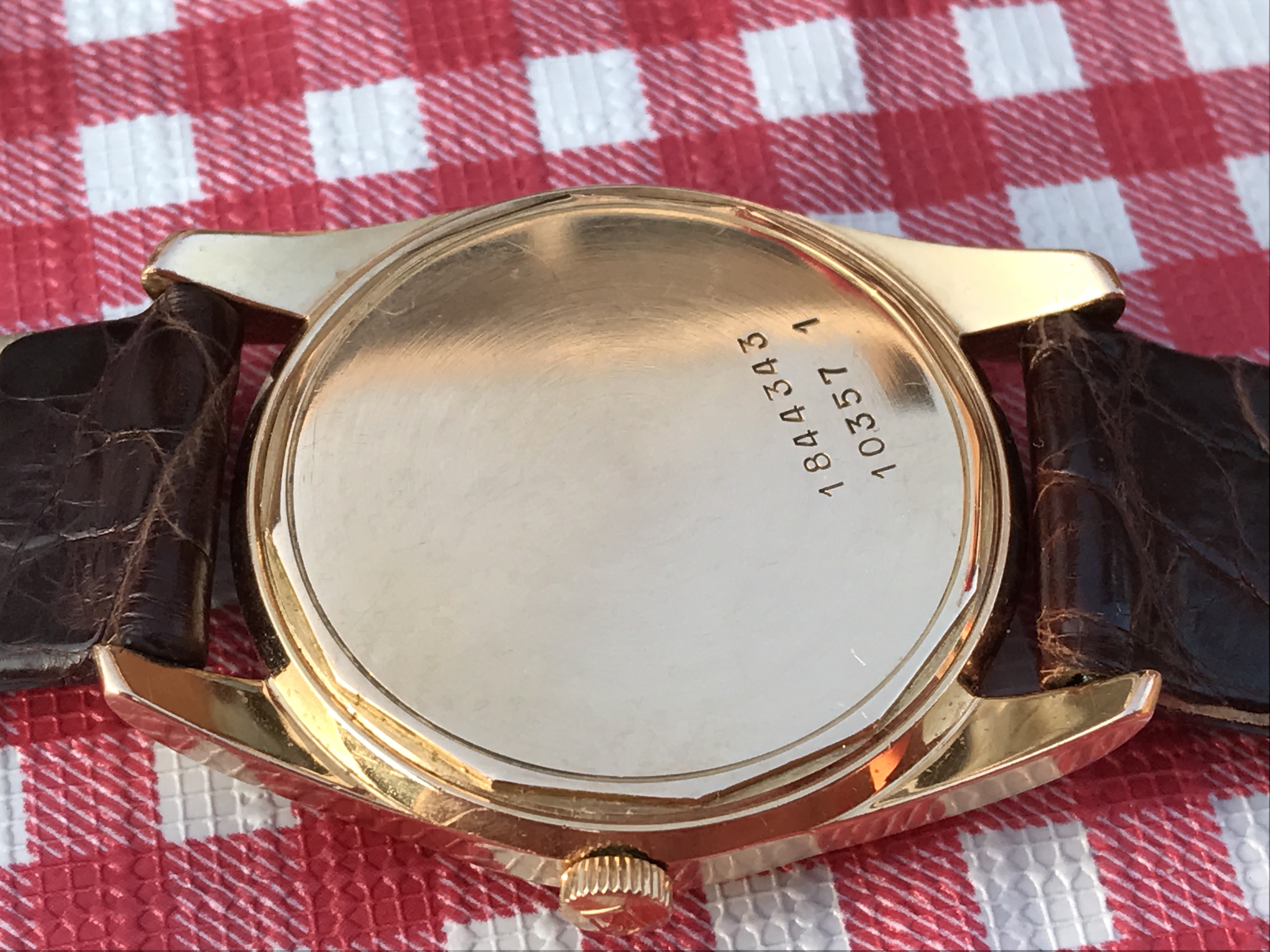

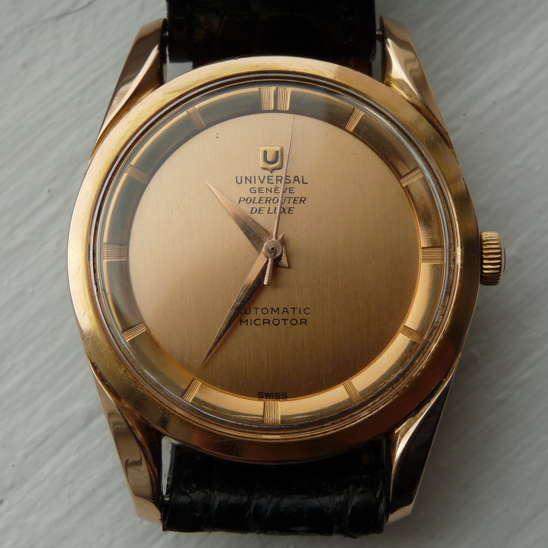

2 questions on the 10357-1:
1) Is this a low 1844xxx serial with patented rights pending 215?
2) Is the gold hallmark on the case between the lugs or under the lower right lug?
1,775
7,719
1) Yes and yes
2) Between the lugs

Awesome. In that case, this one should have a horizontal gold hallmark between the top lugs.
There seems to be at least 3 hallmark location/position changes through the 10357 serial range. 馃摉

I can check it this evening.

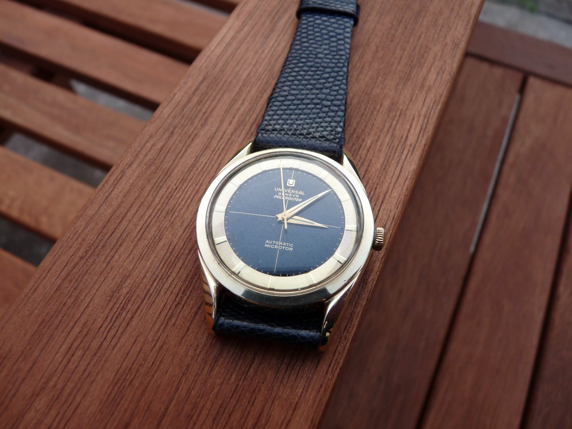

Is mine an early rendition?
407
1,068
Yes, definitely. The earliest serial I've seen for a 10357 1 is 1844268, and yours is not far after it.
The earliest production examples (1956-7) had only "Microtor" on the dial and "patented rights pending" stamped on the movement plate around the rotor.
This was whilst they were producing Microtor mechanisms and had applied for the Swiss Patent to protect it, but were waiting for it to be granted (hence they didn't have a patent number yet). It was granted officially as Patent nr. 329805 on 15th May 1958.
https://universalgenevepolerouter.com/patents/patent-329805-swiss/
Some time around here they switched to "Automatic Microtor" on the dial, and not long after, the 215 movement plates with patented rights pending were replaced with ones stating the swiss patent number instead.
(There is a crossover with the movements, I guess they had an excess of patented rights pending movement plates to use up before switching to the new ones..?)
The same pattern above applies to 20357 (steel version of yours) and 20360 (big case version).

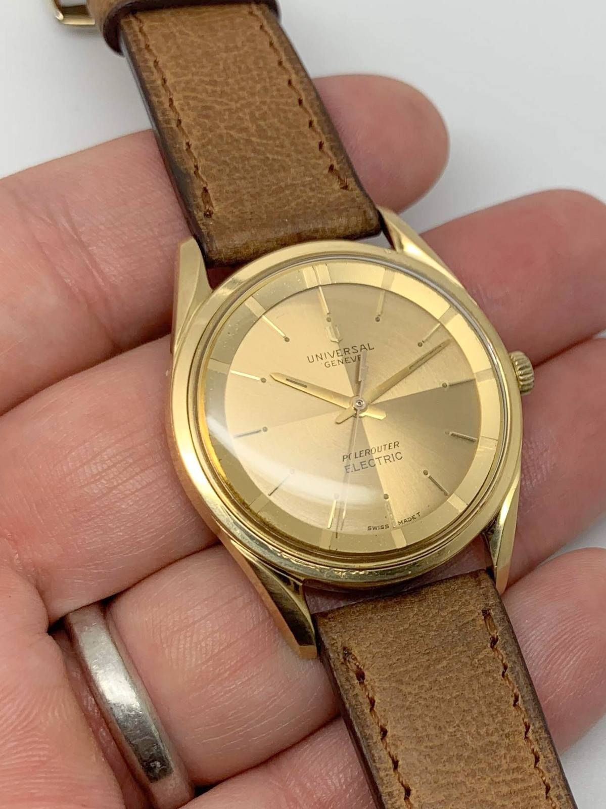

Gold electric 119301-1

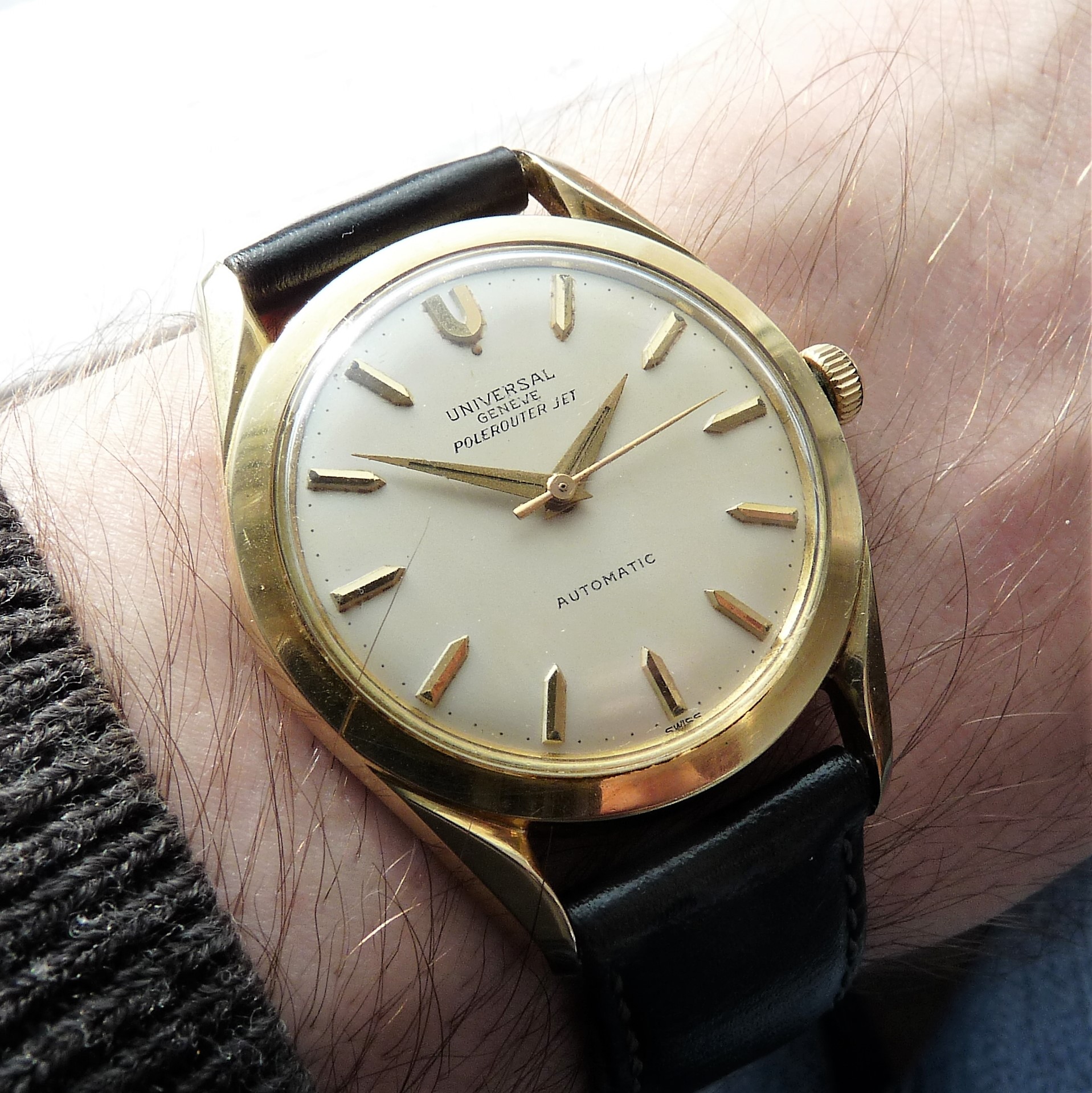

A 20361 'Big U' Jet that used to belong to @Jonatan until I could resist no longer

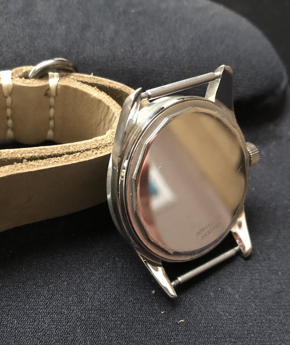

860100-01
860100 - 01

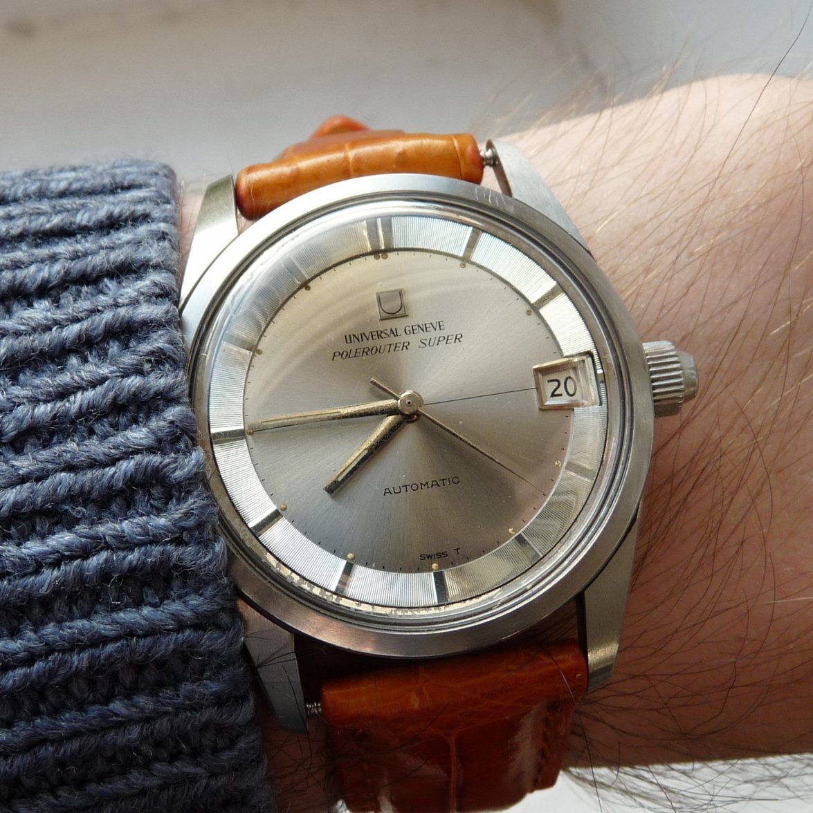

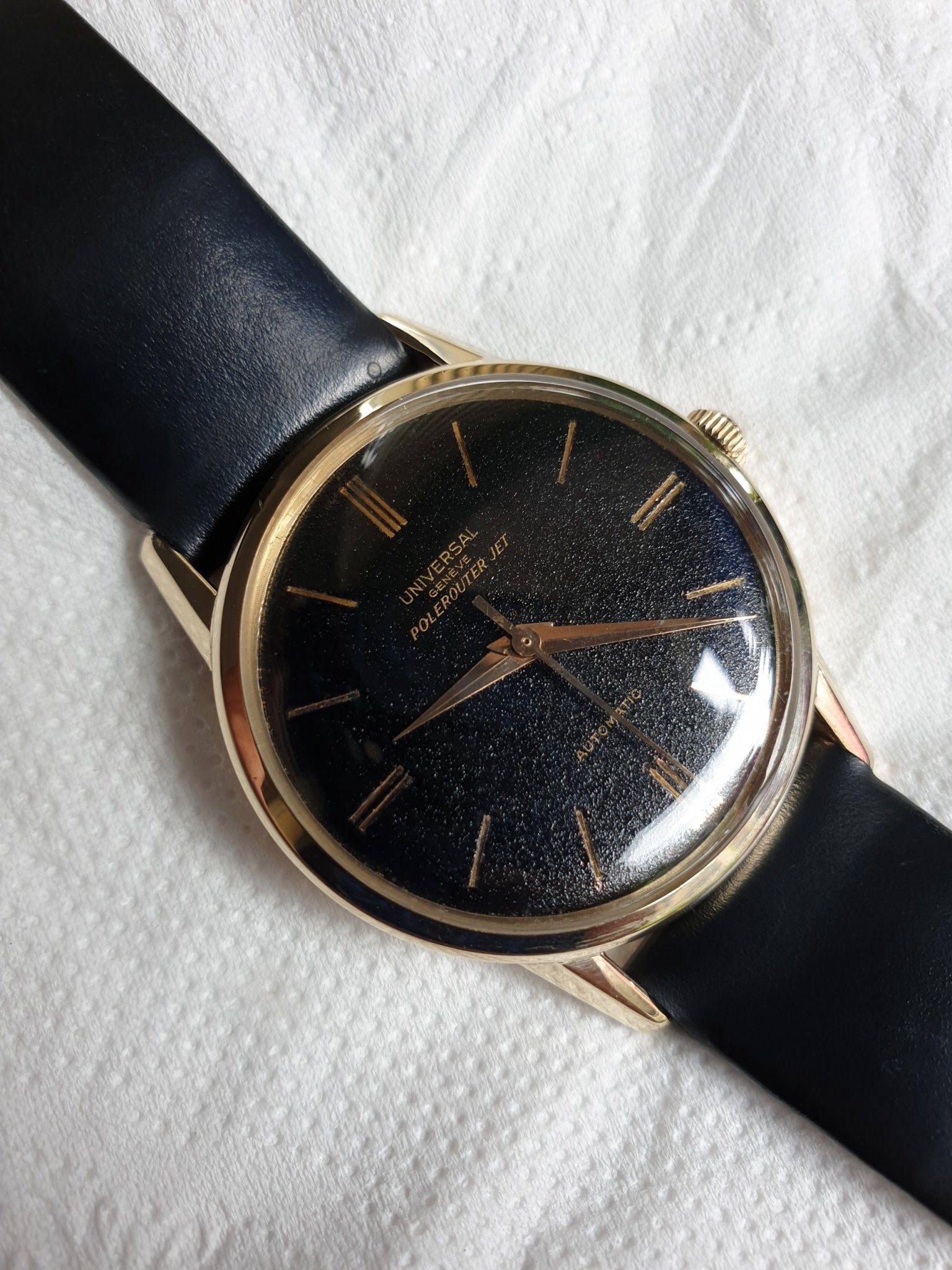

My latest aquisition, an 869112-03 Super on a too narrow strap!

Also yours is the only gold electric I've ever seen. Very cool.
