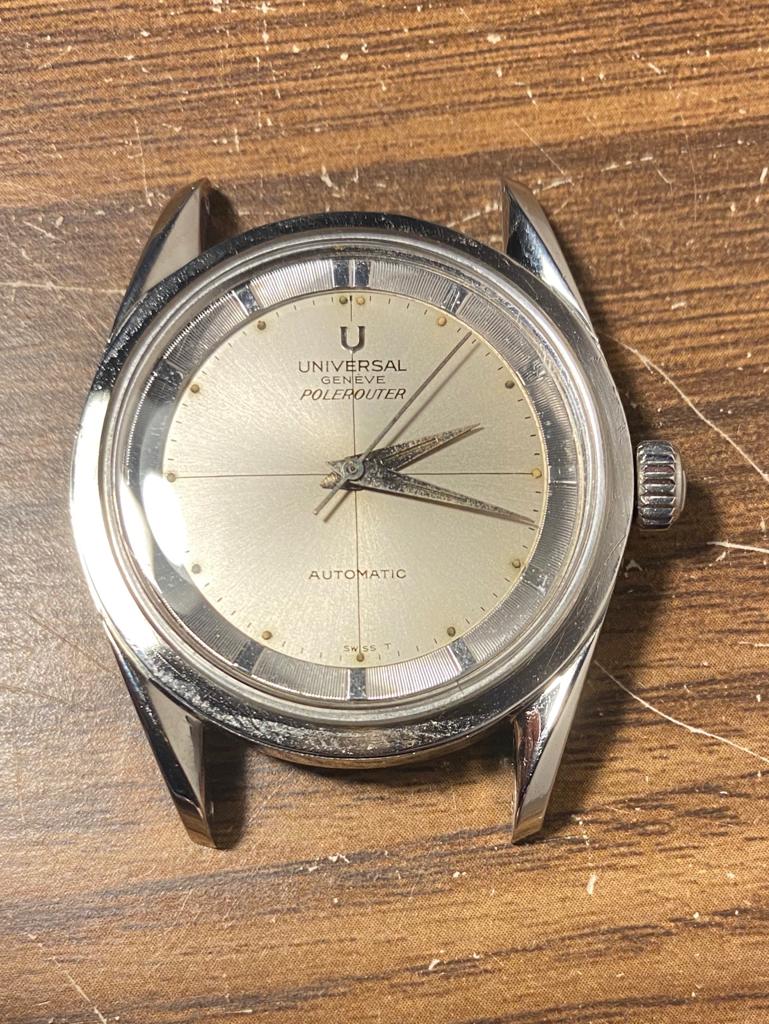

I have just received the above mentioned watch pictured here. You may have seen it before as it was sold in sweeden a year or so ago (https://antika.no/produkt/polerouter/) and I brought it from the person who brought it from them. Im happy with the dial and the case but the movement is the only thing that needs repairing. Full disclosure I brought the watch knowing it had issues with the movement and the seller was completly honest with me.

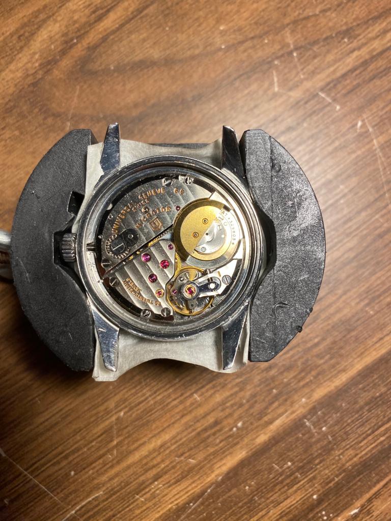

I just have a quick question about the microtor. The microtor is not working correclty and is making a grinding sound. I initilay thought this may be on the case back from seeing other posts but from opening the watch the micrortor is not turning correctly at all. I have tried to attach a video but cant seem to do it. The microtor pretty much does not turn when I angle the watch around and only moves slighty. It is not stuck in one posistion it is just seems to be resting on the plate behind it. It seems to move slighlty better when I hold the watch face up. I am obviously going to be sending it away for service but was wondering if it would be wise to source a replacment microtor before doing this or wether there is anyway it could be repaired. I have read on here before about replacing microtors I belive and correct me if I am wrong but is it possible to swap out older microters and put them in the later movements if they would be easier to source?

Hi all, I have spoken to a watchmaker and they have said it sounds like it will need a a replacement rotor bearing. They have said they will repair the watch if I am able to source one myself. Does anyone know somewhere or someone who has a Cal 68 rotor bearing available? Or alternatively a watchmaker who has one in stock and can repair the watch in the UK? Thanks
