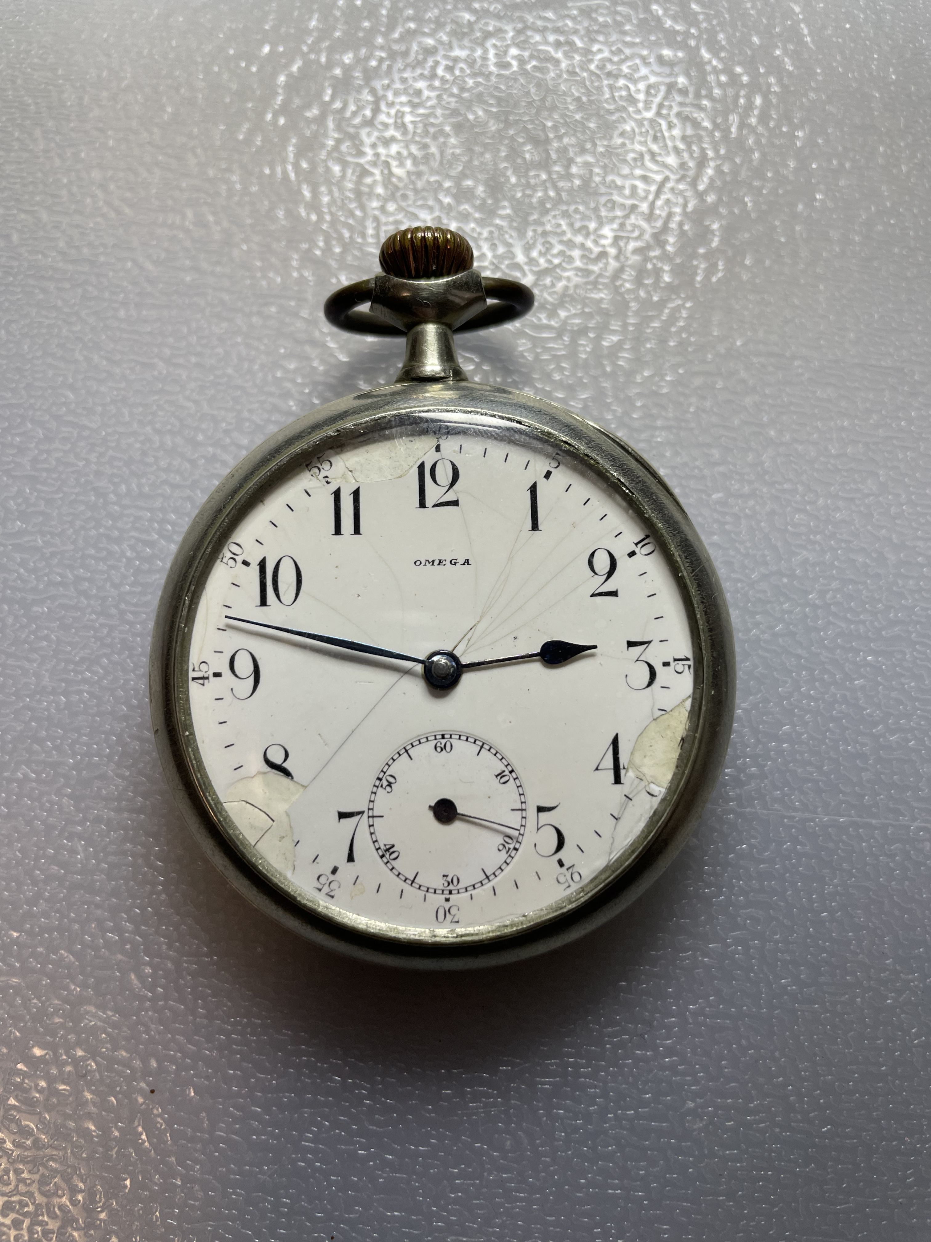

I inherited this pocket watch who belonged to my grandpa who left Switzerland in 1912-14 (in case it helps narrow down the movement's number).
I'm trying to find what movement model this is in order to buy original replacement parts for the ones that are broken as seen in some of the pictures. I really want to bring it back to working order so that I can wear it.
Thank you to anyone who reads this and specially to anyone who can provide some info on the movement model number and maybe even a trustworthy place to source parts from馃榾

Looks like either 18 Ligne, or 19 Ligne. Don鈥檛 look for any other calibre number. The 18 or 19 refers to the diameter in lignes. Parts? No source I know of, apart from finding a donor watch of the same model. It is, after all, about 100 years old. Case looks like nickel silver (no silver content). Dial? Rough! From the amount of work that likely will be required, the cost to do the repairs might give you the expectation that it can be made into a virtually new watch! Not a chance! Not a lot of watchmakers would take on the challenge.

I know there must be great sentiment in the Omega. I suggest you don鈥檛 move Heaven and earth looking for a donor watch! I doubt very much you鈥檒l find one in worse shape to cannibalize, than the one you have. I suggest that you try to find an equivalent Omega in much better shape than the one you have, and fix that one instead. Keep this one the way it is. Find a better one, it will require less work, at less expense, with a better result. And it won鈥檛 be so tough to find someone to work on it! This is not a scarce watch, so they are available.
If you find something that you think you might like, get back to us with pictures and details, and maybe we can help.

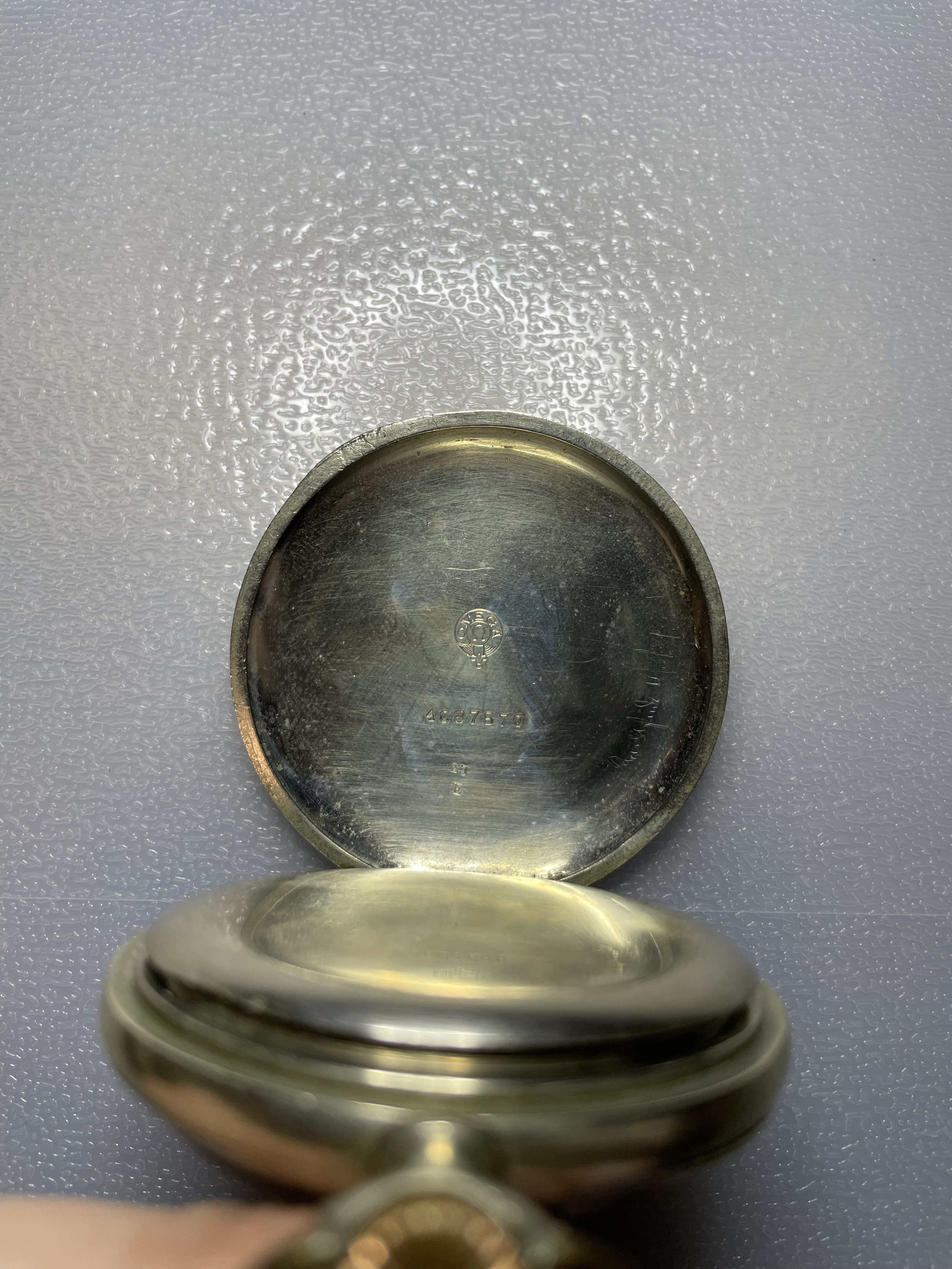

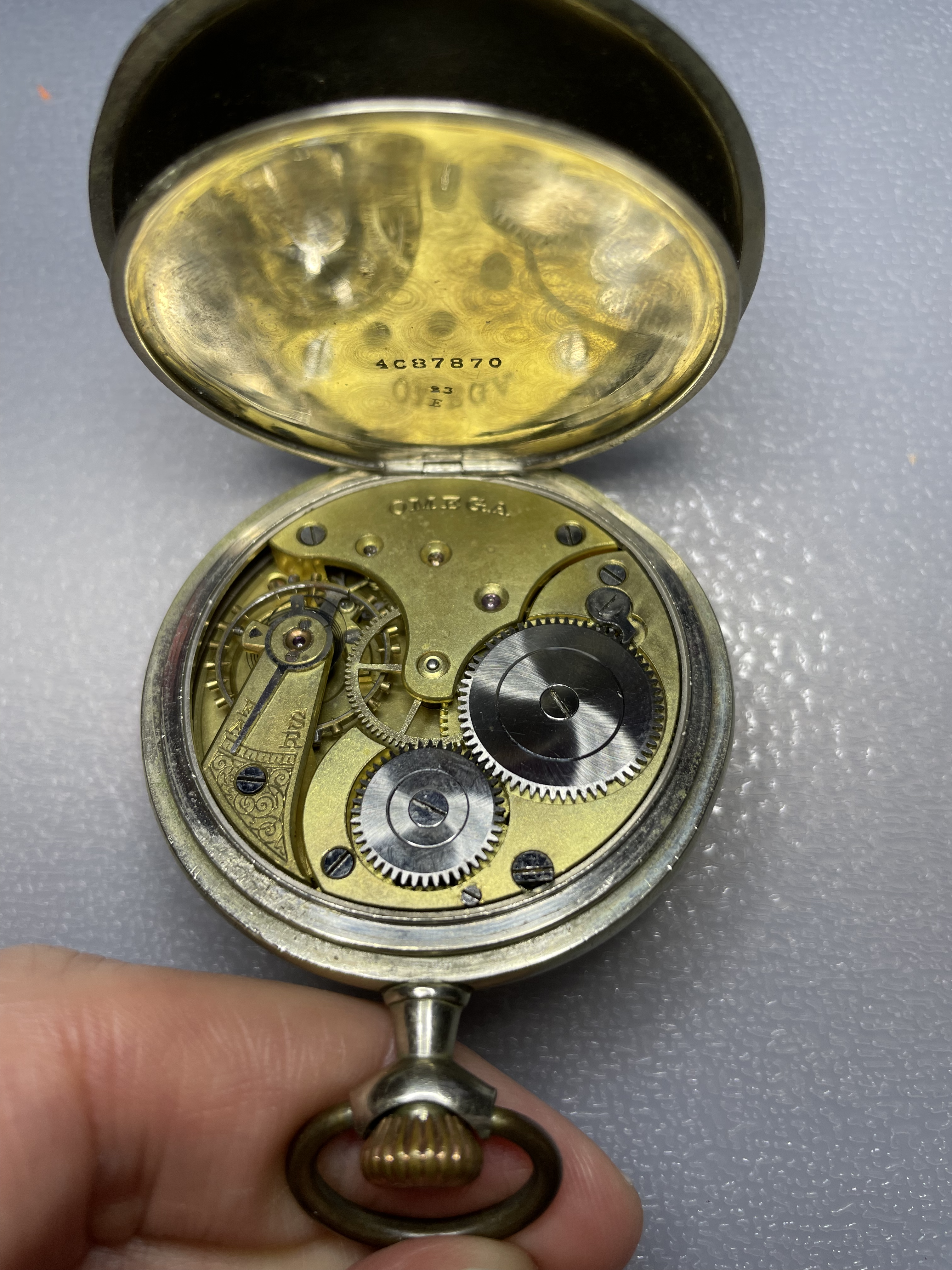

Sidenote here, is it normal that the serial number in the case reads 4CE37870 ? I mean, with some imagination I can think of it as 4087870 (which seems to put this watch at the 1910-15 year-made range, but it looks strange they'd use different fonts for the 8 and the 0. The same font discrepancy seems to appear in the inside of the outer lid/cover..

Before you start buying things, you MUST determine exactly what caliber your watch has. Although they all look the same, there are many differences and not all parts fit all calibers (talking of Omega 18'''/19''' from that era).
To determine the caliber, you need to measure the diameter of the movement out of the case. There are three steps on the case, you measure the one just below the dial plate to get the caliber.
Regarding the numbers. The case maker (most likely not Omega) has used either an internal numbering system, or the marker has lost or damaged the correct punches and used whatever they had on their bench. It doesn't really matter, it's the case that came with the watch so that's it.

I removed the movement and measured it to 43mm (I did all of this just before reading your message), and since I was at that point already, I had a go at checking the parts that were KO in the watch and I found that the following need replacement:
Escape wheel: bent pivot
Ratchet wheel: missing teeth
Train Bridge jewelled: damaged jewels
Plateau: damaged jewel
Hairspring: warped
Barrel spring/main spring: broken
