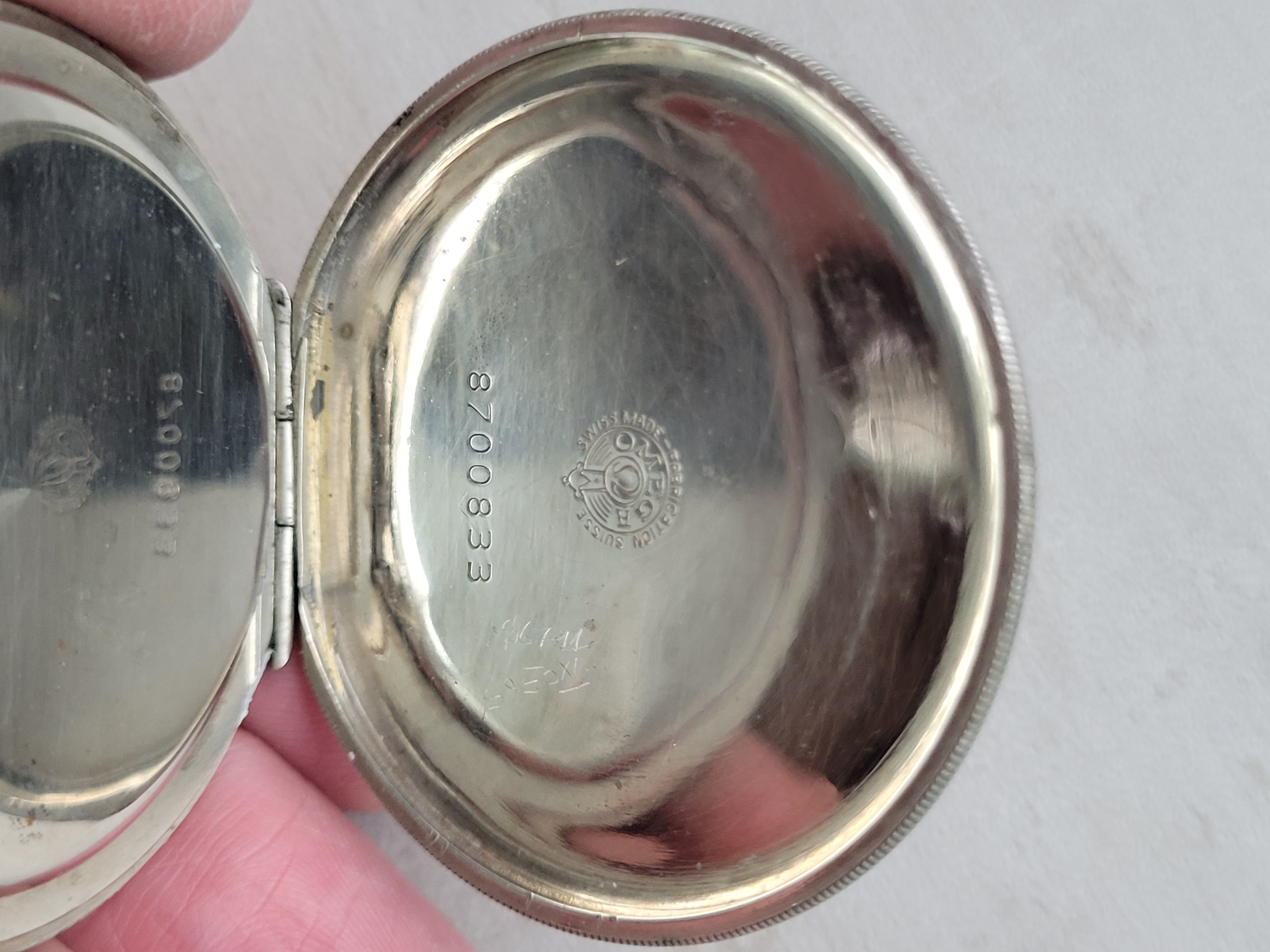

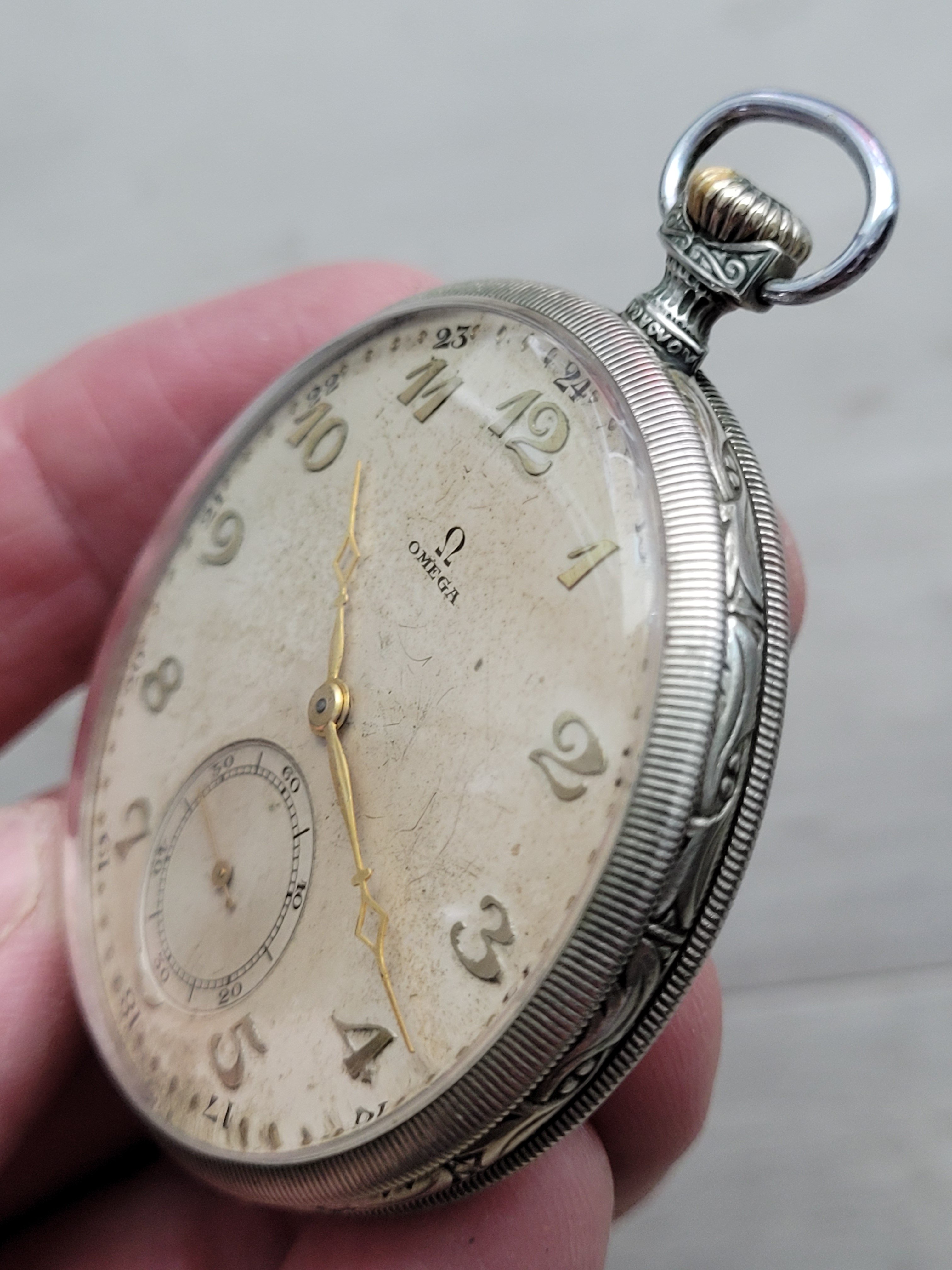

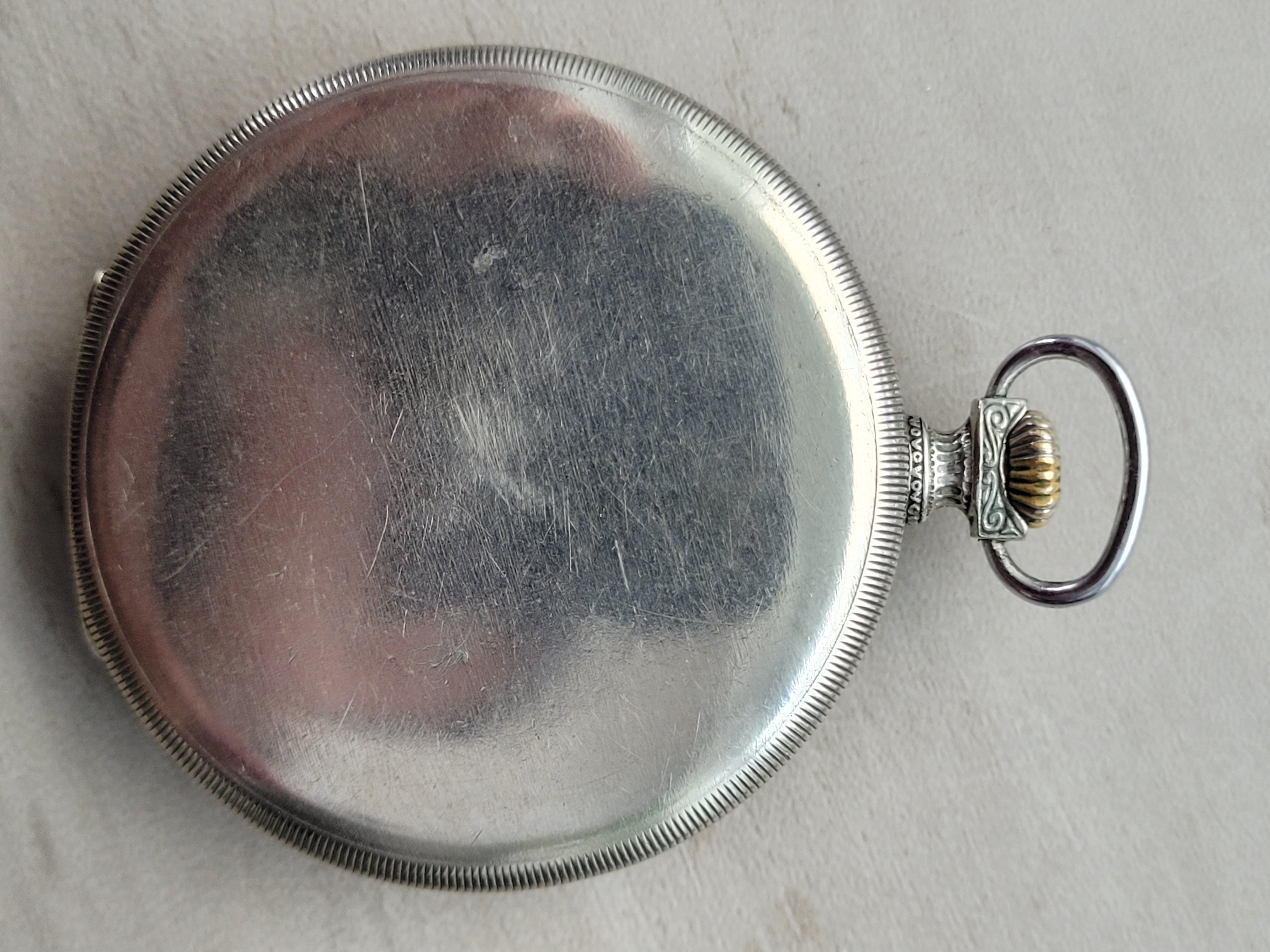

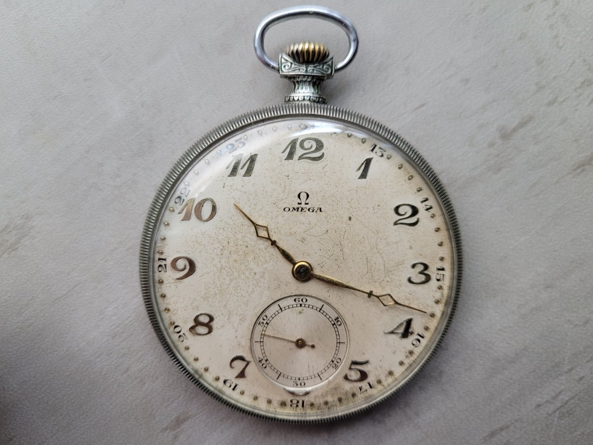

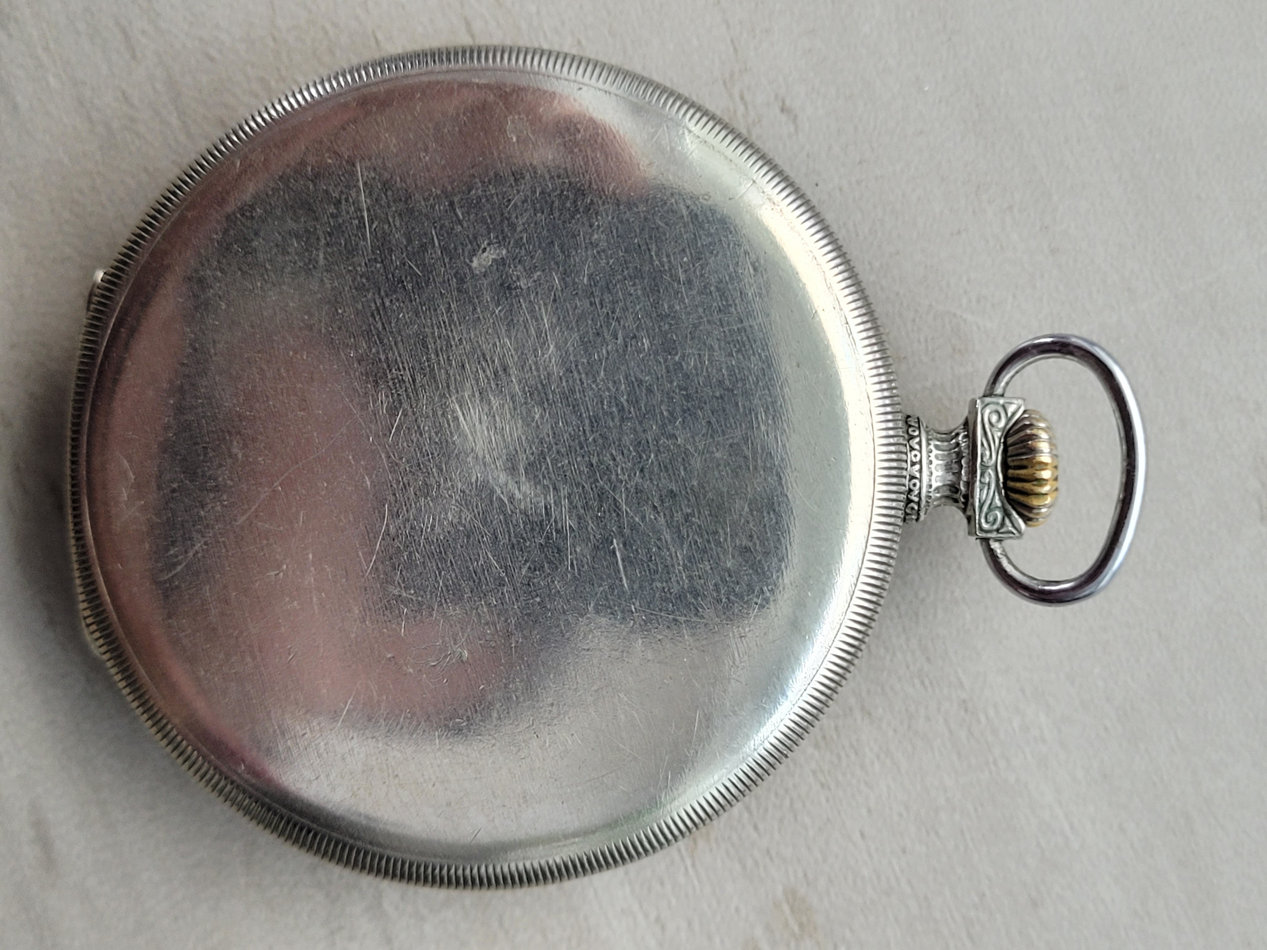

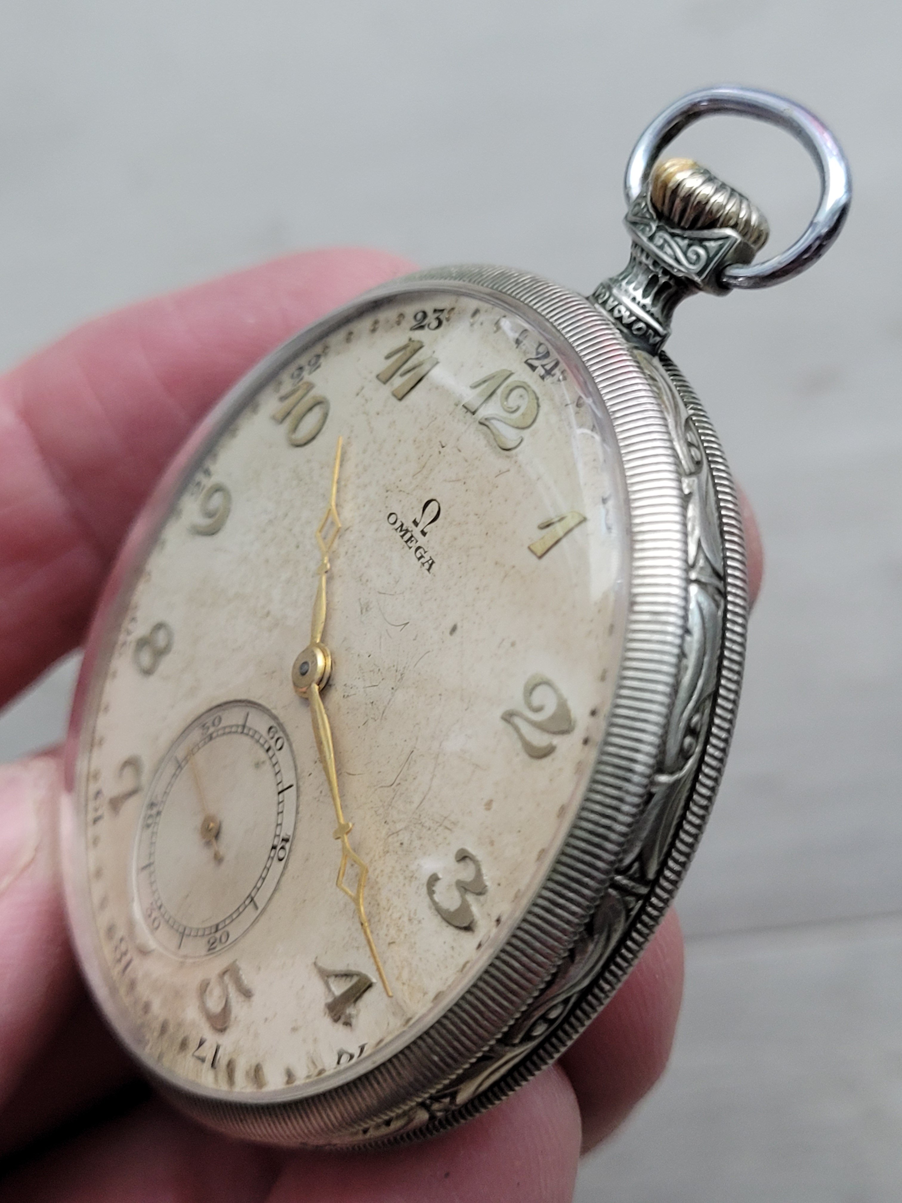

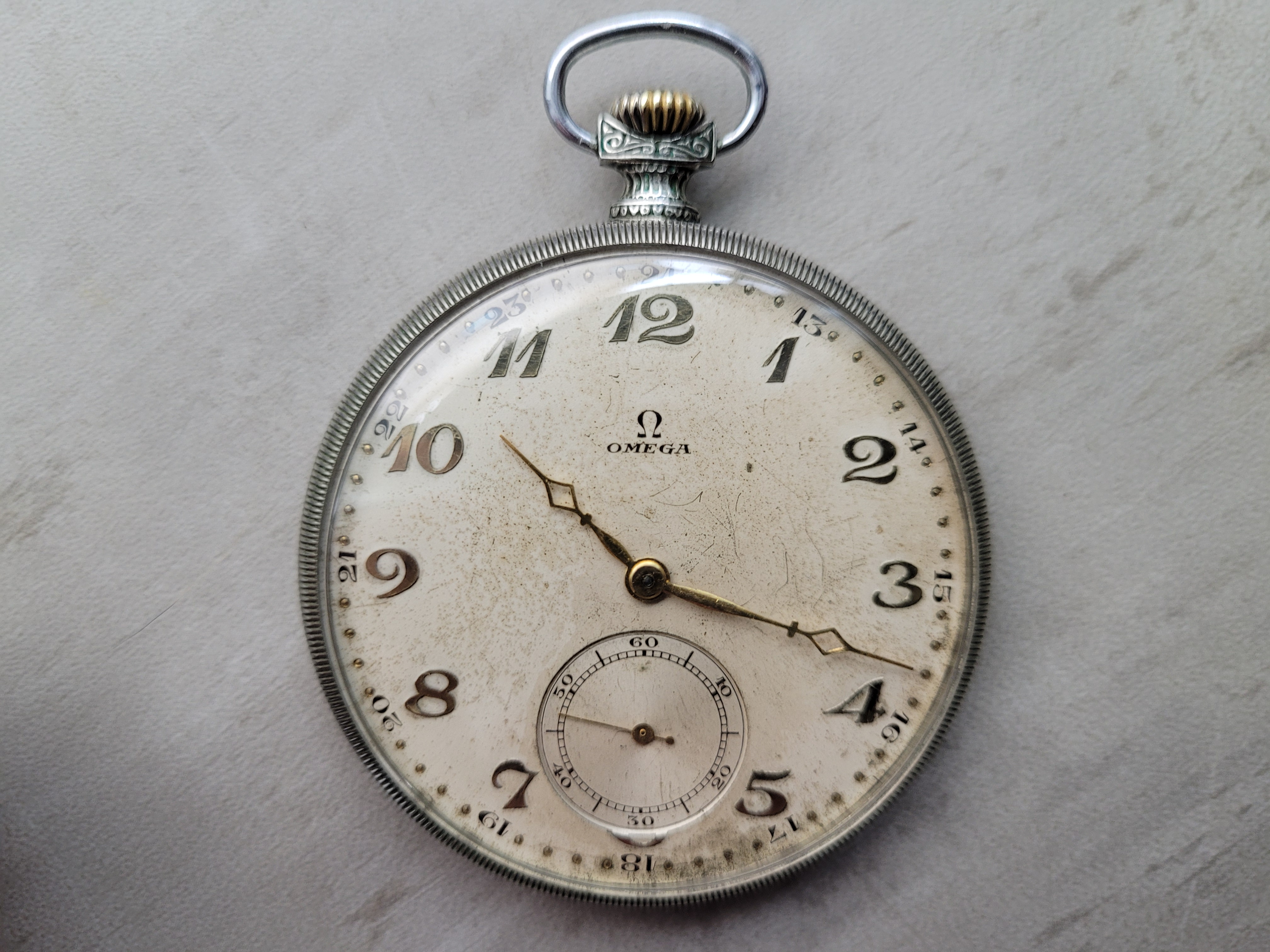

This is my first Omega. After a bit of searching, I stumbled on this one. My best guess is mid 30s era. Not perfect by any means sporting some wear. I do enjoy a bit of patina but it is the case in particular that drew my attention. It is different than most of the "smooth" cases I was seeing. Not sure of its authenticity as I have not run across another like it.
With all that said, I'm seeking any info on authenticity. My plan is to service the movement, maybe a slight polish on the case and enjoy it as is.

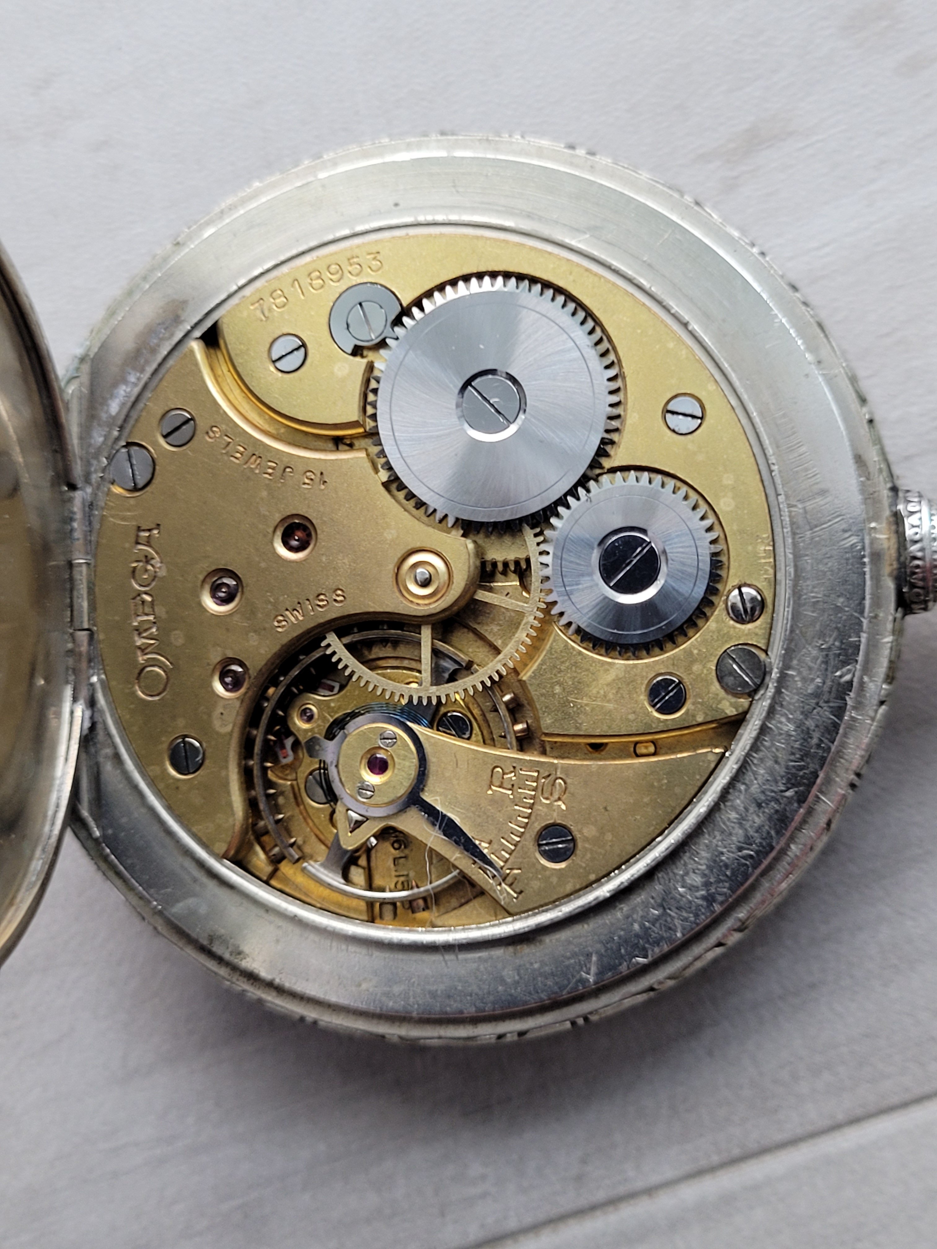

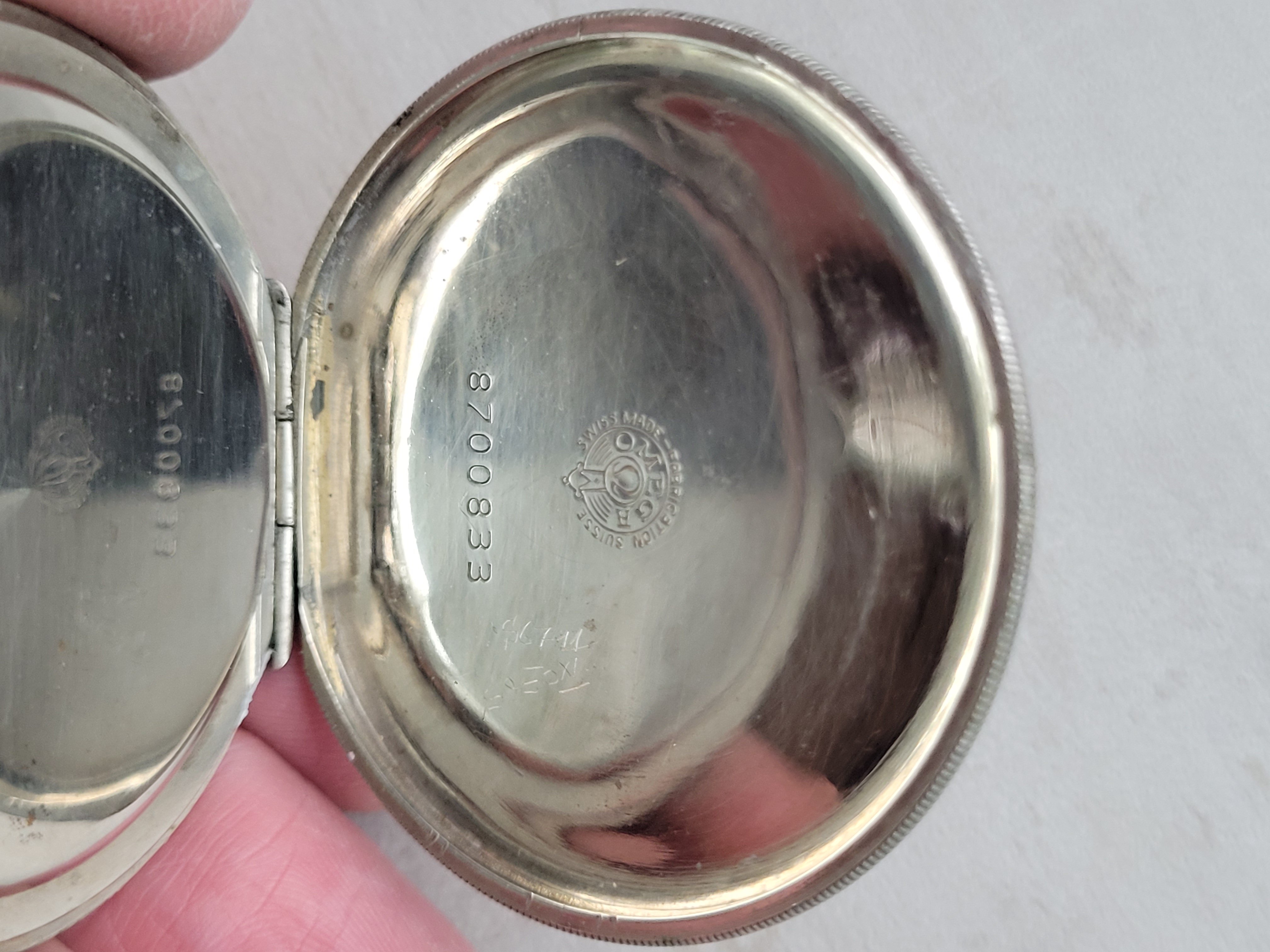

The serial number list I referred to indicates circa 1933-34. The case is base metal alloy, possibly nickel silver. In my opinion, it is original to the watch. The case shows what I would call Art Deco influences, but there may be other opinions on that. The mechanism is standard Omega, possibly a #17, or # 18. Depending on the diameter of the movement. I have heard the style of hands called cathedral, and they appear to be original to the watch. The movement appears to have 15-jewels, a bi-metallic (temperature compensating) balance wheel, and blued steel Breguet (over coil) hairspring. The dial is metal, and it appears to me to have been anodized. It is typical of such dials to show patina. The movement is not high grade, but a good quality, average movement for the era.

Not much more to add than what @Canuck has said. The movement is a caliber 37.6 L15P which was introduced in 1928.
