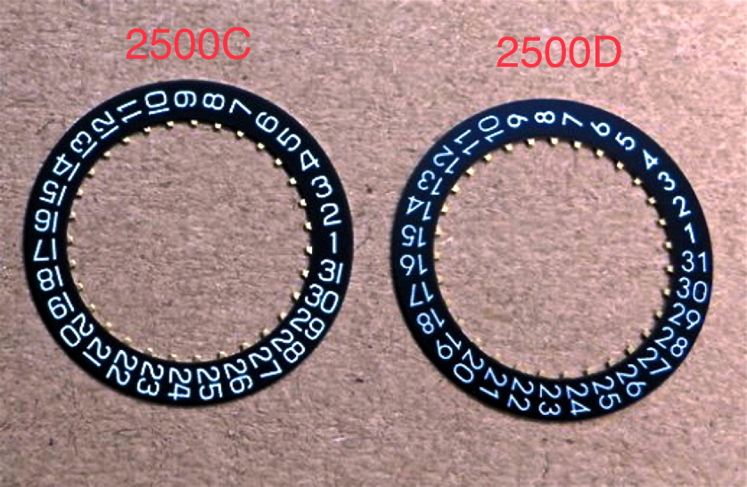

I heard the same thing with the general consensus of 852XXXXX being the D movements. You can also get a general idea by the date wheel, but they could in theory be swapped out. I have a 85285805 which has the D movement. The only 100% way to be sure is to look at the movement, there should be a 2500D marking on it.
Date wheel differences for those wondering.

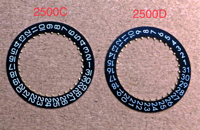

Great stuff! Thanks for that! I had heard that the "1" font on the date dial had the serif on the D and sans serif on the Cs - it's great to see a pic of the dial wheels side by side. 👍👍
