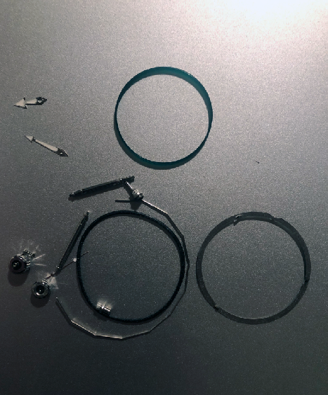

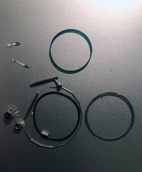

I did contact them after a few days with it, and they said, keep an eye on it and if there's a problem with it let us know and if you want to send back.... So as it was running OK, I didn't bother. But it's a niggle
30,289
78,178
These are all case parts. Was there another set of movement parts?
336
164
Hey Archer, absolutely nothing else, that's the whole of the contents I received after the full service.
