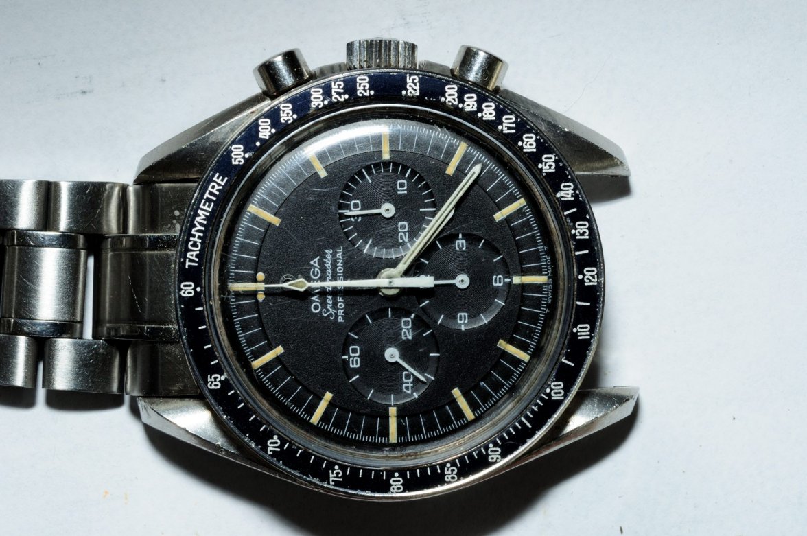

Hi there,
I have a chance to pick up a (what looks) decent Speedy.
could you throw your collective knowlege it those pics?
the good the bad and the ugly ;-)
speedy1_zpsjzvdsh5e.jpg~original
speedy1111111_zps2tim04r1.jpg~original
speedy111_zps8fjduyla.jpg~original
speedy1111_zpsj7ygxefj.jpg~original
speedy11111_zps94smzyn1.jpg~original
here a bit more information:
inside case reads: OMEGA WATCH CO. FAB.SUISSE,SWISS MADE, ACIER INOX, HF, 145022-71 ST
the serial number on the 861 caliber is: 31.000.xxx
how does the watch check out for you guys?
thx, I really *appreciate* your input here 👍
cheers, Al

I'm thinking you would recoup an awful lot of the purchase price if you sold the bezel and replaced it with a DNN bezel, which would be correct for the years the 71 was produced.

I would sell the watch and wear the bezel.

As above, everything looks correct for a 71, step dial, case back, serial, except the DoN bezel is from the 69 or earlier. Luckily the bezel is worth several times the cost of the correct one.

31.000.xxx I know are all -69 refs and produced end of 1970, thus unlikely to be a -71 version. But has to be checked.

Before any useful conclusions can be drawn, I think we need the case back reference, the first four serial digits, and sight of the movement.
This may well be a border example. I would agree that the DO90 bezel might be a later addition. Or it could be the case back was replaced, or it could just be an assembly.
It could be anything, especially since we dont know what is inside.
I suspect it is a nice watch and worth buying
