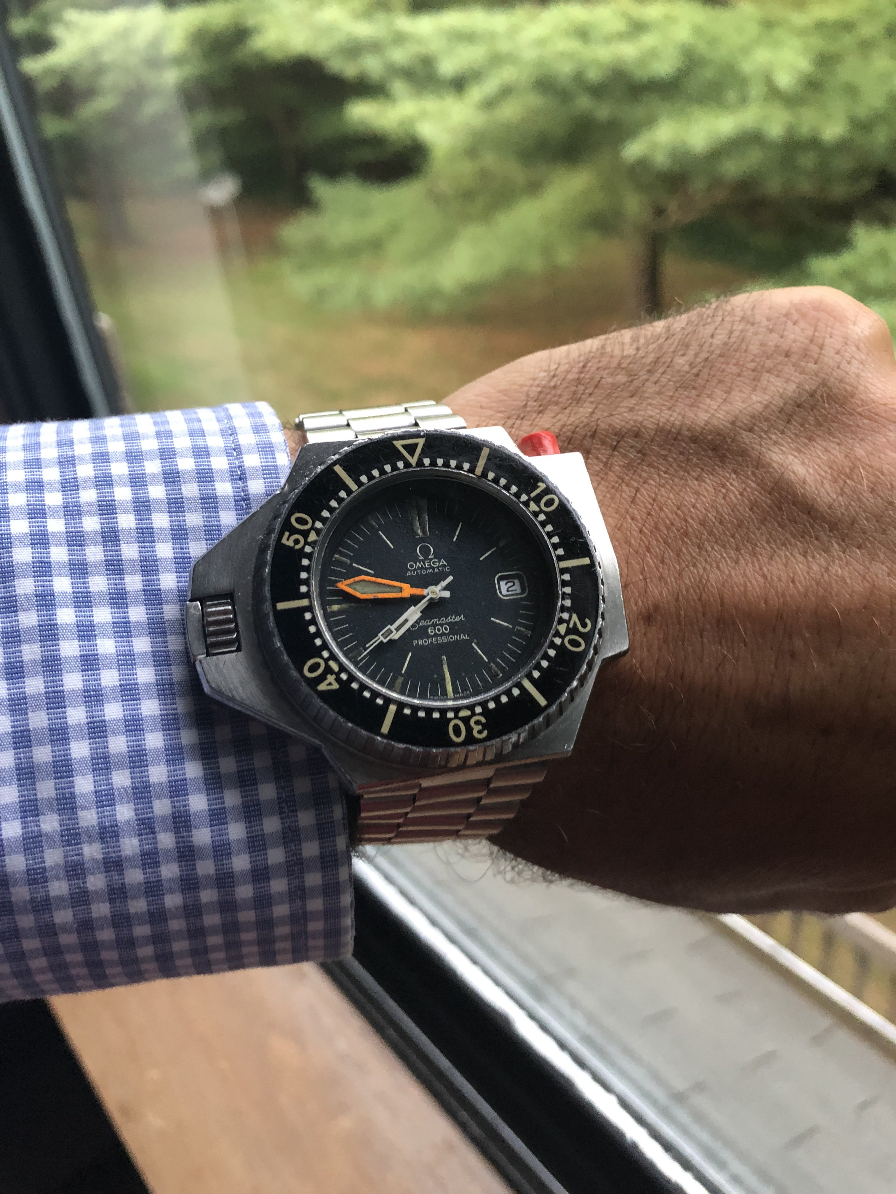

I had mine restored by @photo500
He did a service, and also converted from left to right. I bought a date wheel and sent that to him. He also rehabbed my case and painted my modern hands to match dial, which was not touched.

What a stunning watch Taddyangle!
I think I’m going to have it serviced now and leave it the way it is. Later, I will get a dial and hands in better shape to rejuvenate the watch and keep the originals in a safe place.

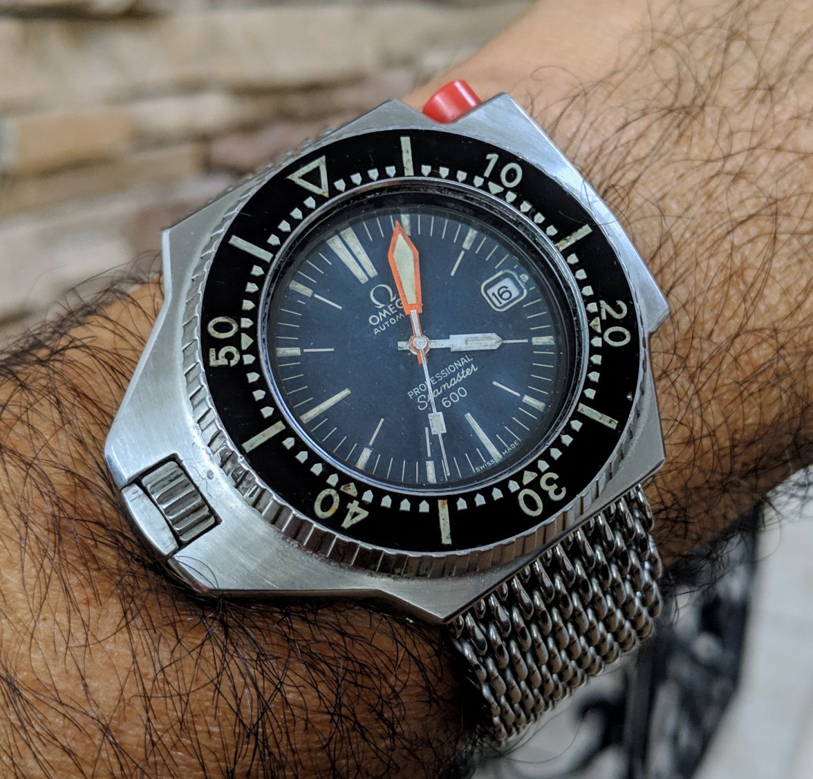

I am lefty, and as my dad I wear my watches on the right hand. BUT! The PloProf was designed with the bezel button at 1o’clock..this was is easily operated. When the button is on the 8o’clock position not so much. If mine ends up being a lefty from factory I will leave it this way, otherwise, despite me being lefty, I would have it reassemble the right way...

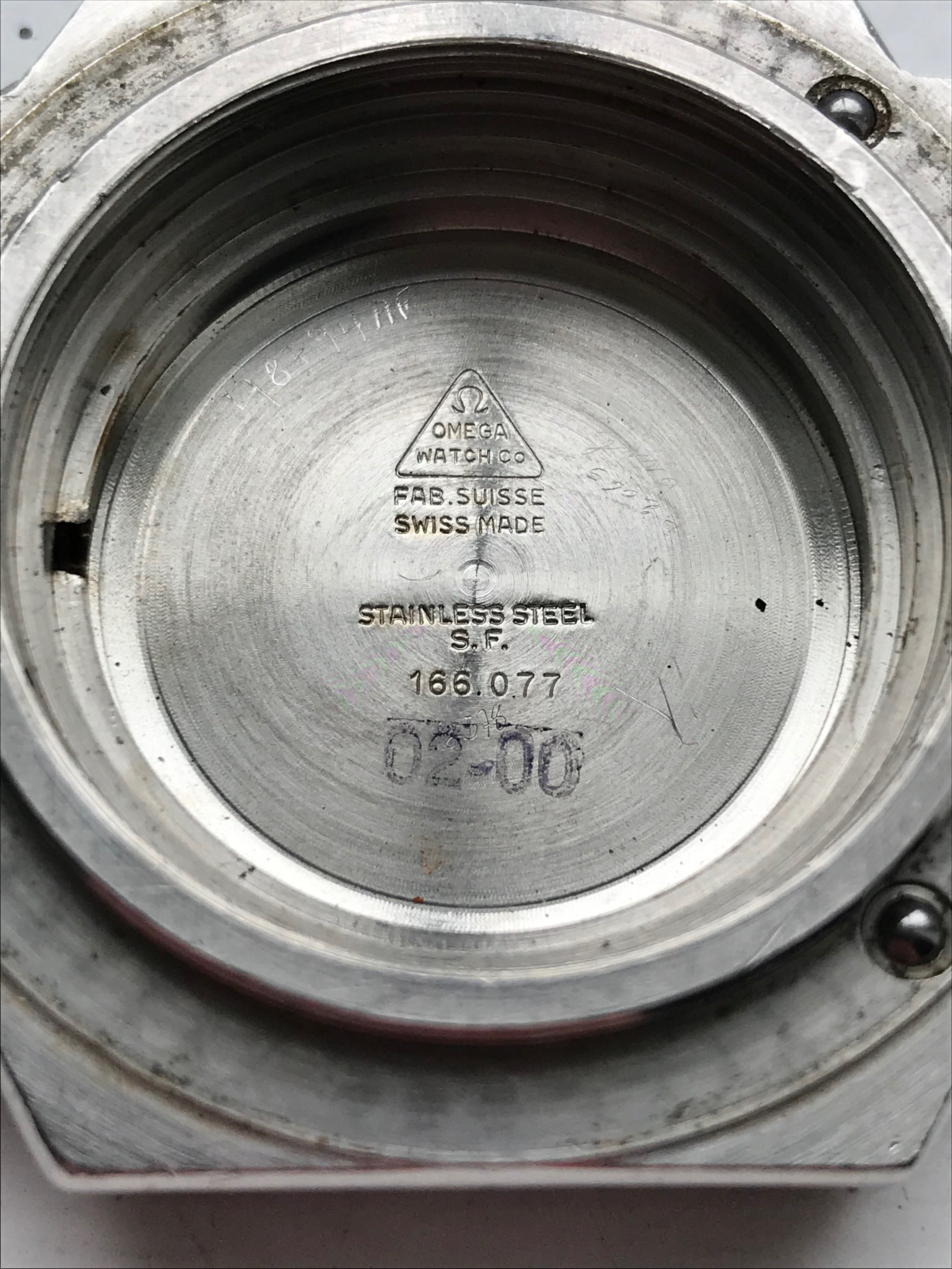

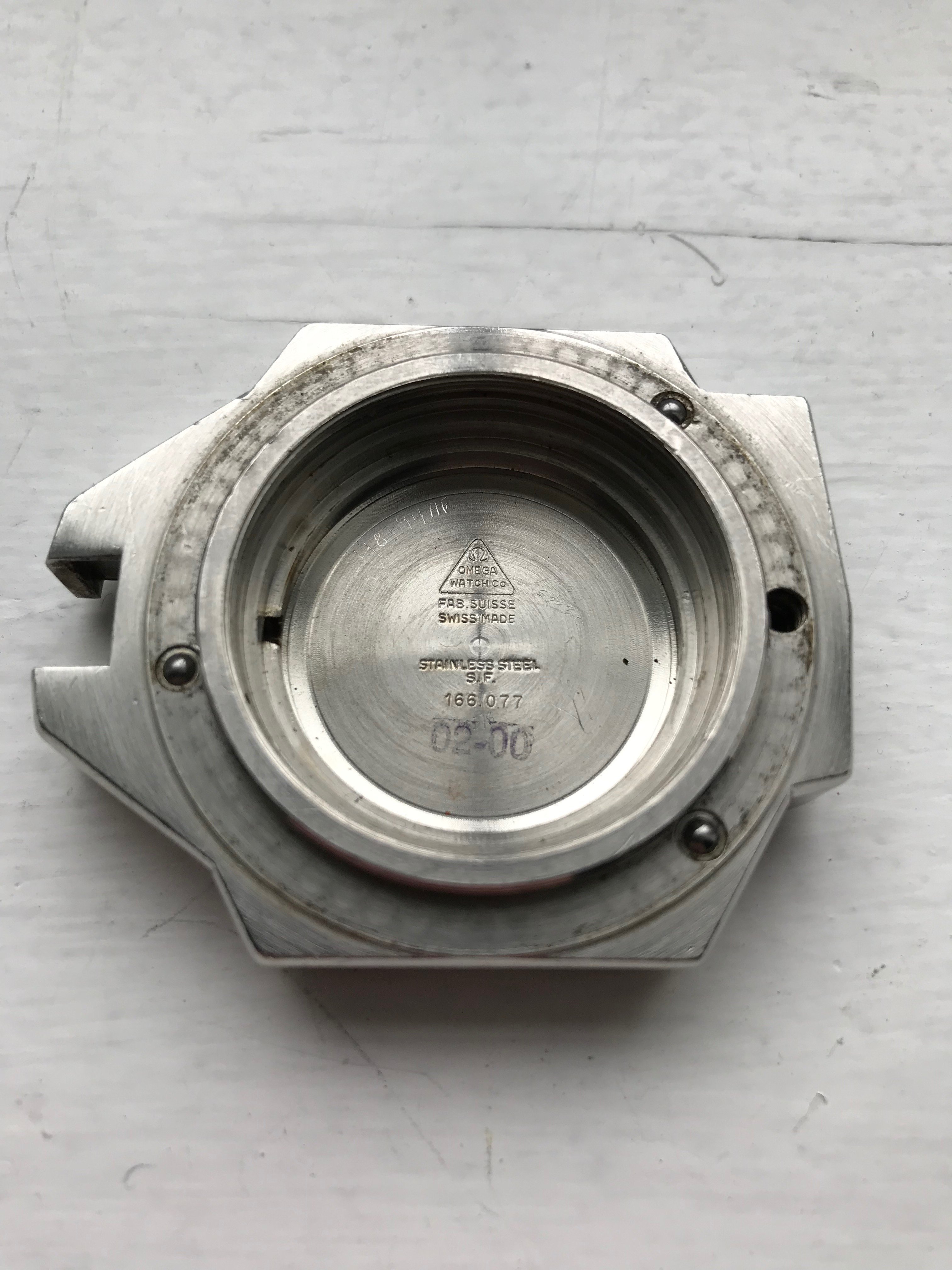

So I took the watch to this shop (Gehan & Doherty Watchmaking) and left it for an estimate on the work needed; they are 10 miles away from my job so it is very convenient. They called me yesterday with the good news that the mechanism is not totaled, it is in good shape and other than replacement o-rings, gaskets and spacers it should need not much more, perhaps the replacement of a couple of rusted bolts.
He told me that the case is the standard one, the crown should be located at the 9 o'clock position, so this is not an "Inverse" Ploprof. But what surprised me the most is that it has a Calibre 1001 instead of a 1002.
He told me he took a few pictures, I will post them as soon as I get them.

Chris I've also read that back in the day the swap from a 1002 to a 1001 during services was not uncommon. Perhaps this is what happened. The calibre 1001 is a Chronograph and 1002 is a non-chronograph. Newby assumption here: I assume that watchmaker would be able to tell the difference and tell me whether this is actually a chronograph (cal. 1001) or it is in fact a 1002 with the auto bridge of a 1001?
I forgot to mention something what I consider as a little bit of a bad news. He mentioned that the piece where the serial # is engraved was replaced at some point and that the replacement doe not have a serial #.... I am not sure if my dad still has the documentation of this watch and I was really hoping to dig on the story of it using the serial number.
Hi Francisco
The serial number is on the train bridge and the caliber number is on the auto bridge. Without checking thoroughly, regarding part differences between 1001 and 1002:
Both have the 1000 as the base calibre so, most parts are from that.
The 1002 has a 1002 train bridge (as it has the calibre number!). The 10001 obviously has a specific 1001 bridge saying "1001".
The 1002 has a 1001 lower bridge for the auto (it fits under the auto bridge).
That's it... So, the 1002 only differs from the 1001 because of the upper auto bridge where the calibre number is written - all wheels and parts are identical in the parts lists now. I wouldn't read any more into this than you probably just have a replacement bridge. Not sure how your watchmaker knows the train bridge with serial has been changed as you can't tell unless the colour is a little different - let's see. EDIT - I now see you're missing a serial number and that's how he knows - sorry.

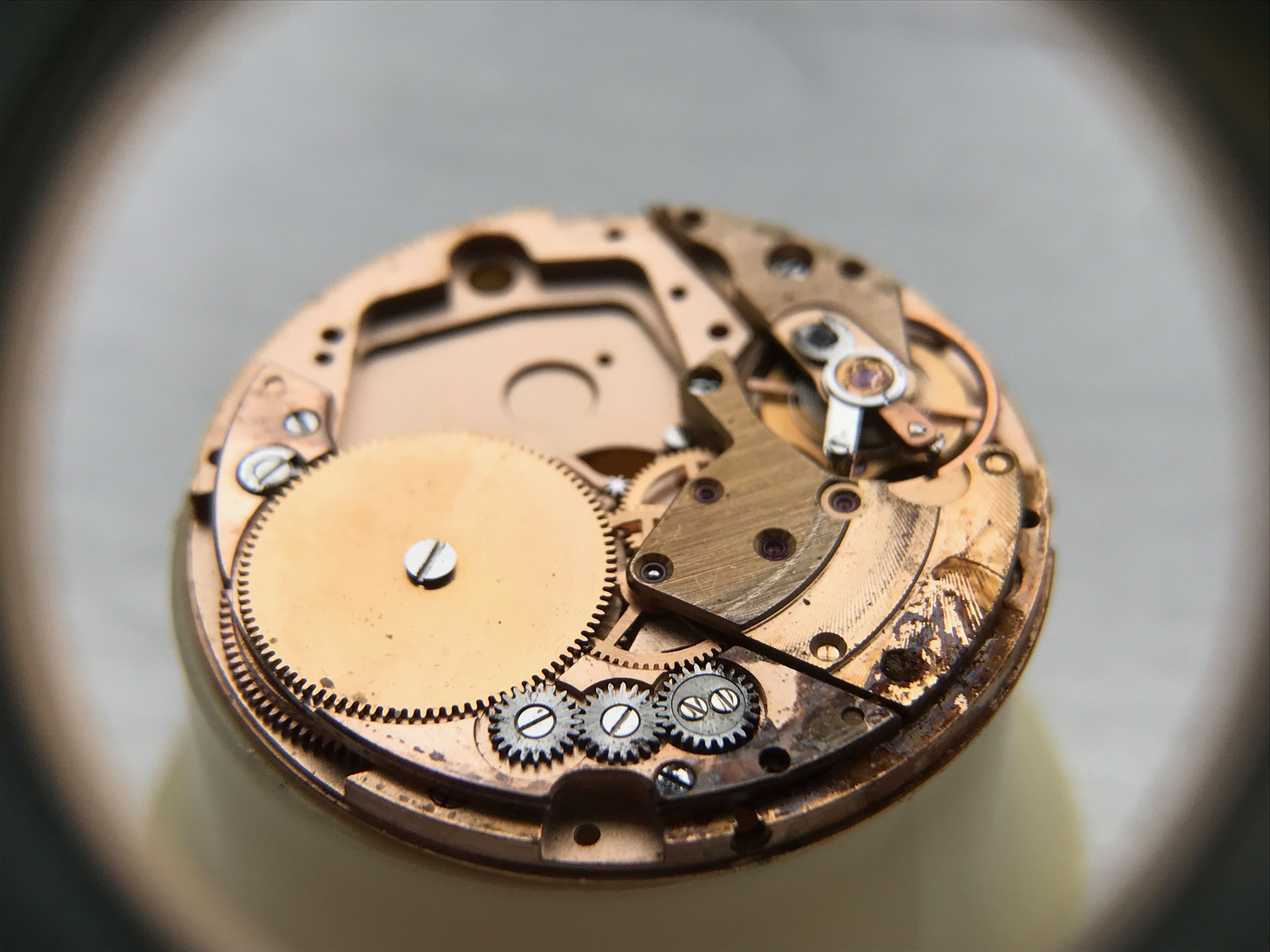

So this are some pictures showing a watch that hasn’t been opened for over 20 years. Some rust damage product of a missing seal . Luckily they told me they were able to restore it and bringing back to life
Make sure you get a new crown/seals or, as a minimum crown seals. Should be nice when sorted.

So I finally got it back, after 20 years being dead in a safe box, the watch is back lo life and is ticking nicely; it just needed new o-rings, a spacer was missing, some gunk and junk cleaned and that was basically it.
I ended up just servicing it, no cosmetic changes whatsoever. It is a Mark I from 1971 in its original state. I think they told me the caliber was a 1001 instead of a 1002. Is this common? Anyway, my plan is to keep it as it is today: “My Dad’s Watch”
