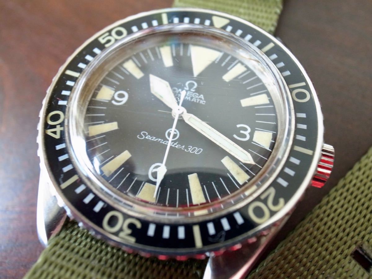

Please opinion for buy Seamaster 300 3rd Military Cal.562 ST14755
521
980

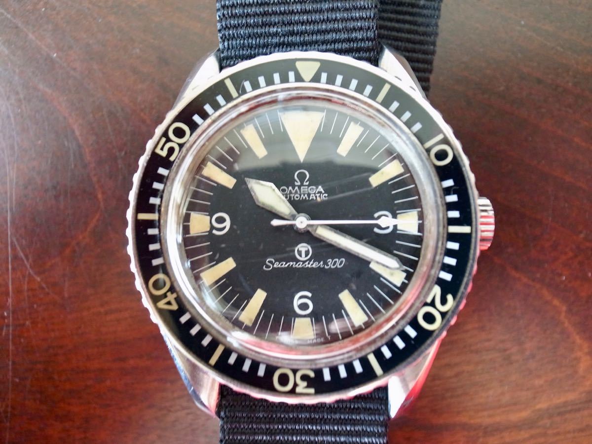

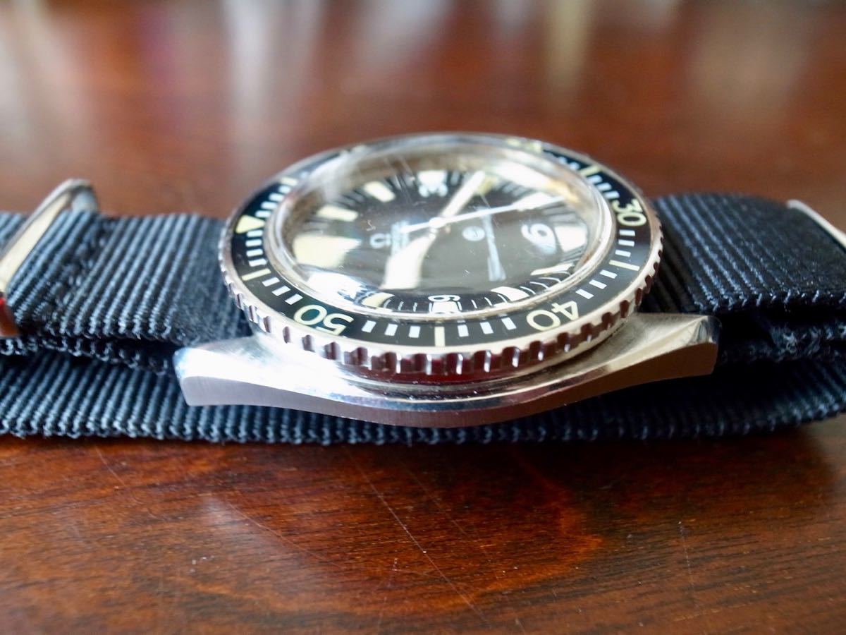

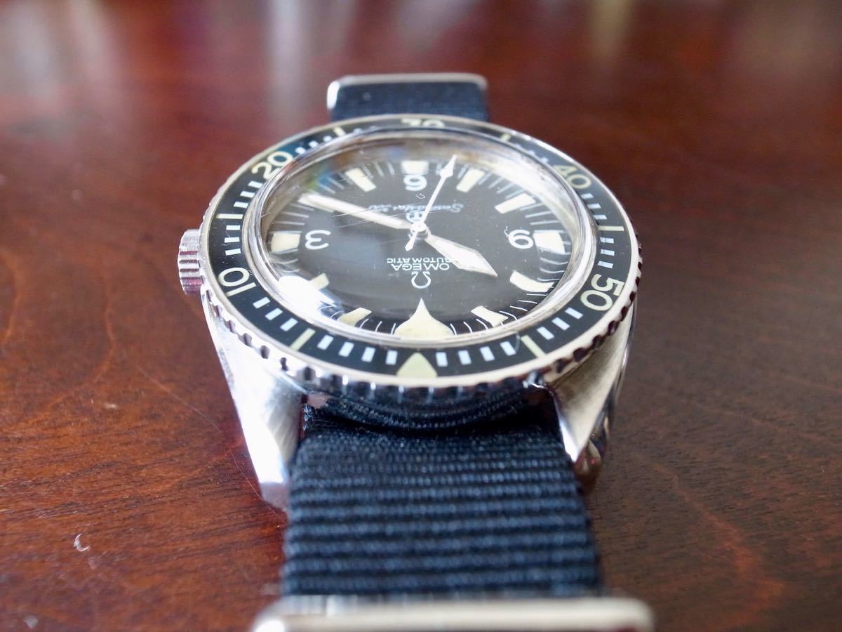

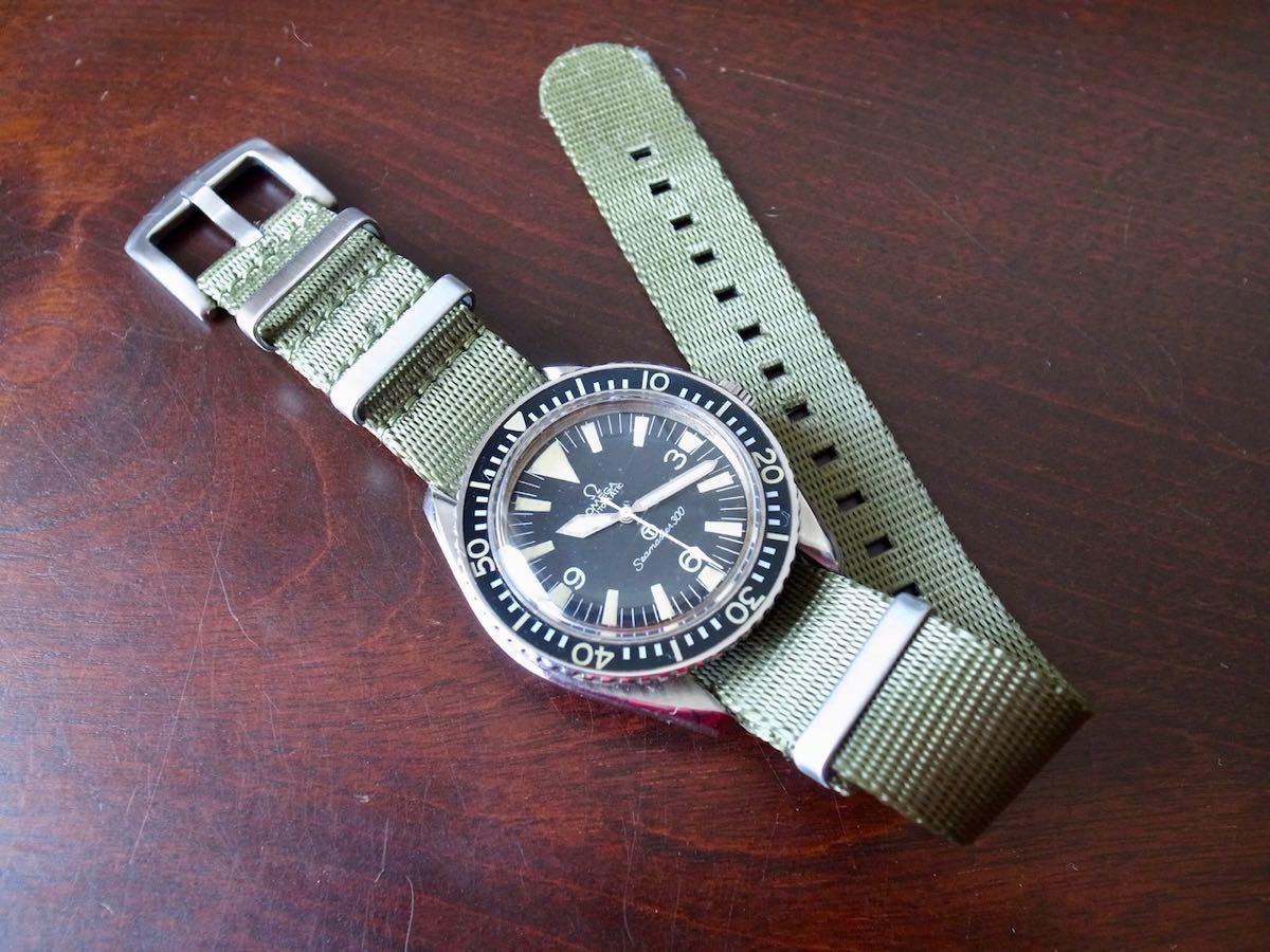

Hello, Omega Forum!

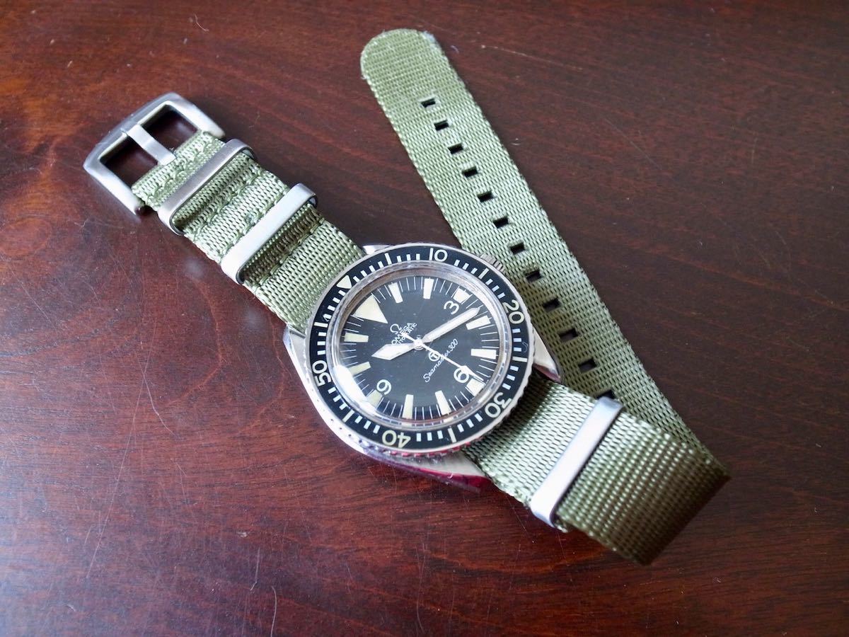

I found a Seamaster 300 3rd Military Cal.562 ST14755 in an auction.
I would like to know what you guys think about it.
It looks good in my opinion.
Please let me know if there is anything I have missed.
This is an auction, so the price is not fixed. (Start from 1)
Seller has asked Omega for a quote for service.
The seller confirmed the quote and cancelled the service.
The windshield has been replaced from the original with a genuine Omega plastic domed one.
The history of parts replacement is unknown.
This is the only photo I have. Sorry.
I am using a translation service. Sorry for the strange English.
609
789

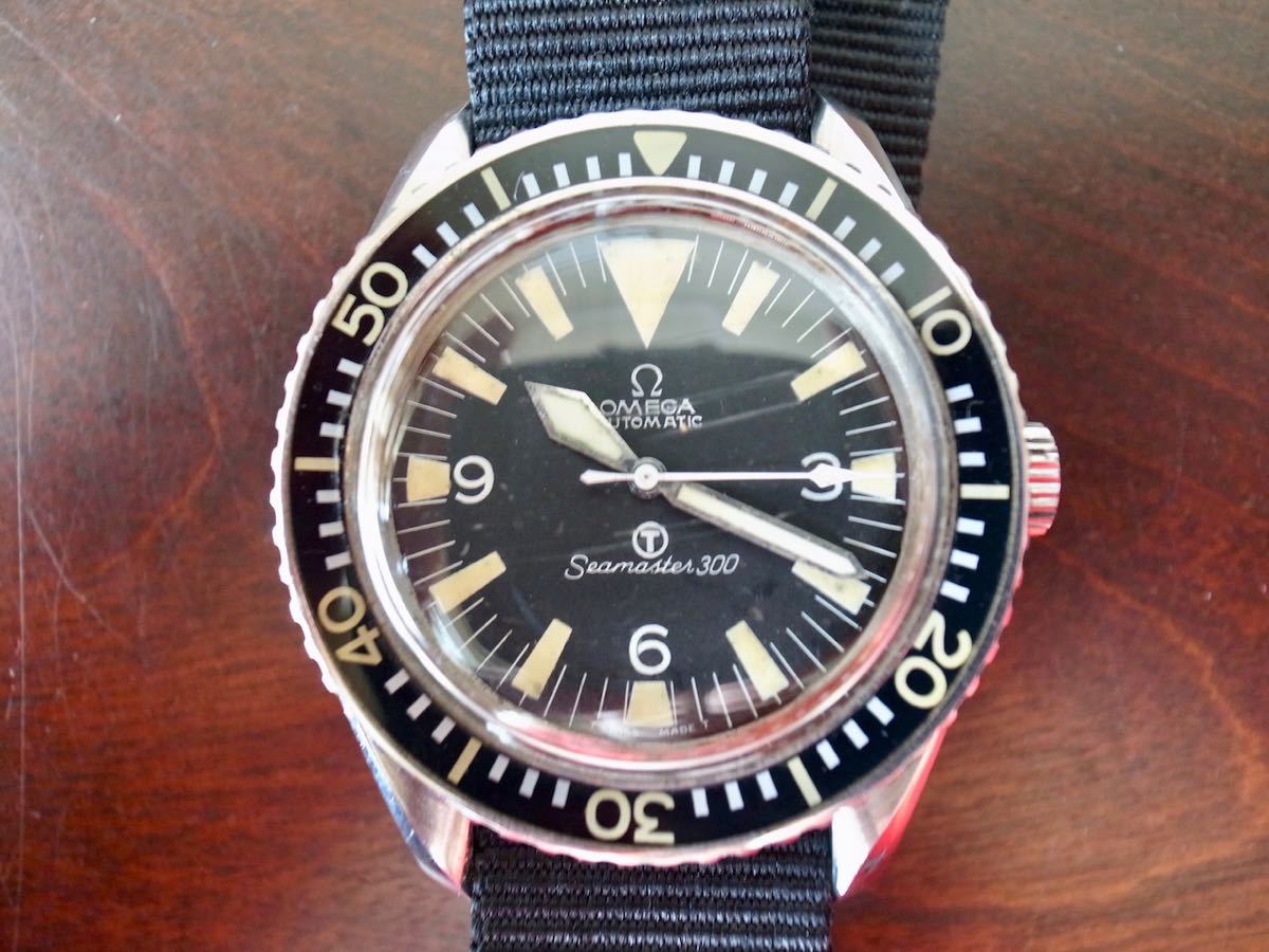

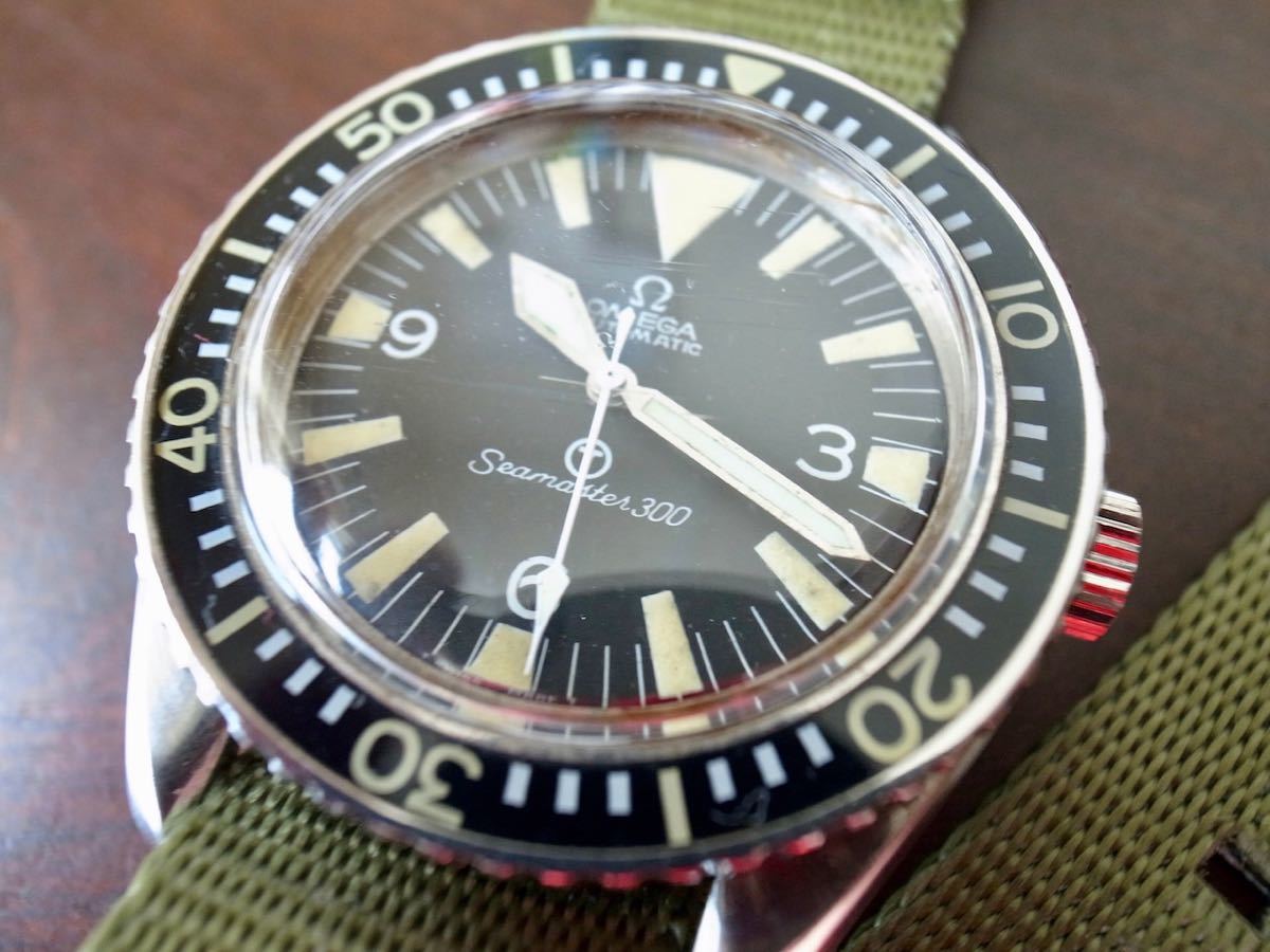

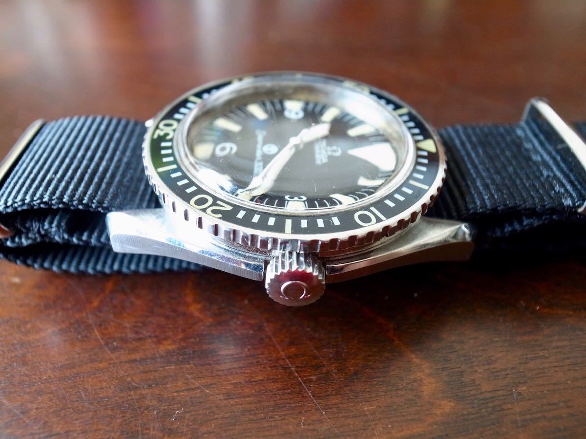

It is a Vietnamese fake. Assignment number from Knirim book, pointy 3 in the bezel, closed 9 and stubs at the indices. Worth about 80 USD at street markets.
also, the 562 is a movement with date, nothing to do with the 165.024.
521
980
I thought it was real because of the service quote from Omega.
Thank you for your help.
Kowloon has loads of them too. I suspect this one is Hong Kong manufactured as the bezel knurling is similar and not as well machined as the Vietnam examples I have come across in the Philippines.

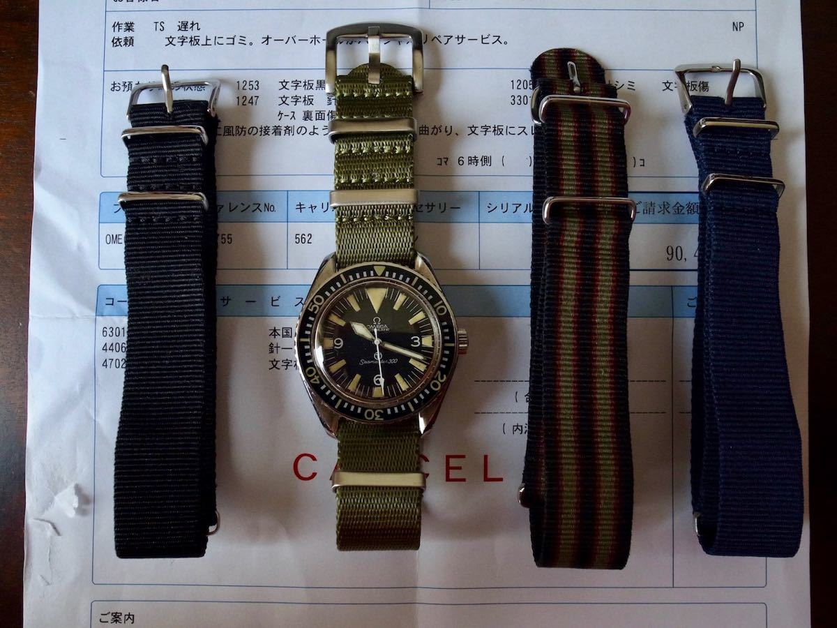

For reference, here is a picture of the service quote from Omega Japan.
The estimate looks correct (then again, I could be wrong...)
I wonder if it's an estimate for a different watch...
The service includes
Complete service from the original manufacturer (A)
Complete set of hands Dial replacement

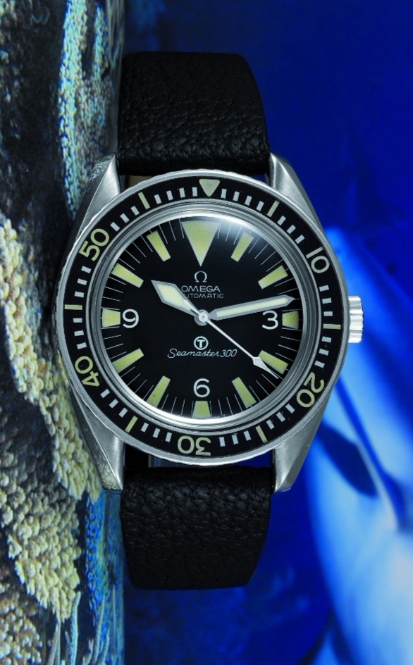

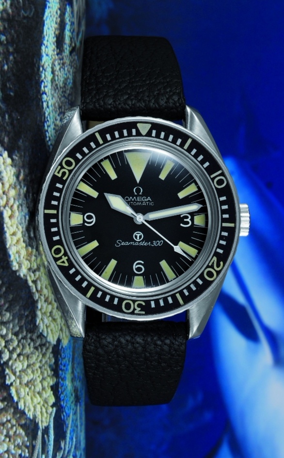

Maybe someone at Omega Japan thought "Wow... that is exactly THE 14755 from the 2007 Antiquorum Omegamania auction, that was sold for CHF 40.000 those days. How lucky I am to restore it."
Picture source:
https://catalog.antiquorum.swiss/en/lots/omega-lot-158-128
So obviously not the 1st neither the last time some Omega "experts" took such an asian replica for authentic.

Unlikely... unless the serviced watch was another fake. Because a 14755 cannot be equipped with a 562 caliber. As simple as that.

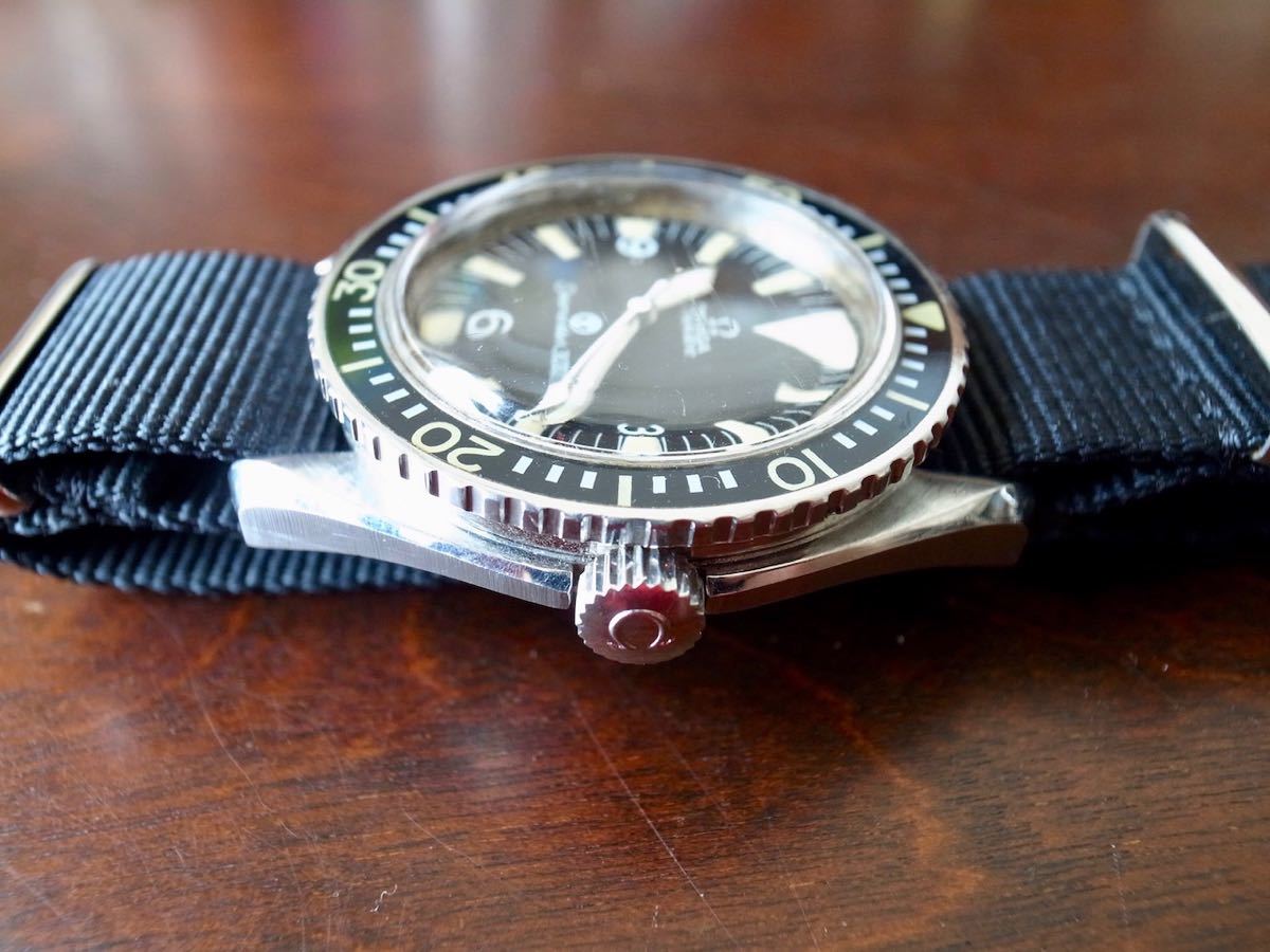

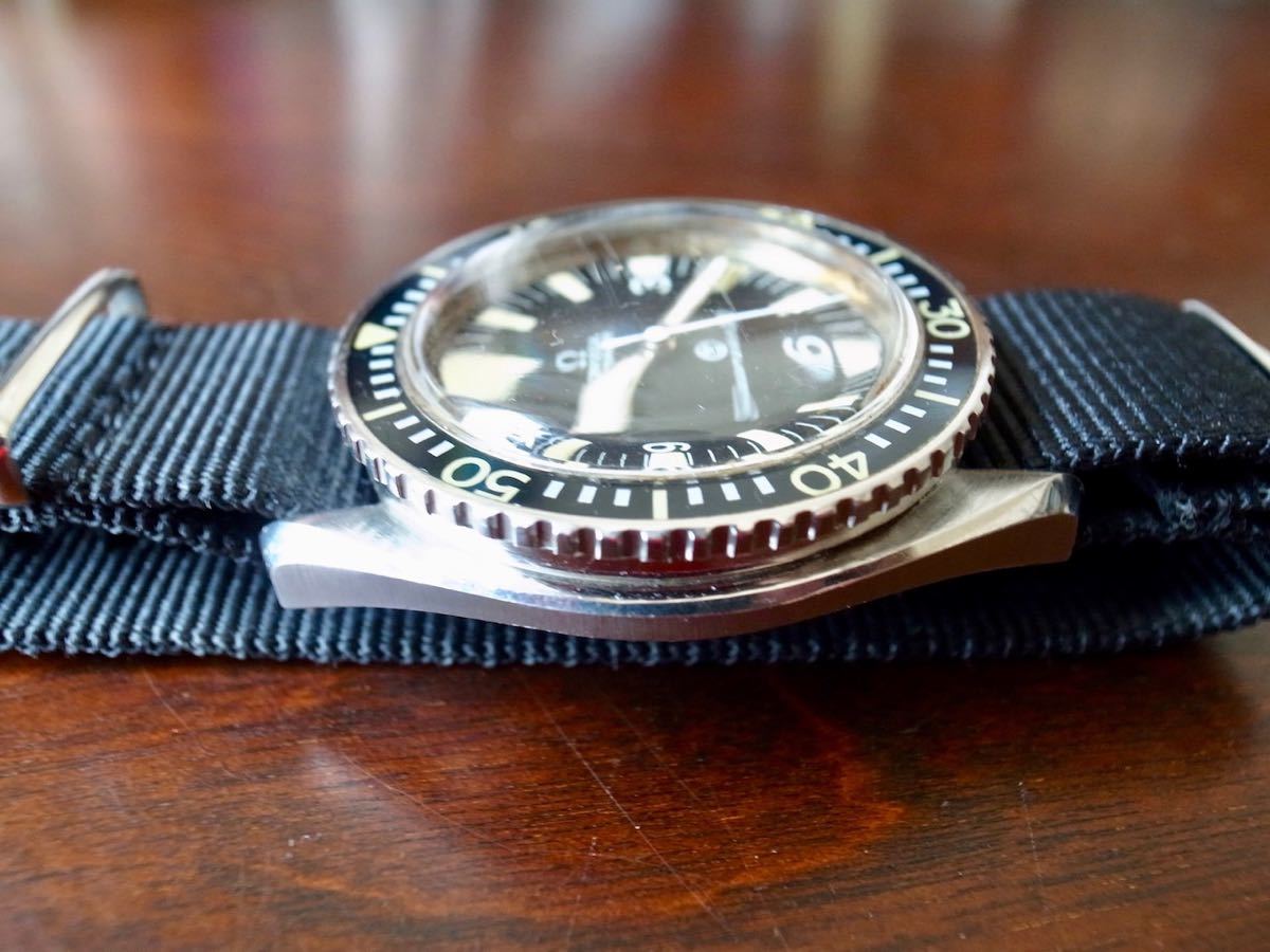

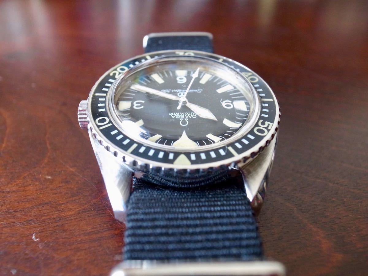

All three images are from a single service quote
The first image shows the contents of the product. (The watch, the quotation and the nylon strap)
521
980
The red circle to the left of the barcode in the upper right corner is a stamp indicating that it was created by 'Tokyo Customer Service' on September 9, 2020.
The part hidden by the nylon strap in the upper left corner is the client's address, phone number, and other contact information, so it is hidden.
521
980
The Japanese of the image has been exported.
Can use a translation service to translate it.
521
980
作業 TS 遅れ NP
依頼 文字板上にゴミ。オーバーホールかバーシャルリペアサービス。
お預かり時の状態
 1253 文字板黒色    1205 文字板 針シミ 文字板傷
 1247 文字板 針夜光変色 3301 ケースガラス傷
    ケース 裏面傷      ベゼル傷
 文字板上に風防の接着剤のようなものあり。針曲がり、文字板にスレ跡。
コマ 6時側( )コ 12時側( )コ
ブランド OMEGA
リファレンスNo. ST14755
キャリパーNo. 562
アクゼサリー クロナイロン
シリアルNo.
ご請求金額(税込) 90,420
コード サービス内容 ご請求金額
6301 本国 メーカー コンプリートサービス (A) 63,800
4406 針一式 0
4702 文字板交換 26,620
(合 計) 90,420
(内消費税) 8,220
CANCEL
ご案内
【重要】保証規定、時計のご使用上の注意点、個人情報のお取り扱いについてのお知らせを裏画に記載しております。
必ずご一跳ください。
521
980
The serial number field is left blank in the quotation.
The service quoted is to send the watch back to the country of origin, replace the dial and hands, and Maker complete ervice.
The service price is 90,420 Japanese Yen including tax.
Thank you all very much!
