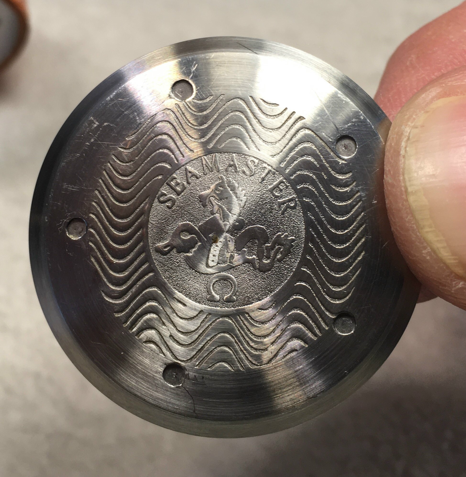

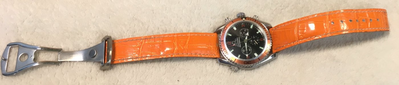

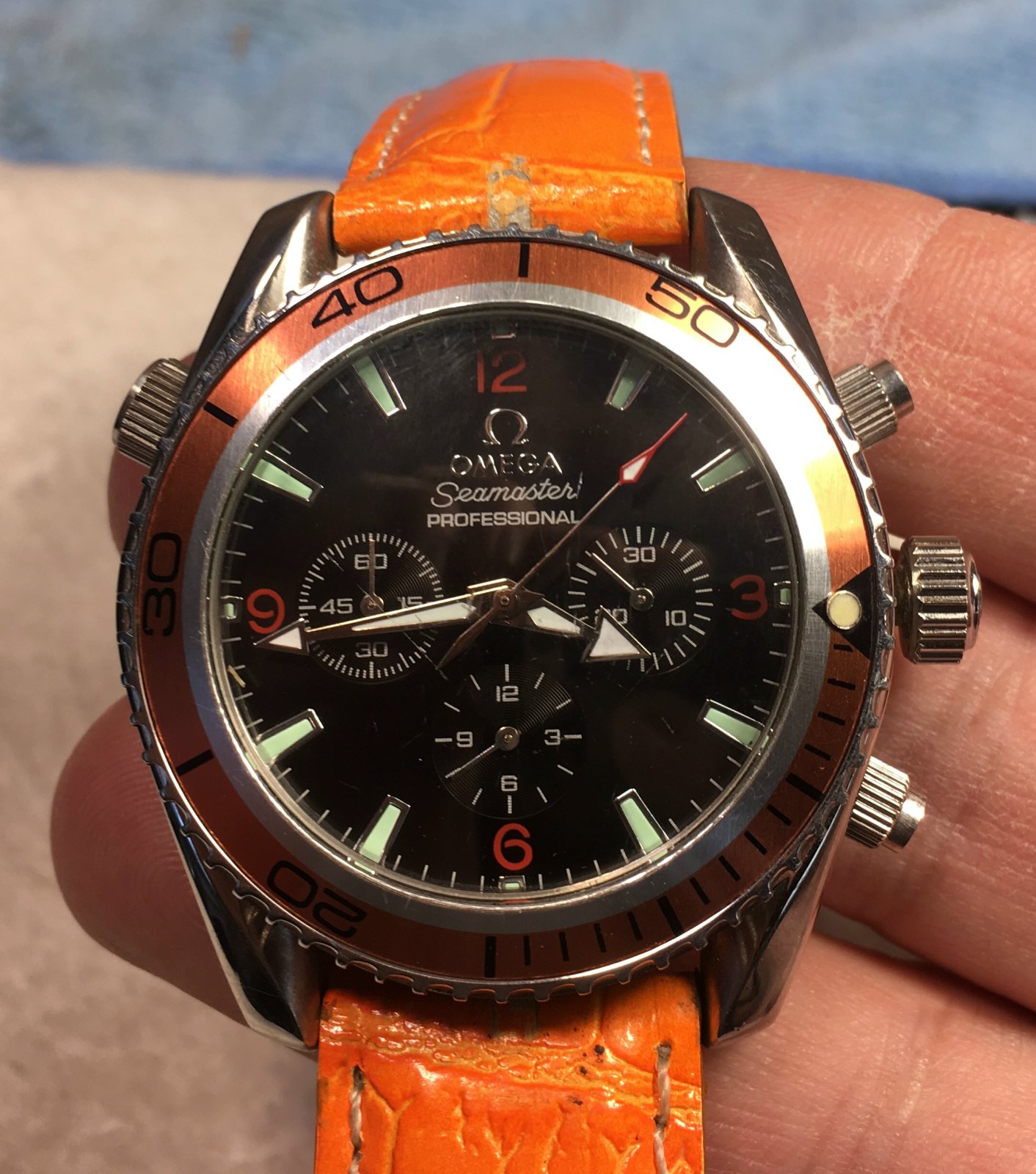

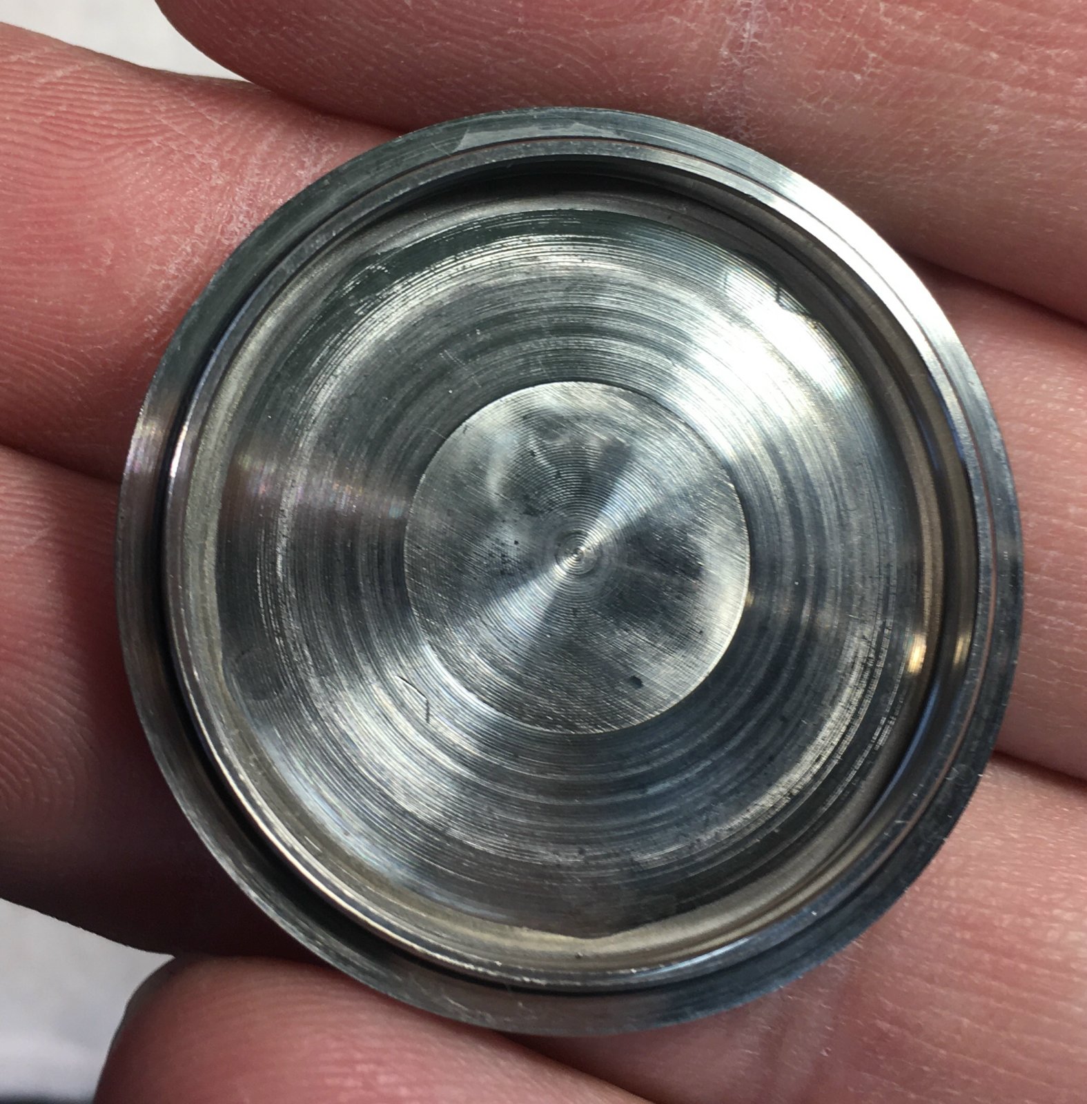

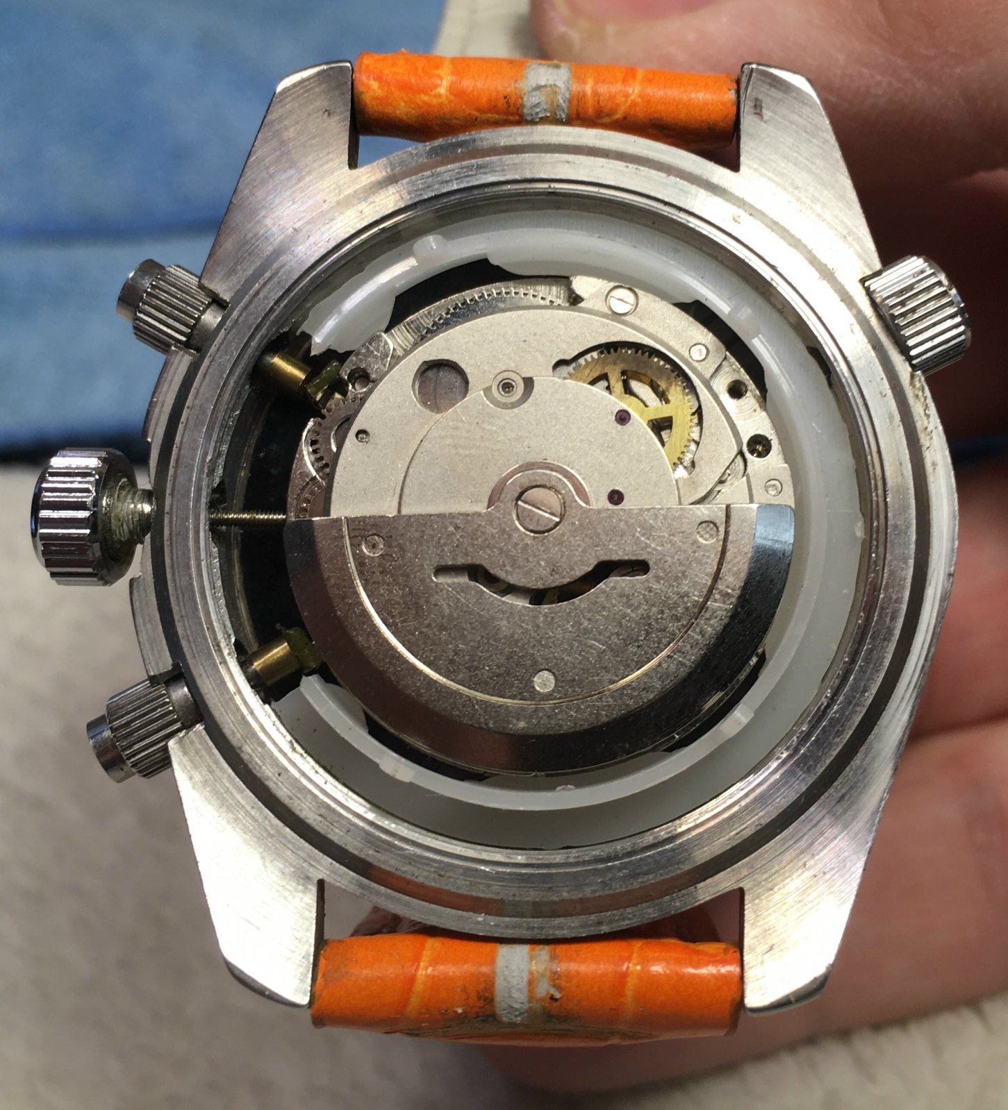

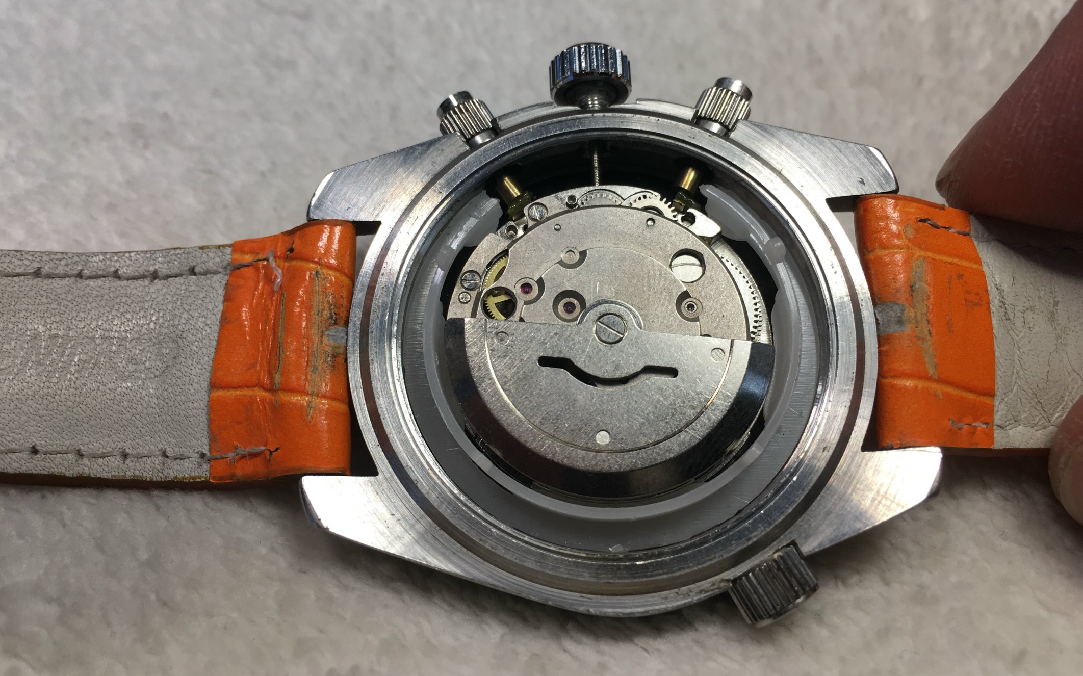

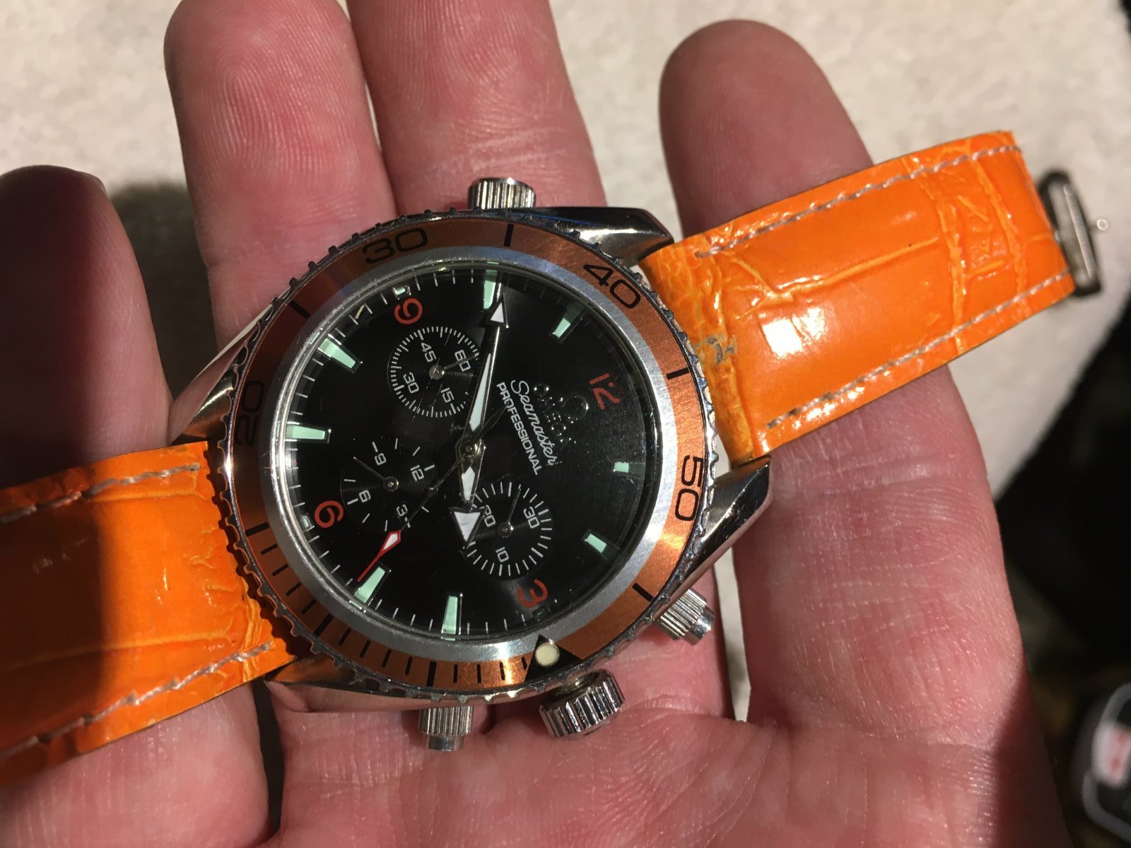

I found an 'Omega Seamaster Professional' with orange leather band at a consignment store, and am trying to verify authenticity. There are absolutely no serial numbers or numbers of any kind that I can find on the exterior or inside the watch (please see attached photos).
Is this a fake? If so, any ideas on quality and value? The store is asking $1500. Is this Omega, a lesser knockoff of some value, or junk?

Very fake, not even a good attempt! 馃槻
232
247
Welcome to the forum but sadly this is very fake

Probably worthless even aside from being fake. Typical layout for a VERY cheap fake, where it's a DG28XX style movement (likely offbrand from the main chinese ones) with pushers that actuate the front sub dials. (normally one will be a 24 hour display, one will be "days of the week" (i.e. 7 increments) and one will be months (12 increments) or date (30 increments). You can always spot these because the effort stopped at having roughly the correct number of subdials and buttons, but because the dial is meant to be a copy of the original watches layout the dials can't even be used as intended by the movement or the layout.
