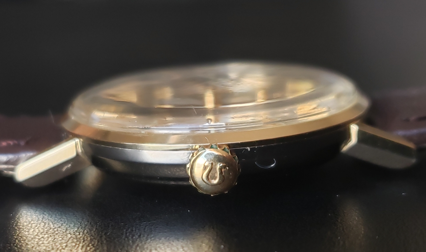

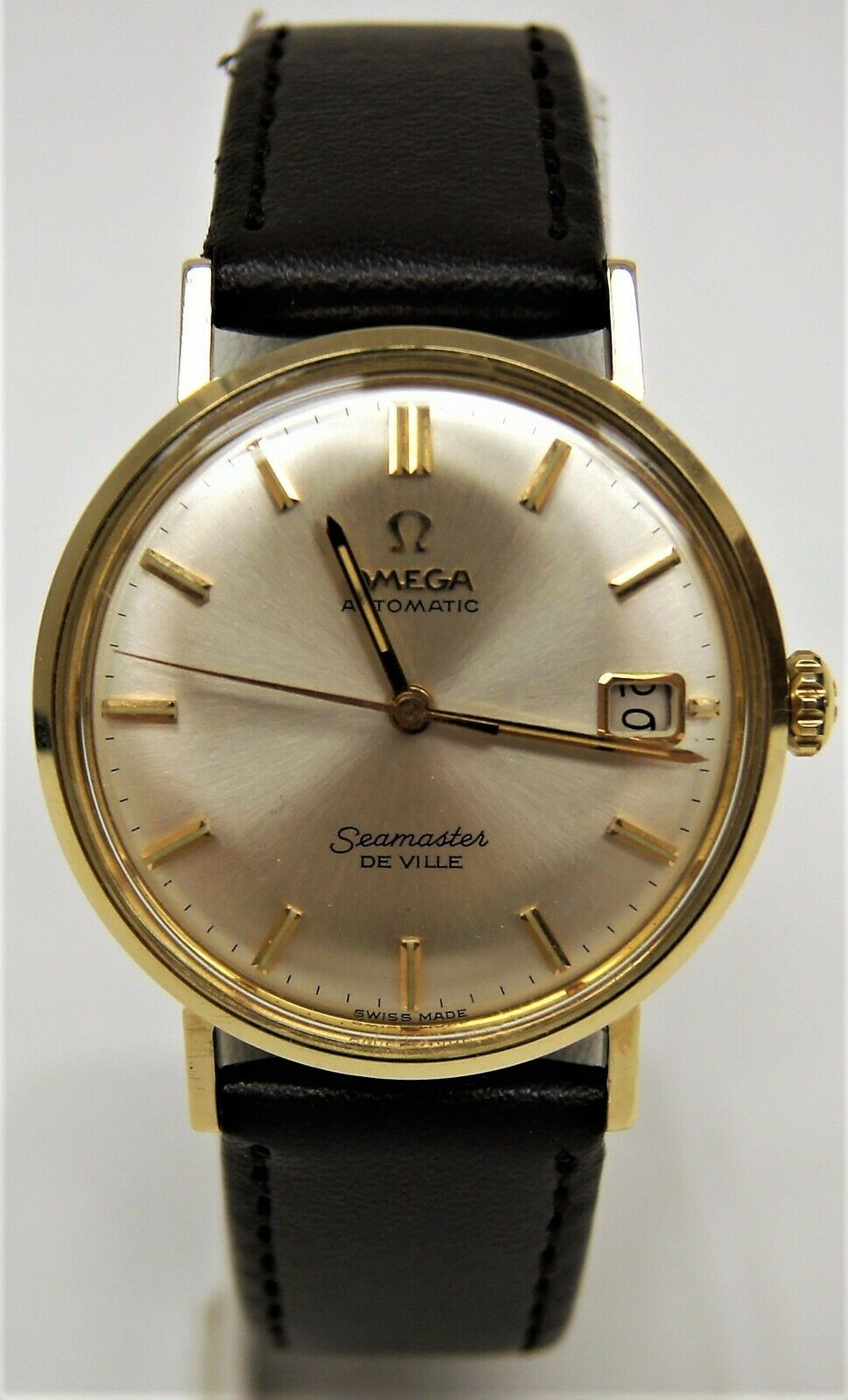

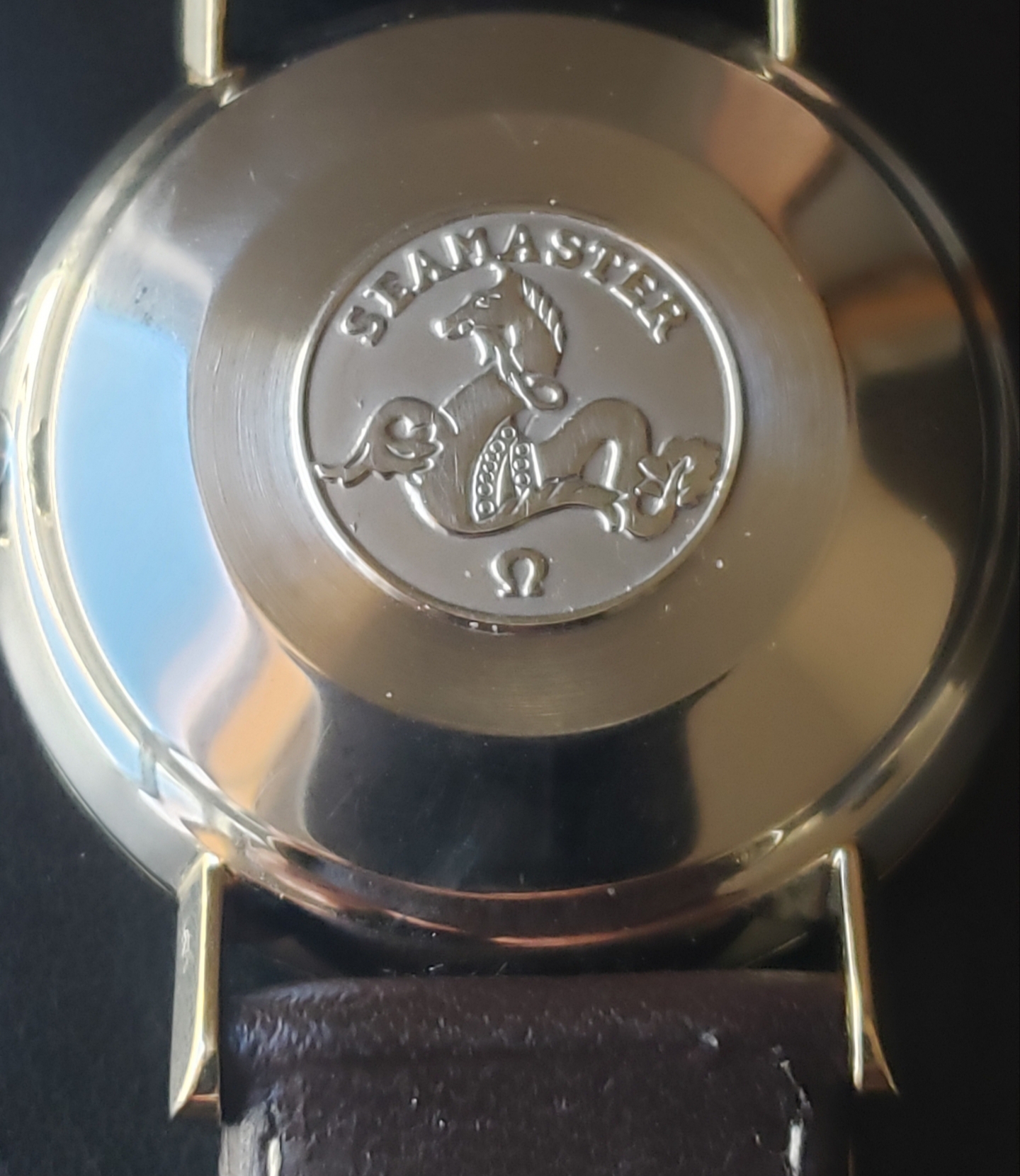

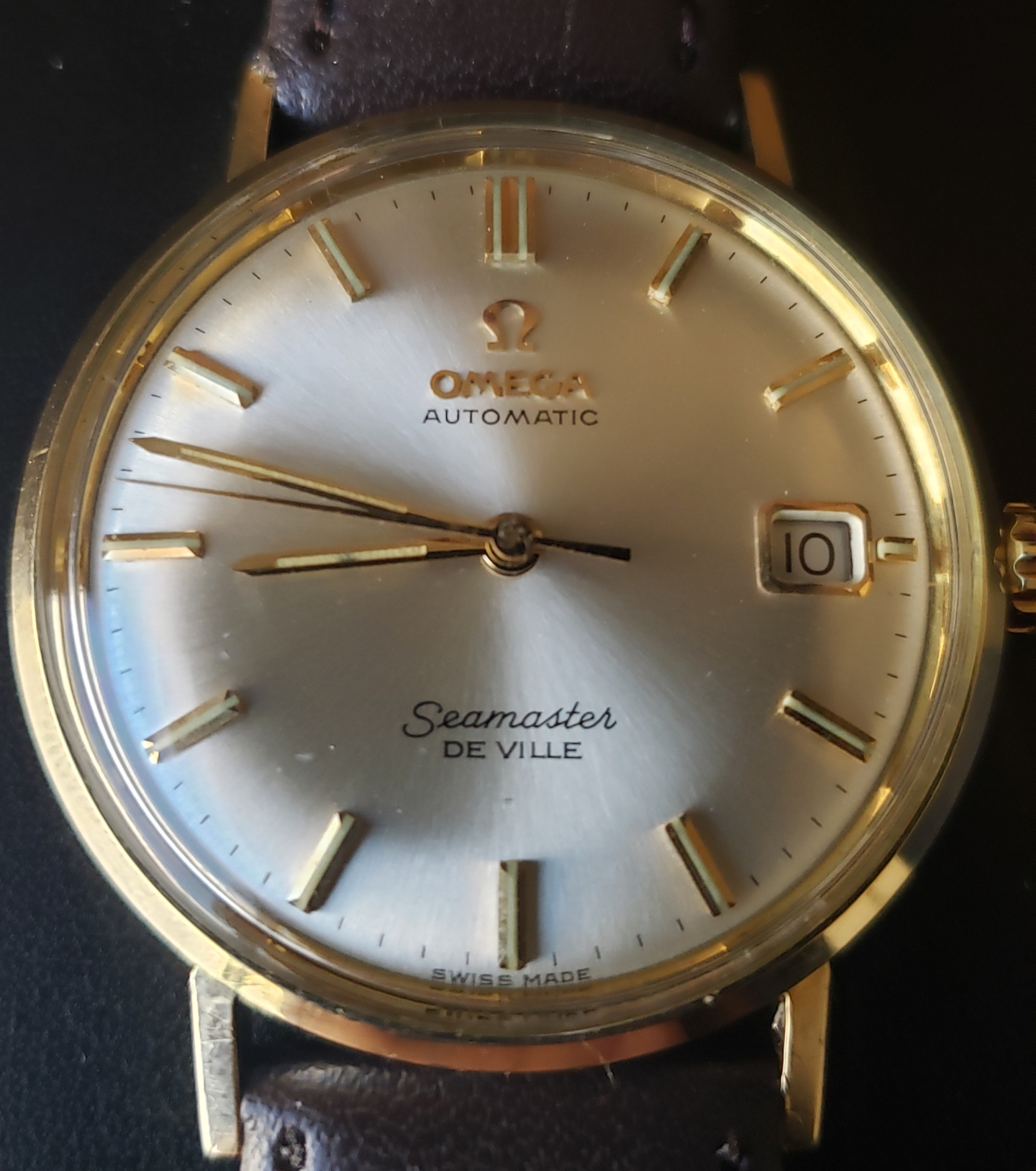

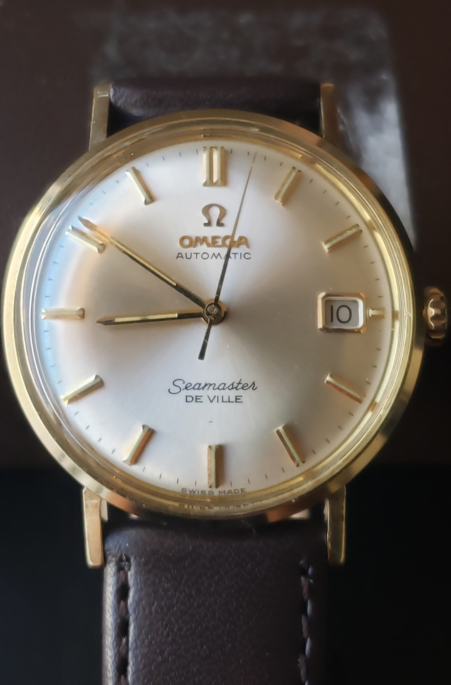

I would like to humbly ask for your help in determining whether this watch is authentic and its quality. I fell in love with the seamaster de ville when I first saw it.
These photos are my own captures (I never knew how difficult it is to photograph a watch. Some members here get gorgeous pictures of their watches- I, however, do not seem capable to do so)
These photos below are form the seller.

Lovely watch. It’s in great shape and you got a great watch. If it hasn’t been serviced in the last 5-10 years, wear it sparingly until you can get it to a watchmaker for a clean and lube.
And your photos are better than many long time members 👍
1,534
3,248
Very clean - nice choice for your first vintage Omega. You can't go wrong with a 500 series movement. This was the golden age of the Swiss watch industry.

1. Should I have my watch opened to check the movement? Should I trust the seller's picture they posted of it?
2. Marks on my watch- on the hour hand- has a black mark in the middle- should I be concerned? Should I take it in right away?

The black mark on the hand is slight moisture damage of the lume (lume is like a sponge), and any moisture can change it from golden yellow to moldy green/black. This is common and yours is not bad. As long as the watch has a fresh crown seal (and the whole crown needs to be replaced with a new factory correct crown) it should stay moisture tight (don’t go swimming with it, but even a humid summer sweaty day can get moisture into a watch if the seals are bad). As for wearing it, even though it may run, if it hasn’t been serviced in the last decade the oils inside are dry as a bone and all the parts are running dry- so the more you wear it, the more potential damage that can happen.
Let us know where you are in the world and someone can reccomended an independent watchmaker that can take care of this.

A tiny spot of mold is not something to worry about in a 50+ year-old watch. Get it serviced and enjoy it.
