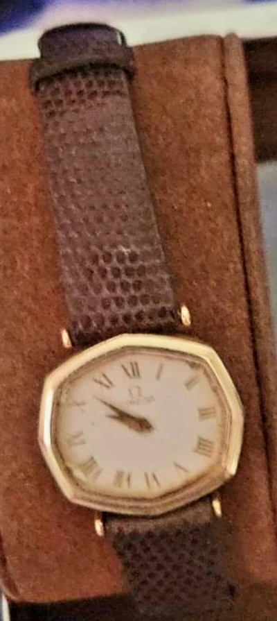

Please help identify this vintage timepiece.
I would like to replace the missing crown stem
on this 14k Gold timepiece. I would also like to source the dial face as well.
Please help me identify a source where I can find replacements for the aforementioned parts.

It’s a weirdly shaped watch. Just out of curiosity, does your cameras focus automatically, or do you have to do it manually?

Hi, i’m no expert but have a fair amount of experience on the forum and i’m sure you’ll be asked, not always politely, to provide more, and better quality photos, a few good clear close ups of the dial, case back (inside and out) and several of the movement, as clear as possible, determining a model involves quite a few criteria, good luck

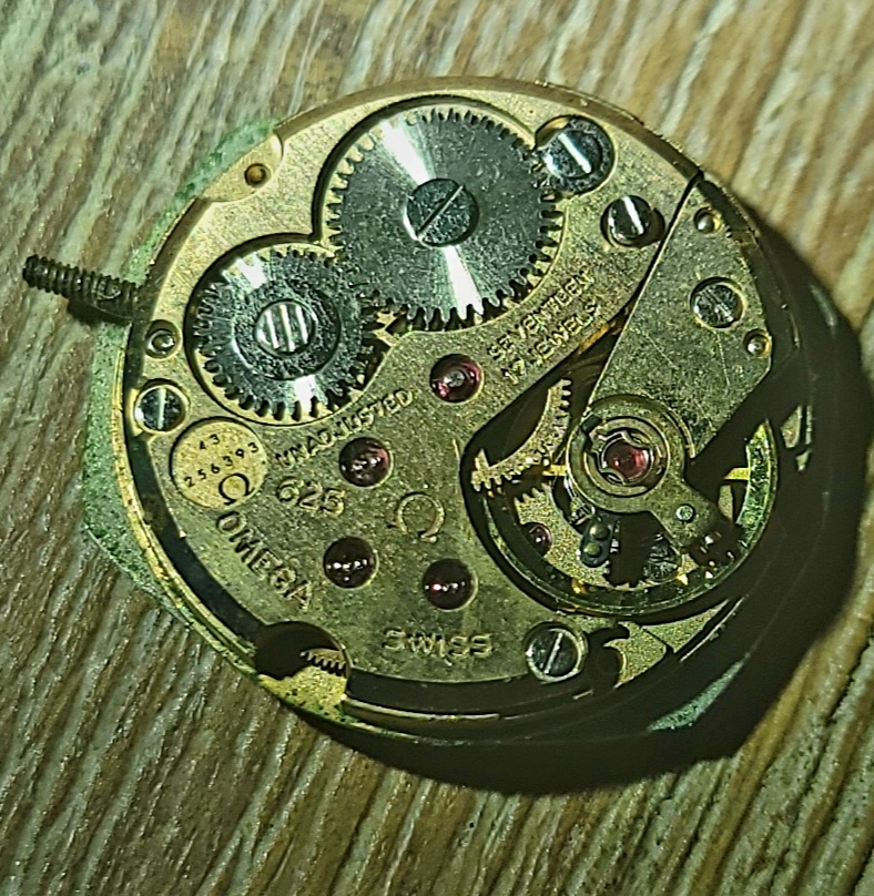

You will likely not be able to replace the crown yourself. Let us know where you are so we can recommend a competent watchmaker. Let the watchmaker source a crown for you.

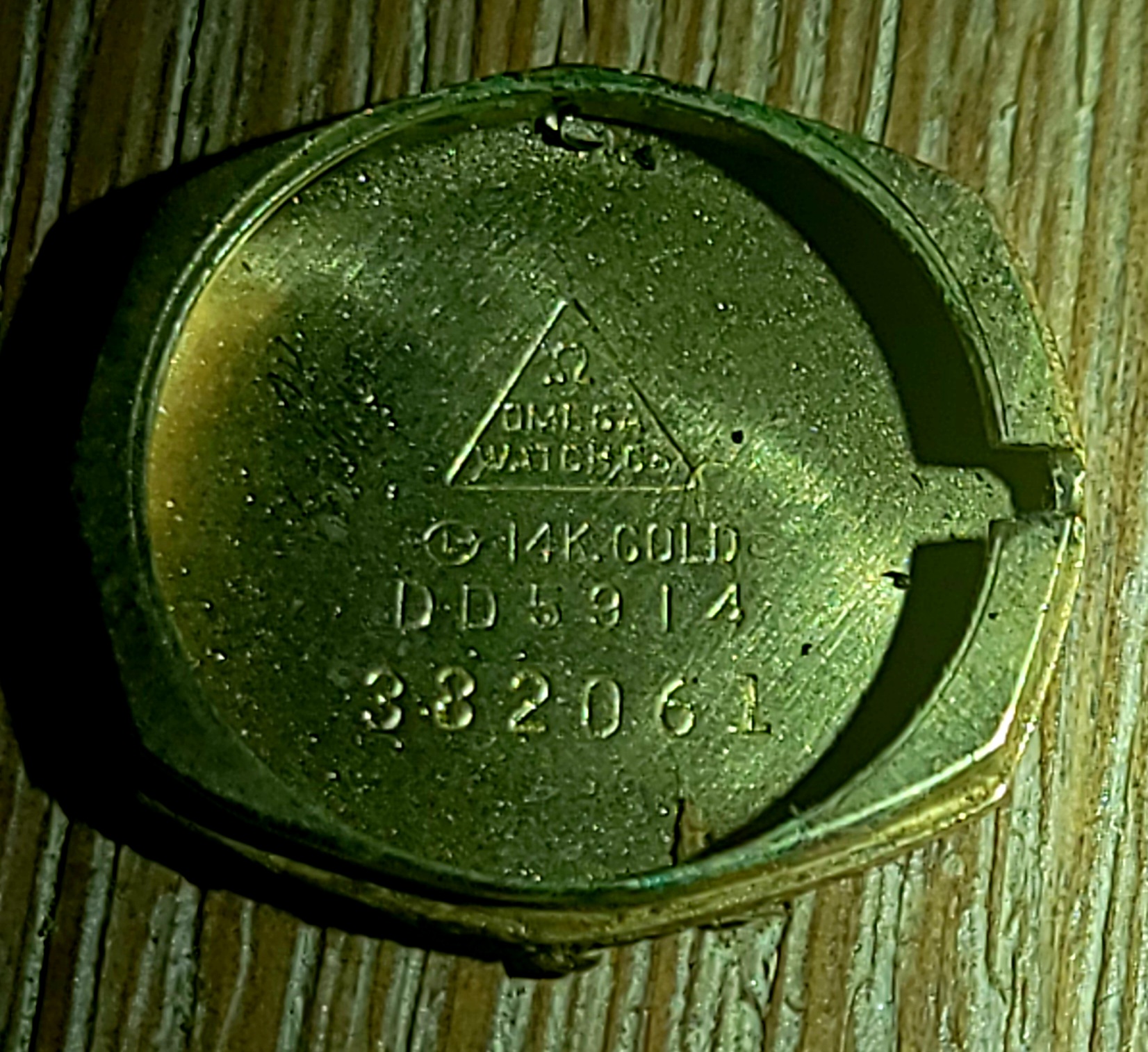

To identify the reference of the watch you will have to open it and you will find it written inside of the case back.

US market, ref DD5914, ca 1979.

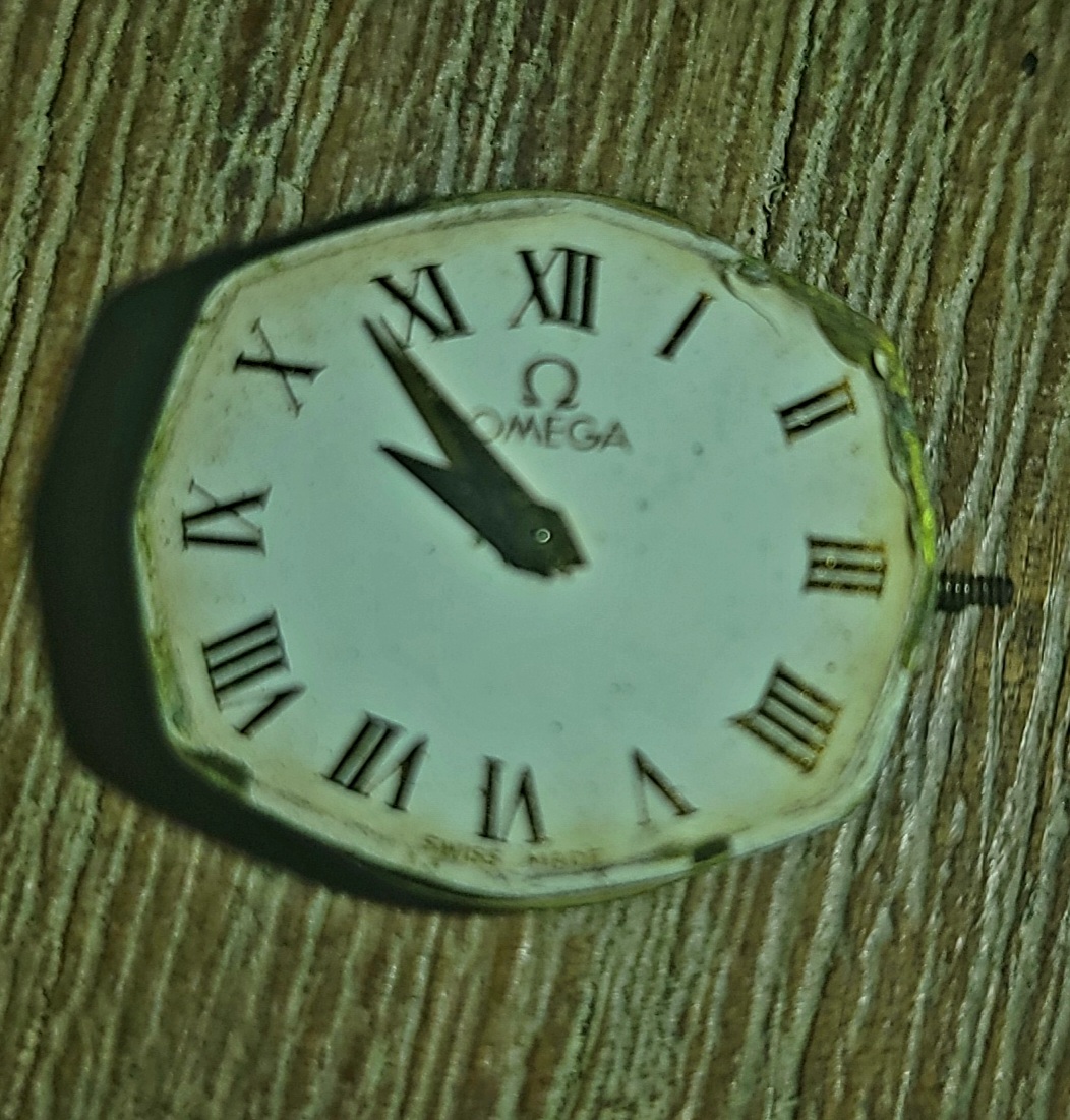

Probably originally had a simple cabochon crown. Good luck on the dial.
