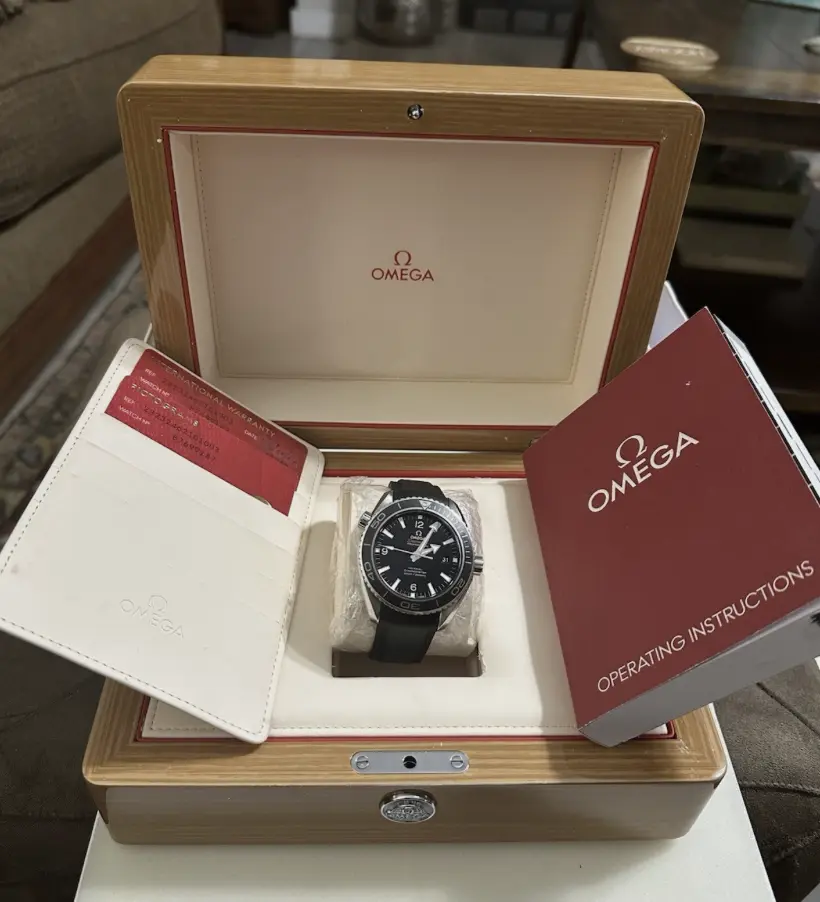

I just purchased a PO 8500 45.5 on a rubber strap and love it! (232.32.46.21.01.003) I was thinking of getting a Omega metal bracelet to have another wear option, but it’s a bit confusing on which bracelets would fit, and Omega’s website does not show any that are apparently still in production. Any help appreciated!
