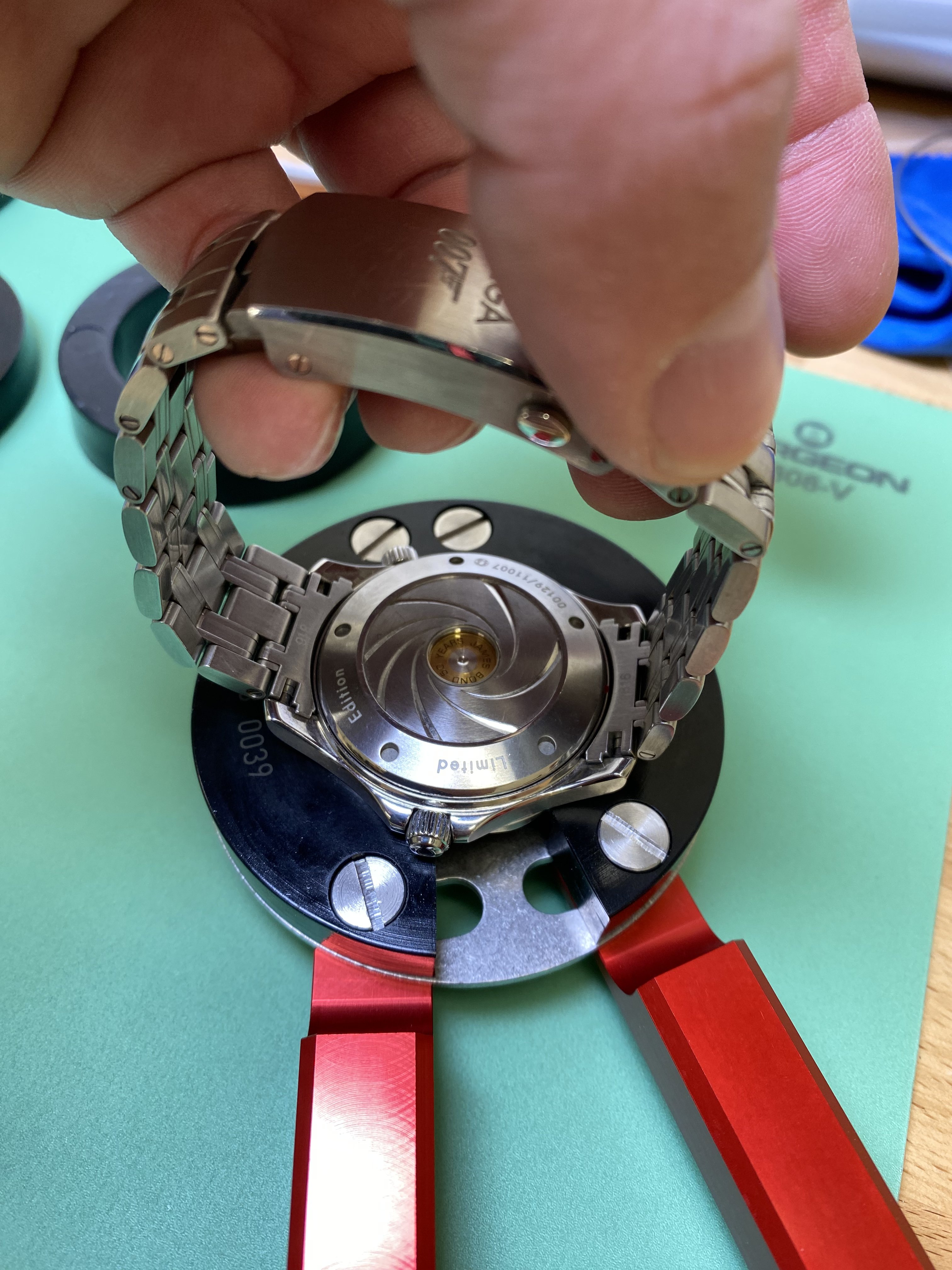

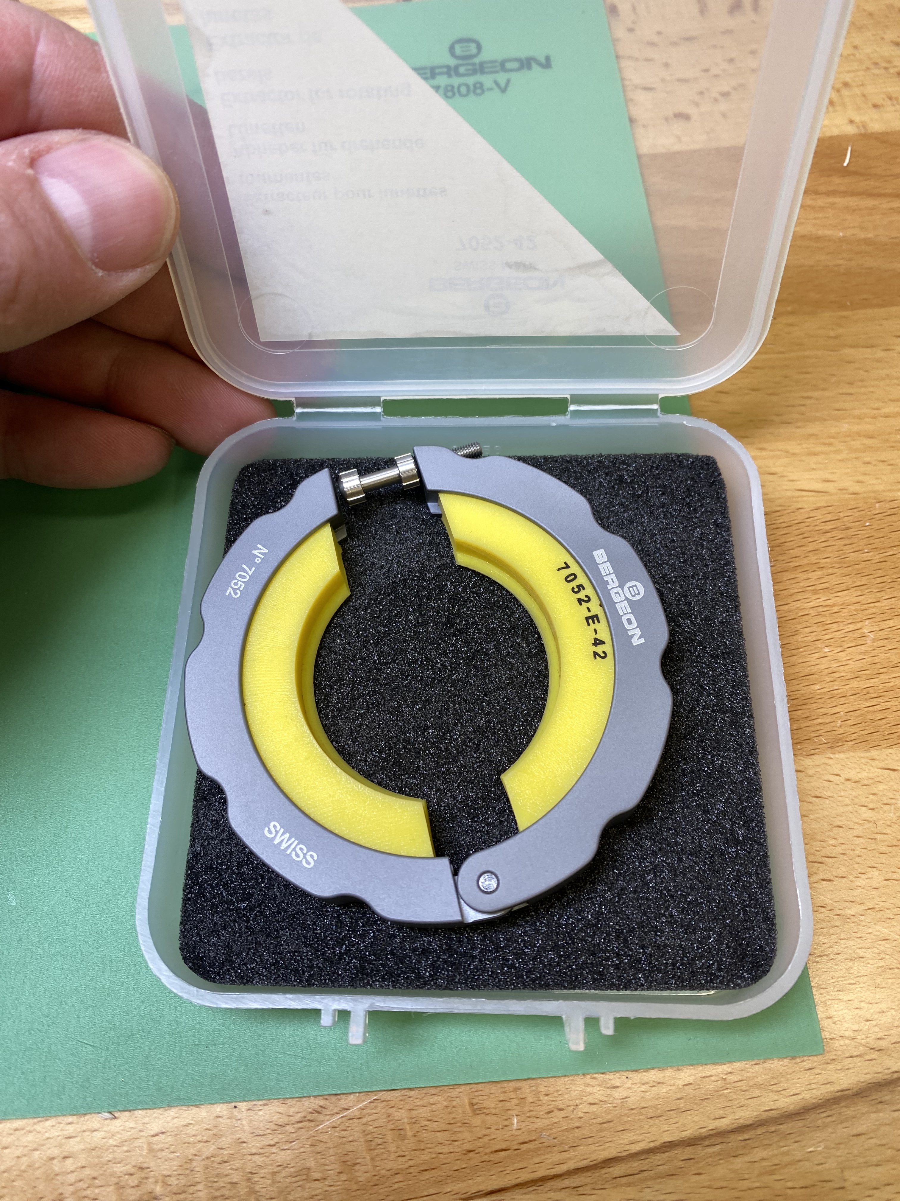

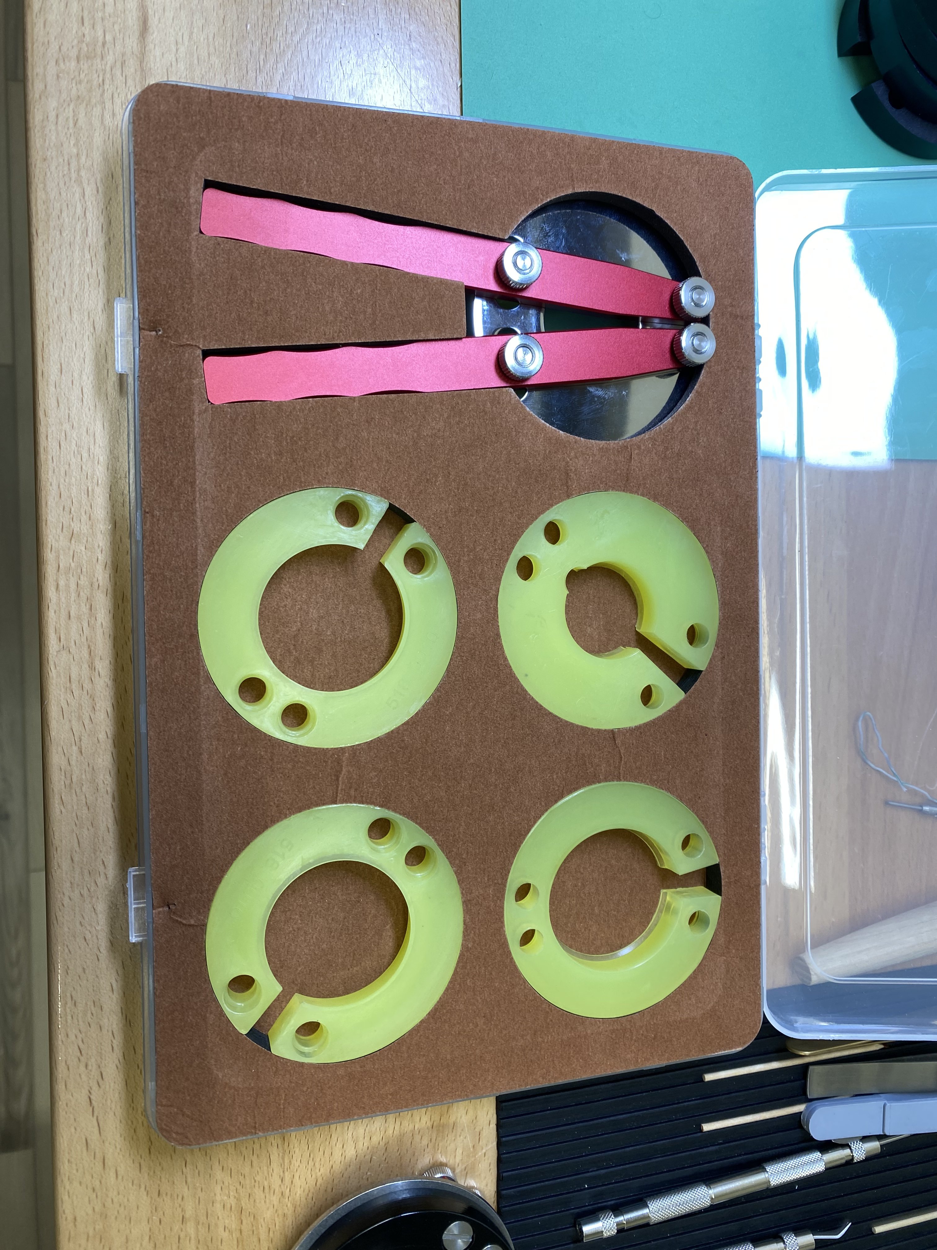

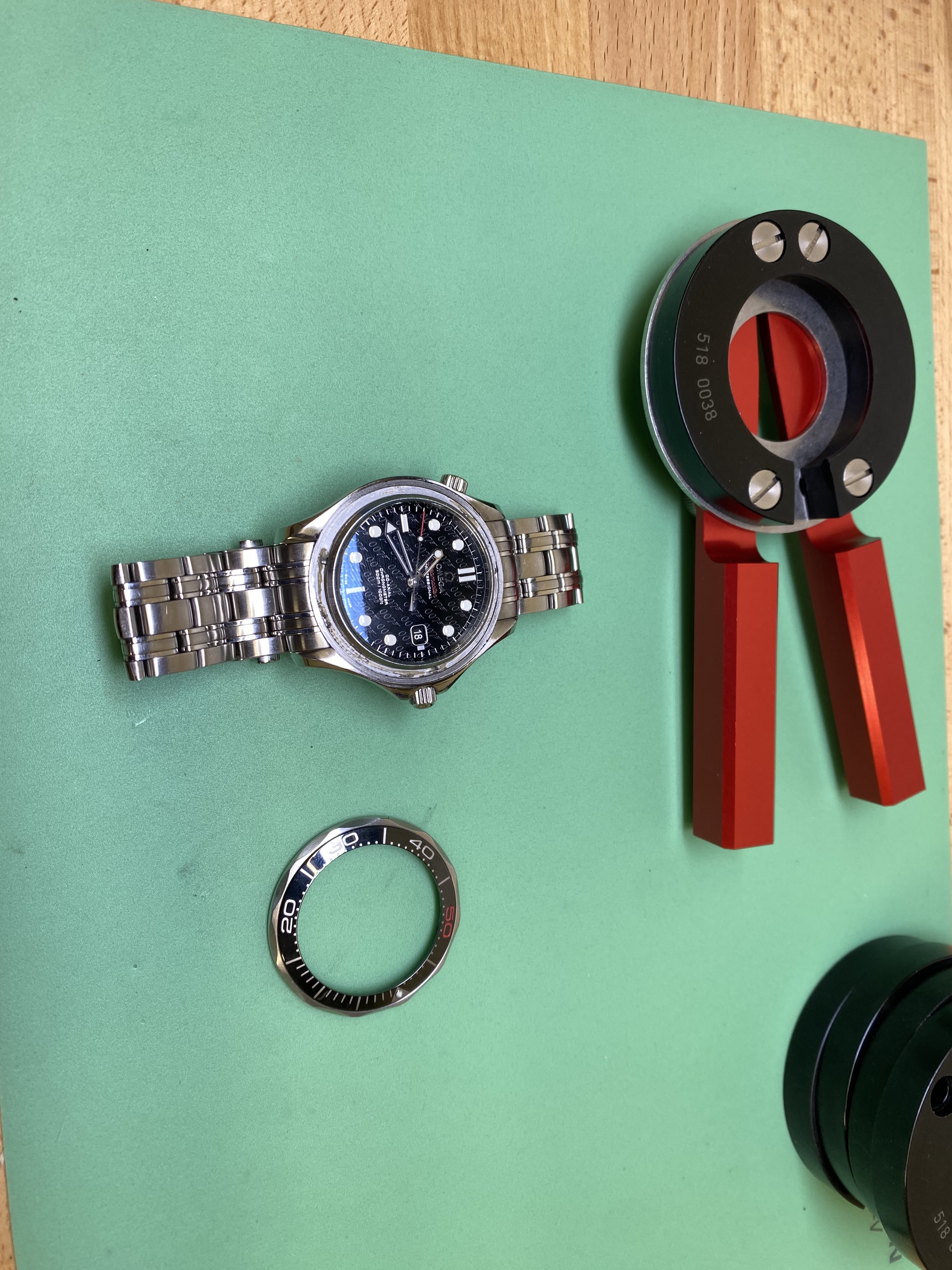

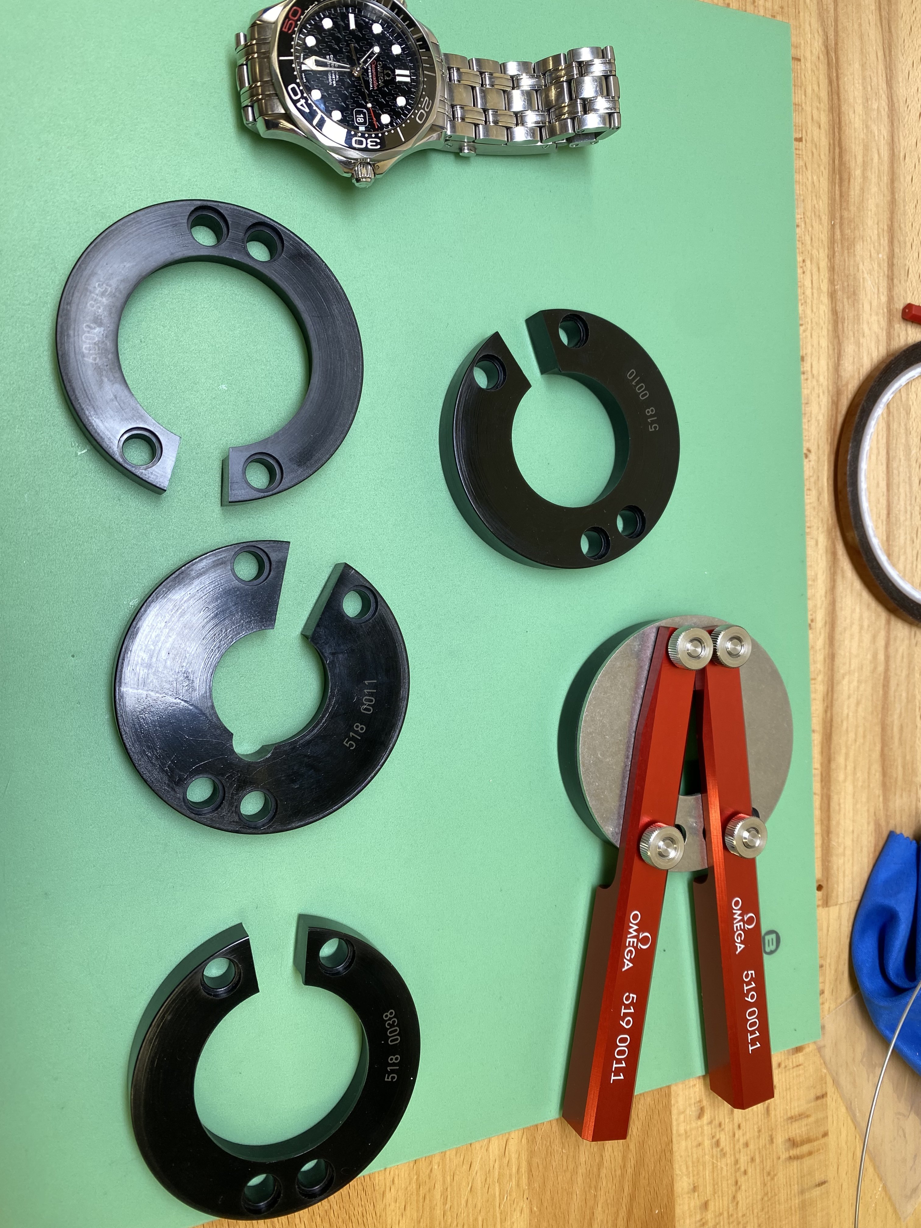

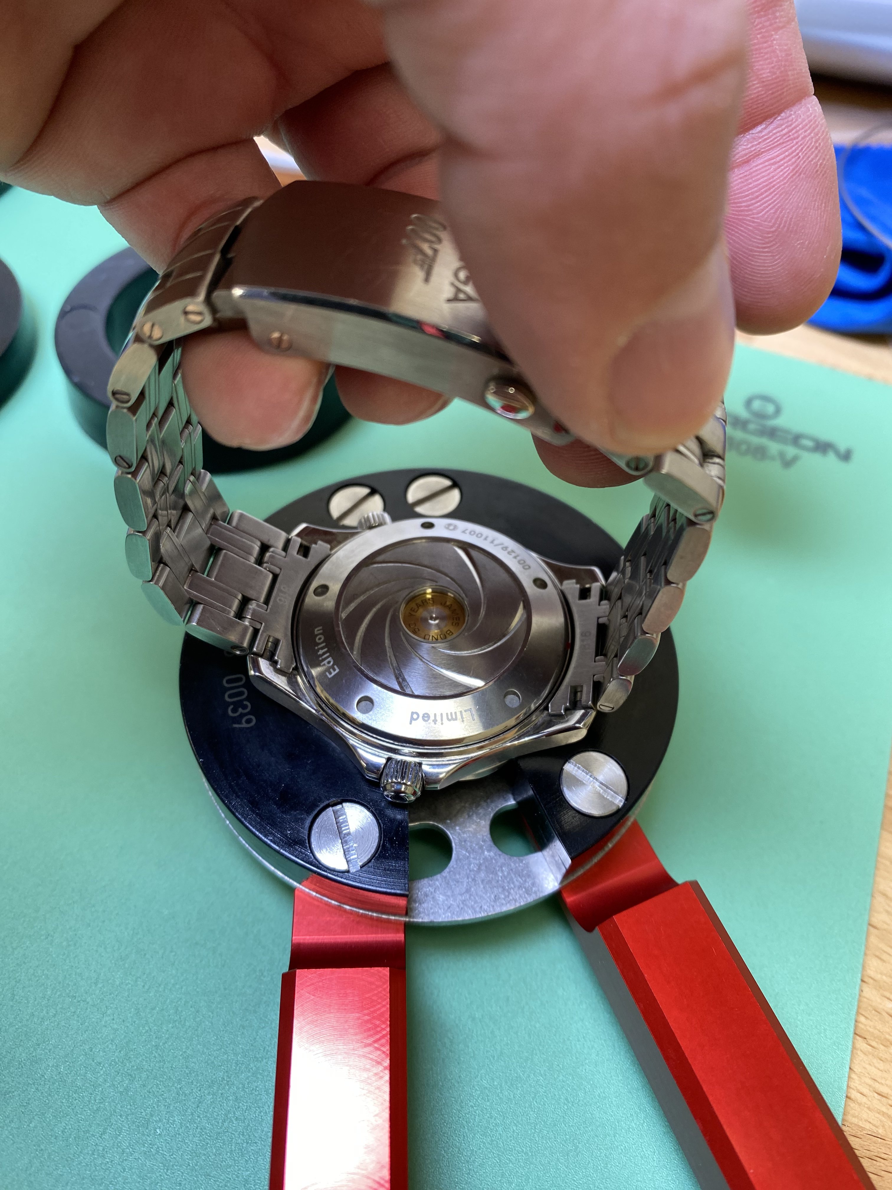

The correct tool looks like this:
you install the correct size inner die, then squeeze and twist in the direction of bezel rotation.

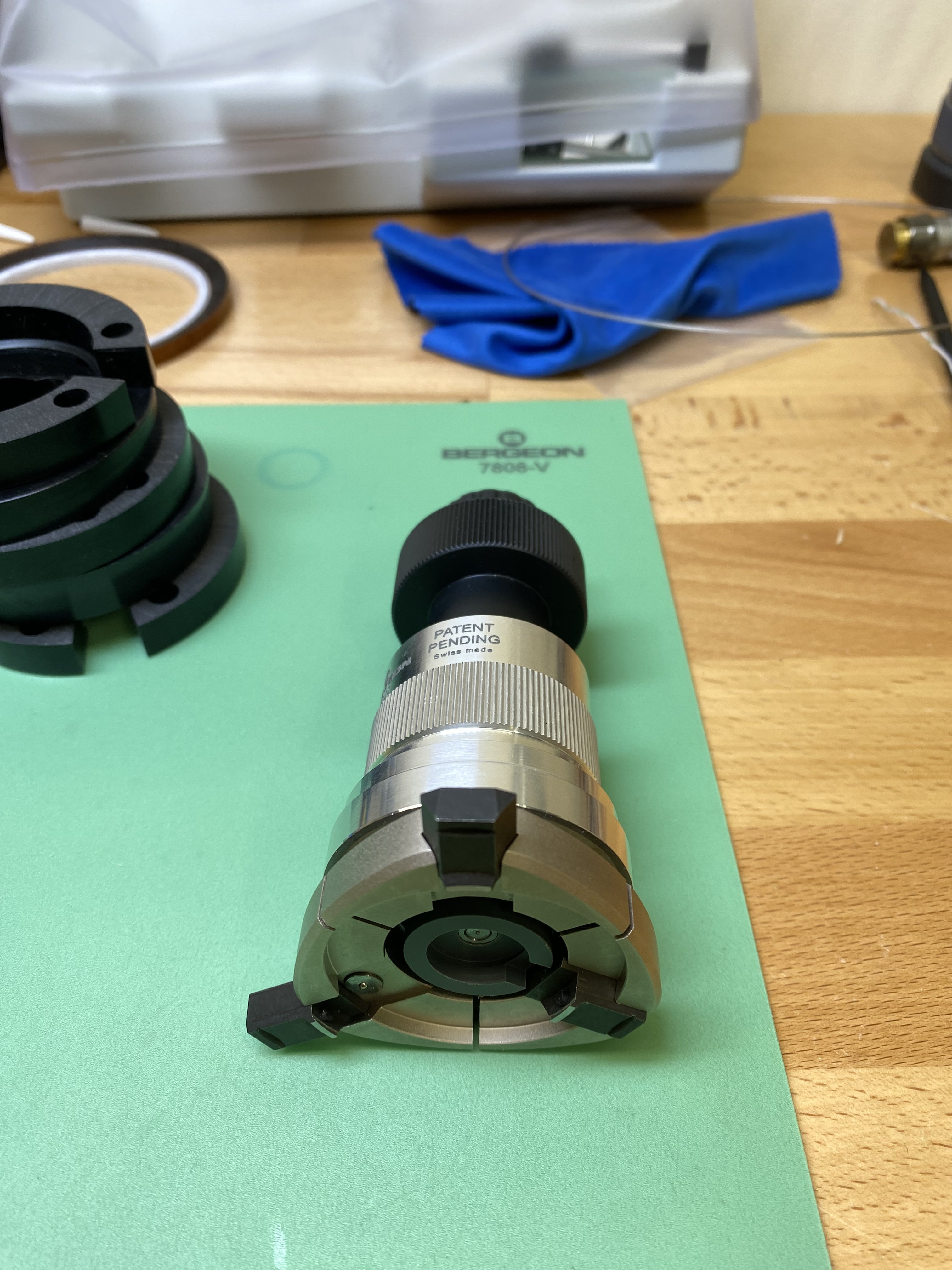

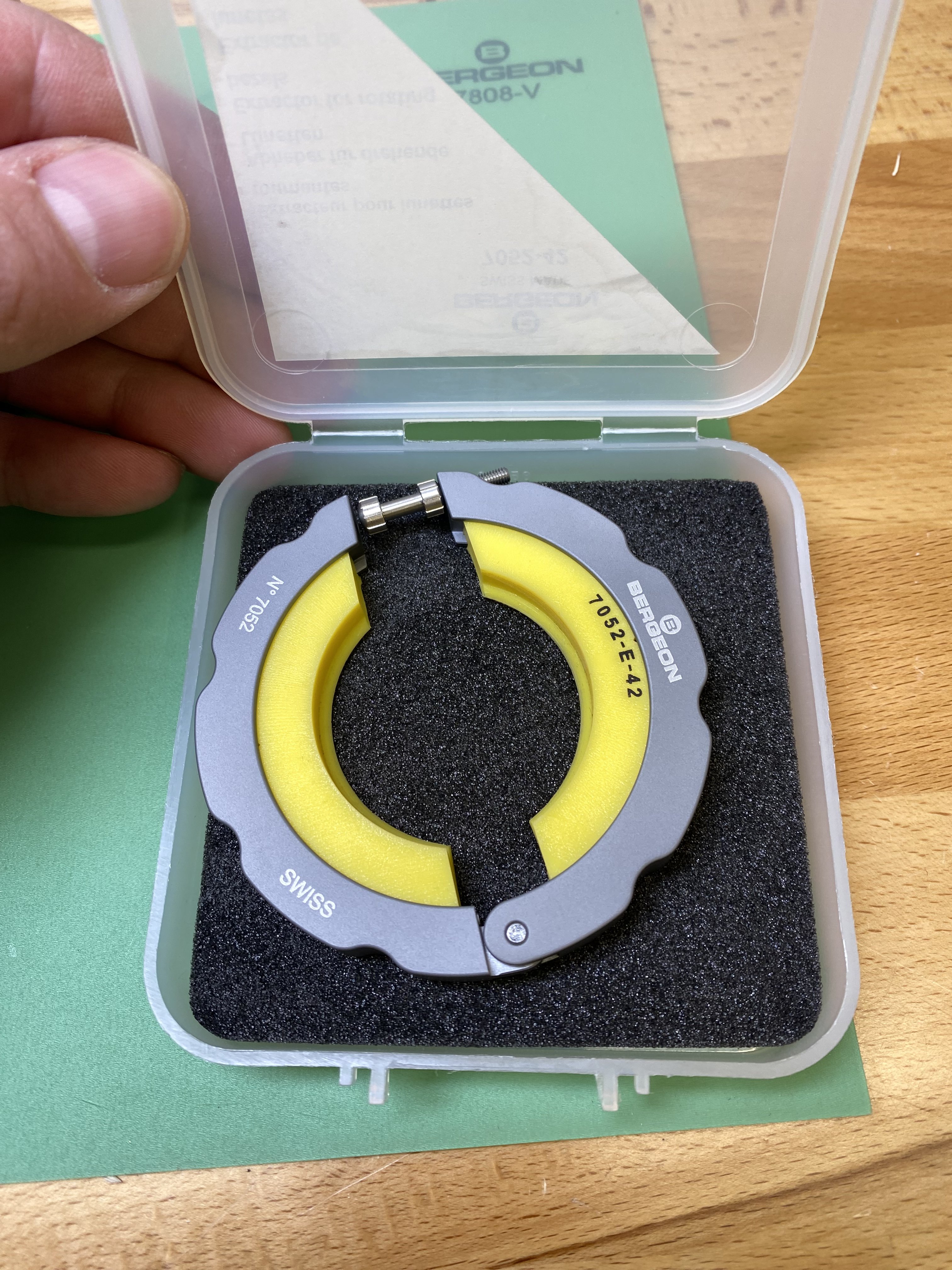

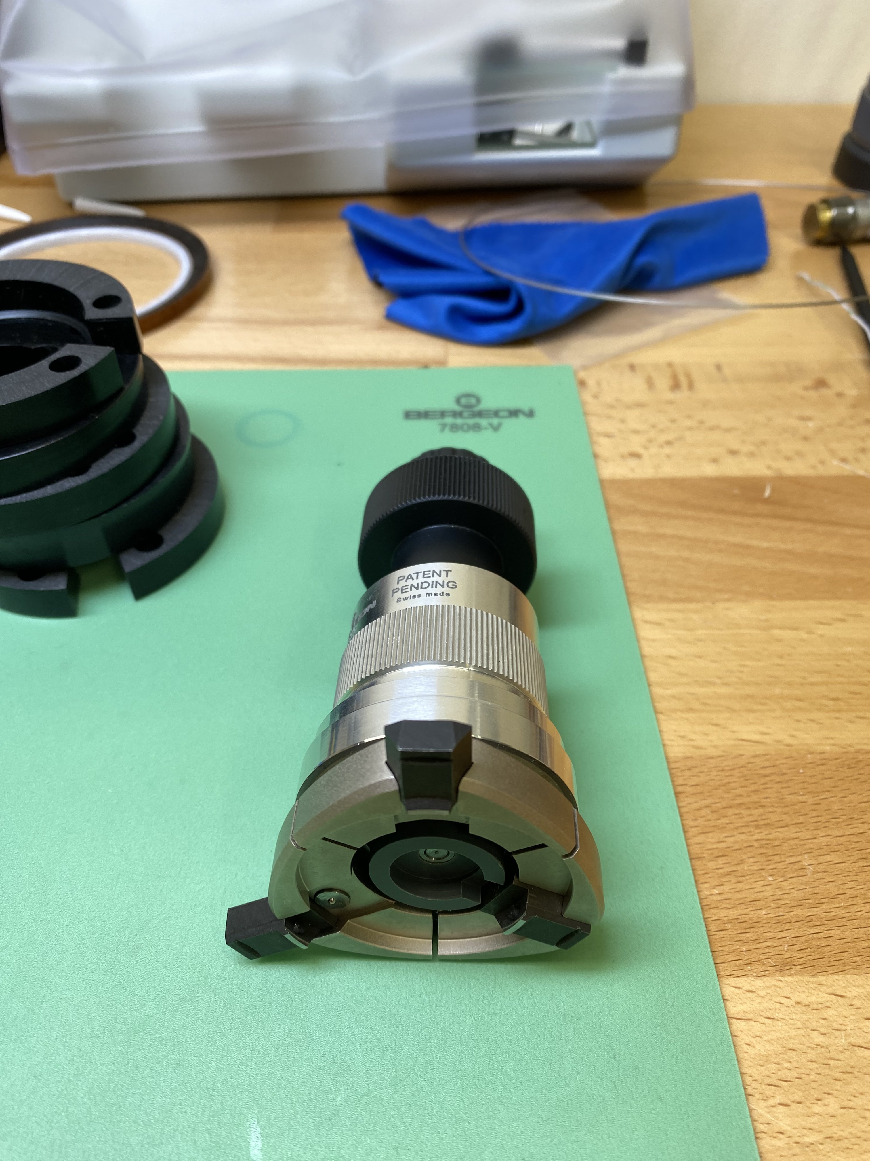

before I obtained my Omega parts/tool account I used some aftermarket options that worked ok:
This tool is also meant for rotating bezels, but I tend to not use it as it has metal clamping jaws. If it slips you cause damage:

Maybe disaster was a harsh word. I have had watches come in with notable damage from failed attempts to remove the bezel. The Omega or aftermarket equivalent tools are nice as they can’t cause damage.

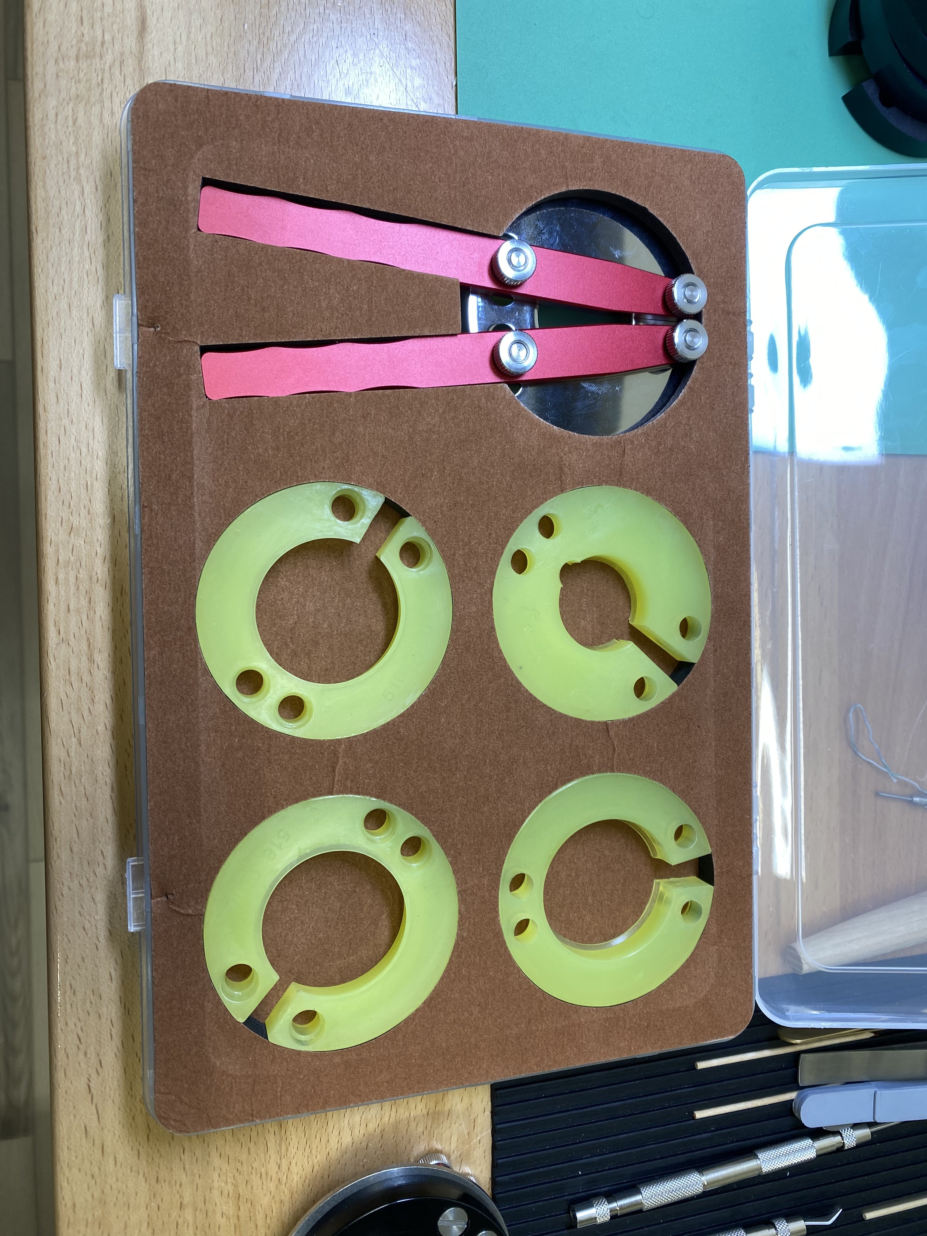

Part number is 519 0011, but I don't know if they are readily available and the cost is likely to be scary.
There are hundreds of generic examples of the Omega tool on eBay, AliExpress etc.
Have you tried any? I’m afraid they might damage the bezel/click spring.
How would they do that?
(if used correctly)
(if used correctly)
As per several reviews the rings don’t grip on to the bezel tight or as they should.
