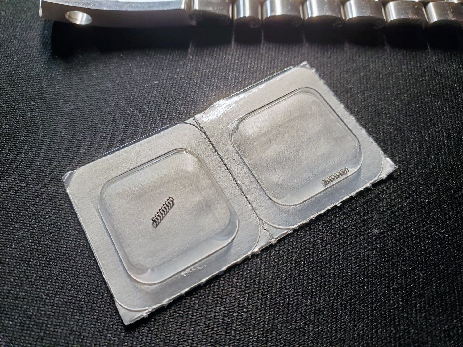

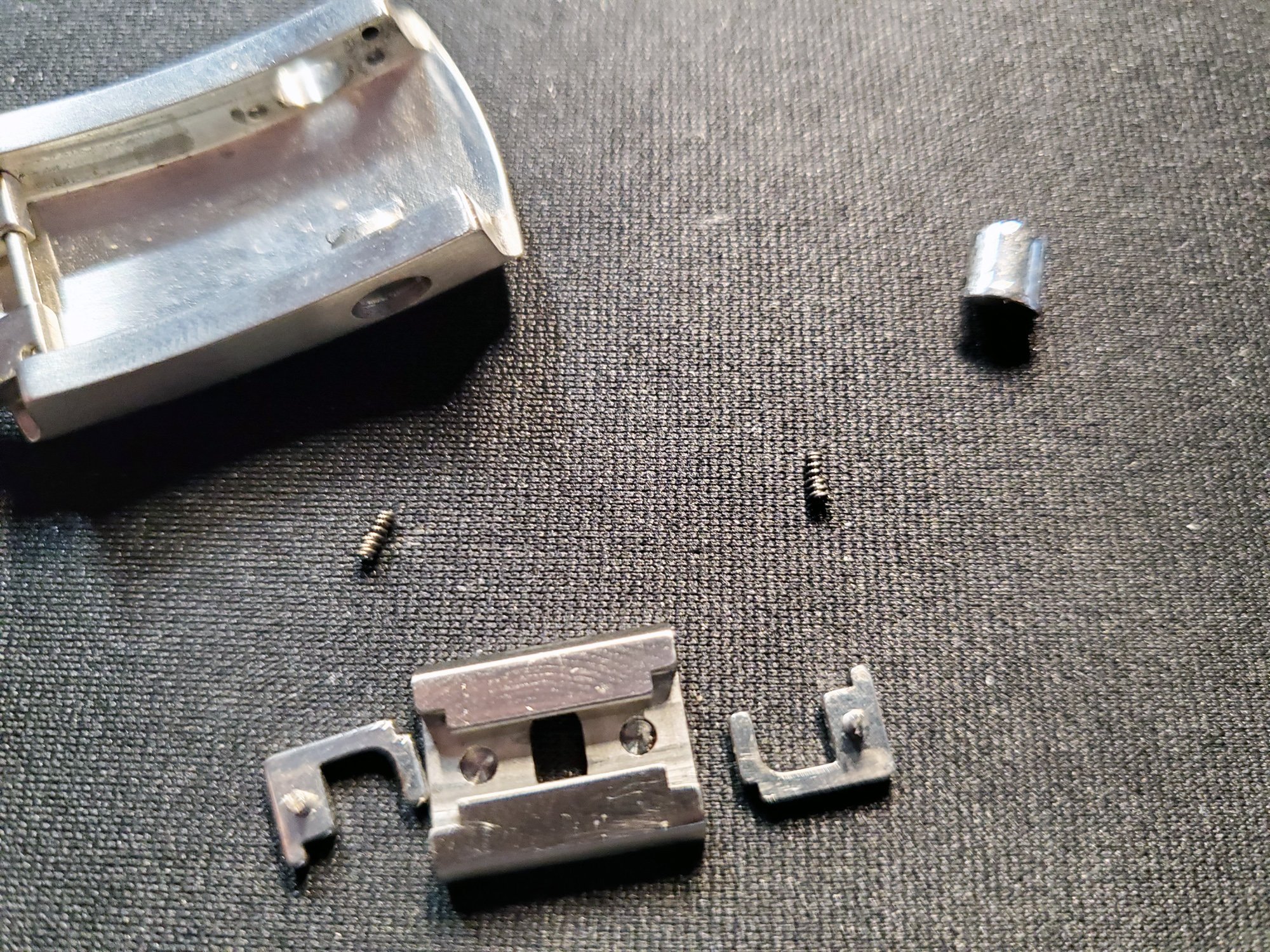

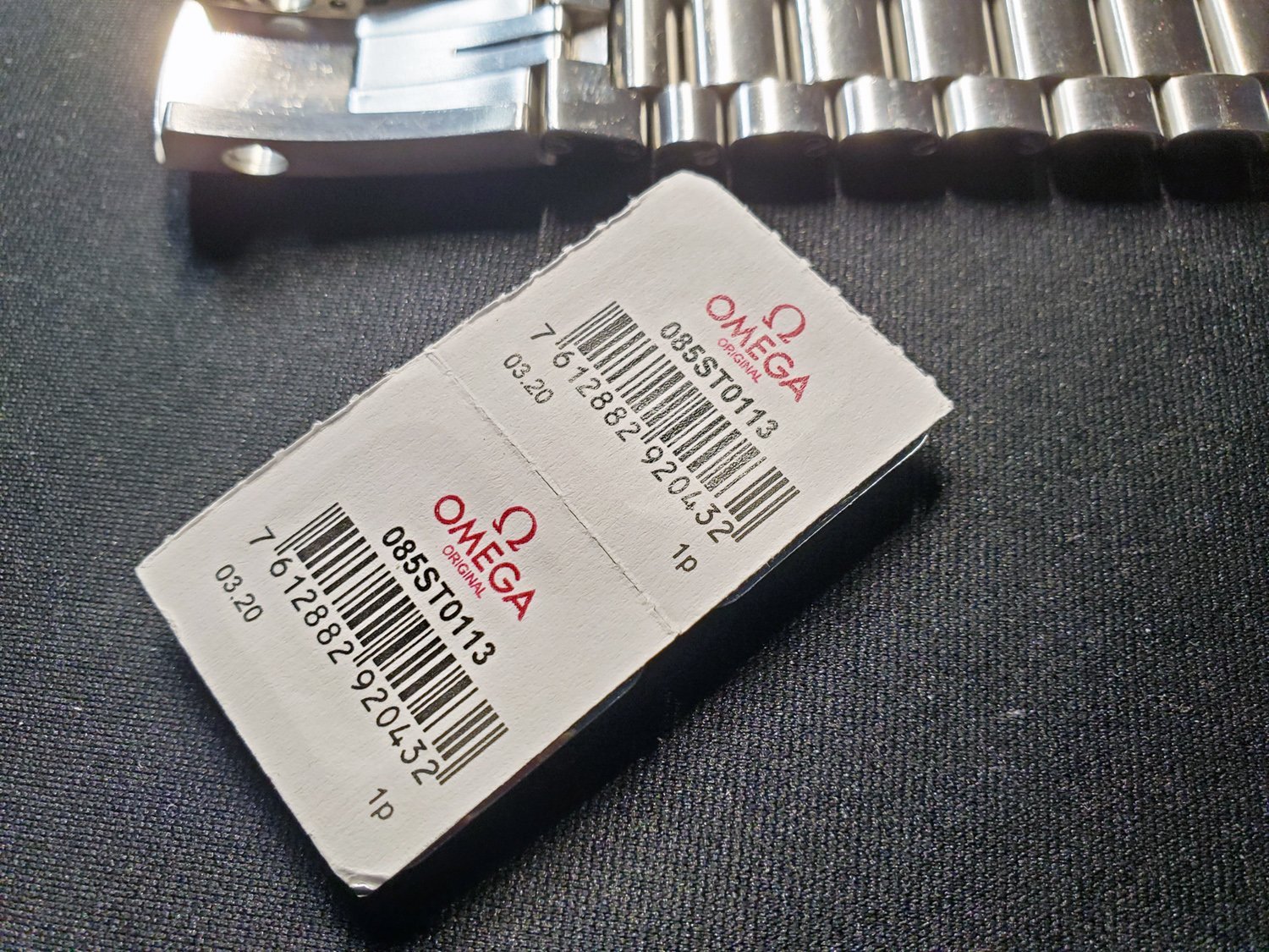

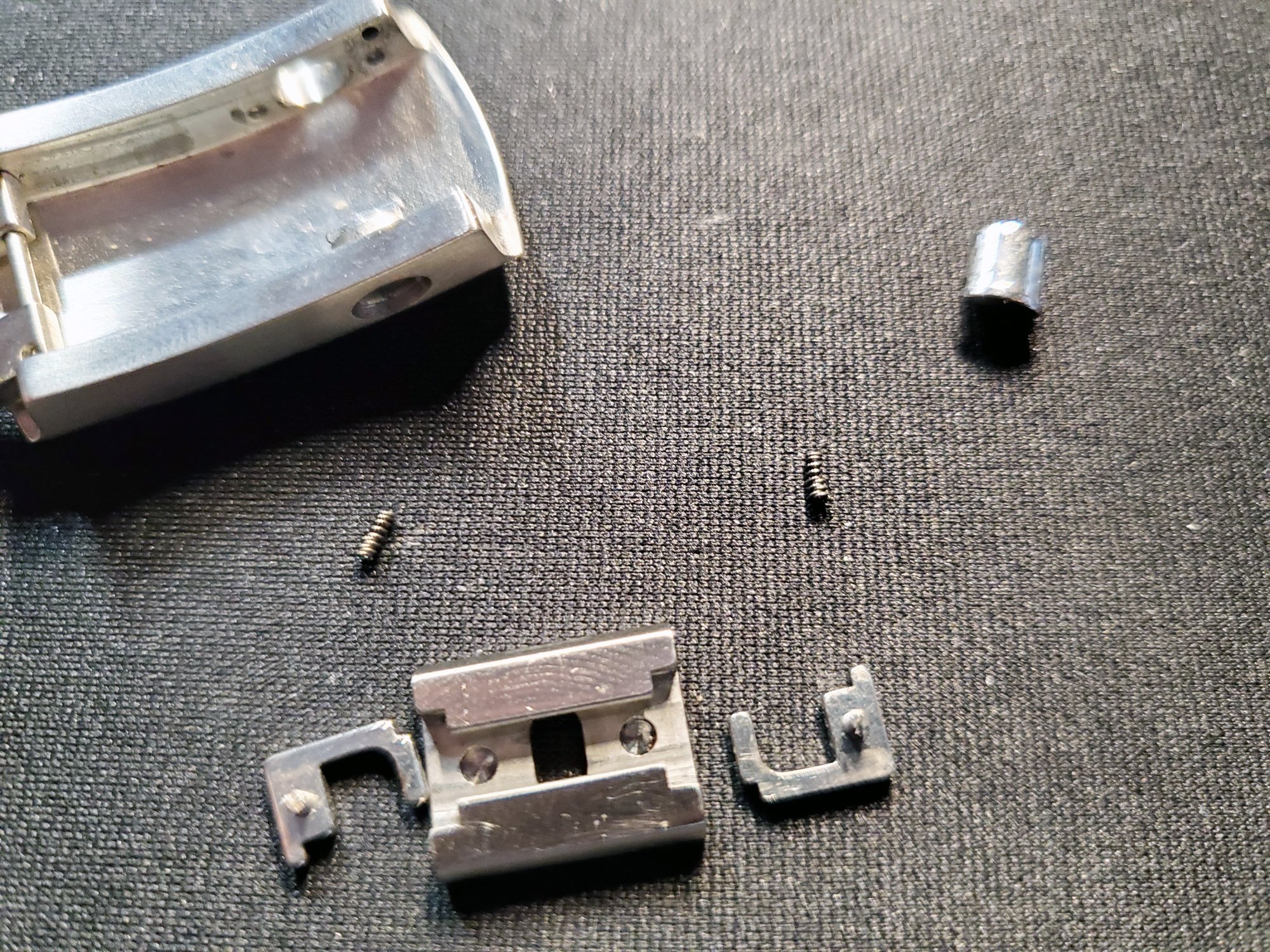

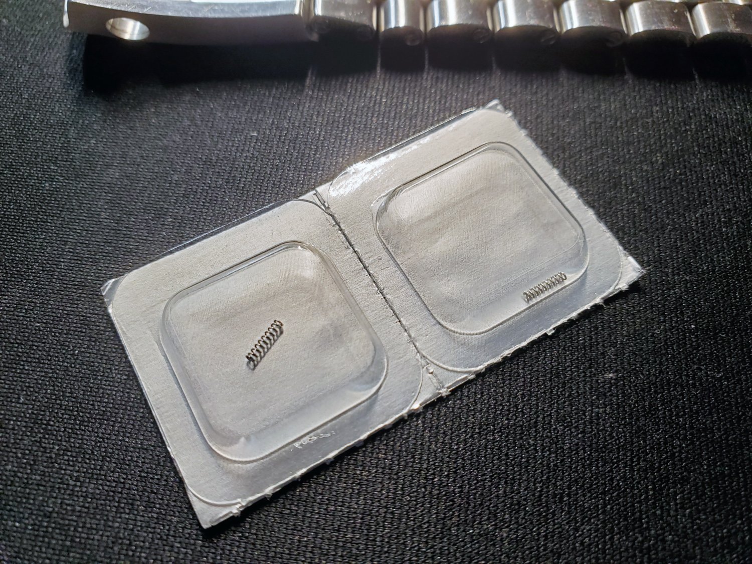

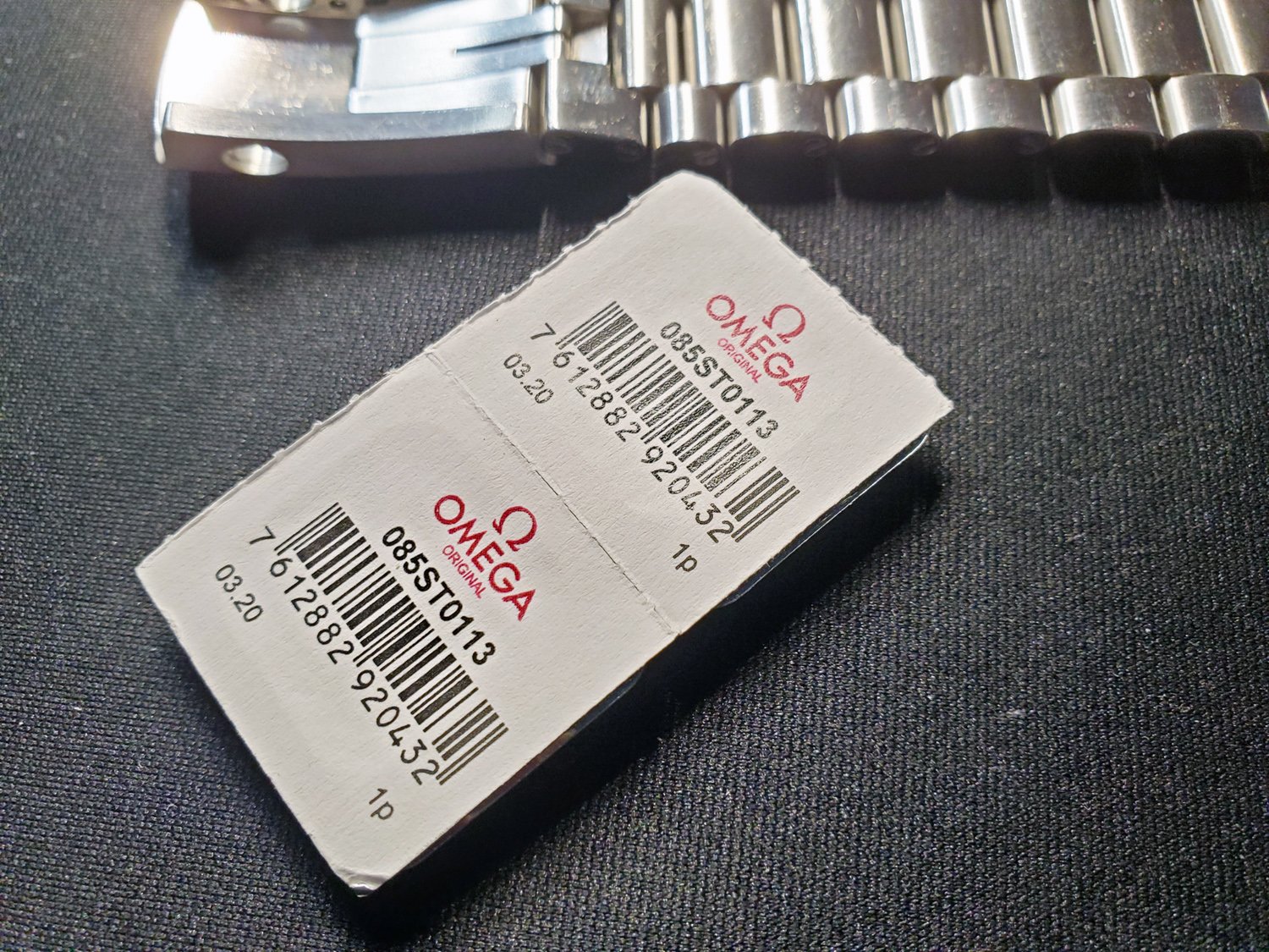

I would be wondering why there was a screw missing on the clasp of a new watch. Replacing the screw would not fix the issue, as the missing screw may have allowed some parts inside the clasp to shift, specifically one or both of the tiny little springs giving tension to the push buttons and the two locking hooks. If they're out of alignment, broken, tangled, or just old, that clasp would stick as you described.
I replaced both clasp springs on one of my old Planet Oceans recently because they were old/weak, and as
I picked them up with tweezers, they both broke in half (not pictured). Replacement was pretty quick, took about 5 minutes.
With Omega, they're just going to replace the entire clasp with a new one as opposed to diagnosing & repairing.
