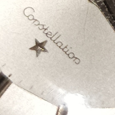

Very little available in terms of pics and detail on this one, but amateur first look suggests a re-dial?
My untrained eye is telling me there is something wrong with the size or font of the 'Constellation', and then the elephant in the room been the crooked star?
Agree or disagree?

I vote redial. Also polished and tired. Unattractive watch.

Deffo redial. Lots of tells, the star, the text, the lack of definition at the scalloped sides, lack of minute ticks etc etc.

100% redial.
All the text is wrong.
The pie pan edges are too soft. These edges are sharper on original dials.
Minute track is absent.

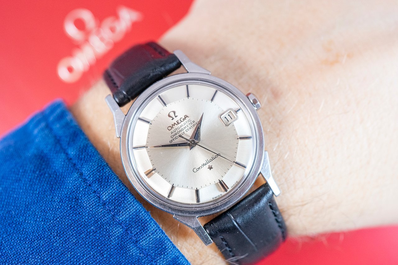

This one looks much better.. (found it on other thread here ..)
1,101
8,453

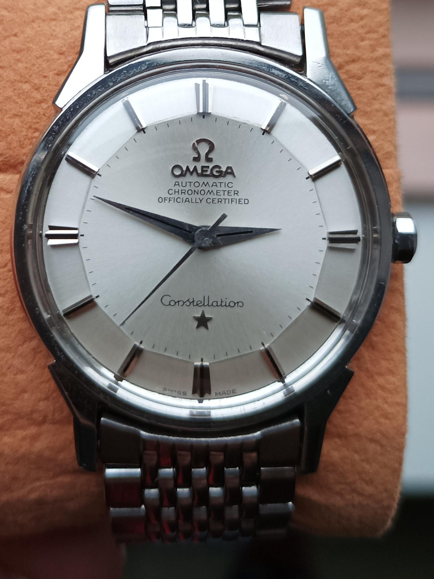

The OP is definitely a redial and I think, and I highlight the word think, the one above may be a redial as well, although not a bad one, the n's in constellation are not quite right, the Swiss Made too far apart, and the font just not as crisp. Below is my own which is not a redial and what I use for reference. If I am wrong I am sure someone will correct me, every day is a school day after all.

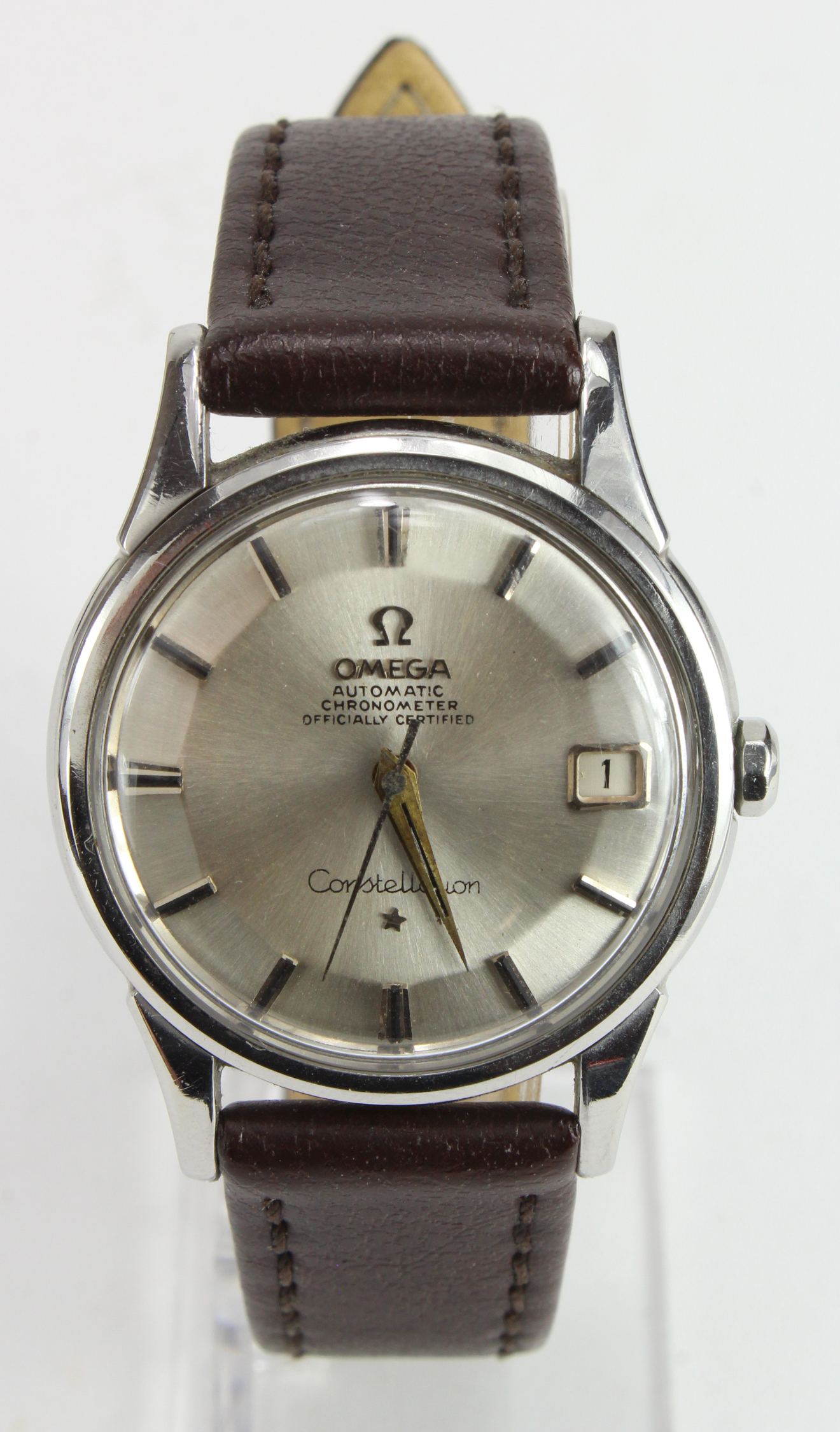

Just out of interest, do Connies come with both (excuse the terminology) 'flat' & '3D' stars? I've seen evidence of both. The star on your watch appears quite flat whereas many look 3D as per attached pic.

Oh, now your asking😕. Again I can only go by what I have, and I have 3 constellations with 3 different dials and all have the '3D' star, the previous picture doesn't show it and the best pic I could get on my phone is a bit blurry but I think it shows the effect, below. So I think it is standard.

there are large stars and small stars but no flat applied metal stars on 50s and 60s Connies.
Noted 👍 Thank you.
