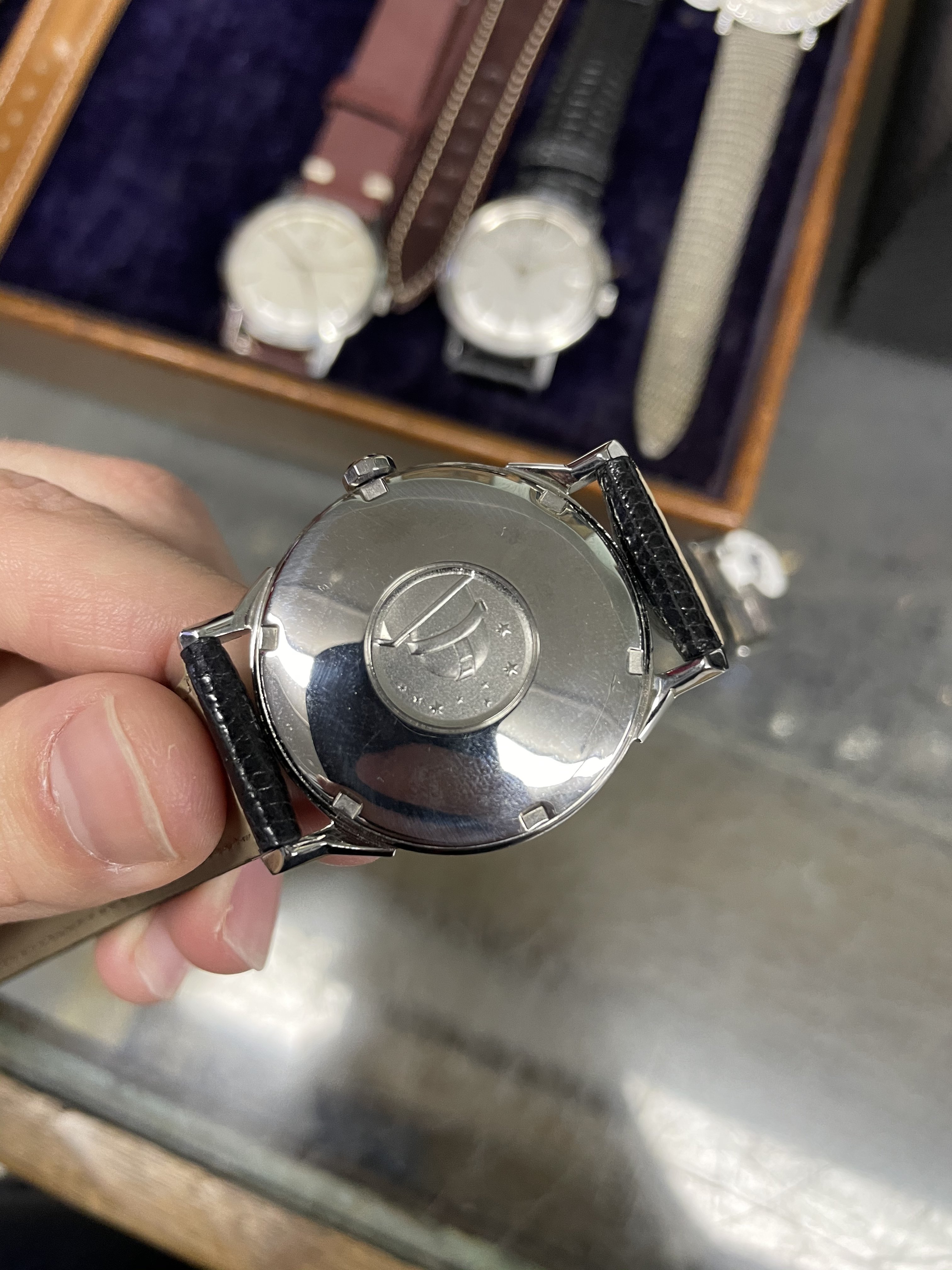

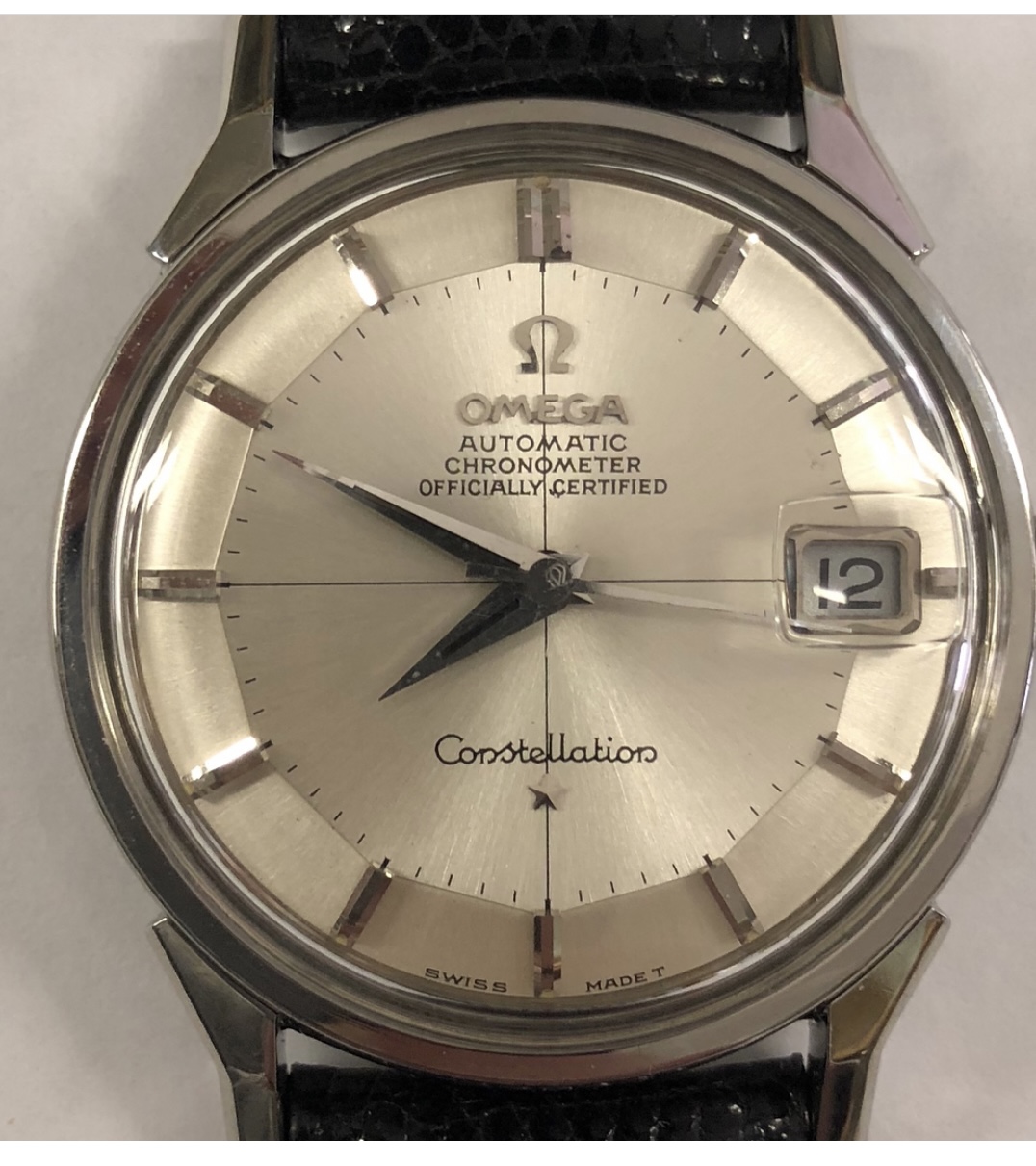

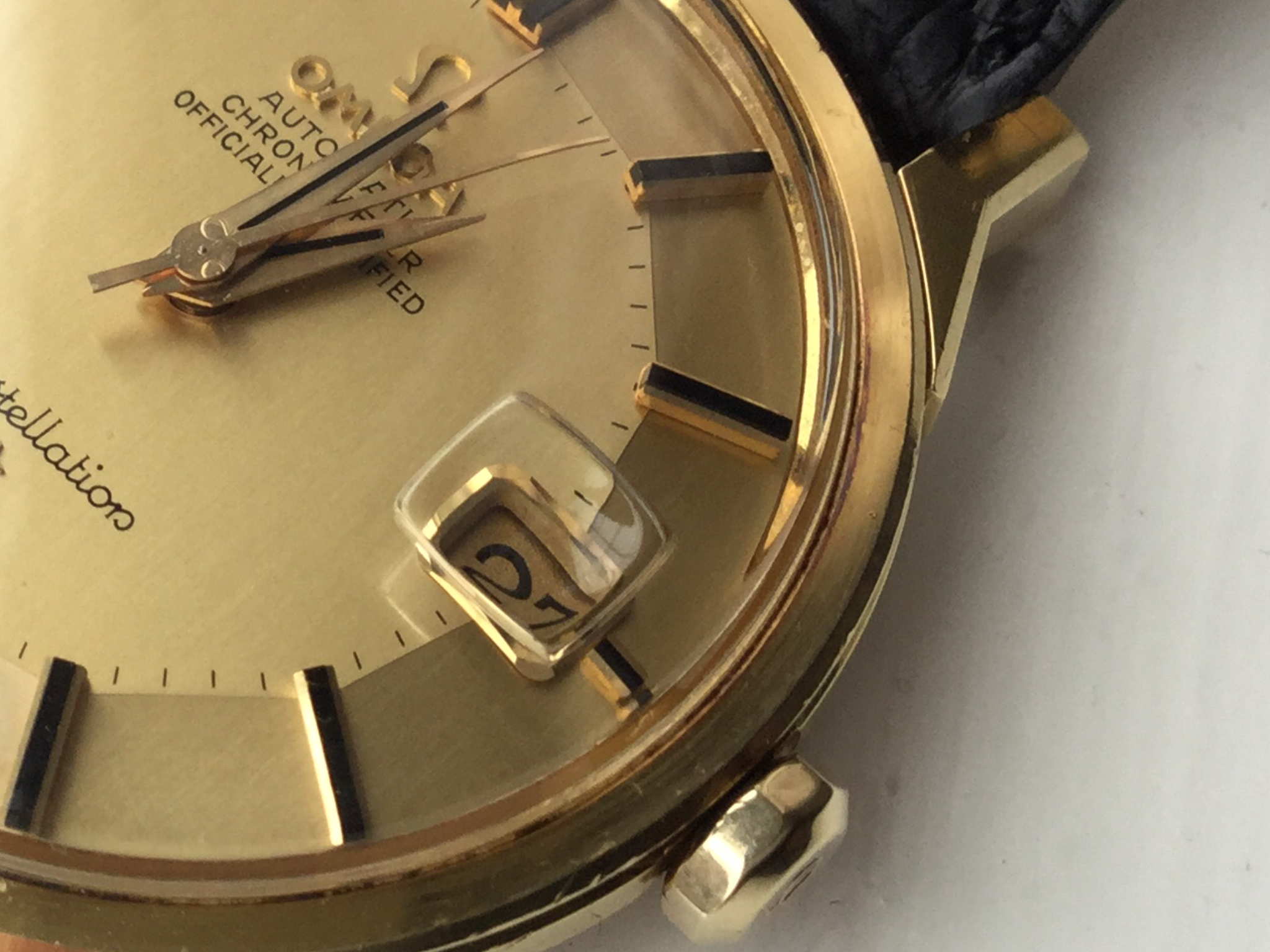

Hi experts,
I found this vintage pie pan at an antique/vintage jeweler today and was hoping to get opinions. My impression is that the case and medallion are incredibly sharp and the dial is clean. Haven’t seen the movement and don’t know the reference number but can enquire. My concerns are the printing of the word Constellation on the dial (looks thicker) and I don’t know much about the magnifying crystal. Thanks so much!

I’m not one of the experts to give advice but if it’s a redial it’s a damn good one. There is a lot to like there I’ll be curious to see what those more familiar with the particular reference say.

Hi,
dial seems absolutely right to me and in great condition, font is ok, MOY test ok.
Case is in good condition but not incredibly sharp, facets on lugs have seen some polishing.
Main concern to me are hands, with black paint while dial has lume. They have been swapped at some point.

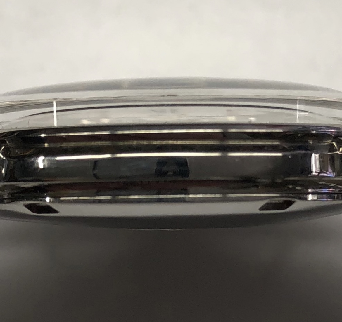

Could you get a pictures of the side of the watch?
46
255
Good point on lume and hands. On second look, the seconds hand may look a hair short to me too(?) and yes the black paint doesn’t seem to match the lume on some of the indices.
I don’t have pics of the sides of case at the moment but could enquire.

Can’t tell from the picture, but the lume on the hands may have darkened with age.
Everything looks OK except for the price. Seems a bit high to me. For $1,850, there should be no questions.

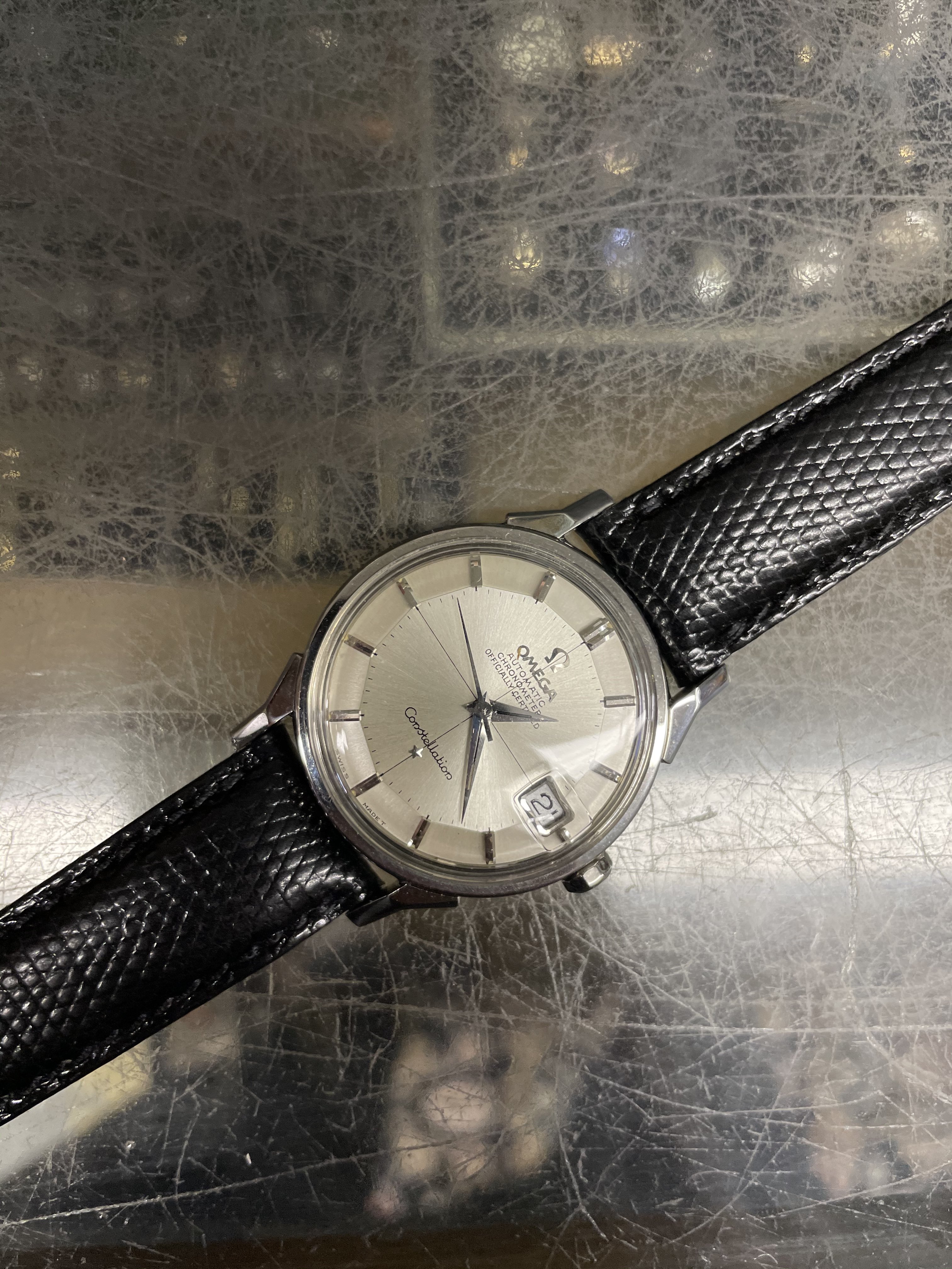

Some marginally better pics. Here it does look like hands may have darkened but you’re right. Shouldn’t have to question at the price. In your opinion, what would be a more fair price?
505
738

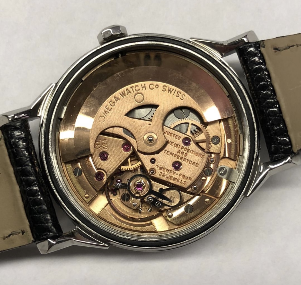

Well, case seems in better shape than on first pictures.
but hands look definitely black paint to me.

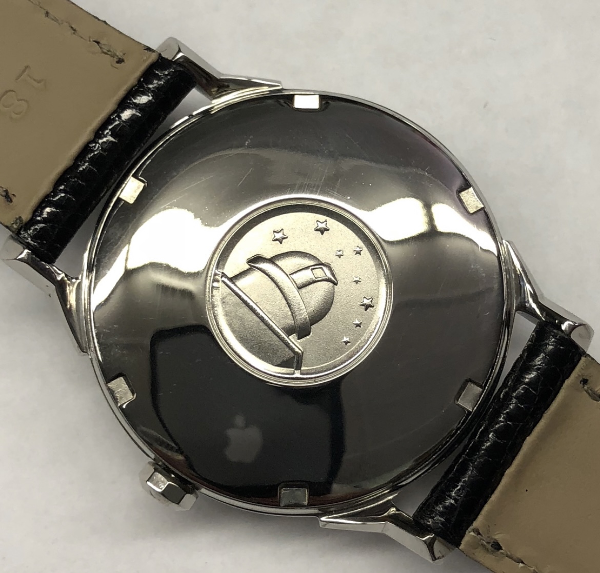

The rotor may have become loose, there is rubbing marks on the bridge, you can see it where it is written “adjusted in five....”
But, the rotor could have been changed in previous servicing, because the “o” on it means it’s a service one.
Not a deal breacker, an easy fix if it has to be done

Dials original. Unusual Omega plexi with magnifier as well.
Even in GBP where watches are more expensive, with no bracelet and polished case the price is high.

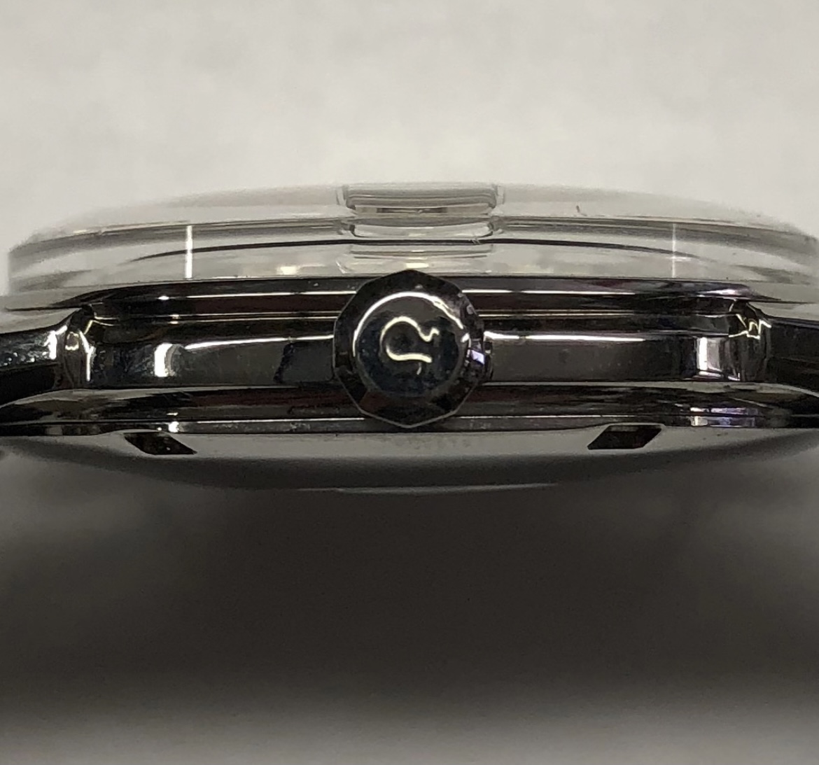

Price is high considering the polished case, the additional photos clearly show this.
More like $1250, if you can live with the case.

Magnifier on a constellation is a bit unusual but omega used to change them on demand when a watch was serviced you could either put a non magnifier plexi or one with a magnifier. Also that pie pan doesnt look so bad case is polished but not so much that would be a deal breaker. Also caseback is in a very good condition , it has a 564 cal. which is a plus instead of the 561 cal, also the dial is in a pretty good condition with no moisture damage or patina. I were you I would make a lower offer hope that helps.

Also not sure about the magnifier. @Gui13250 you seem more expert. Have you ever seen one on a Constellation?
I’ve seen many Constellation with date magnifiers.
I even have one myself, probably not popular but certainly not unusual.

Magnifier does exist on constellation.
but black painted hands and lume on dial can’t be original

Hands are not painted. This is a common lighting effect.
Magnifiers are not uncommon on these. At one time you could still buy them from Jules Boreal. I still have one sealed in the original Omega packaging.
The most important part of this watch is the dial. Knock a little off the price and buy it.

The hands should surely have lume, it is a T dial and there is lume visible on the dial. If they are indeed black then either they have been painted or swapped. Or the lume has gone mouldy. Either way it isnt a good thing IMO.
That OP watch has a nice dial its true but also looks pretty heavily polished to my eye, perhaps too much so.
