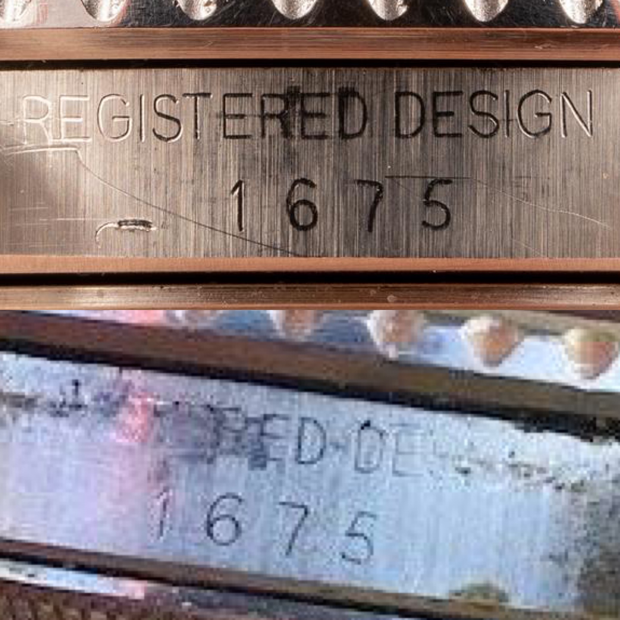

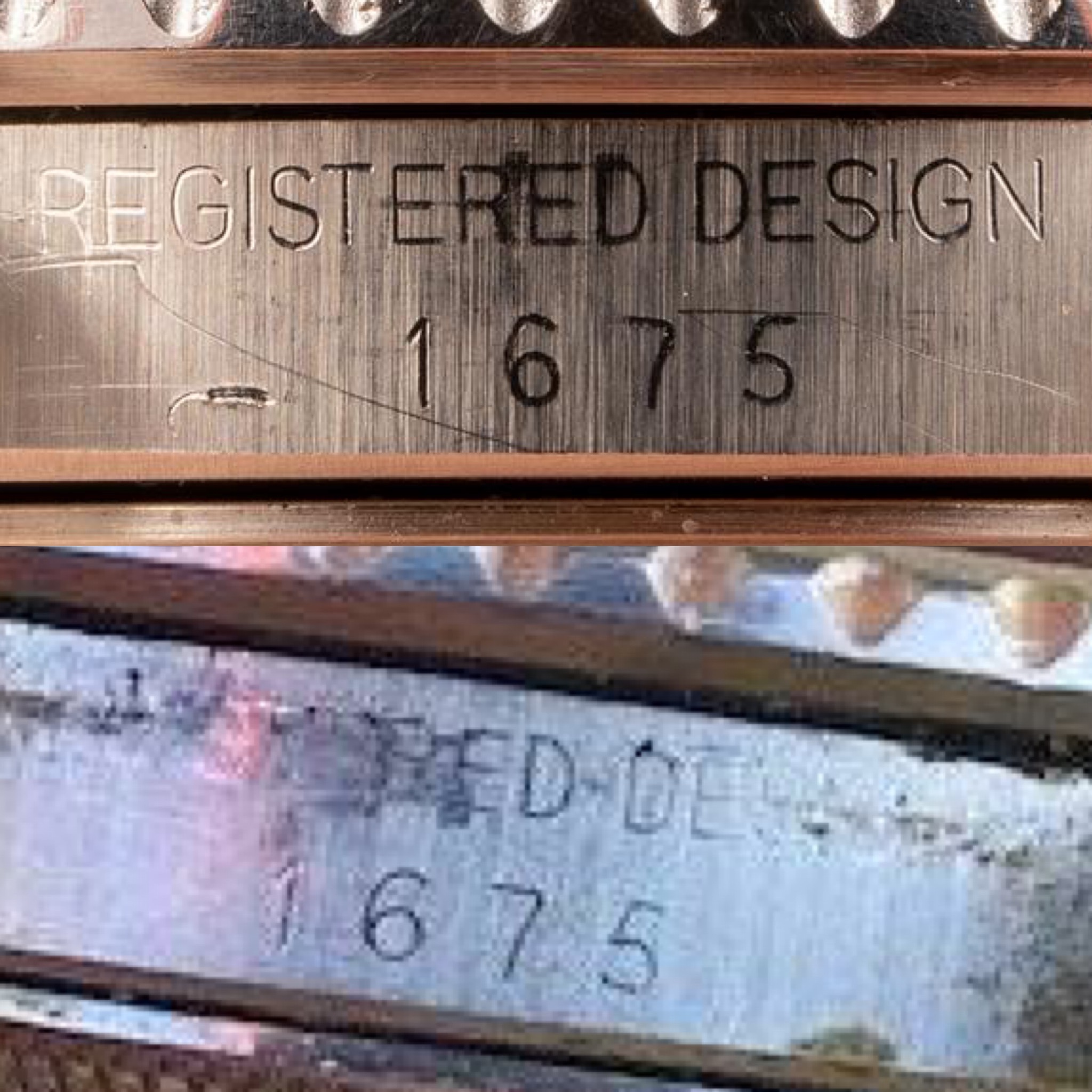

Thanks for putting up the bat signal @Larry S . People have gotten the main points - dial refinished, hands fake, insert fake. Also concerned that the case is fake, the engravings look wrong to me. The typeface looks most similar to Type C (which wasn鈥檛 introduced until 1970 and wouldn鈥檛 be correct for a gilt dial anyway), but also isn鈥檛 completely correct. Here鈥檚 a comparison of the OPs engraving (bottom) and a correct Type C (top). Most obvious differences are in the 6s and Es.

I think the OP noted that the case has a 3.3M serial, it's not from the gilt era. In my experience, the pantograph engravings can be pretty variable, so I would want to compare with a handful of cases from the correct period, to get a sense of the range of expectations.

Re:serial - okay thanks.
Re:imprecision - possibly, the picture the OP posted of the engraving is terrible. The E middle bars look the same length as the top/bottom, and shouldn鈥檛 be. If that鈥檚 just the picture, might be fine. But if the same length, that doesn鈥檛 change despite shaky pantographs, and would be wrong.

I would agree with you that from the poor photo the relative depth and thickness of the engravings seems off. I wouldn't bet money on it though.

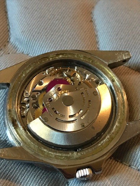

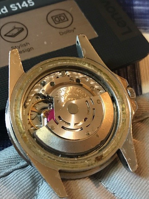

John, thanks for asking about my progress with the project and the watch is still in Manhattan as I'm debating whether to send the case out for refinishing or run it as-is. The movement is now running and was gummed up along with a loose rotor pivot that distributed debris through the workings. My pals in NYC rounded up a great looking used service dial for $700 so I'm basically dragging my feet whether to have the thing slapped back together now or send the case out. I have too many (watch) irons in the fire so I better get this and some other projects wrapped up to make room for more. Anyways I doubt I'll wear this thing as we have some Rolex sport models already that we gathered over the years in the Philippines and I don't wear them either. I'm more of a vintage Airking and Datejust guy. However it will make for great trading fodder down the road. 馃榿

If the dial is refinished, the hands are fake, and the bezel insert is incorrect, how is thinking the case might be wrong is a "bizarre notion." Also, I said that I was "concerned" about the engravings, noting that the pictures we had to go on were terrible and pointed to the specifics about the font that don't match the pantograph fonts used on 1675s, while leaving room to be persuaded otherwise with better pictures.

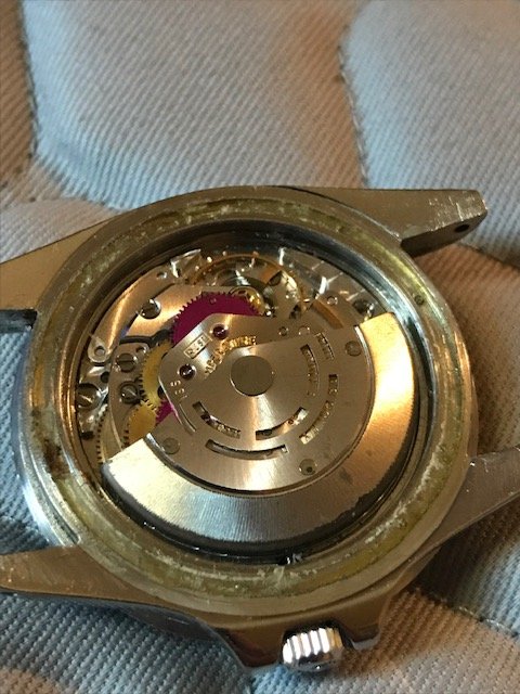

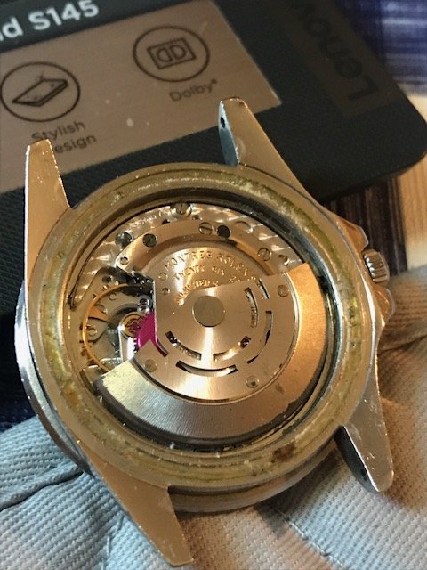

i think any doubt about authenticity of the watch was dispelled in my earlier posts when I reported that the movement was reasonably clean, yet there are still some who must keep droning on about engravings. If I have opened the watch and seen the movement, I think all doubts could be dispelled. I didn't bother with interior or movement shots as this discussion was about the dial.
The movement is reasonably clean

The watch has a refinished or fake dial, fake hands, incorrect bezel, so why is having an original movement among incorrect parts reassuring?Looking at the prior posts, I see little to no doubt being dispelled other than yours. I am happy to readdress the midcase authenticity if you post better pictures of the engravings.

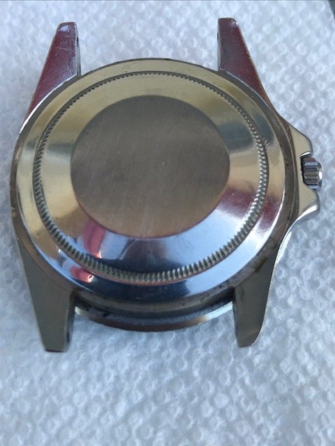

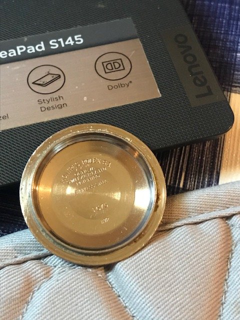

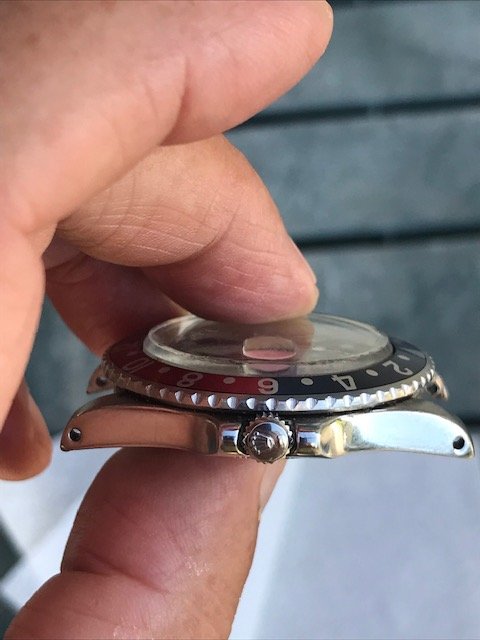

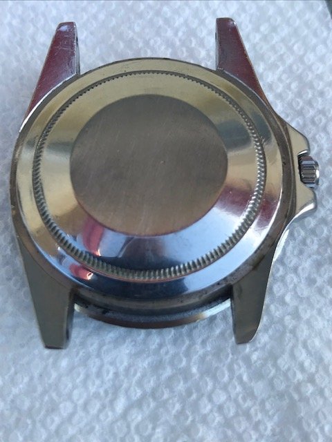

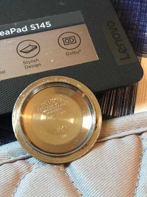

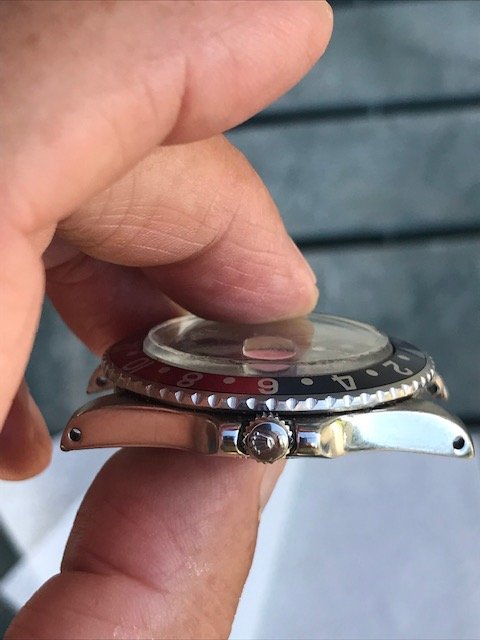

Yes my photo skills are crappy but along with pictures you have my typed words as part of the description. However here are some additional pictures I took that day for you to obsess over. As I mentioned earlier, there was no initial need for interior shots as that wasn't the subject of this thread. Here it is in all it's grungy glory. Still have doubts? Enough of this already.

We're taking about the midcase engravings; I don't see any pictures of those (apart from the initial ones discussed above). Several members had questions/comments similar to mine. It might be totally fine, it might not be, but yes, I still have doubts. I'm not sure why trying to discuss them is making you angry. I haven't said anything about you lying, or anything about Achim, who I respect. If you don't want to discuss the watch any more, that's okay too.

What you fail to grasp is the watch mid case is in fact genuine. Do you think I'm lying about the authenticity? You don't seem to trust my assertions and that is going to be your problem. Enough people have now handled the watch in person besides myself so I would know if I was mistaken. What angers me is your stubborn obsession with the engravings and demands for proof. I'm not trying to sell you or anyone here the watch. Let it go.
